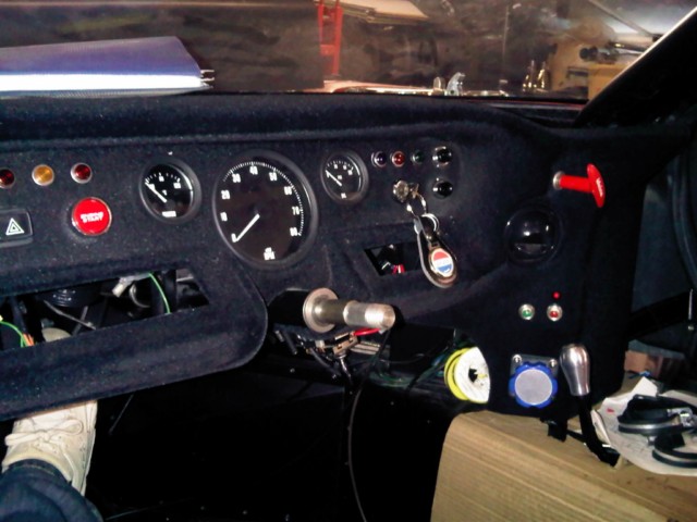

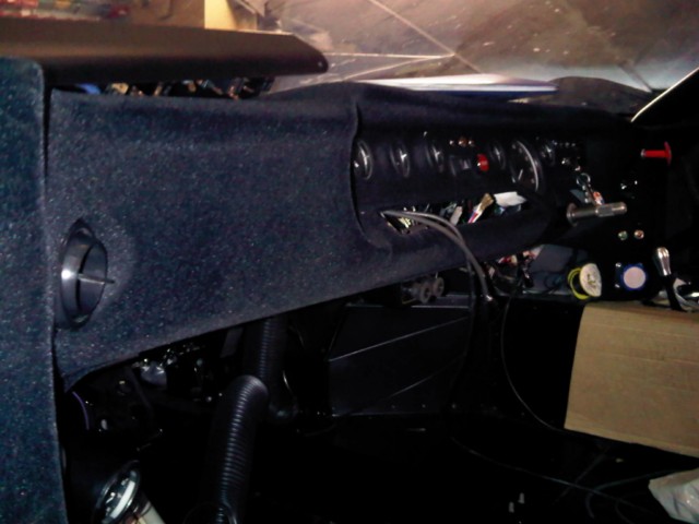

In an earlier post, you mentioned that you had you dash flocked. I was going to paint mine for the IVA than later think about having it 'leathered' but I have to say, your dash looks great. Can you tell me a bit more about it (I have no idea what flocking is) and who did yours?
Hi Ian,
It looks better in the flesh too. The finish is like a velvet covering and looks really good. I was a little afraid it may take away from the period look as I was originally just going to paint it Matt black, but I'm glad now I decided to have it flocked. It doesn't look out of place and finishes it off really well. I had mine done in Southampton but that's not going to help you in Scotland. It was £100 which i though was pretty reasonable.
Molleur,Mark, thanks for posting that up. Interesting.
Here's a pic of a Ferrari P4 dash to show you what flocking looks like.
The top of the dash and instrument cowls are flocked and the face of the dash is crinkle paint.
The flock itself is like Action Man's hair, or the linning of your daily driver's glove box perhaps. Nice and non-reflective from a driving point of view.

Sorry for not replying sooner, I've been away on business. Here are a couple more shots of the dash.

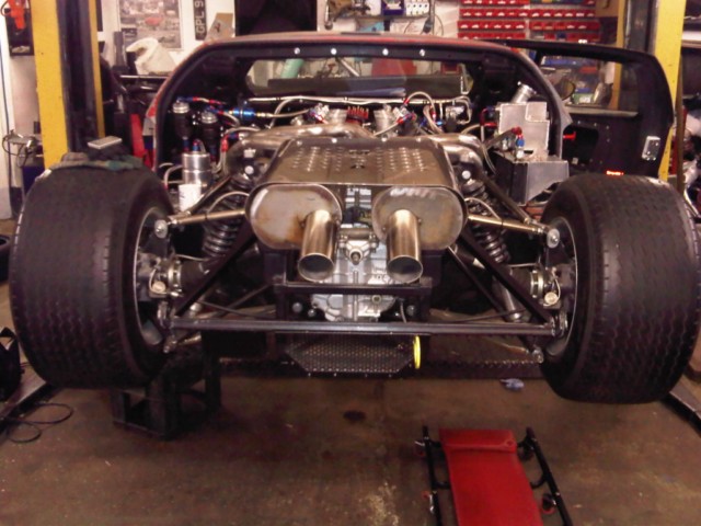

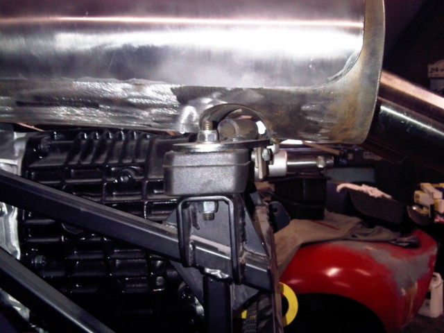

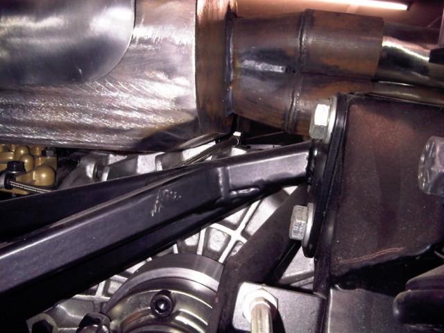

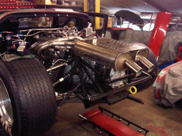

Some more progress to report.
The exhaust system is almost done. The tail pipes are tacked on in position. The position of the tail pipes on the silencers is different left and right. This was done to make sure the pipes exit and look symetrical when the body is on as the body itself is not symetrical to the chasssis.
The cut outs in the rear allow the system to sit as low as possible and the slight angle shaved off the front allows for better clearance. These were custom made for me and look great.
I'm sticking with the MDA heat shield, which I like.
