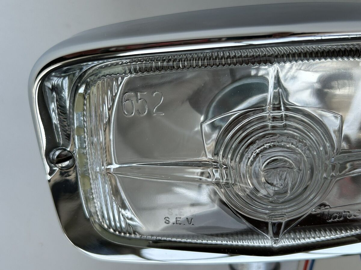

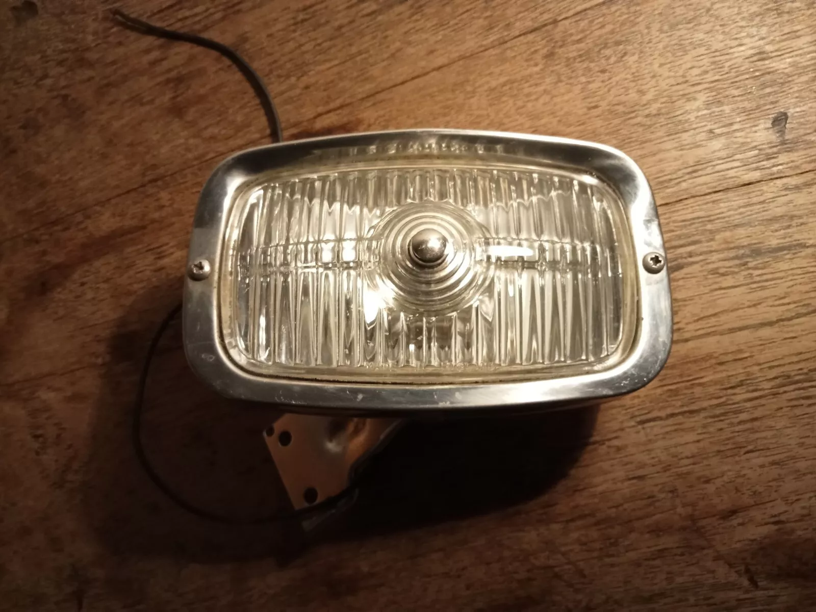

The lens makes the difference between fog or spot.
Think the 653 has a yellow reflector (not a yellow lens)
The 656 has a Yellow lens.
To convert a 653 to 652 you'll need the silver reflector of a 652. The reflector holds the bulb.

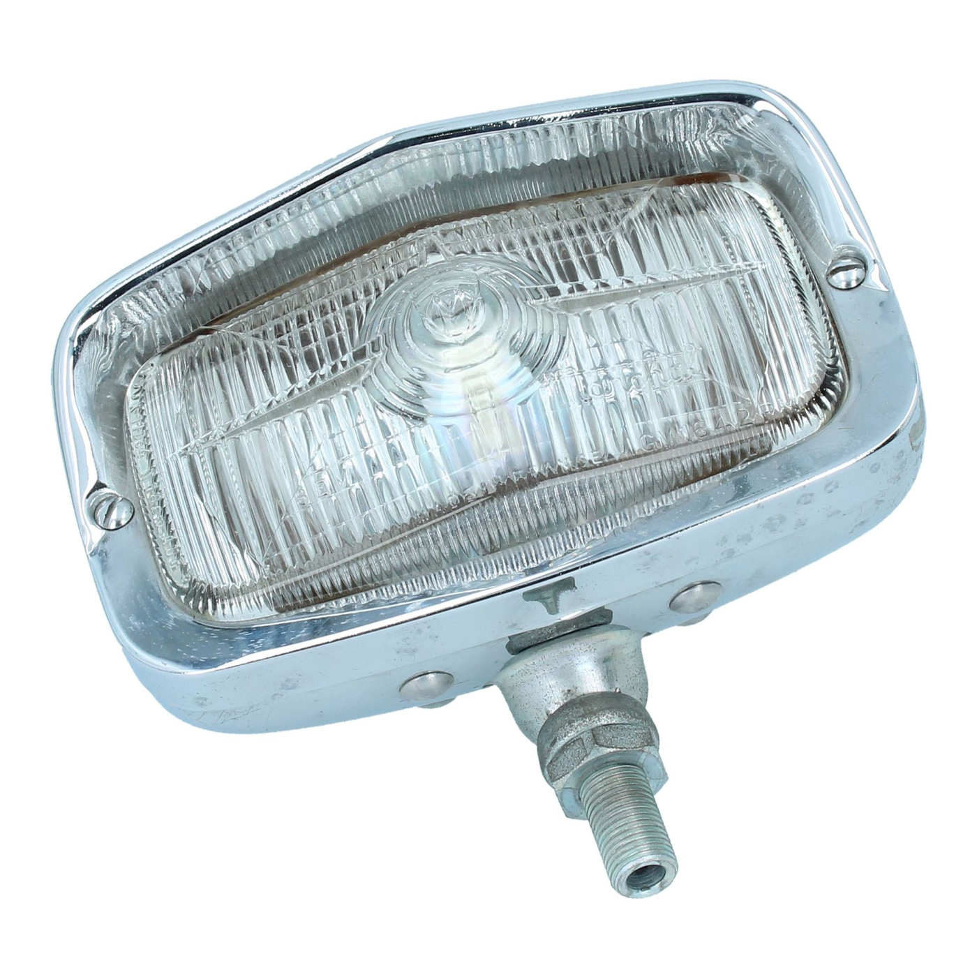

Spot
Fog

The alternative I used, Ford Capri Mk1 (UK) (Not EU) spot lamps. In the pic you'll see the Fog version.
Genuine FoMoCo. Nearly identical in size.
These usually can be found for less then $100/set on ebay. Last week a set got sold for 90.
I was told somewhere the 651, 653, 656 are the same basic lense and the "fog" light. The 652 is the "spot" light which does not have all the internal lense ribbing. Not sure if that is true.
