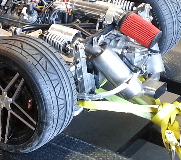

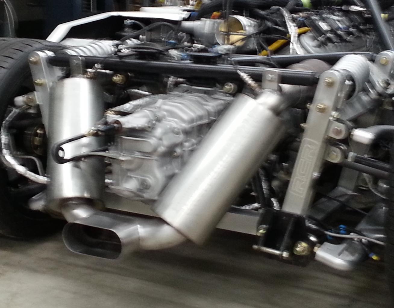

Couple pictures of how I did it - sorry for the poor quality these were all I could find. LS7 manifolds, corvette cats., DBX mufflers In the close up picture, you can see a heat shield over the top of the cats. The system is in 3 pieces, manifold/pipe/cat on the left and right are pieces 1&2 and the mufflers/tailpipe are the third section.

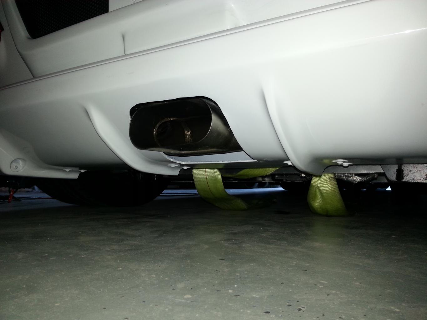

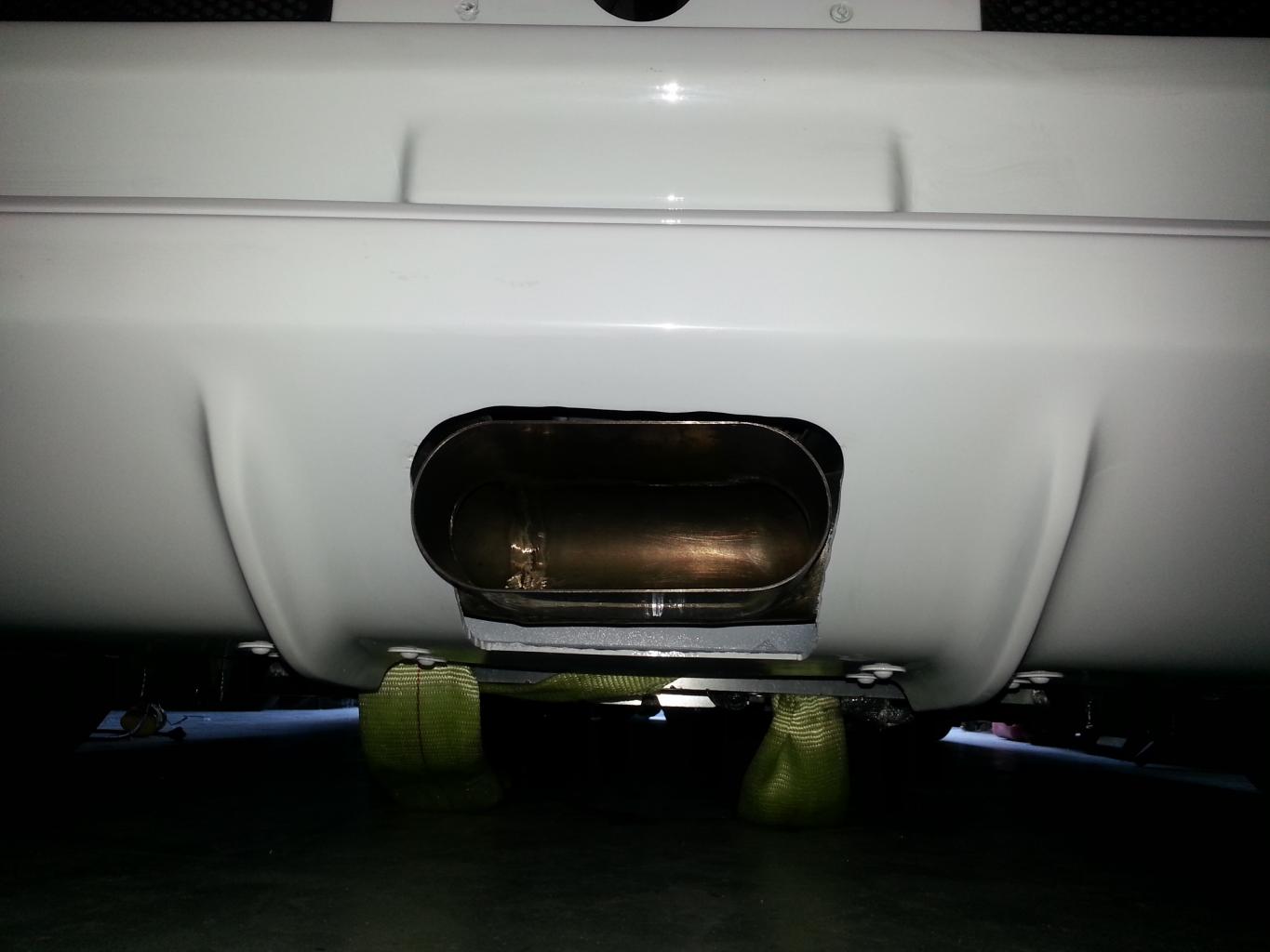

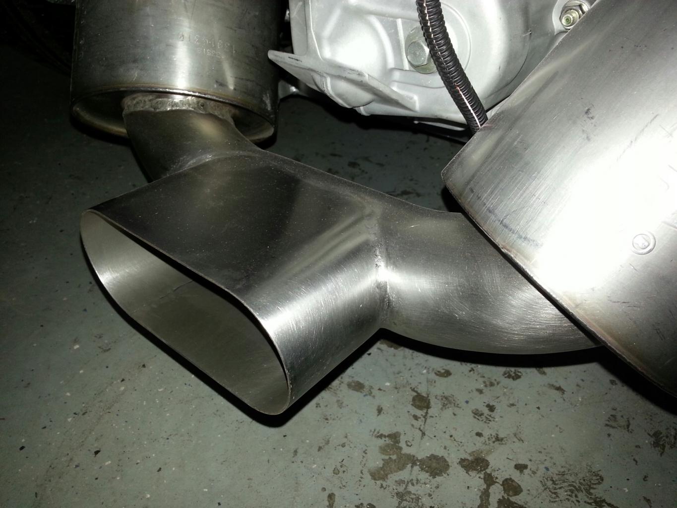

Sorry for the delay responding. Couple of pics of the exhaust exiting the bodywork. I still need to design and fabricate some king of trim ring. Any ideas/suggestions would be appreciated!
