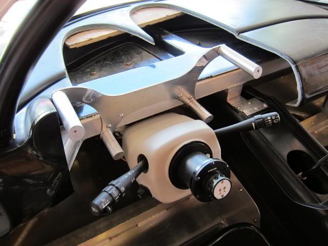

Both humps were cut out of the dash. A bracket has been made to mount the cluster at the correct angle and distance from the bulkhead. The bracket was bolted to the bulkhead using rivetnuts.
Now on to mounting the heads up display in front of the cluster.

It's important to mention the fact that the C6 Corvette gauge cluster can only be used if you are using a BCM (body control module). I didn't purchase the ISIS wiring harness. My wiring is basically taken from a C6 Vette. All the "not used" features are depinned from the harness. I built the engine harness the same way.

Ken- On the gauge cluster. Are you concerned about how high it sits on top of the column? The reason I say this is that when I sat in seat that was low I could not see a car right in front of the stock cluster height, now I am short at 5-6, but still. Just thinking when you put the cover on top and sitting there will you be able to see good? I plan on making a custom dash myself and this is something I am concerned with, but will be using the Koso, just not sure if I will mount it a little offset to get it as low as I can.
Ken Roberts
I'm 6'1" Troy and my seat is not as reclined as some others. The new dash height at the top of the gauges might be about an inch taller. It looks deceiving.

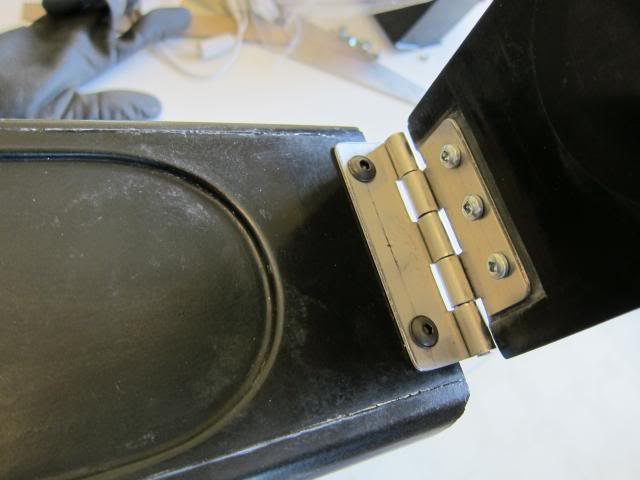

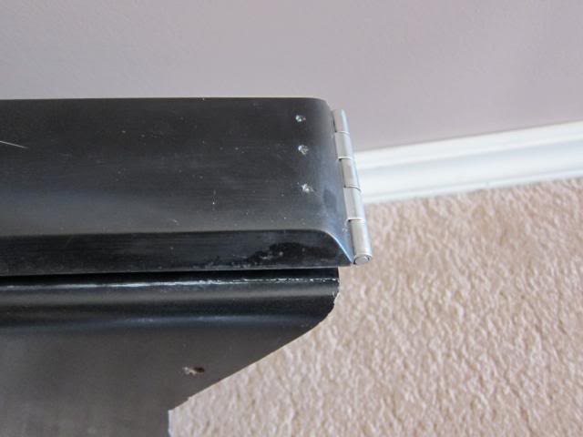

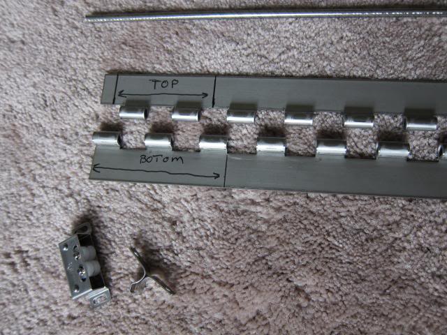

Here's some pictures and description of how I mounted the center console arm rest.
I purchased from McMaster Carr a stainless steel piano hinge (#1582A274) and stainless steel grab catch (#1659A7). I marked off the hinge in the first picture to show you how it was cut up. It's important to mention that you must space your mounting screws for the hinge in such a way that the bottom screws don't line up with the top hinge screws when closed.

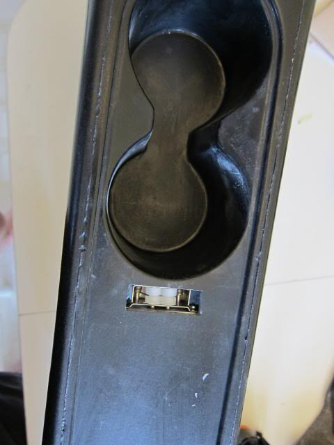

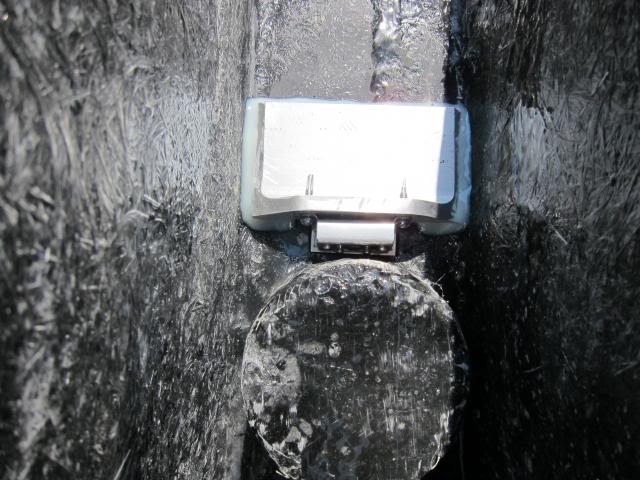

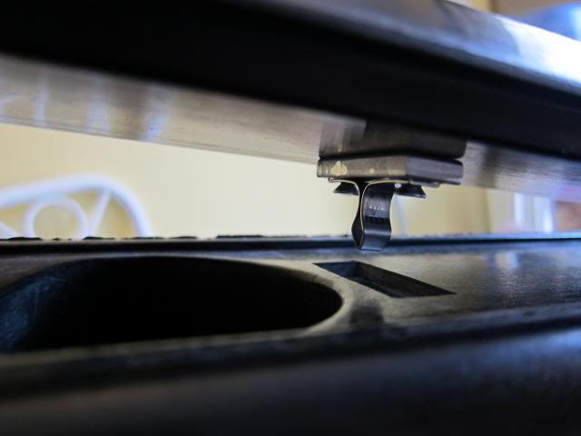

Next up was how to securely keep the arm rest closed. The forward part of the lid couldn't be used due to a lack of mounting space so I chose to mount the "grab catch" in the middle. A small rubber bumper will be installed later at the front.
Here is a picture showing the male part of the grab catch from the bottom of the console with the arm rest in the closed position. The rectangular block is made slightly smaller than the hole. It adds strength in case of a side blow/hit.
