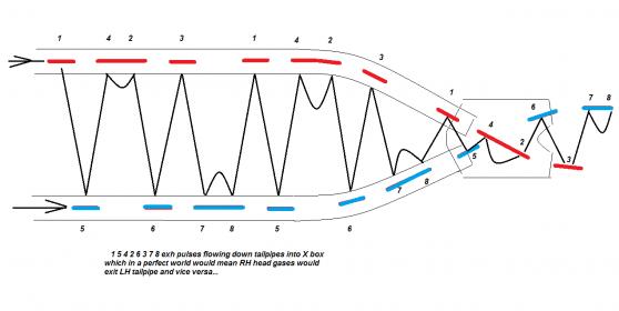

Principle on which X- box is supposed to work. Plus a thought, assume your using a different bell housing with Leons stuff, looks like that starter night be fighting with CV as is.

Hey John, Love the headers they look the goods I have run all into a single pipe on a couple of engines now and the sound is so much better than a twin system, you get a smooth note and not that popping note you can get from twin pipes so I'm guessing the X box gets the same result.
Jac, it's close but John gave me the specs last week and I can make it work with the extra spacer I have to use to match his B/H anyway.
