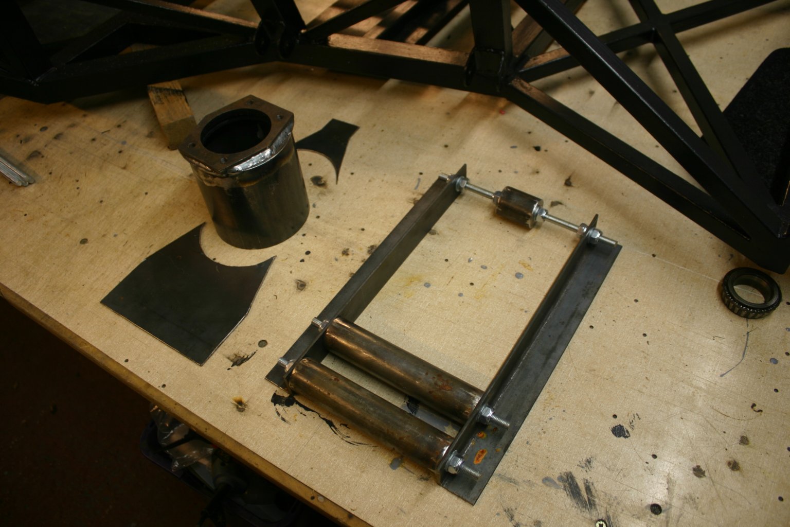

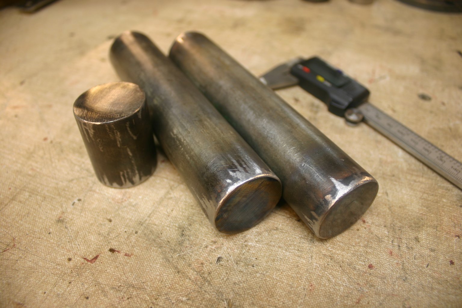

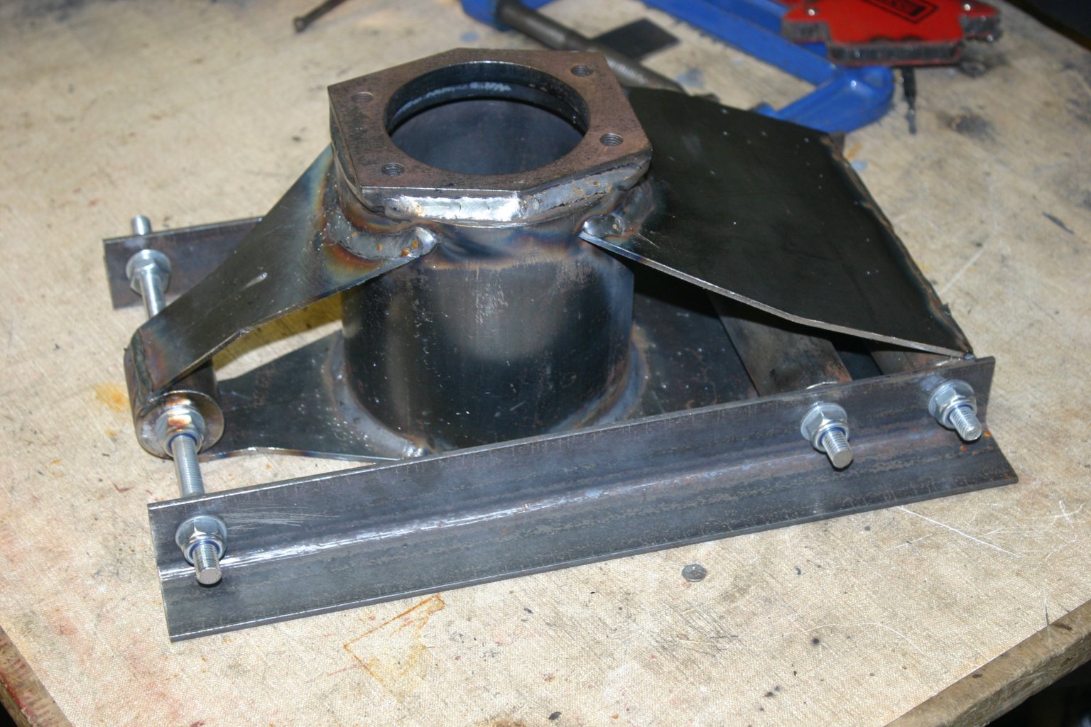

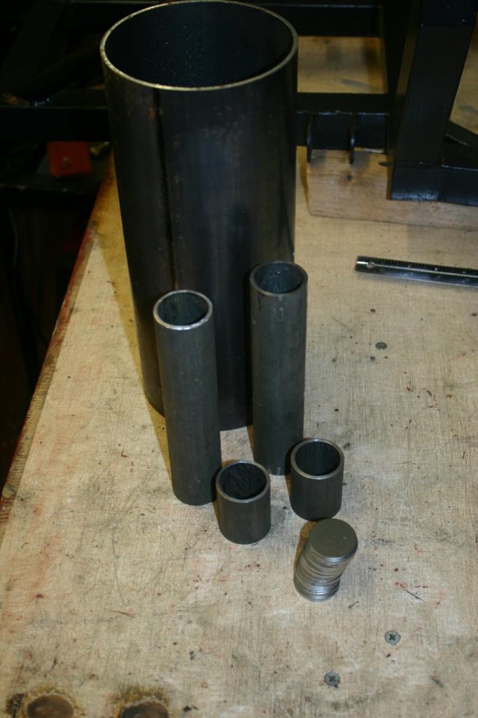

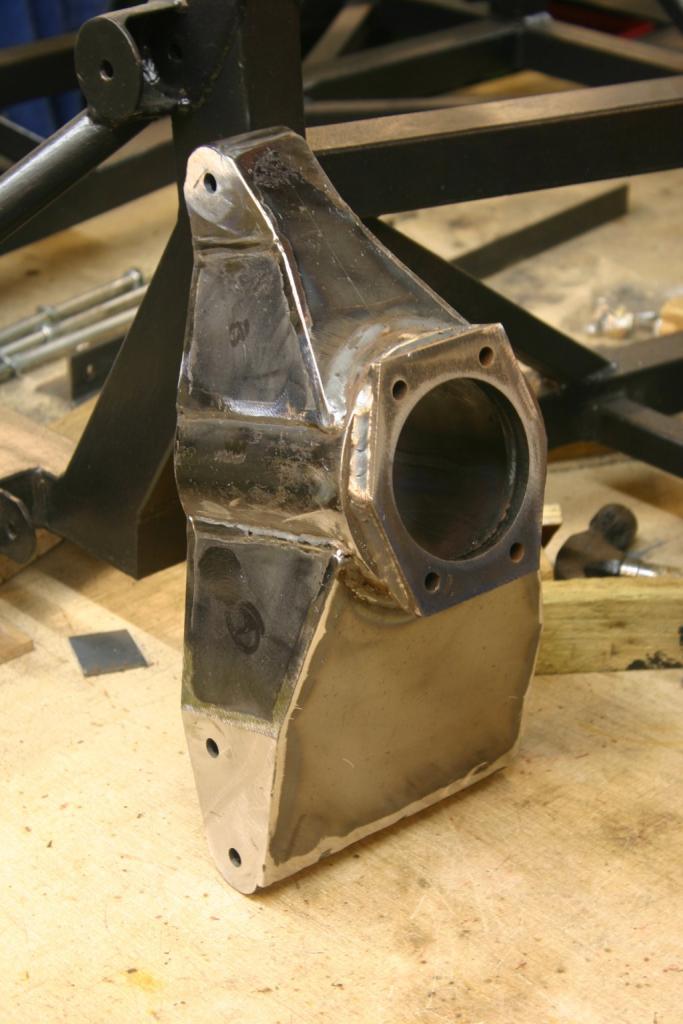

It's been a little while.... but I've fabricated the first rear upright. Hope the other side is a bit quicker!

NickD
Hi James,
That looks a fine piece of work. I had the luxury of being provided with the basic parts so all I had to do was fabricate it, welding up was still tough but you have gone one step further. Looks great.
Nick.
Nice work.
I keep finding the second side/version is better than the first. There are a couple of times I've gone back and re-made the first one because of it!
