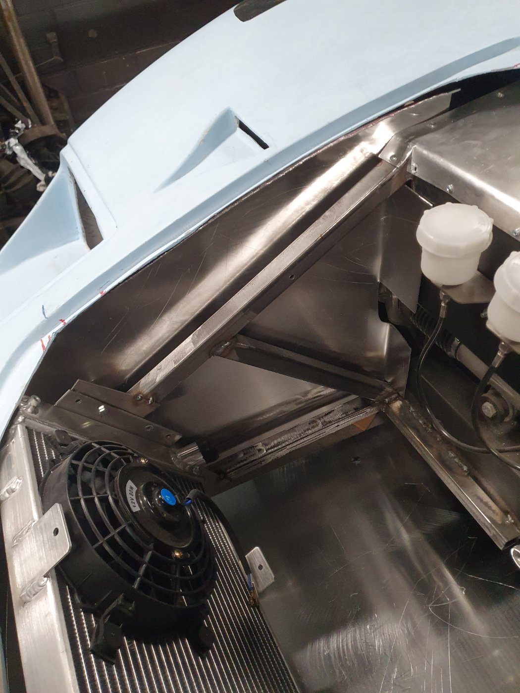

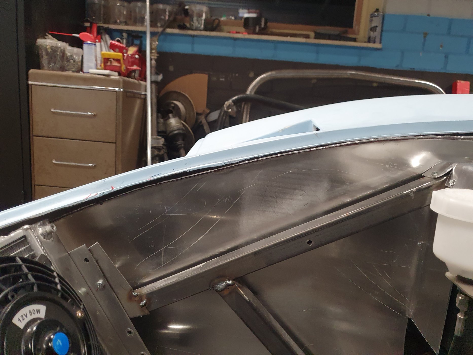

I was thinking about making front inner aluminium fenders. Started on the right side.
IT needs some trimming and bending here and therethw idea is to have it snug against the front clam with a rubber profile between it.
I was wondering why no one did this before.
Is there a curtain reason not to do that?

Nice work Frank. Don't know why, but I think I missed it before. Think it's time to look at your build thread from start to finish again.

Dr. Bob Wood also noted on his radiator research paper that there is cooling benefits to doing this as well to keep the air flow clean and directed back out the nostrils of the front hood. I am doing this as well for both reasons.

GTDs have this built into the front clam in fibre glass. It has never caused any issues on my car. Keeps the air flow from the raditor and the wheel arches separate. I also made a plate that sits in the nose section so airflow is chanelled into the radiator and could not spill down or side ways. Helps with cooling and reduces lift.

The GTD closure panels are separate panels like yours that fix to the front clam and you trim to fit. There is a foam strip between the clam and the chassis. In front of the radiator I have a flat panel to stop air hitting the radiator and then due to the radiator causing some flow resistance, pushing the air under the car. This panel really helps to pass air through the radiator instead of under the car. The headlight boxes in the front clam close off most of the side escape route.

Our front body has integrated fiberglass half-panels that extend to sealing areas on the front subframe.
