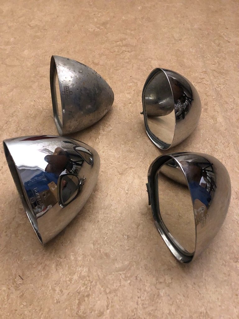

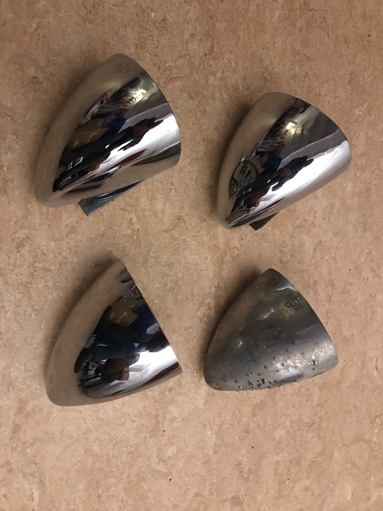

Also, I think the chrome bullet style mirrors are a nice looking option, but again, marginally functional. I have a new set that were delivered with my car, but I never installed them.

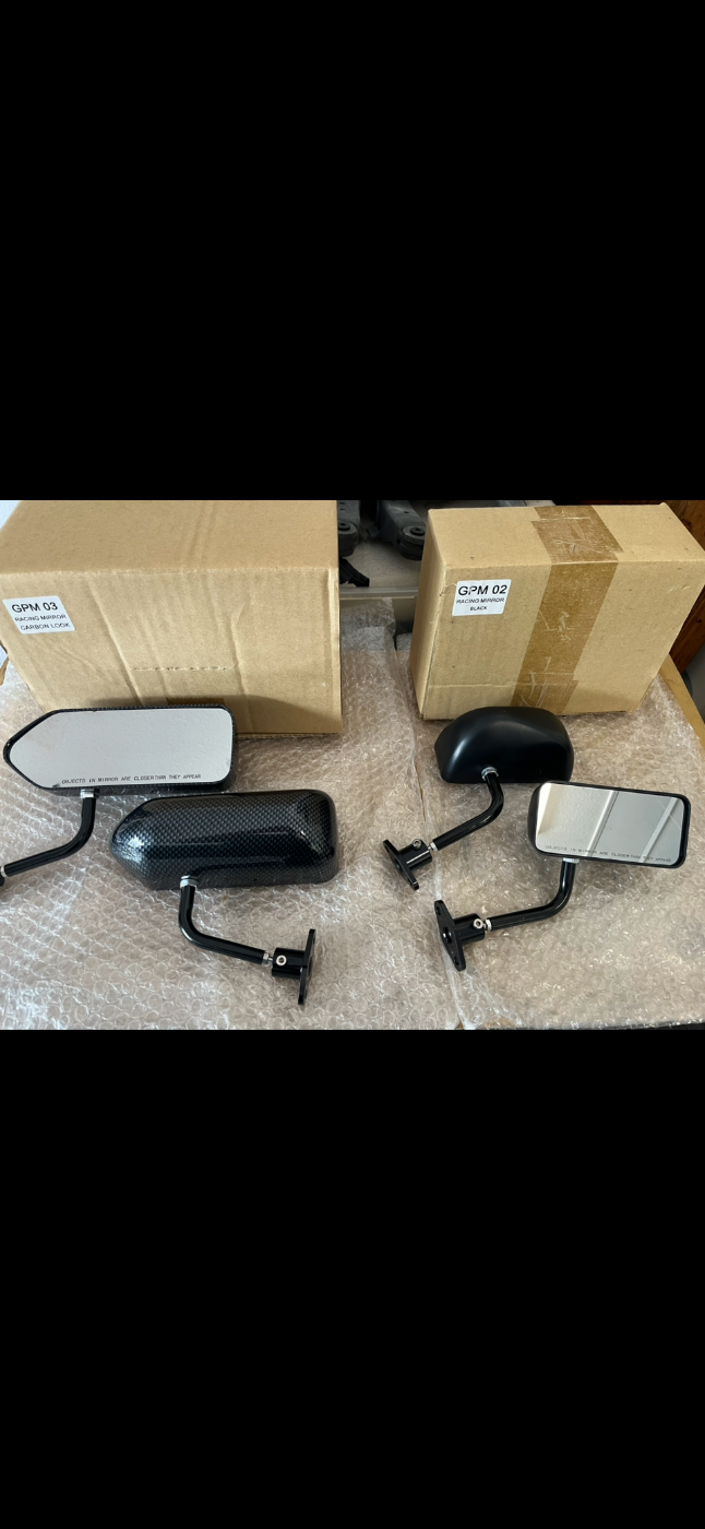

Some have seen the need for a backup/rear view camera, but I don't need that on my car. I can see pretty well between the exterior and interior mirrors. But I don't drive in heavy interstate traffic. Mostly track time or rural highways.

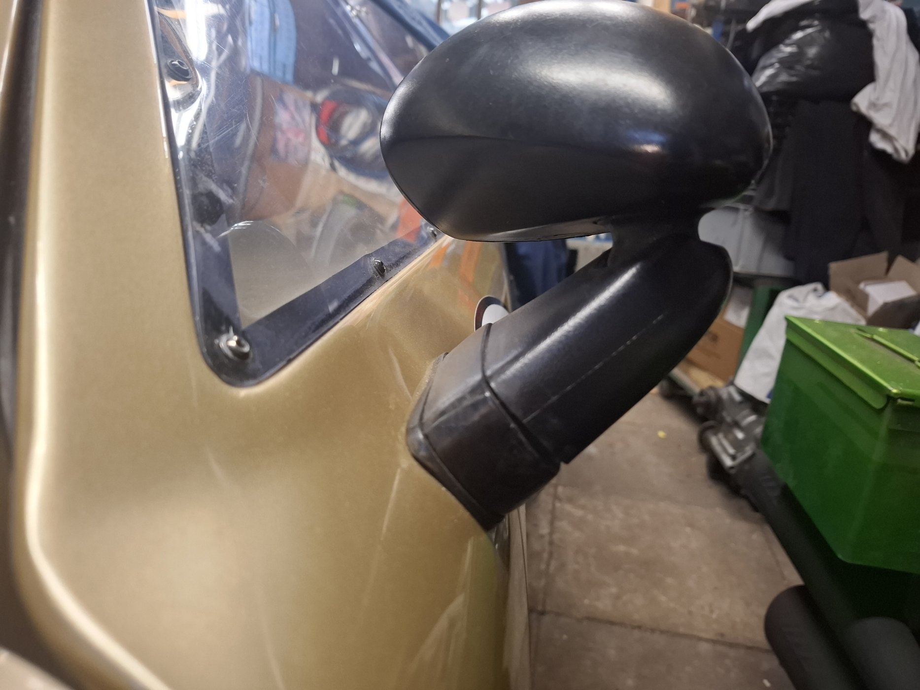

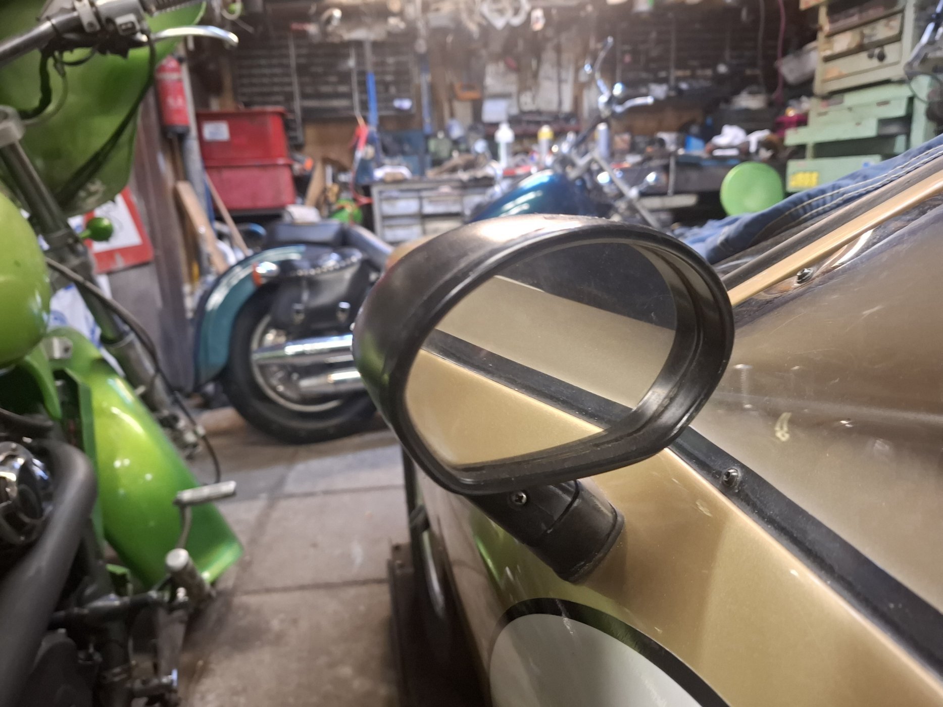

I am running classic Engelmann mirrors on my MK2.
Found also on many classic Opels like GT & Manta etc.
If Opel is the source than they also have a GM stamping.
Mine are without GM stamping.
My nearside mirror is spaced out as you can. see in the pictures.
Sight is very good with these. Way better then the Sebring Vitalony I tried before.

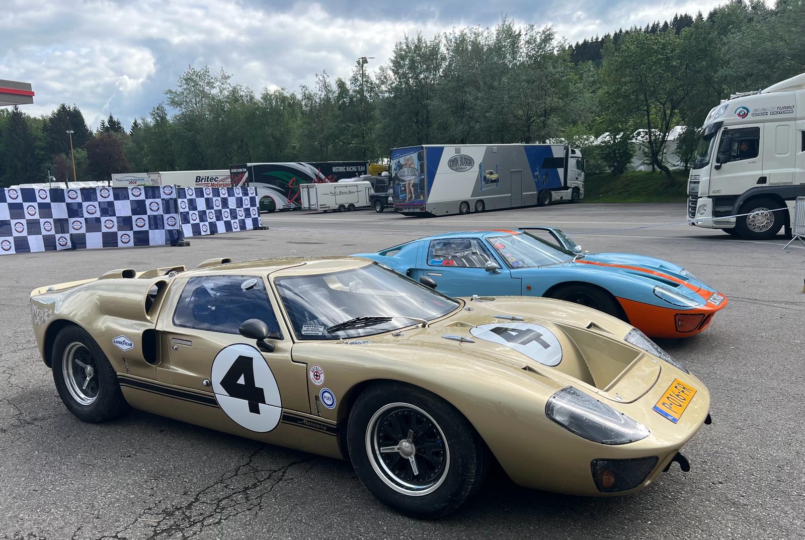

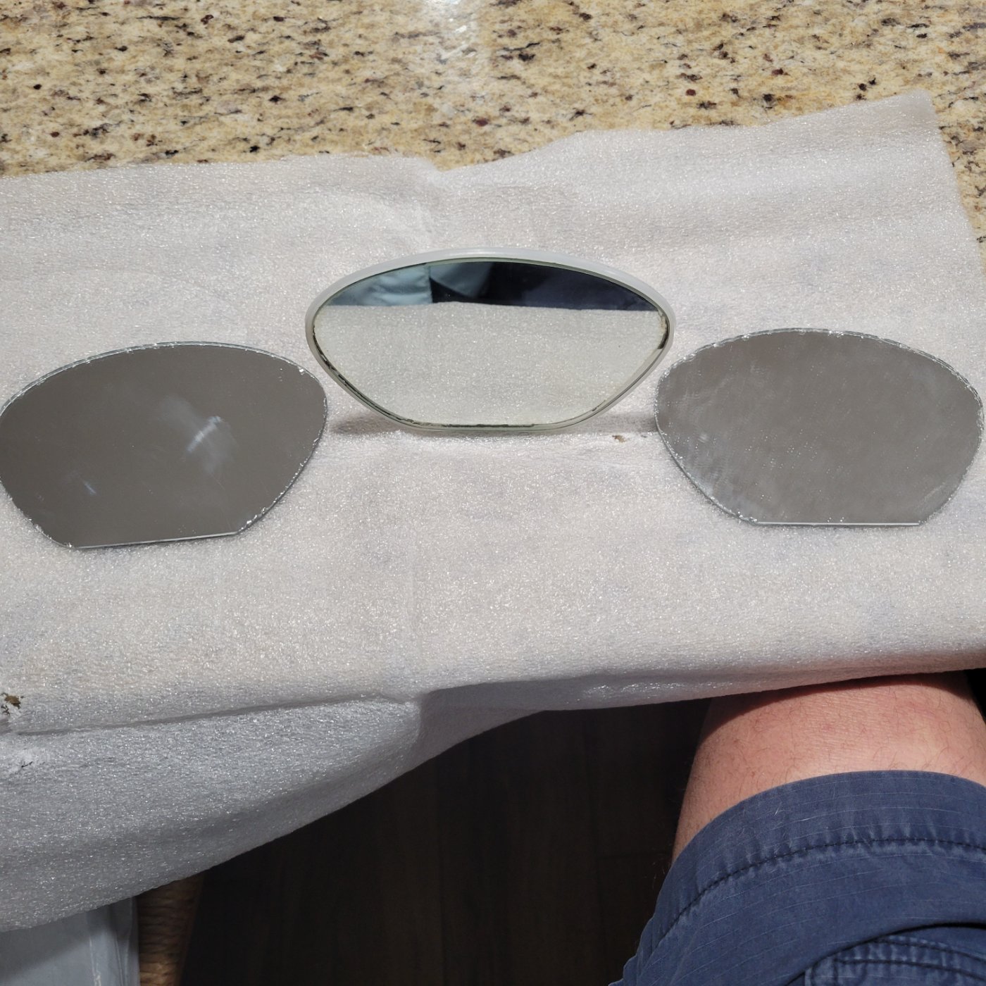

I have three sets of original metal with Sebring logos. One set was painted and I painted them in Gulf Blue. The glass was poor so I bought two blanks of Convex mirror and cut new pieces. Still sanding edges of Convex but should make for better view and coverage.

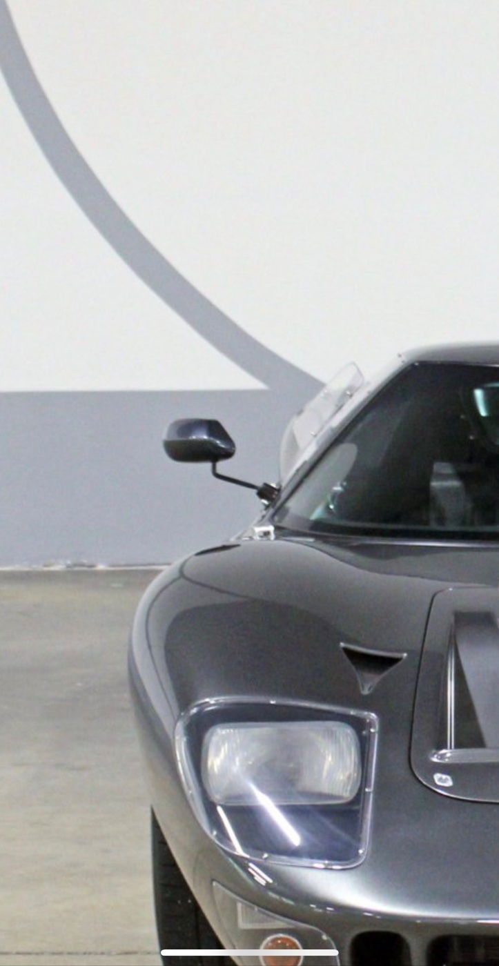

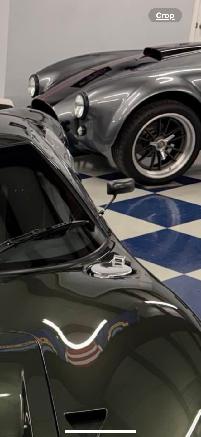

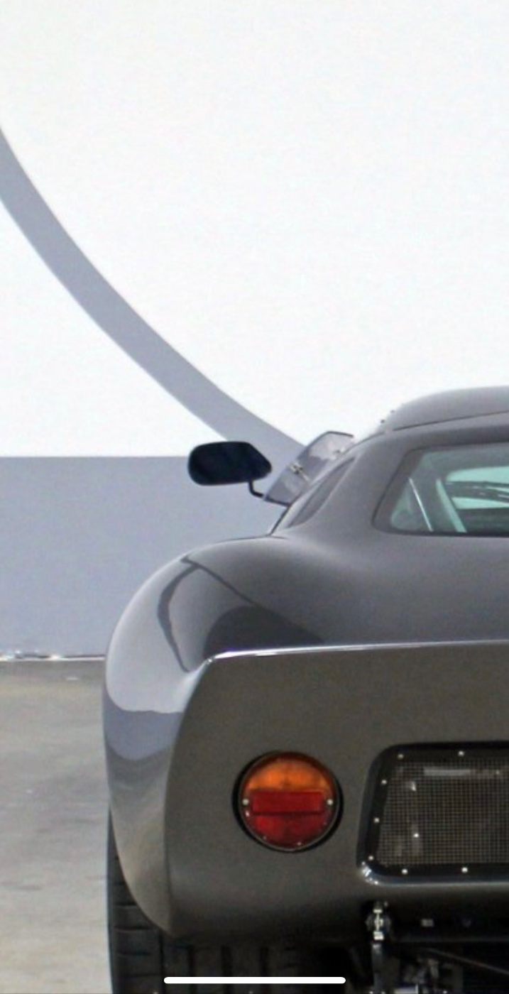

Hello-
Anyone know what this mirror is? Mine are similar to this, but with a smaller/ shorter stem.
Thank you!
RG
