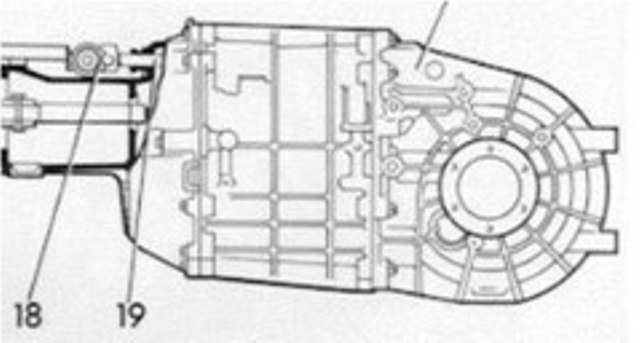

Transaxle Mounting
The 016 transaxle is mounted through insulators attached to a cross member on the body. The late cars have the crossmember mounted to the transaxle with an insulator and the crossmember is mounted to the body. The G31 is mounted to two beams extending from the trailing arm inner mounts. Instead of hanging from the mounts, it sits on the mounts.
<DIR><DIR><DIR><DIR>G31 mounting

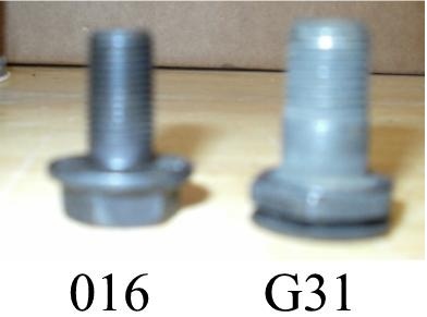

Ring Gears and Attaching Bolts
The ring gear is 7.875" in diameter on the G31. This is the same size as the 915 ring gear. The 016/083 ring gear is 7.1875" in diameter and the cross section is much smaller than the G31. The 944 turbo has a 7.4875" ring gear. The G31 ring gear is attached with twelve 12mm x 1.0 bolts. The 016/083 ring gear is held on with ten 8mm x 1.0 bolts.
