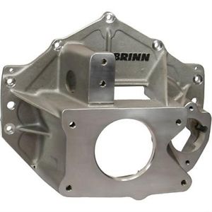

I would have thought it easier to stay with the starter/flywheel up front using a custom made bellhousing or adaptor plate for rear entry starter like the nascar boys use then go torque tube to a manual 928 porsche box . Just thoughts.
Sid

That's not a bad idea, I hadn't seen a bell housing like that before. An adaptor plate on the Ferrari block and that bell, then you can use a standard rwd trans without a transaxle.

I don't think that idea will work looking more into those bell housings. Those are for dirt track cars. They don't use conventional transmissions with clutches. There's no way to use a clutch in it. Maybe use that idea, getting a full custom bell made, but I think that'd be more work and WAY more expense than just using a rear mount transaxle.
