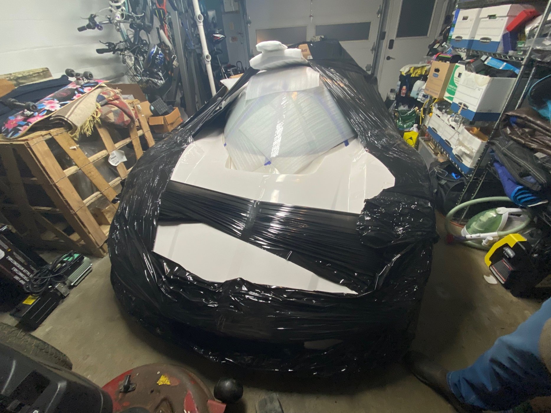

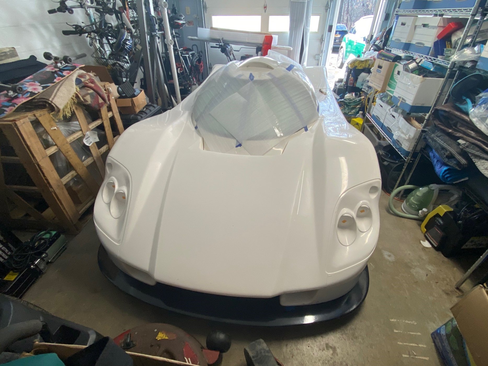

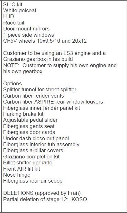

Ordered 3/10/22, got notified in November '23 it would be finished last week of November-ish, got it delivered 12/7/23. Just shy of 1 year, 9 months from deposit to delivery. Attached are the order specs and the first pics at its new home.

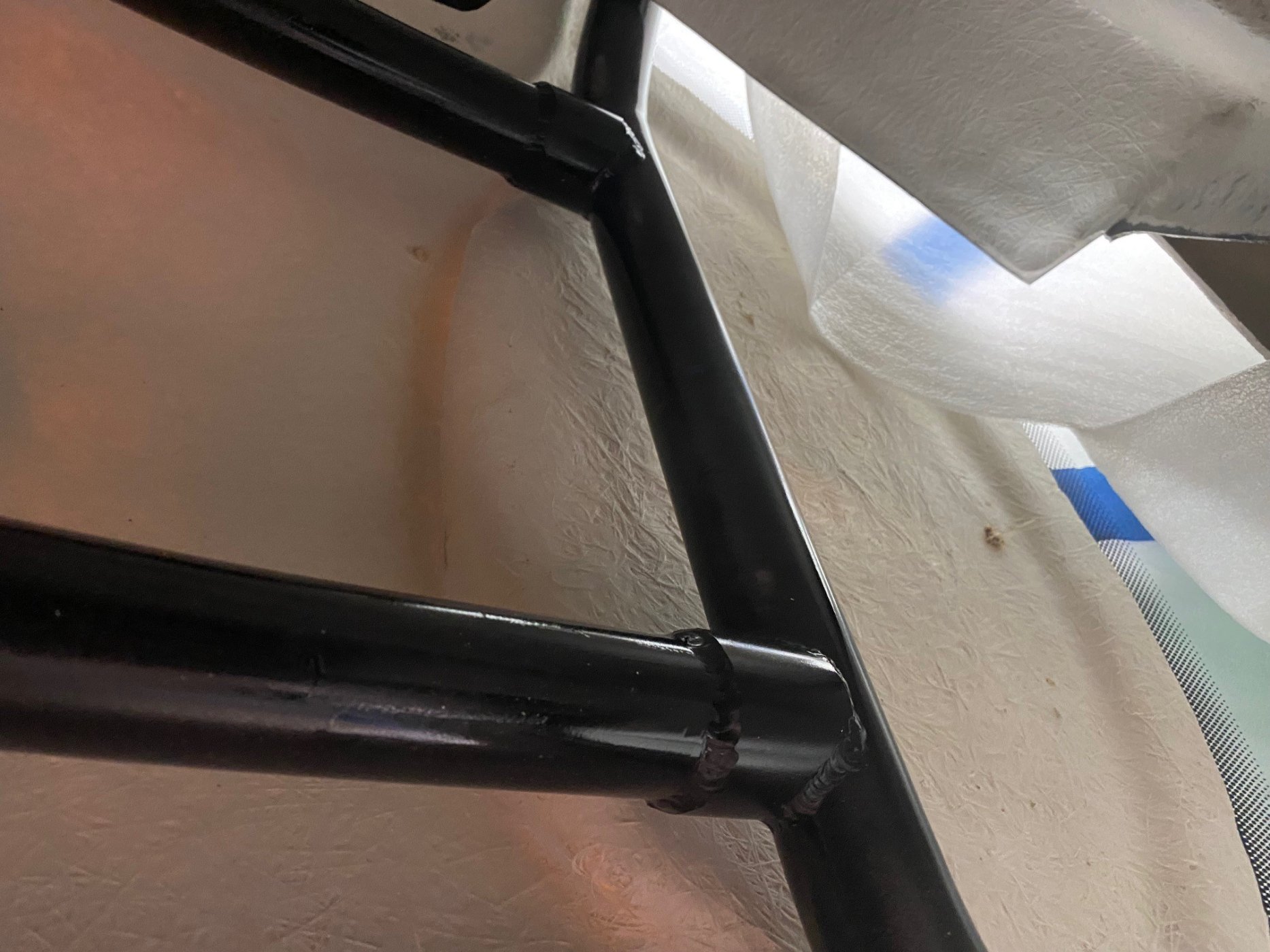

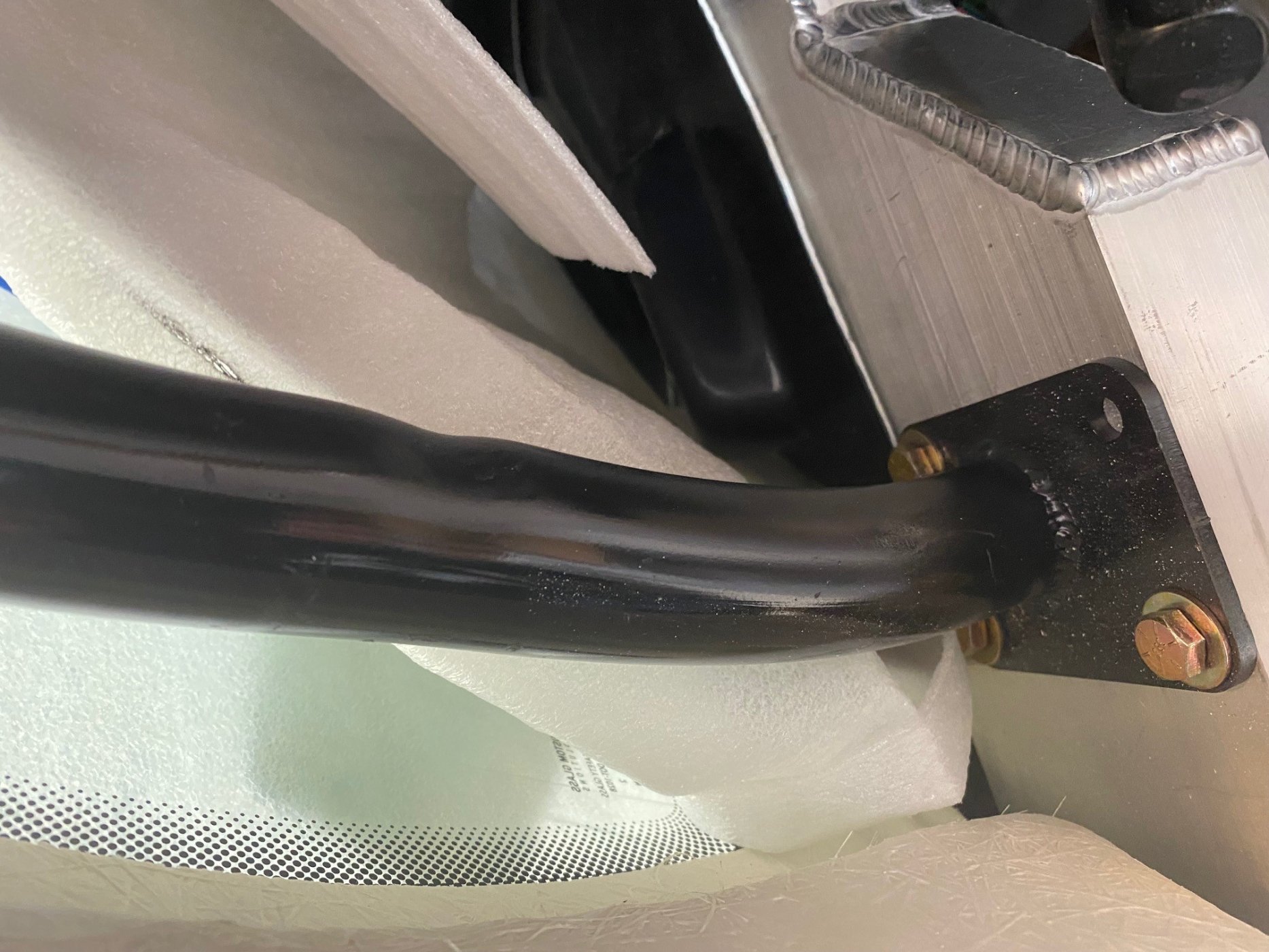

Already have a question for those of you who have recently received a car. The roll cage does not look like the ones I'm used to seeing in the other build threads - those are smoothly curved, no expansion welded ends. Wondering if this is a new thing. The one I have...is different. Also, the bend towards the bottom of both A-pillars is pretty sketch, like it got bent too far and bent back again. I was already thinking of re-doing the front hoop because this one shipped with the hoop not matching the body curve, but the warped curve makes it look like a must-do.

Congrats on receiving your kit Jeff! That’s an interesting mod of the front roll hoop, best to check with Bill on the purpose behind the mod.

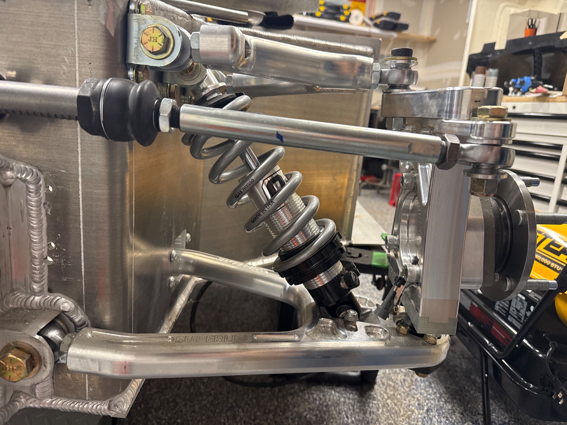

The front lift kit arrived the other day, I got around to checking it out. It’s from Stanceparts, looks pretty solid. However, it’s got a big air tank that will be fun to try to hide. Anyone switched to the tankless version? Also, no ride height sensors seem to be available for the kit, so it sounds like you just ride with the cup bottomed out as your preferred front suspension height? Wouldn’t mind having all 4 corners have adjustability, but with no way to tell what height you’re running it seems to not have any practical benefit.
Scott
Jeff, Pnut installed a pneumatic lift system and used a tank that was much smaller than what was included in the kit. He only has pucks in the nose, so you'd likely need to double the size that he had. IMO, you only need enough capacity to do a single lift. Most available tanks will be cylindrical, but you could go with a different shape so long as you had a professional design and fabricate it. IMO lift pucks in the rear are a bit of a challenge. I can't think of anyone who had done it -- someone will likely correct me. IMO there isn't enough travel in the rear which is why many builders are running really high spring rates. Pucks will force you to shorter springs which may become coil bound.
As far as I know no one has yet implemented the ability to dynamically adjust ride (as opposed to lift the car over a bump) on a SLC. In addition to sensors (likely linear potentiometers) on each corner, you'd need an electromechanical valve at each corner driven by an intelligent controller with a PID to prevent hunting around the target height. In addition, if you don't change the wheel rate, you're going to need to run a spring rate that's high enough for the lowest height that you'll drive the car at. That's going to make the ride harsher than it needs to be at the highest height that you'd drive at.
I know that Bob who is building an electric SLC is in the process of doing exactly that using electric actuators. To accomplish this, he designed new rockers in the rear, implemented a pushrod suspension in the front, added a linear potentiometer to each corner amongst many other changes. Once done, he'll need to write code to manage it all.
I currently have Penske dampers and RamLift Pro hydraulic pucks in the nose. I'm planning on replacing the Penskes with TractTiv active dampers with engineered rubber bump stops. Both front and rear dampers will be longer than stock which provides more travel, but requires new brackets to be machined. The lift pucks in front will be replaced with a custom hydraulic solution that replaces the eyelet at the top of the shock. This ensures that the added weight is sprung and it allows me to use standard-length springs. These changes will allow lower spring rates to be used and a more comfortable ride.
I will then have an automated way to switch between street and track modes. The damper anti-roll, anti-dive and anti-squat will be set via CAN Bus. Ride height and wheel rate are more complicated. New rockers will be machined. They will contain a hydraulic ram that moves the location of the damper's eyelet from a 1.5:1 street ratio to a 1:1 track ratio (stock ratio is 2:1). Since the front isn't push rod based, the front sway bar will be preloaded with a hydraulic ram. Using this approach, the wheel rate increases when the ride height decreases which allows a lower weight spring to be used.
So, I'll have two ride heights and it's a lot of work to make it happen. Unless you're going to real-time, fully-active ride height like Bob, I don't see much utility in arbitrarily adjustable ride height.
Joel K
Jeff,
To Scott’s point you could get a 1/2 gallon tank and tuck that in the passenger footwell. It’s about 6”x6”x7”. Stanceparts also makes a higher capacity pump to be used w/o a tank.
If you read the Stanceparts FAQ, the system is not designed to drive while the suspension is raised. It’s mainly used to avoid scraping on speed bumps.
IMO, one of the advantages of Stanceparts over the Ramliftpro(the older RCR recommended system which I have) is that you may be able to use the stock spring since the Stanceparts cups collapse down to less than an inch. I think the Ramliftpro are about 3 inches.
Scott
If the air cups take 2/3 less space than the RamLift cups on the dampers, you'll be able to solve the front no problem and they might make the rear feasible.
Thank you both for the insight. I knew the rear spring setup was tight, but didn’t think the addition of the cups would be that detrimental. Looks like it would be. I did a deep dive and active suspension would need more knowledge and skill to install than I’m capable of at this time. Joel, I didn’t see the FAQ, but that definitely answers the question. I’ll be looking for a smaller tank, the included one is huge for only occasional use.
If you don't use a tank, you'll have the same problem as the old Ramlift product, which is that it takes several (like 7-9) seconds to extend fully. With the Staceparts unit, and a 1-gallon tank, my SLC was able to lift up fully in about 1-2 seconds- a big improvement. The new setup also allows the standard length springs, so using 4-inch springs is no longer necessary.
You likely don't need them in the rear, as the SLC has a really good departure angle.
And, as others have pointed out, it's supposed to be used to go over speed bumps, not as a street/track height adjuster, as the alignment changes would be too extreme to drive on at speed when fully extended.
