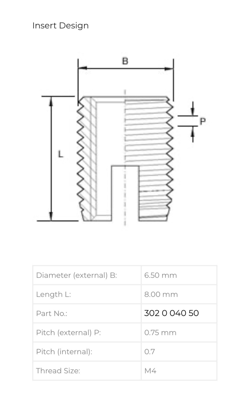

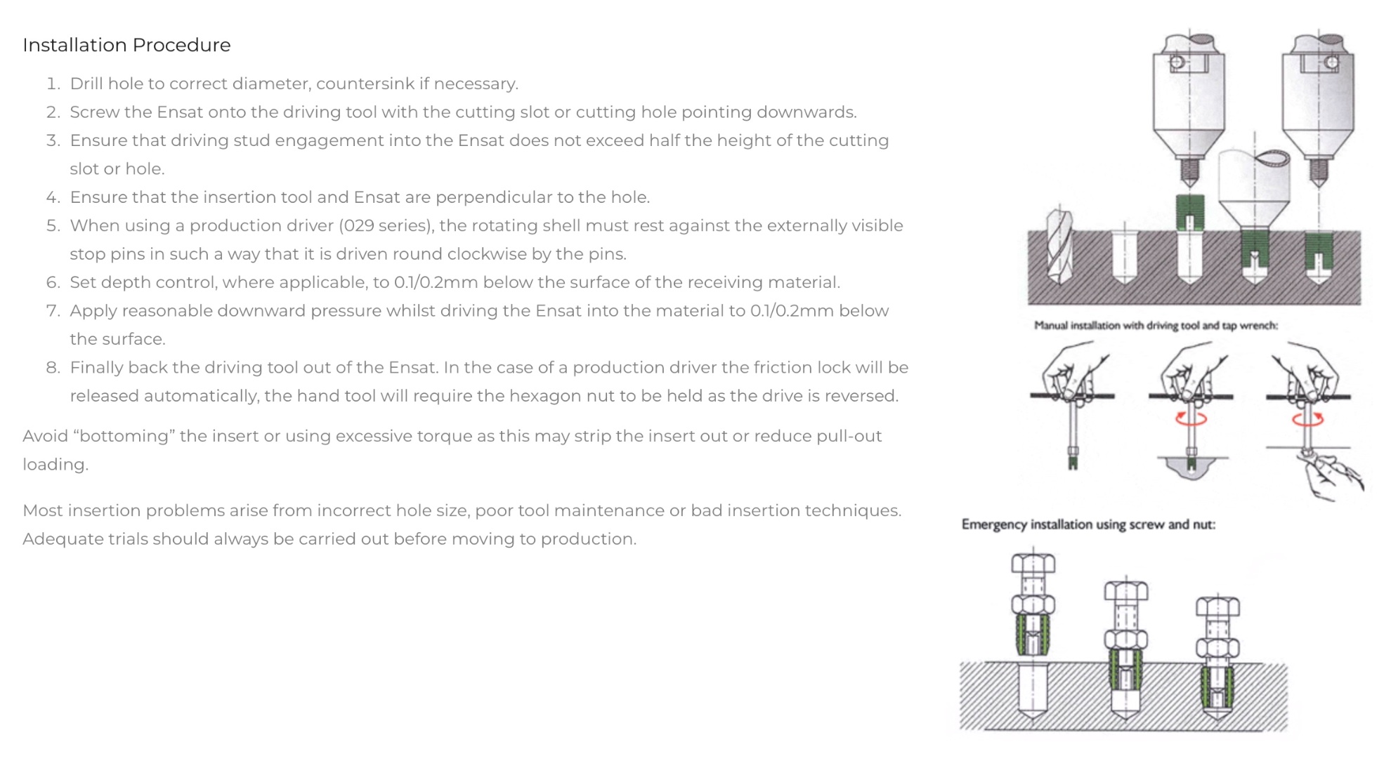

I used the M4 x 0.75mm inserts and bolt and nut to install as per below.

View attachment 145180View attachment 145181
Exactly as i have planned right now.

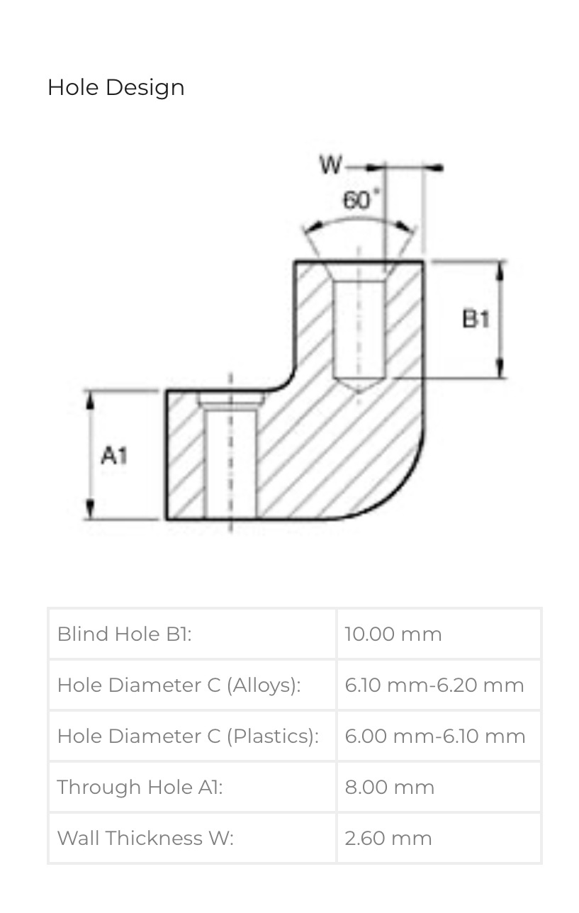

I couldn't find a table for glasfibre body drill diameter though. Metals etc. are listed, but not plastics.
What diameter did you drill for? I was thinking of going about 5,5mm to get a tight grip for the outer threads, but might be to tight and end up cracking the body instead.

Don’t remember the actual size I used, but found this online. 6.0 - 6.1mm
Try 5.5 & 6mm in a scrap piece of fibreglass and see how it feels.
