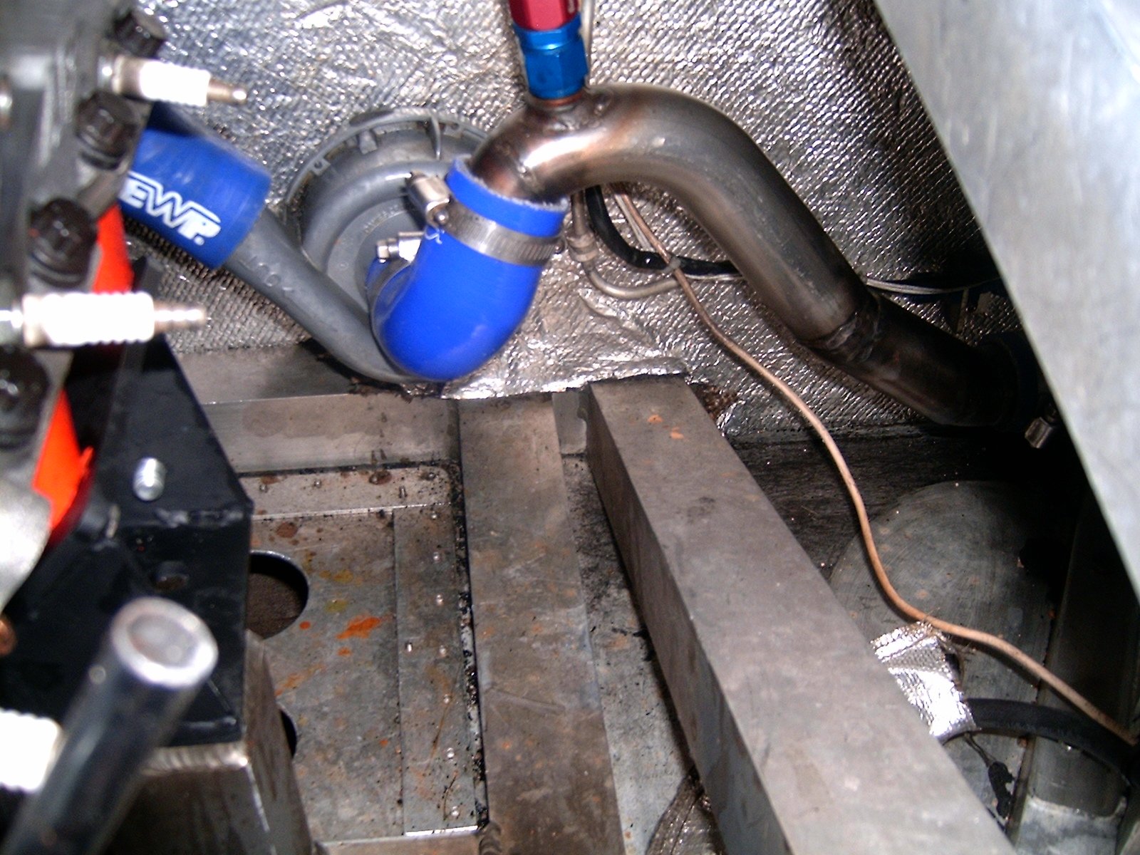

The picture below shows the pump attached directly to the engine coolant manifold that replaces the mechanical pump in my SLC. The left side is the engine inlet, the curvy pipe is the return from the cold side of the radiator, and the AN fitting is the expansion tank inlet hose attachment point that goes to the bottom of the expansion tank.

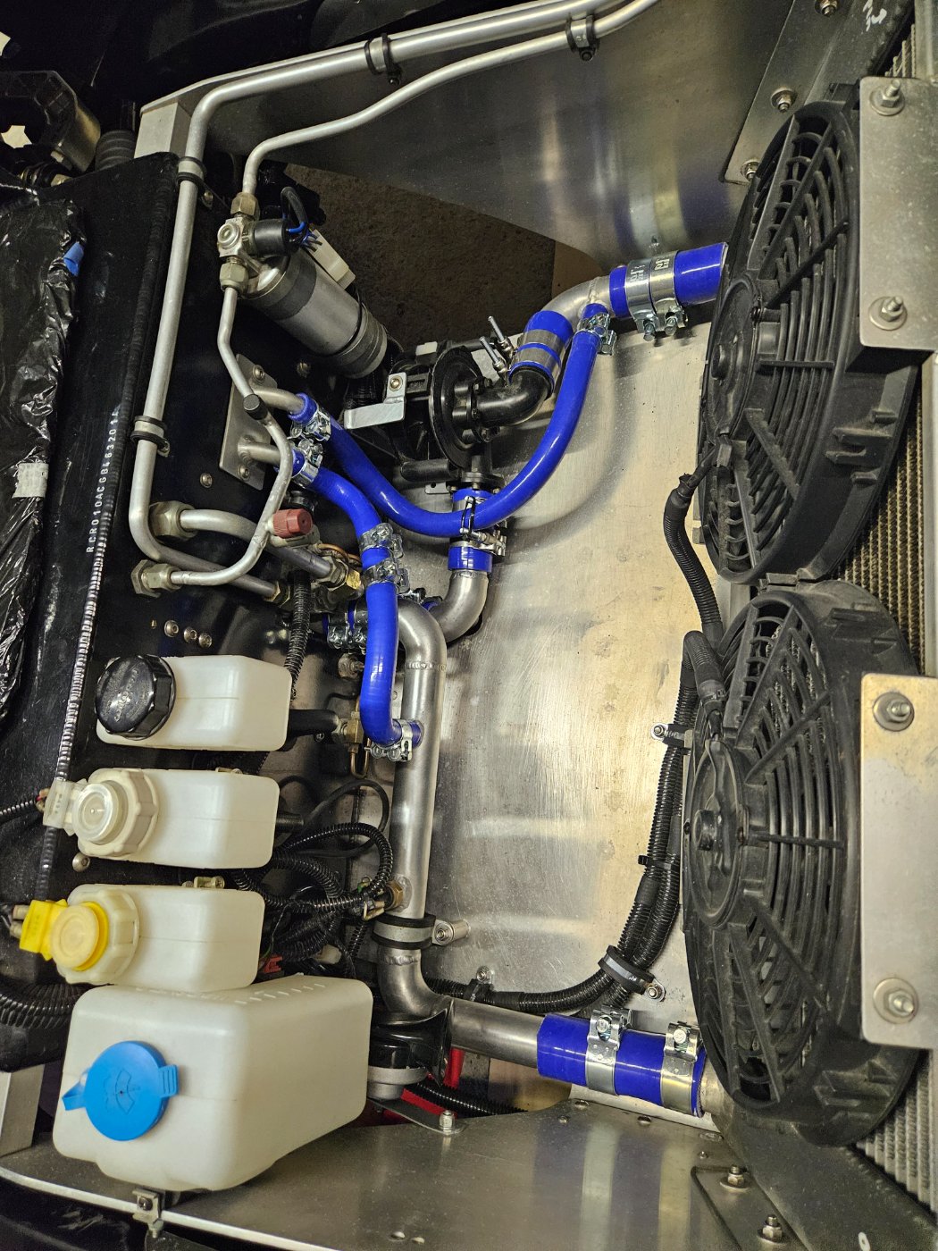

I have my second pump installed just after the radiator, but at this stage, I am still in the rebuilt phase, I cannot tell you if it is efficient or not.

Jean, I was wondering how you are controlling the pumps? Do you run them both full-on all the time, one full-on and the other controlled by the DC electronic controller, or a different controller on each pump? Do you run a DC controller or another electronic controller type?
The WSC prototypes run their 2 electric water pumps, one in the front and one in the back, full on all the time. But then the car is making full power all the time.
Youre the first guy to do this that I know of on a self built car like ours. It will be interesting. As a data point for you. My SLC engine makes about 550HP and uses one Davies Craing 150 pump with their controller. It runs rock solid at the set temp all day on track in Texas on a 105F day. I do also have a lot of oil cooling and I bet that helps a lot.
Howard, The electric pump is controled by a switch that the pilote shall move when he estimate that the temperature is going to high, it is the comment of the previous owner and at this time, I did not experiment the engine. I add that my engine is a Dart 363 equiped with a mechanical water pump and that give 550 to 600hp.
I am not in favor of to much electronic control, especially on such car. May be you may drive the car in a initial period with a switch on the board and when you will know more on how the machine behave, you may add some electronic control.
