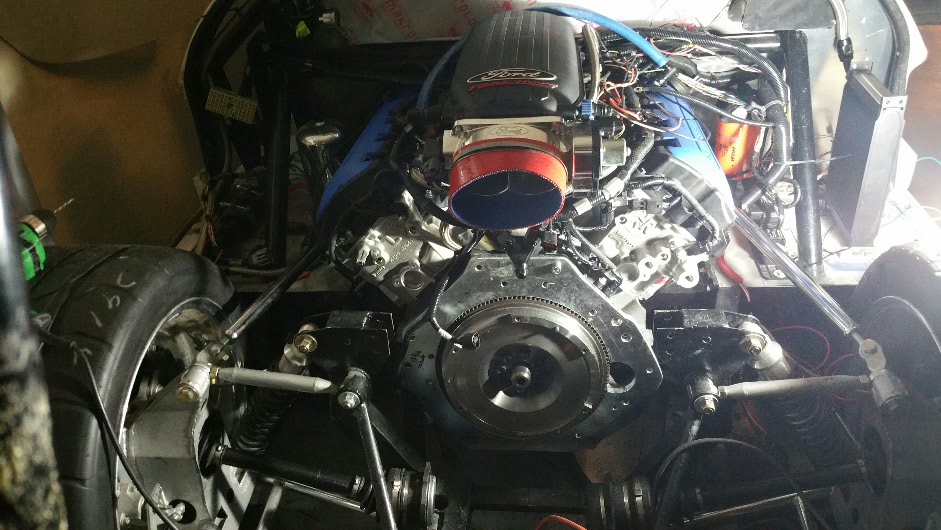

Thanks again guys. More tweaks to the mounts were needed but now all is good with them. The engine is back out of the car so the final wiring can be done then it will go back in "permanently" (I hope).

Well, a CAD drawing, third party fabrication, several tweaks locally and then final welding, and the mounts are done and installed along with the engine.
Now it's a bundle of wires and header fabrication to contend with. Mandrel bends are in. Guess that's next then.

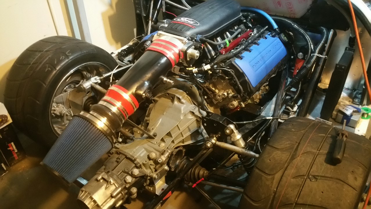

Engine in place. Working on fabricating the headers now. Just finished up the intake setup sans one hose clamp I have on order. Had to hand fabricate it. Not the most beautiful thing, but it should perform very well albeit it might be a bit noisy.

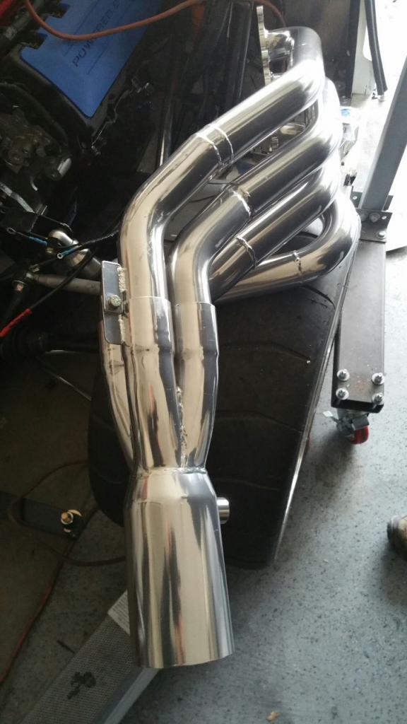

Headers are now being TIG welded. Here they are tacked up. Took a very long time to complete them. After the welding, they will go get ceramic coated, then wrapped (in Ford Blue).
They ended up being 1-7/8" mandrel bent primaries going to a collector that necks to 2.75" and then expands out to about 3.25" (a venture). I'm working on the exhaust now. It will be using a custom built X-pipe muffler short enough to fit.
Shout out to A&E Automotive who really, really, came though and helped out with the fabrication of the headers and will be welding them up.

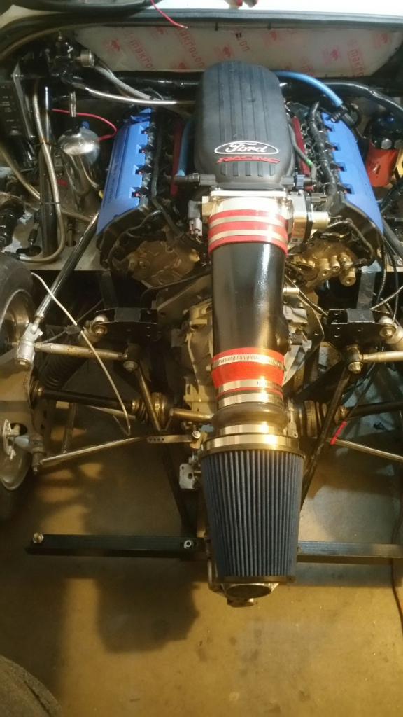

While the headers are being welded, I thought I'd mock some things up to see how things fit. Looks likes there is just enough room for the X-pipe muffler.
The engine and transaxle ended up being lowered about 1/2" to get it to fit. I'm planning to relocate the oil cooler to the left (driver's side here in the US) of the intake where others have done to reduce the line length 30% or more. Will probably route the right side vent to a yet to be fabricated air box and the left side to the oil cooler.

Darrin, how about to split the intake in two - reroute under the hatch glass and get dense air and not air from the hottest spot....
(I know you have plenty on your plate - but that gives you a few ponies more and a better gas mileage) :idea:
I have thought about this, or just routing to one side (once I move the oil cooler to the rear, the passenger side right behind the inlet vent is WIDE open and could make a great spot).
I'm debating between doing one of those options (split, or to the passenger side) or just doing some duct work to route air in from the side vents into an air box that will have the top and sides mounted onto the rear clam shell and the bottom under the intake.
Either way a good bit of work, but I'm thinking this would be the easier to do and get the correct data to the computer from the single MAF sensor.

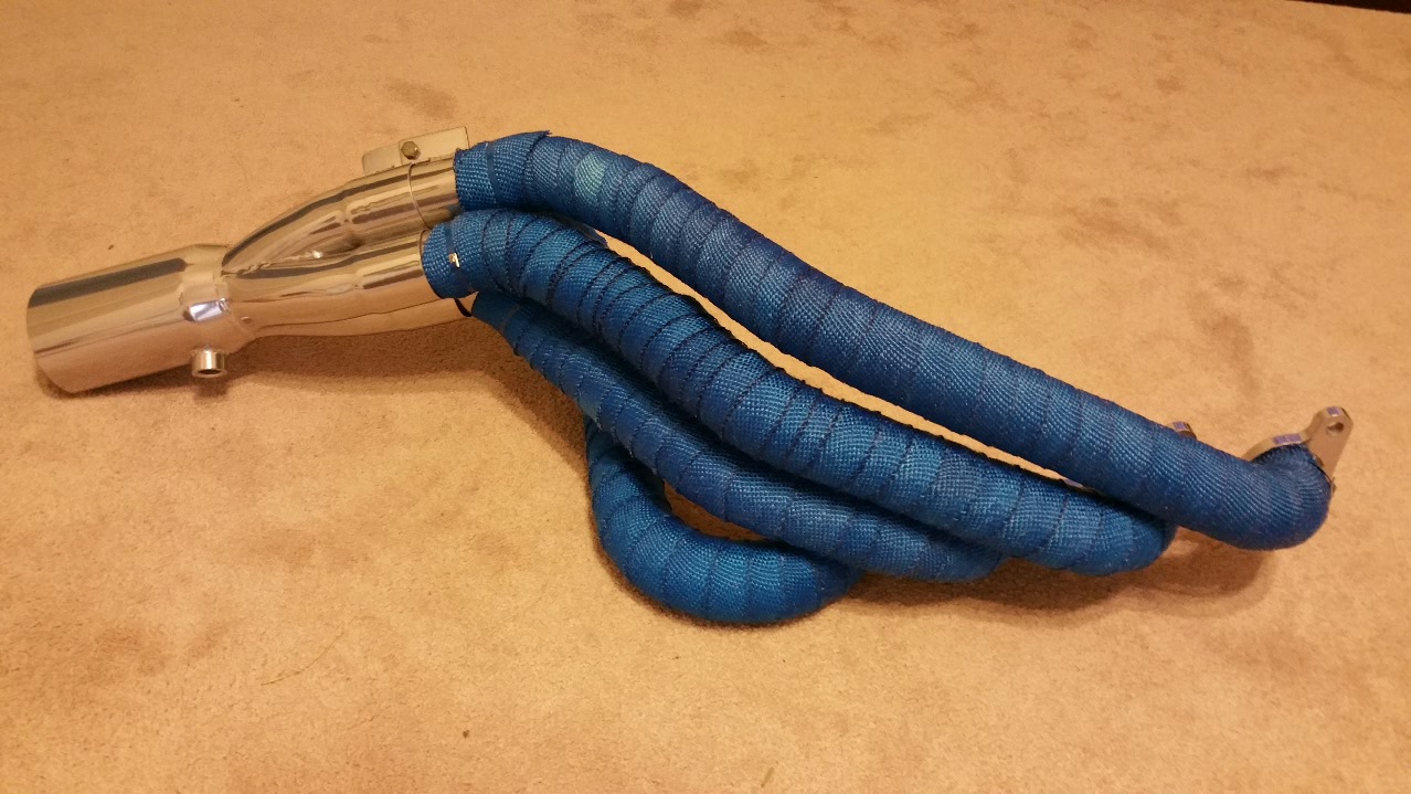

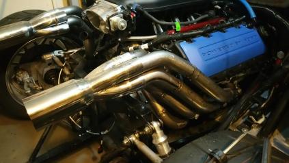

Headers back from the ceramic coating shop. Great result for the money.
Have them wrapped, high temp sealant applied, and ready to install now. They barely fit. Have to insert a couple of the studs into the flange before slide them in due to space limitations.
