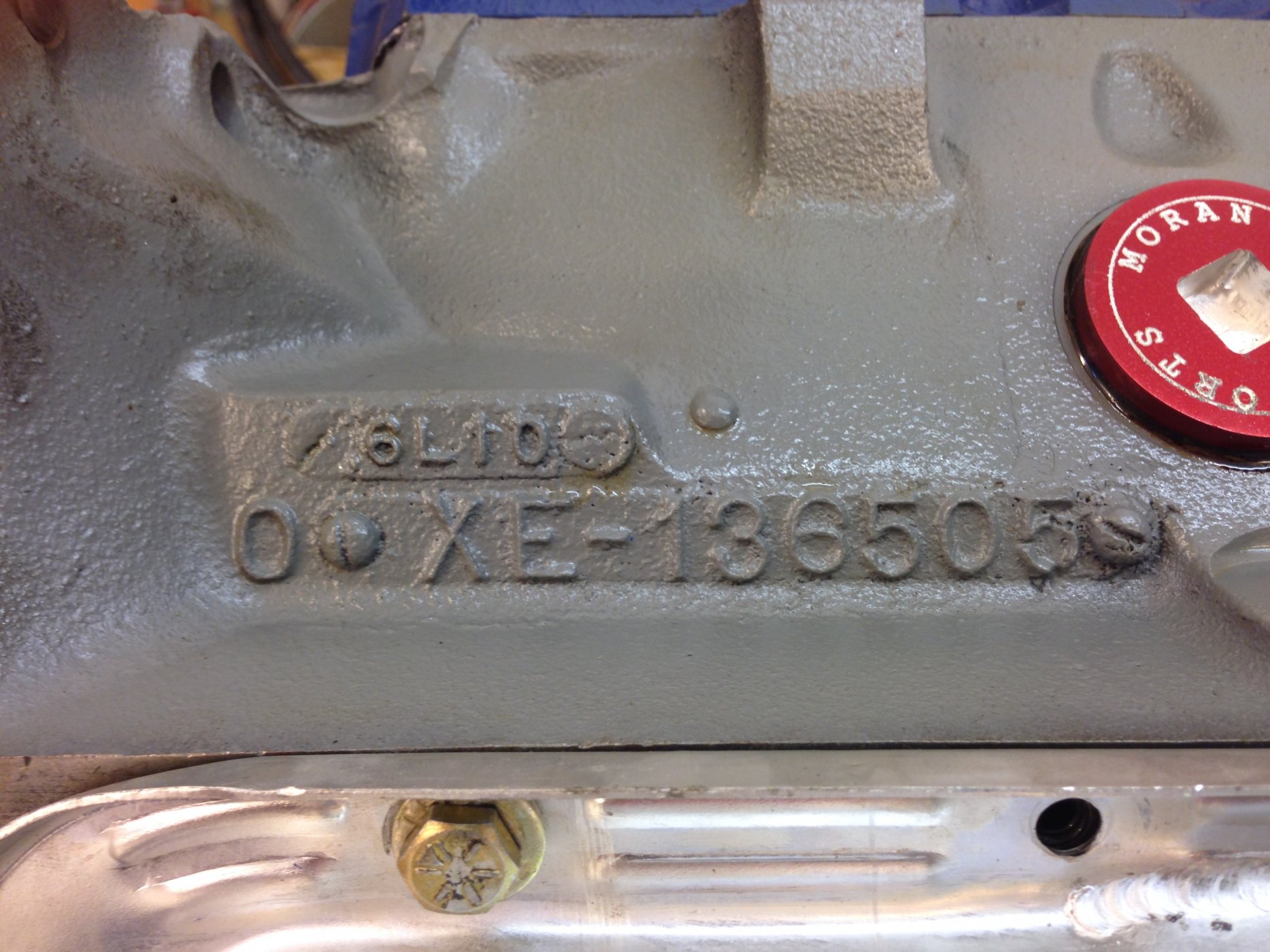

Boss 302 block will likely have valve clearance notch at top of bore, check your casting numbers to identify, if so be sure to check position of top ring to ensure it is below that notch at TDC. Given the description I think your Block might be a pre Boss 'X' casting for use with Windsor style heads only .
Agree with Jac, it is most likely that the engine supplied by Mathwall is from the same batch of 4-bolt racing motors as my own.
The block is an "XE" numbered - pre Boss type and has "289" cast markings .
I added the screw in freeze plugs which were later additions to the Boss 302 spec.
This engine was originally supplied with Gurney Weslake heads according to the Mathwall build sheet.
