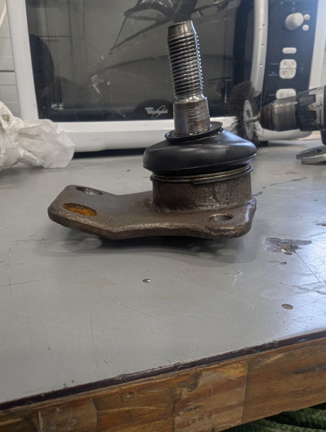

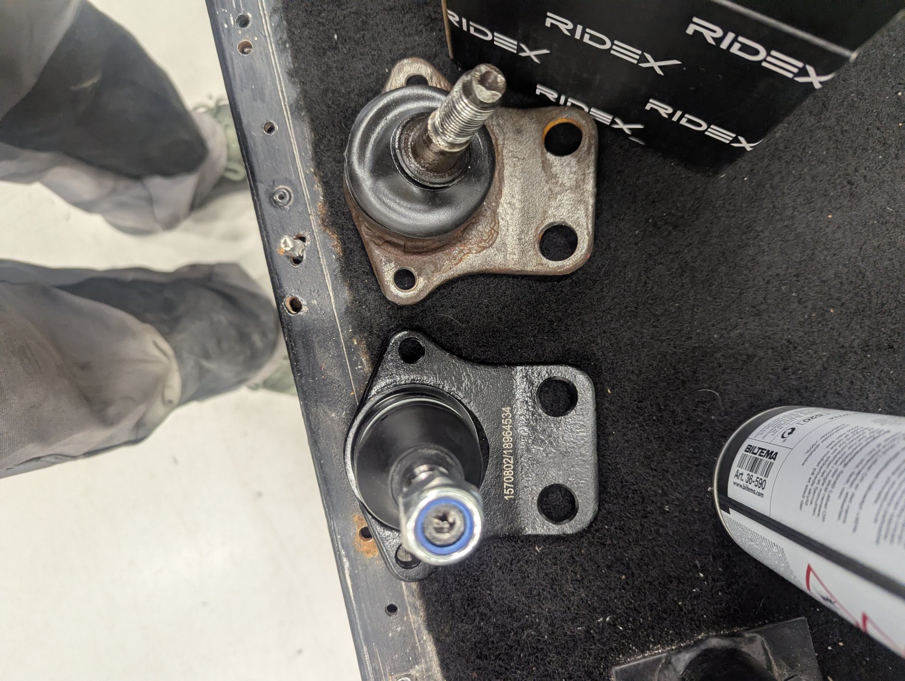

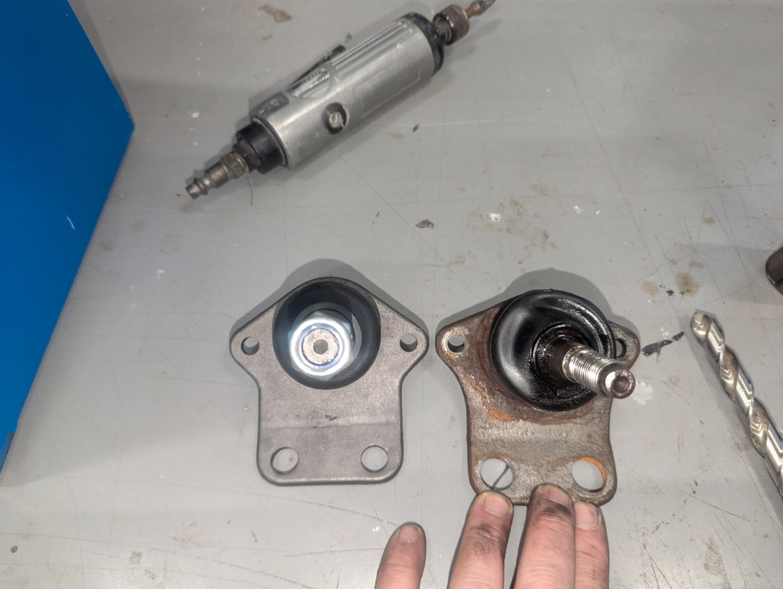

The picture below shows the part received and the old part:
Can any of you point me in the tight direction, or by chance have any suggestions on who to contact to find the correct part.

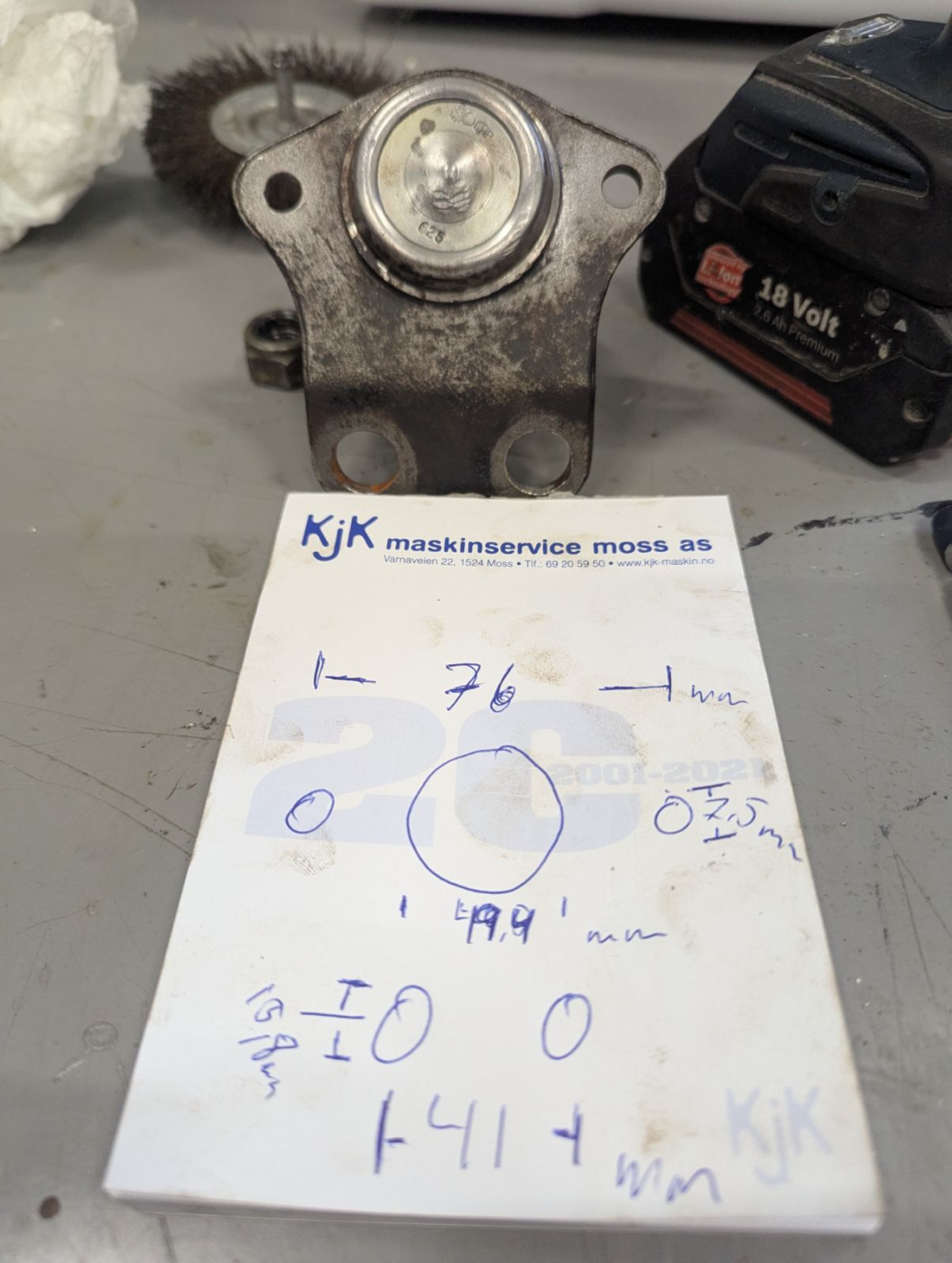

The smaller holes need to be above the vertical centerline of the joint. And the larger holes also need to be larger in diameter.

I have now mounted the new ball joint - and the one from the Ford Corina mk3-5 / Taunus, as referenced above, fits my GTD perfectly.
The Granada mk2 lower ball joint, as suggested above, does not have the same bolt pattern/location to fit my suspension arms.
Maybe mine have
been modified at some point. I do not know.
