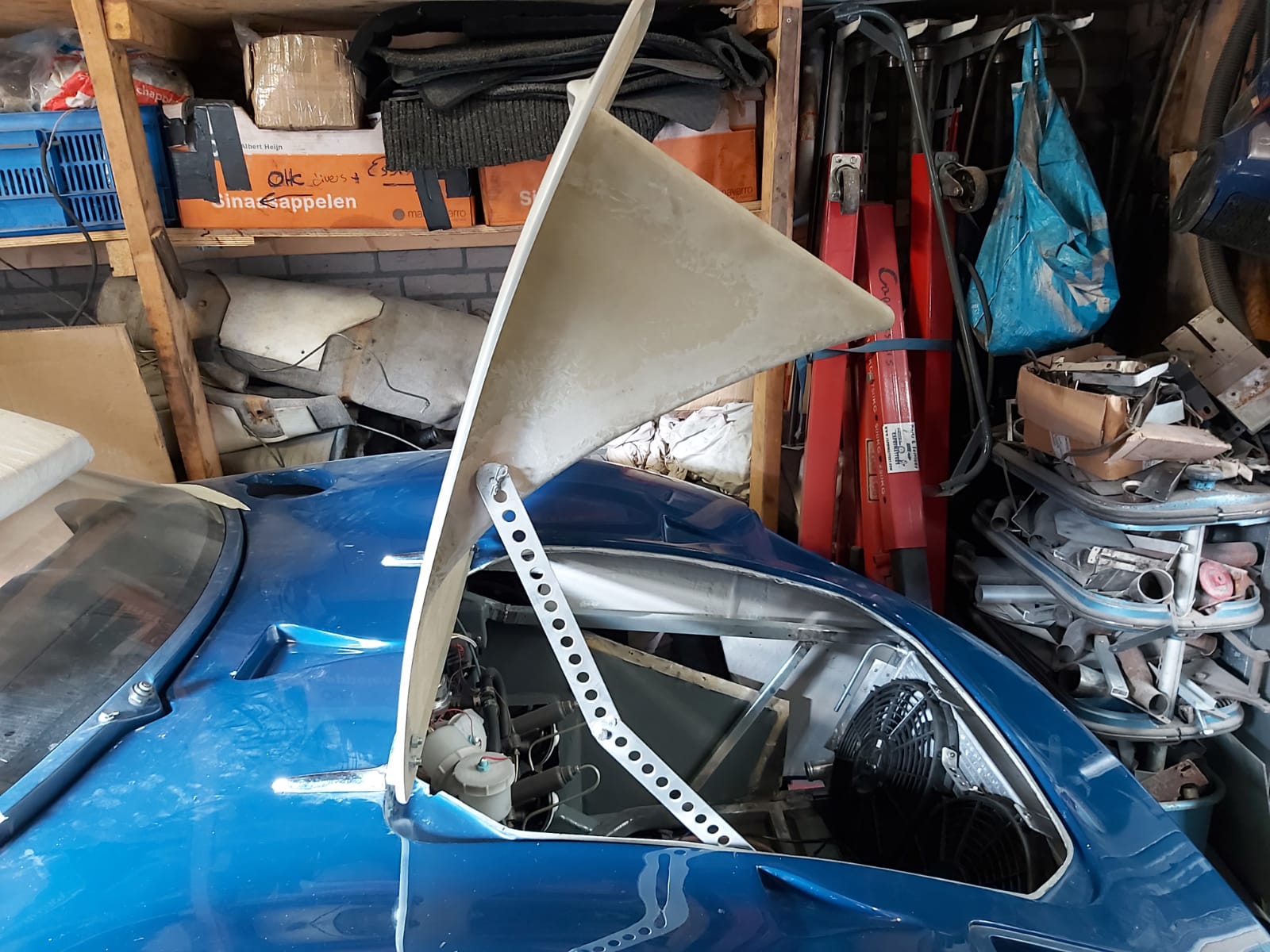

Have no issue at all with my single deep vent nostril. I even have hinges and did not trim anything. It tilts fine backwards without hitting fans & rad.
Cooland pipes run free left & right.
KVA B chassis with GTForte mk2 body.
