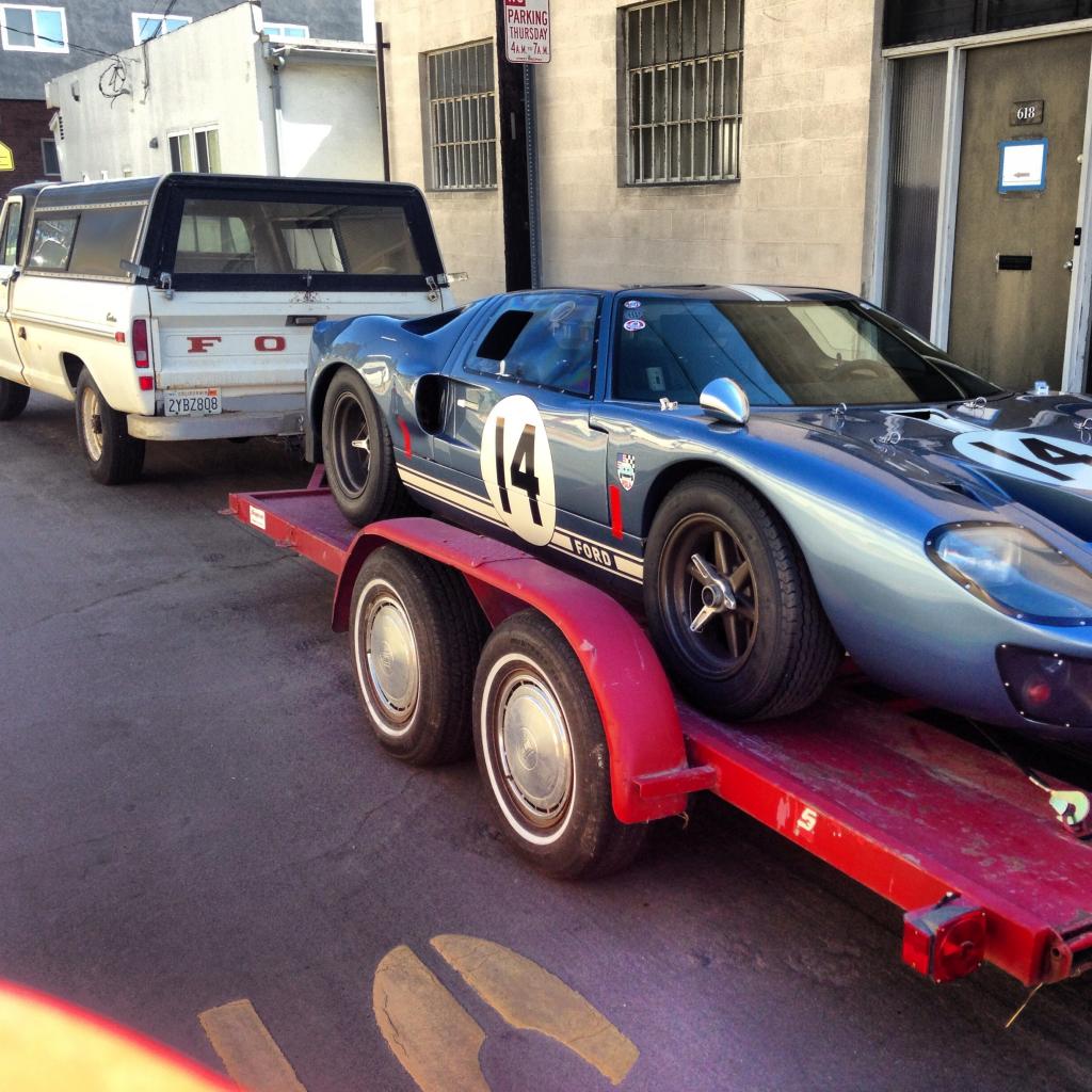

I've been transporting my GT in an open trailer for years without incident. Just back it on, strap it down and go.

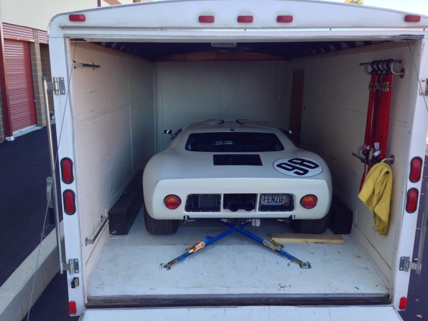

Everyone has their own thoughts on what works for them. I didn't get an open place and I looked at nice aluminum car hauler, because I wanted to be able to tow long distance and not worry about weather as well as overnight and be able to have it locked up and not visible to passerby's. You can find great deals on Craig's List. The other nice thing is being able to use it for other purposes and keep cargo dry. Buy what works for you. I can get in and out fine but if I couldn't I'd mount a winch in the front and truly make it a one man operation.

My vote is go with enclosed simply for weather, out of sight out of mind theft prevention, and multifunction capabilities.
Through the years my friends and family have used my enclosed trailer more than I have. They've used if for moving everything from a bobcat, to heavy machinery, to 3 and 4 bedrooms houses especially in inclement weather. Although I never ask, they are my friends, If they insist on paying me I simply suggest," Buy it a tire". It's worked out pretty well in the past.
