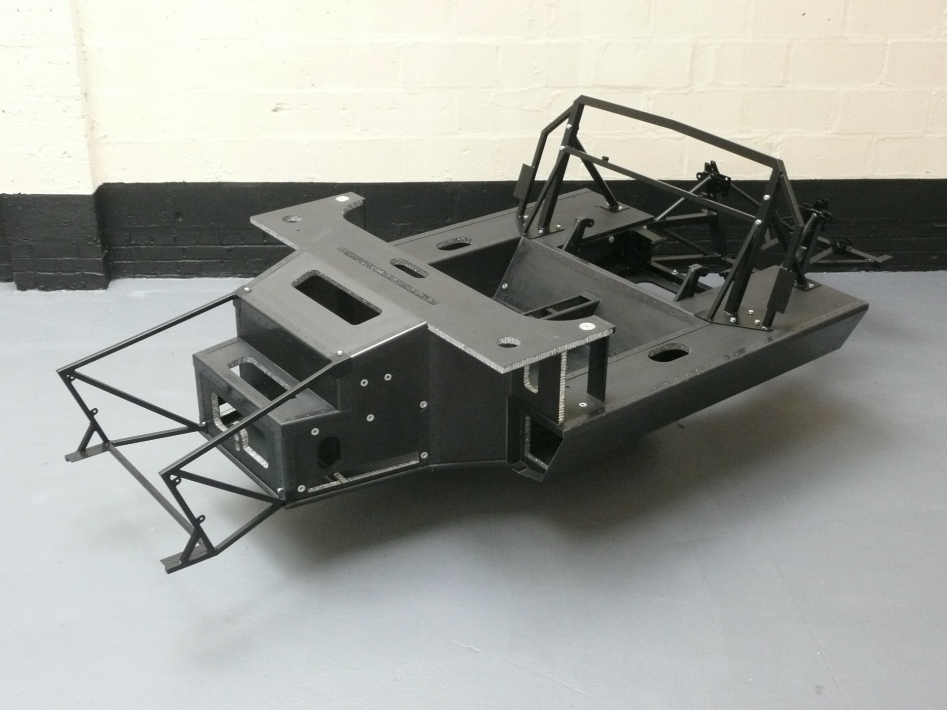

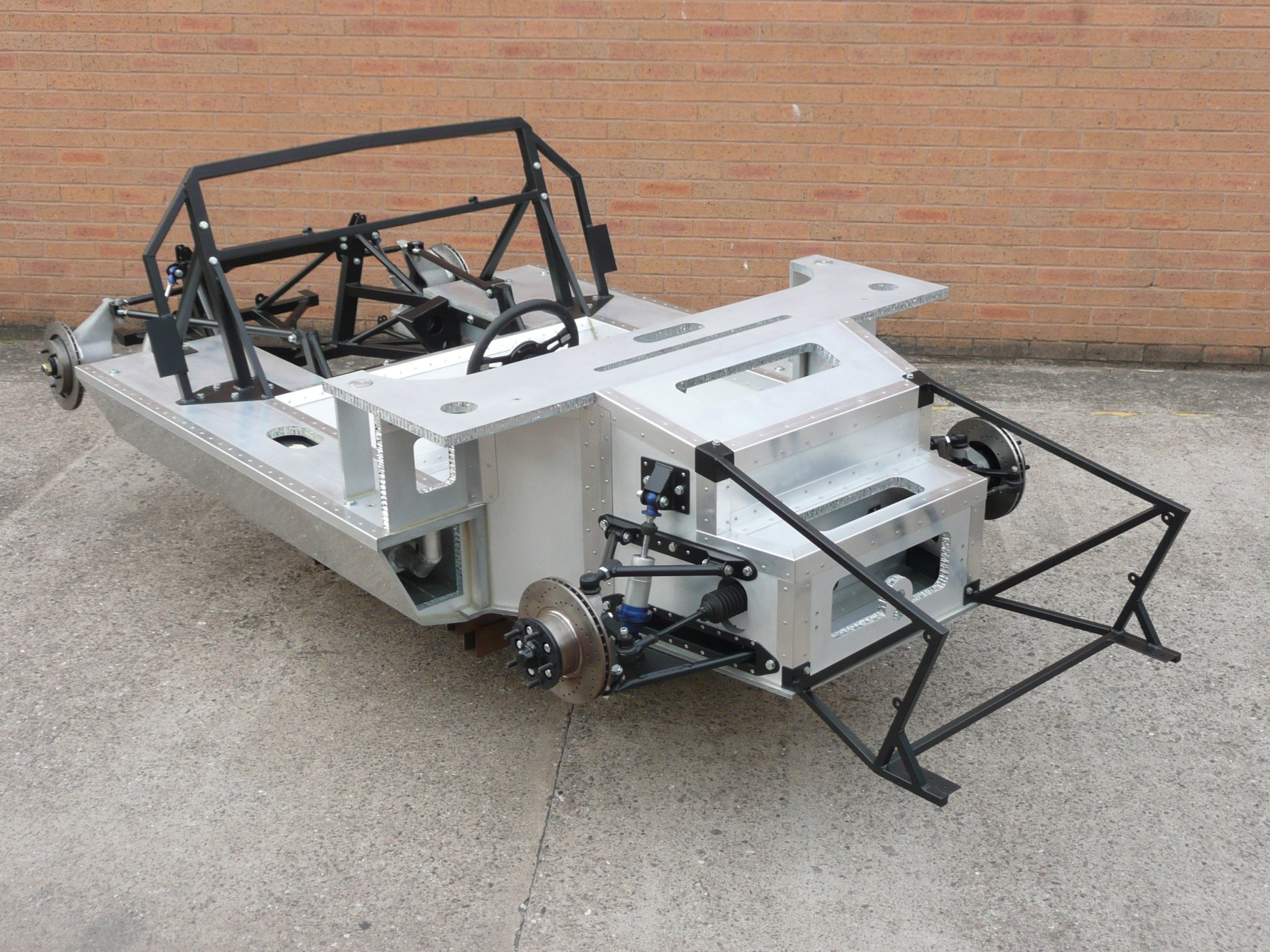

Our Monocoques are manufactured in either Aluminium or Carbon Fibre
