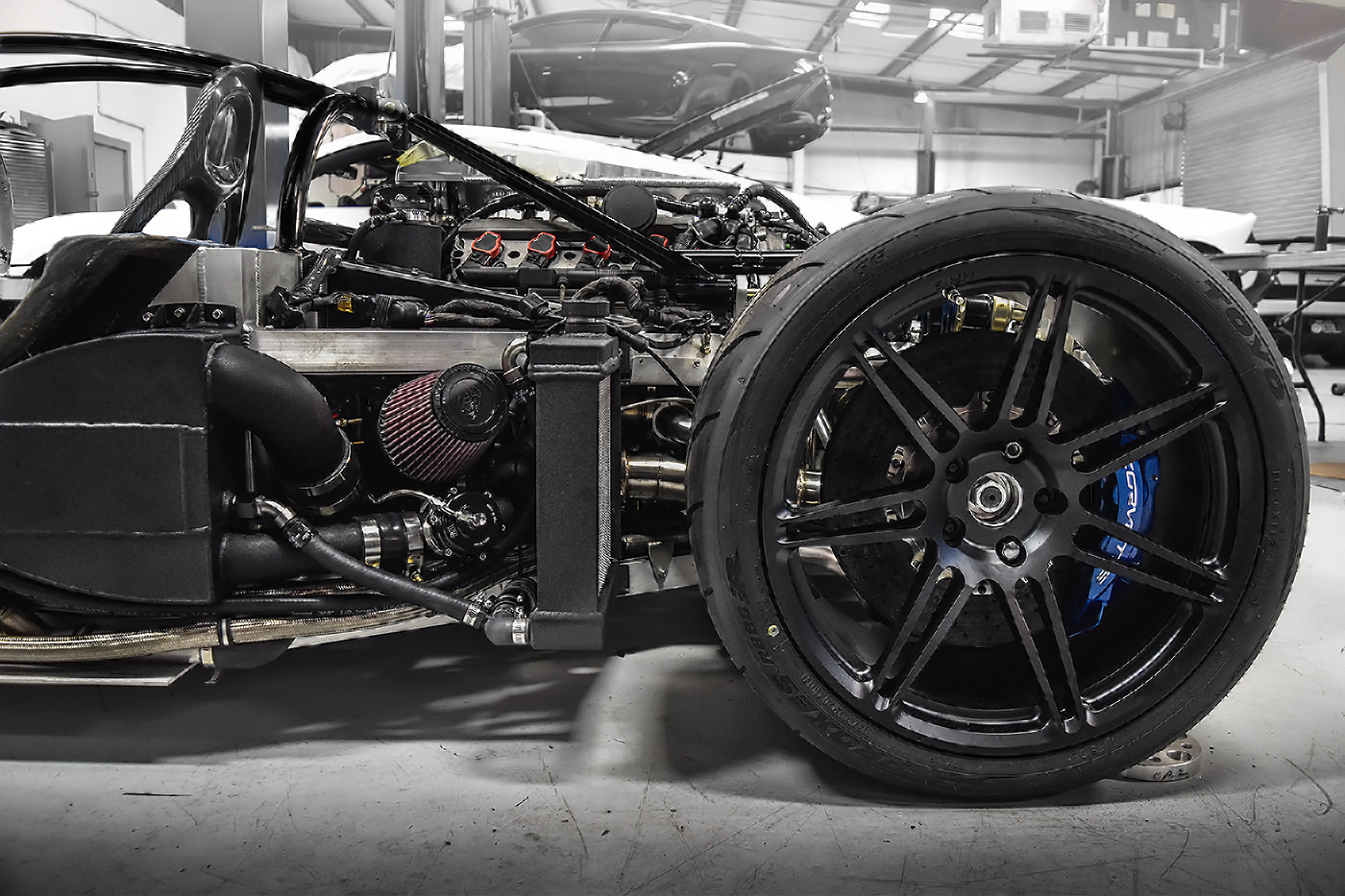

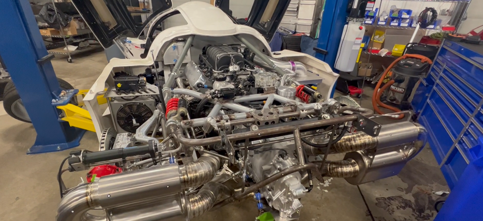

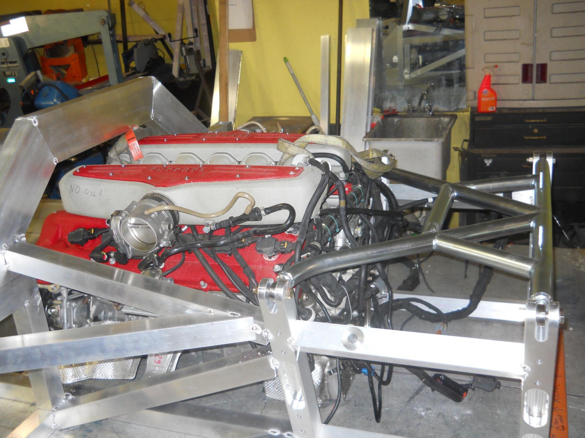

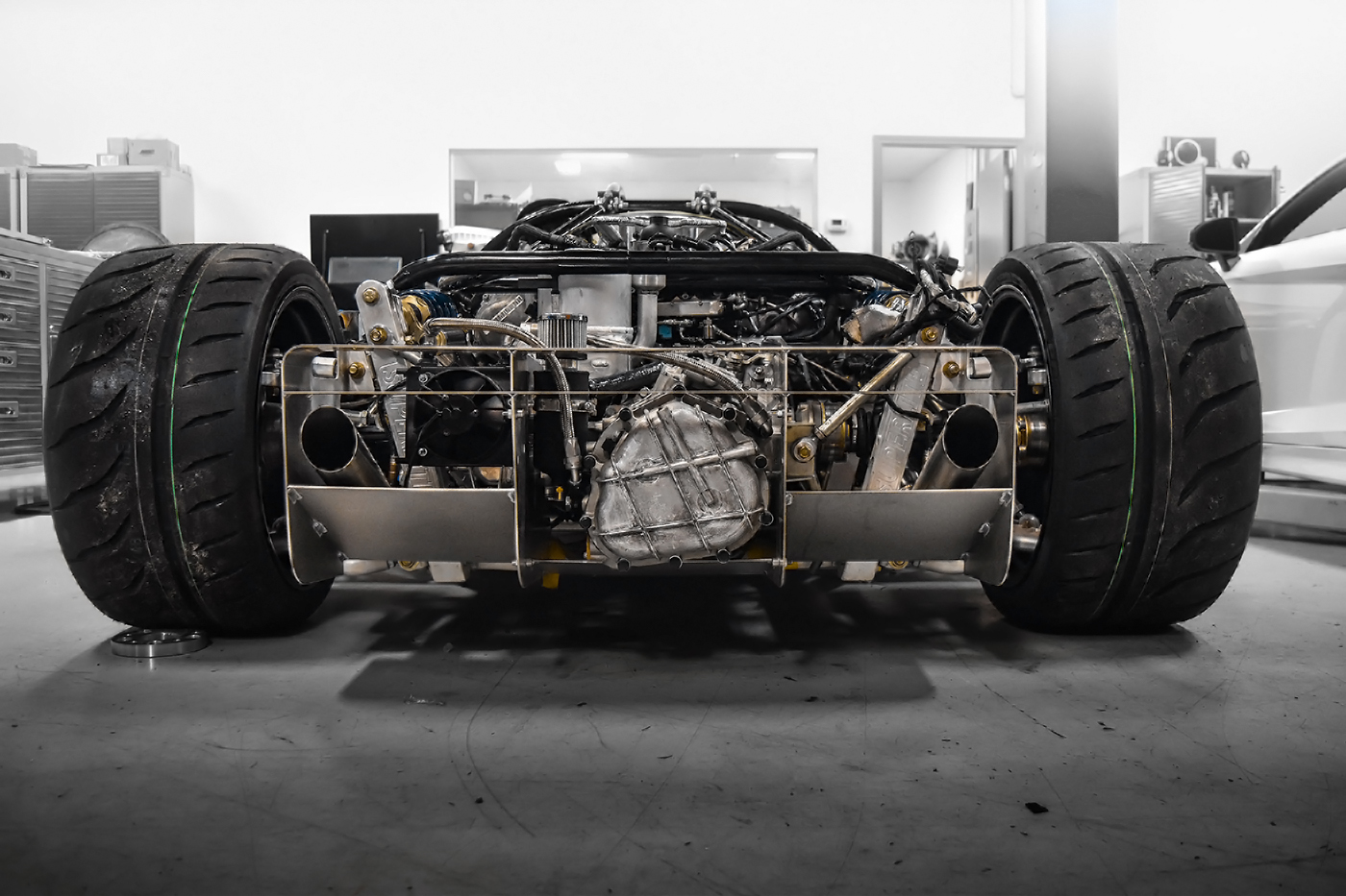

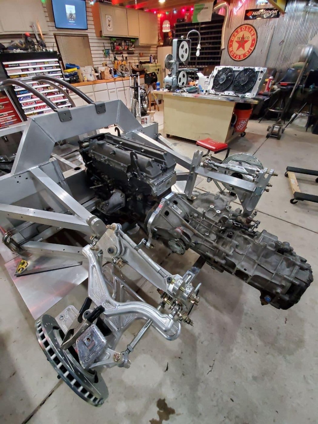

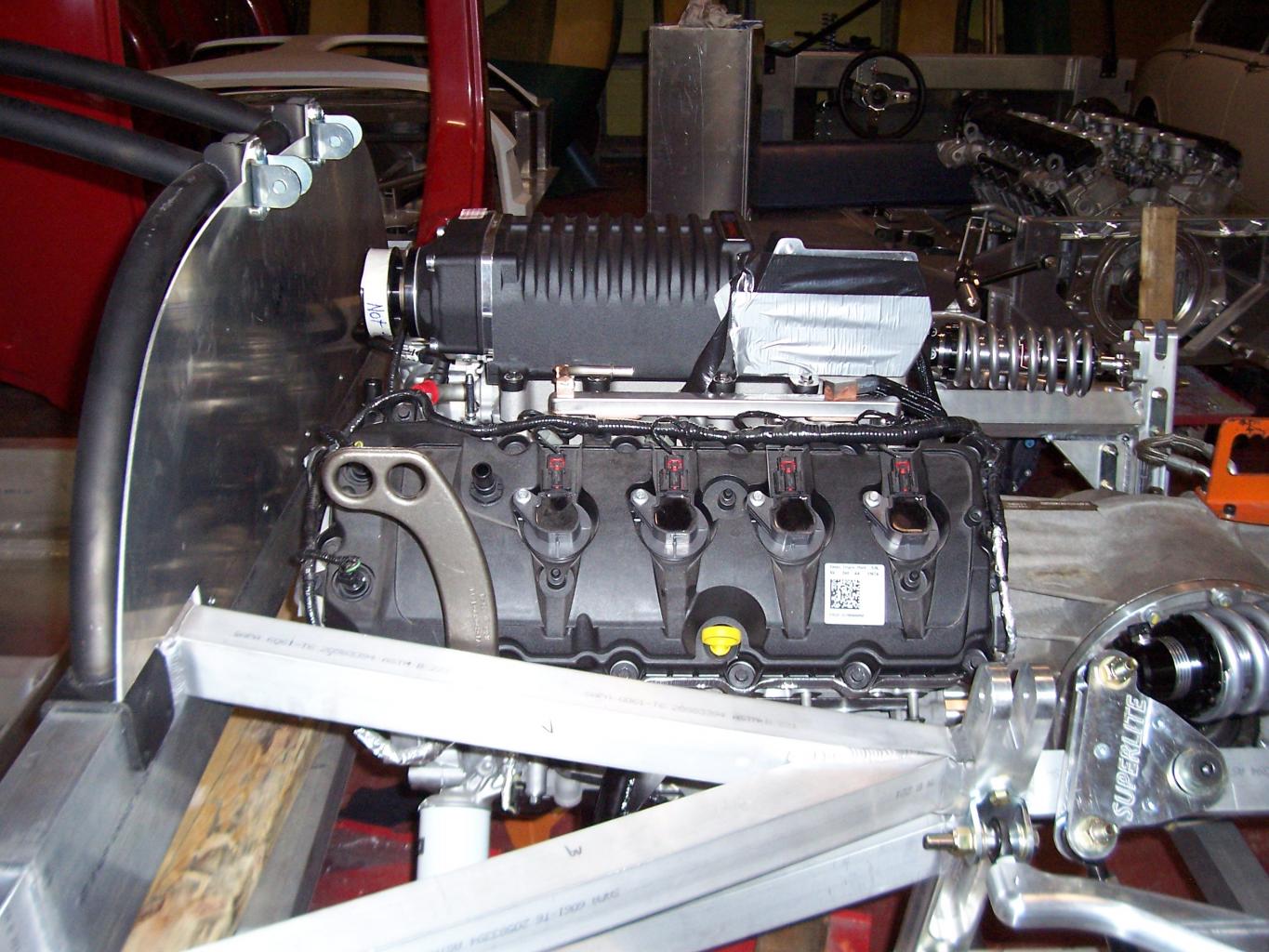

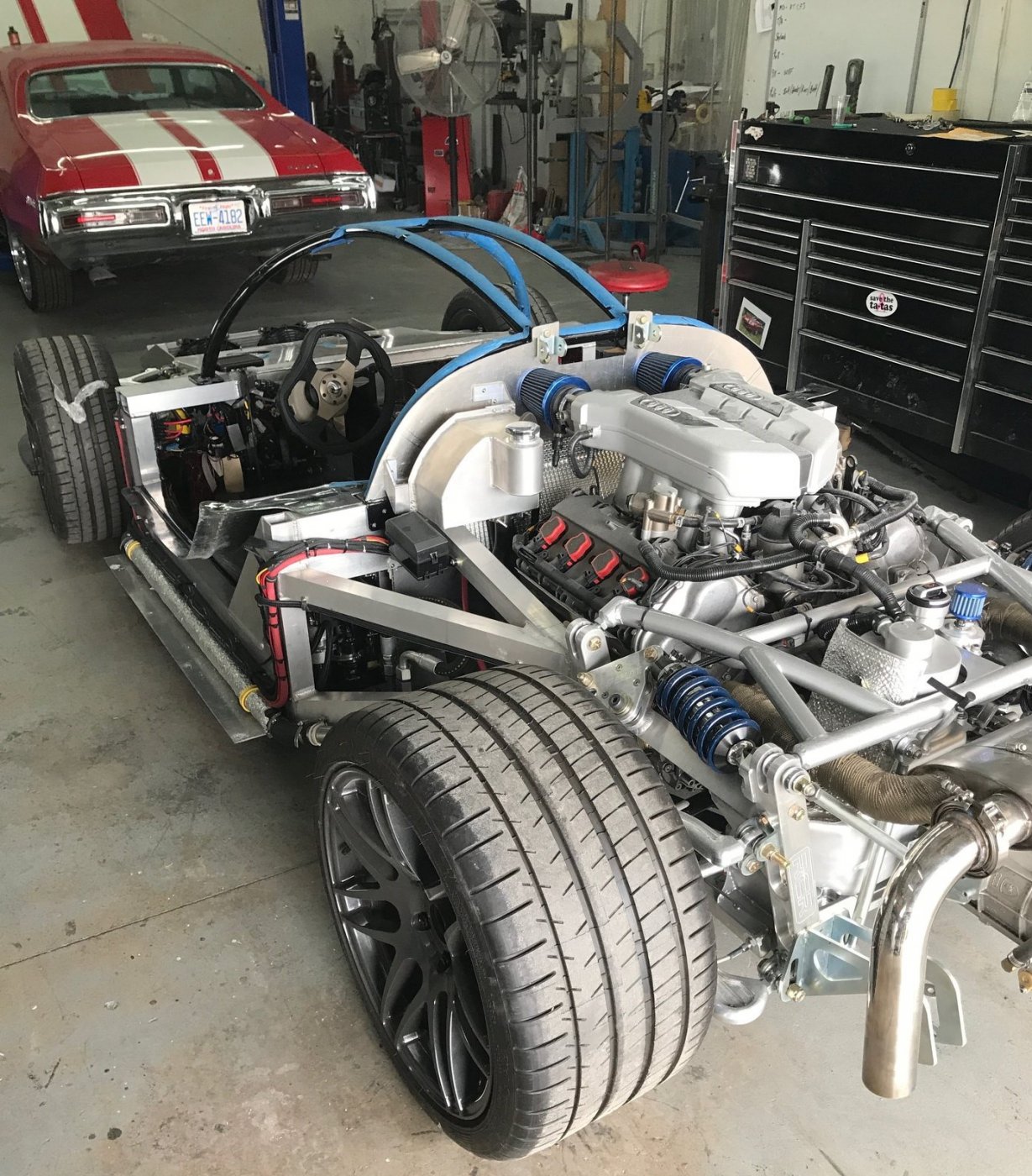

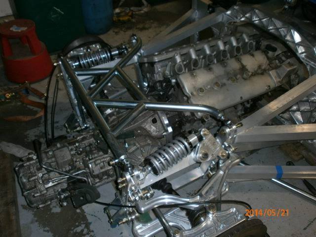

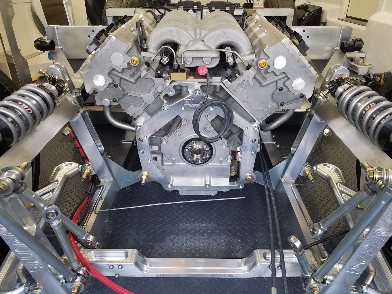

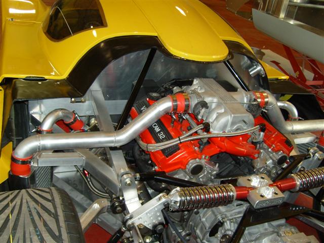

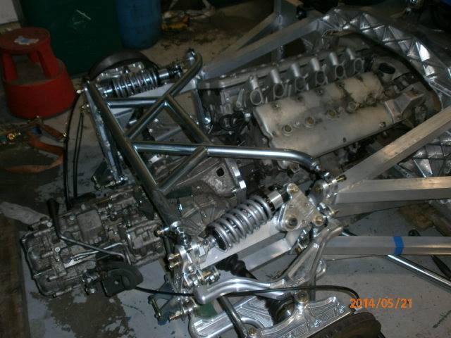

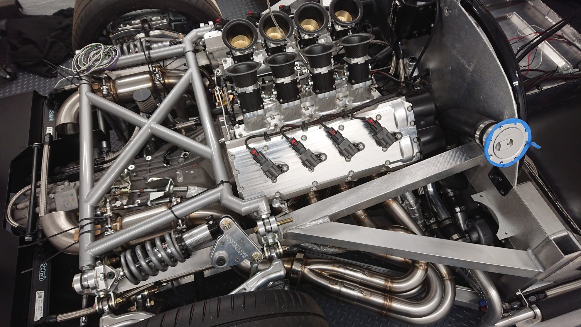

I remembered a few others with DOHC.
Audi V8
Heffner Lambo V10 Twin Turbo
Mercedes V12
Ferrari V12
Toyota J2Z Inline 6
Lexus V8
Ford V8 Coyote
