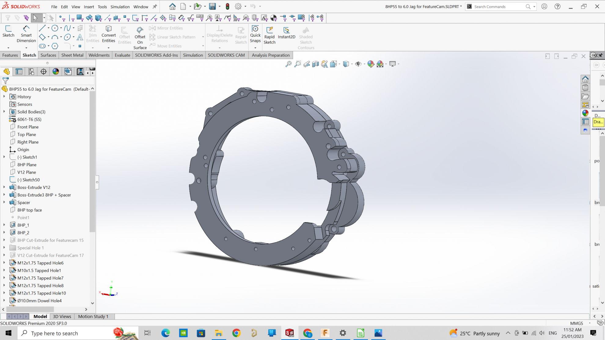

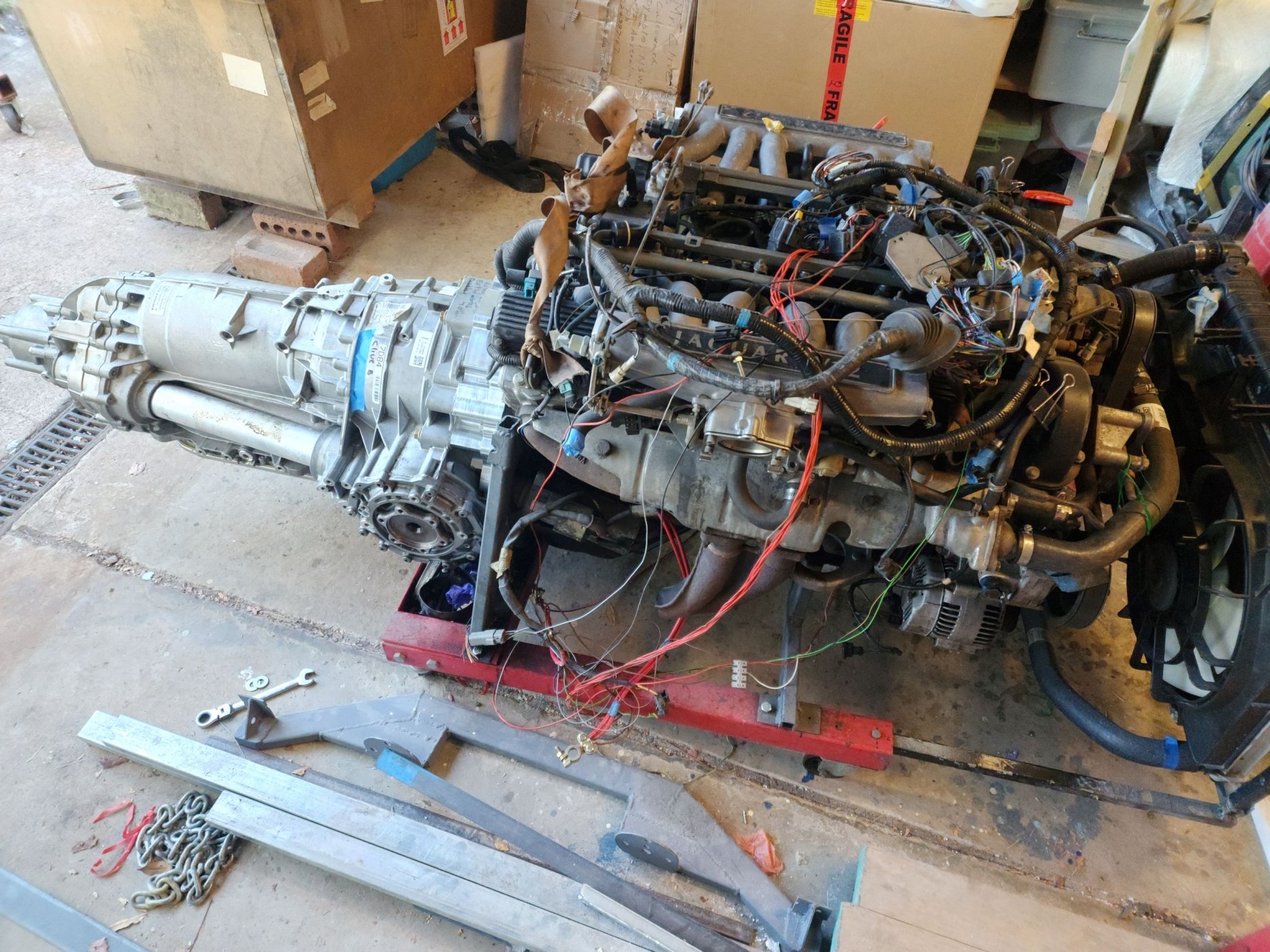

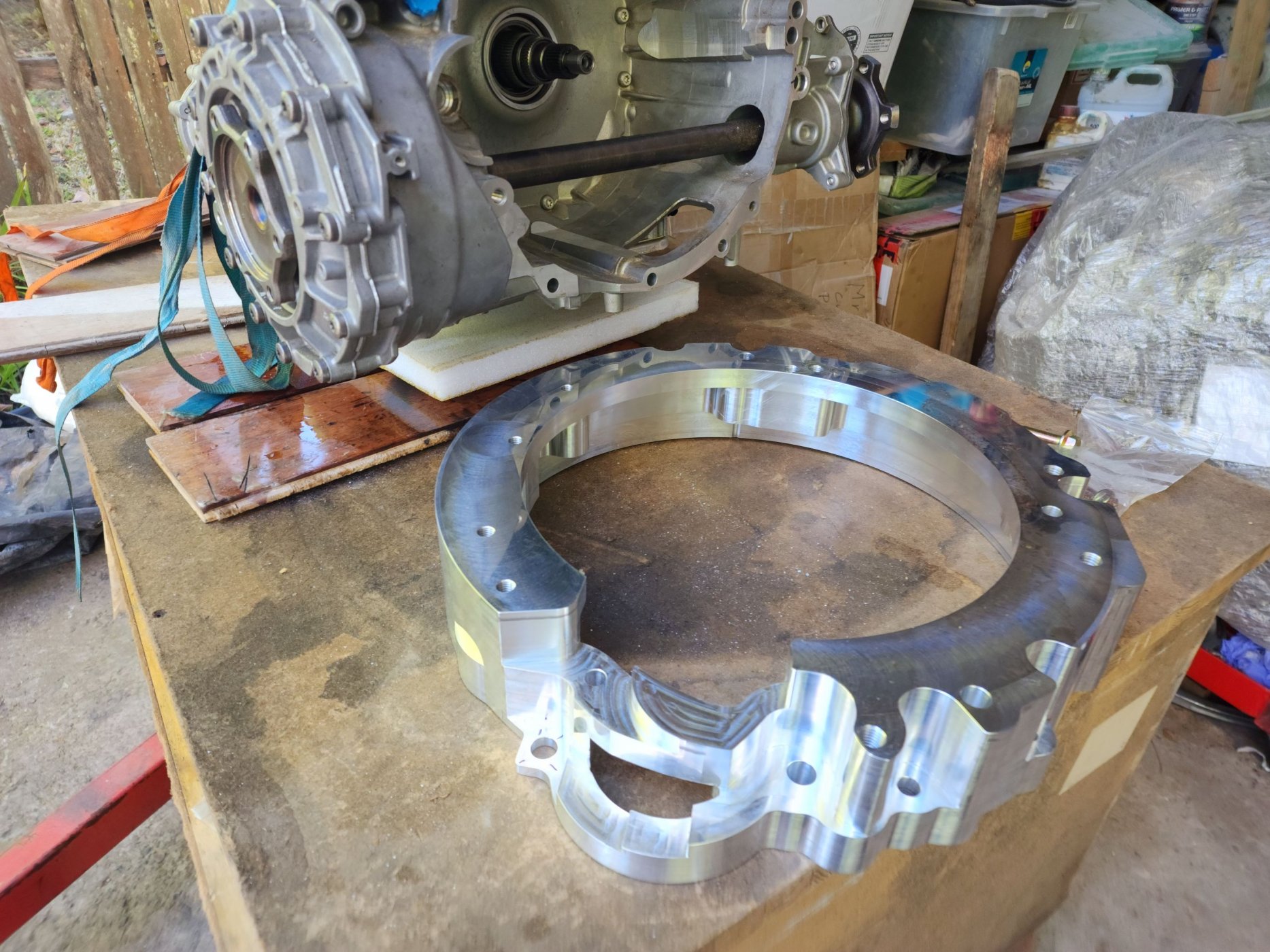

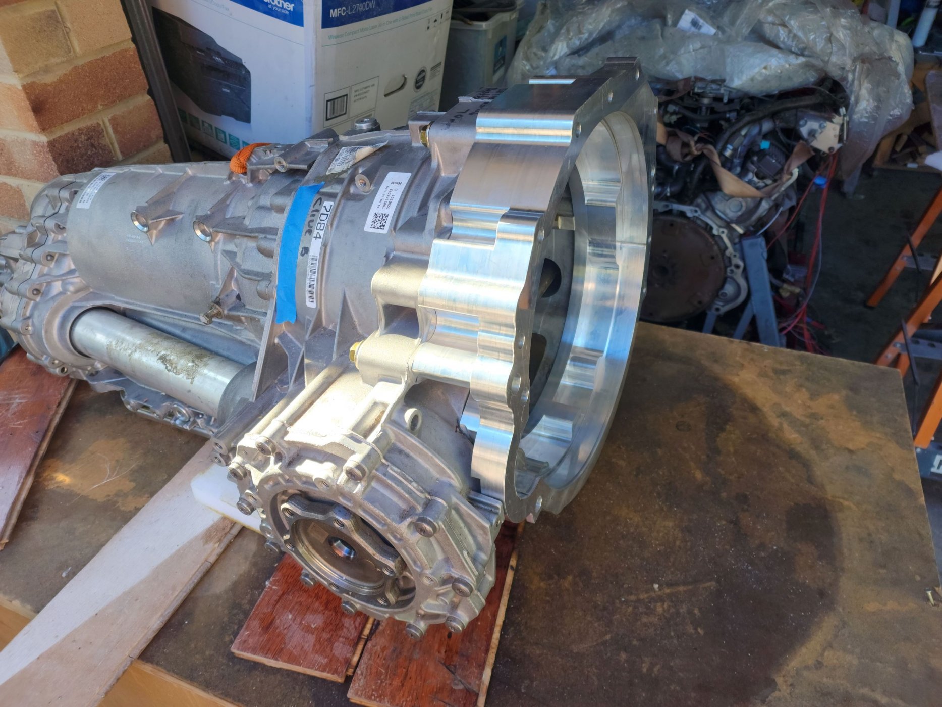

Im currently designing an adaptor to go with this transaxle and Im trying to mate it to a Jag V12 6.0 engine. As the front diff is mounted within the engine plane it requires a funky cutout for the diff and a depth of around 78mm to space it so it will fit.

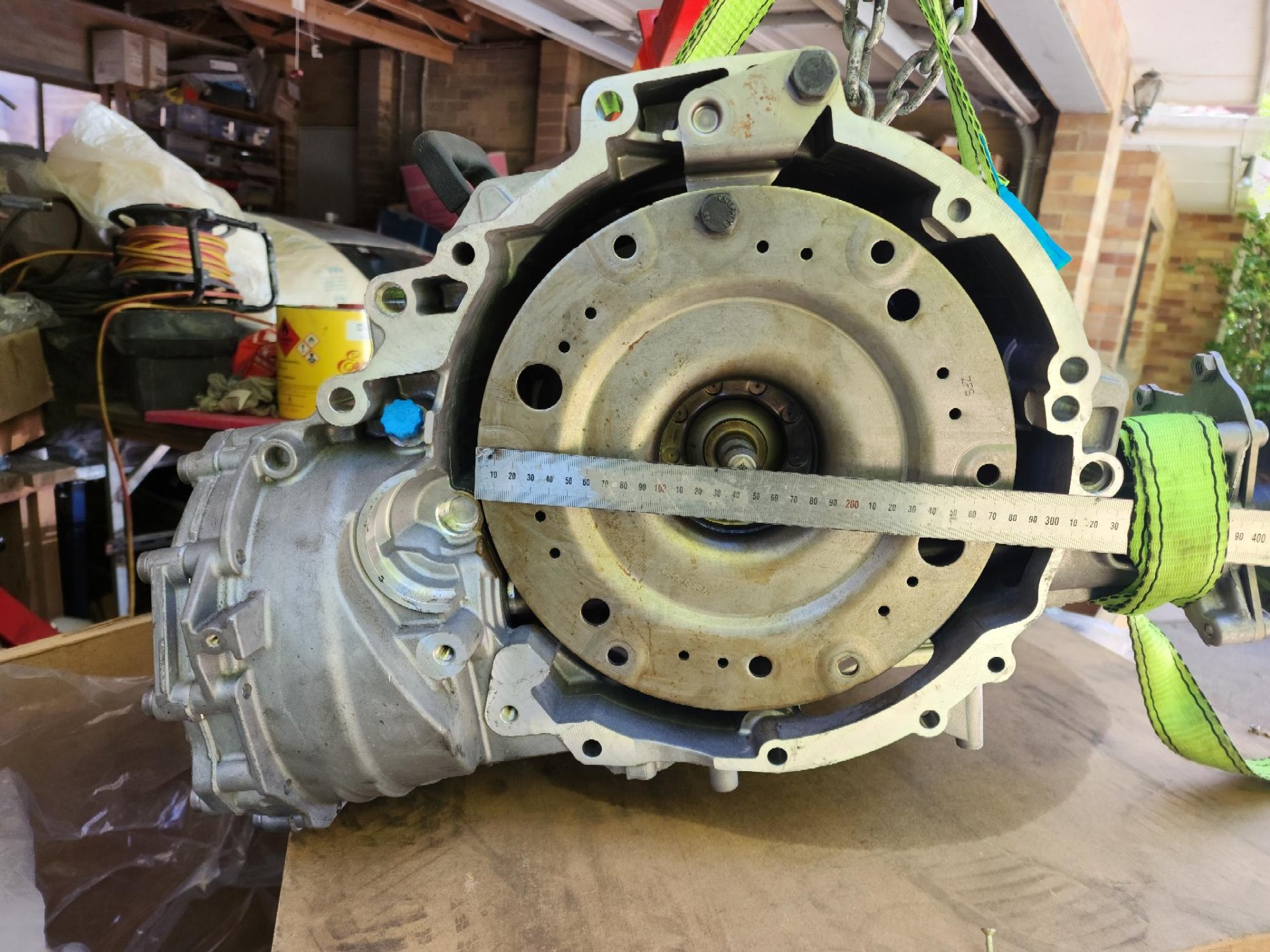

Im getting the transaxle measured by a third party and have measured my V12 using calipers. Im down to around 15 thou error (I think!) and I dont suppose anyone has the V12 6.0 bellhousing dimensions that I could use to crosscheck?
