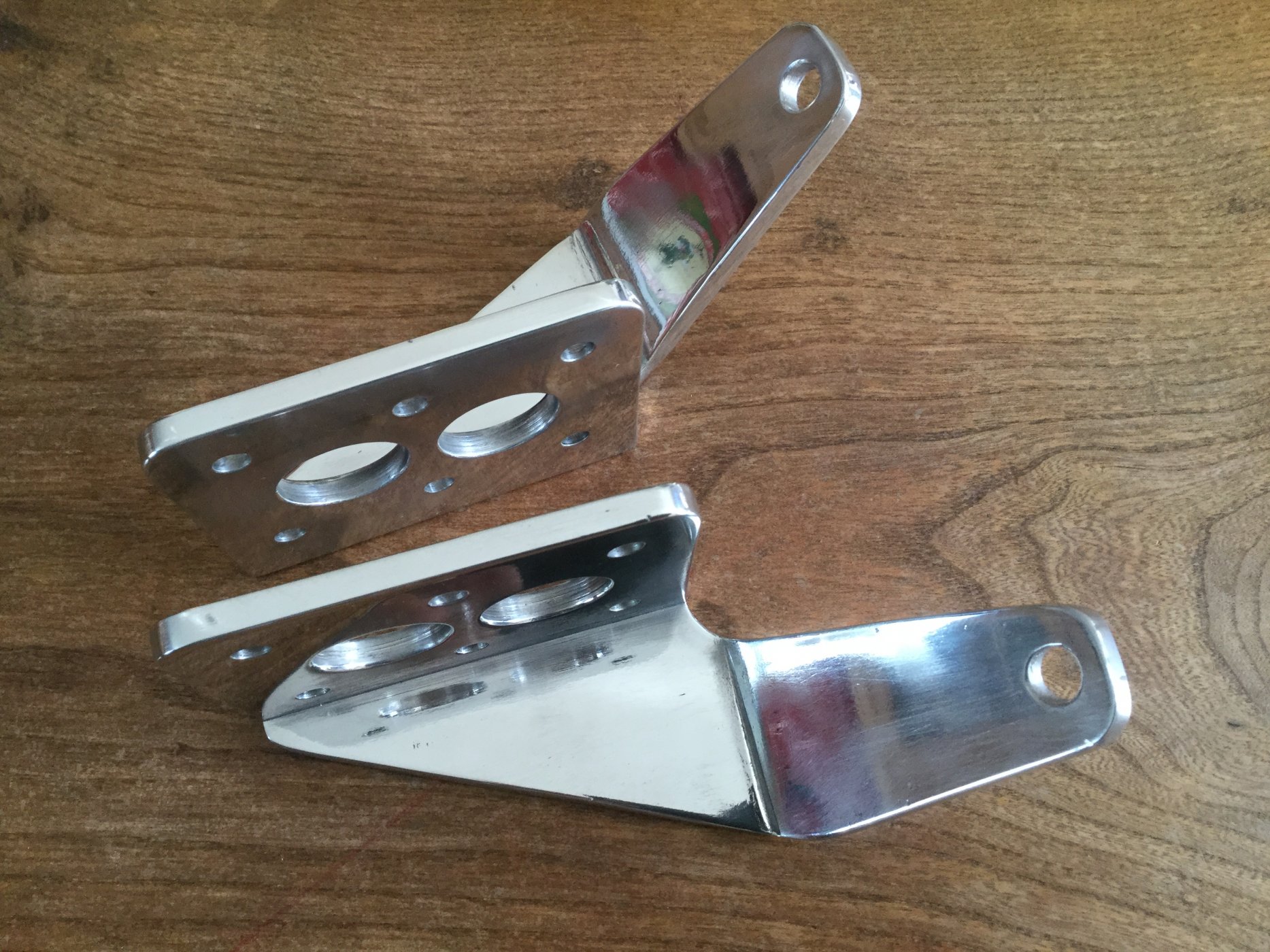

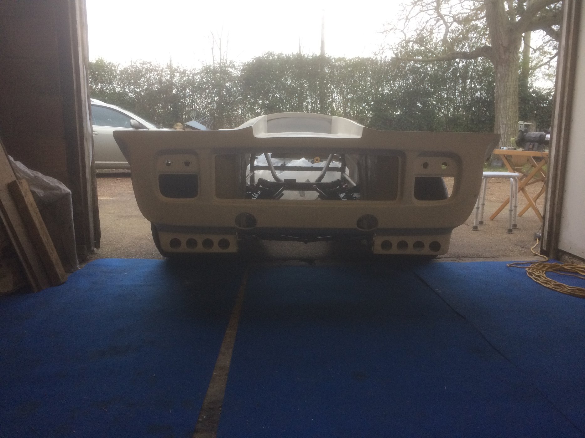

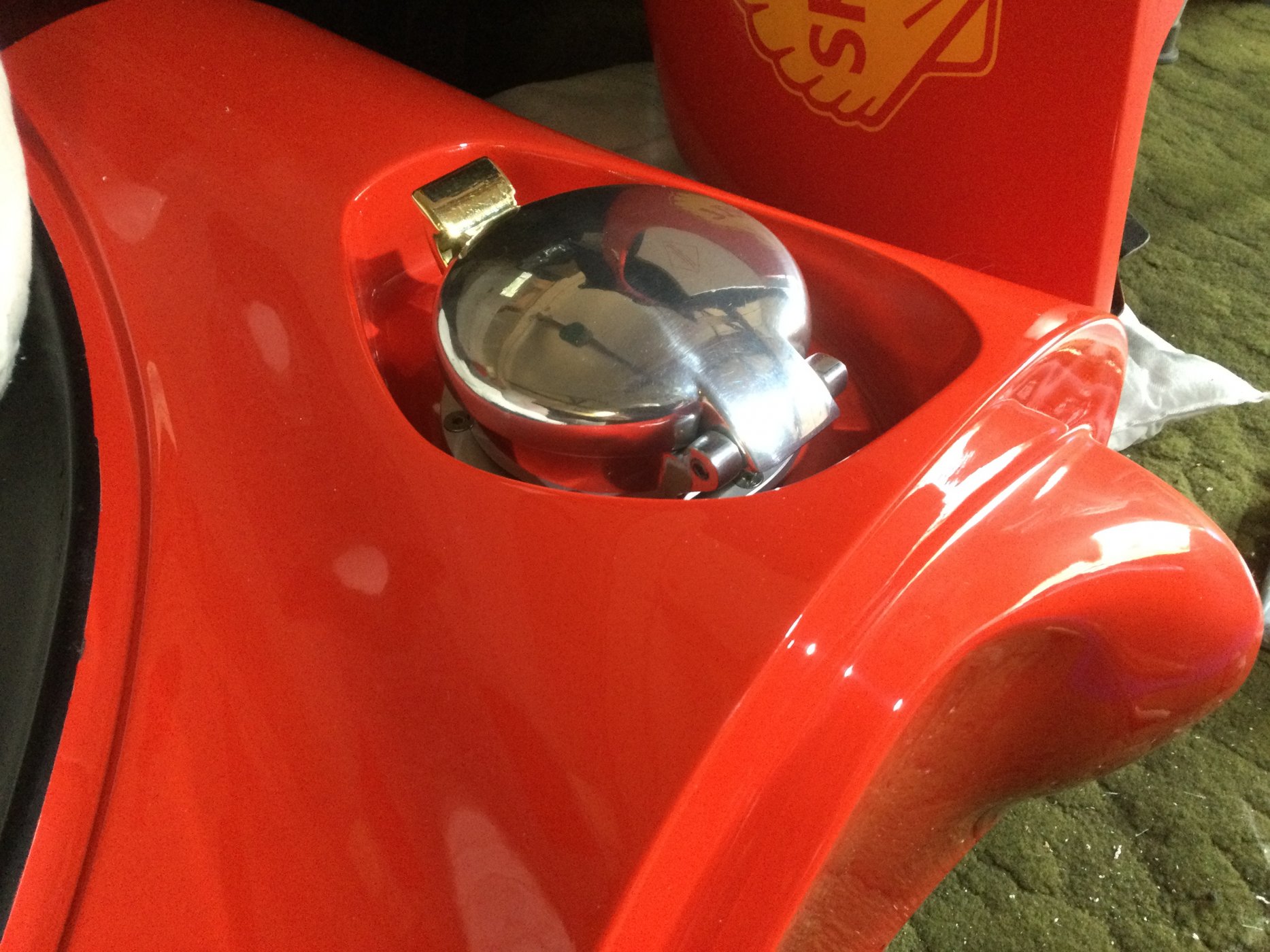

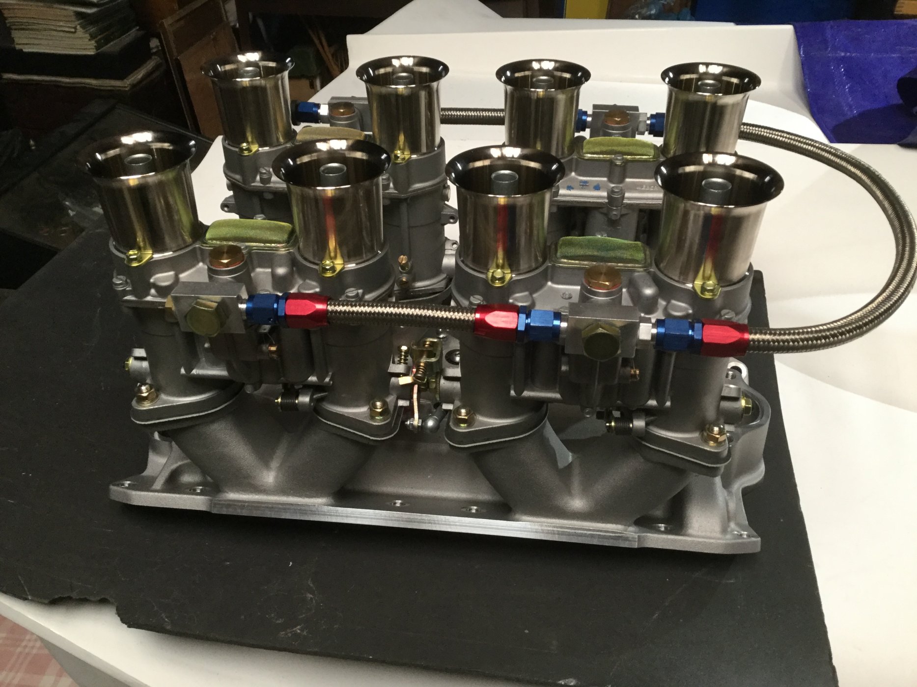

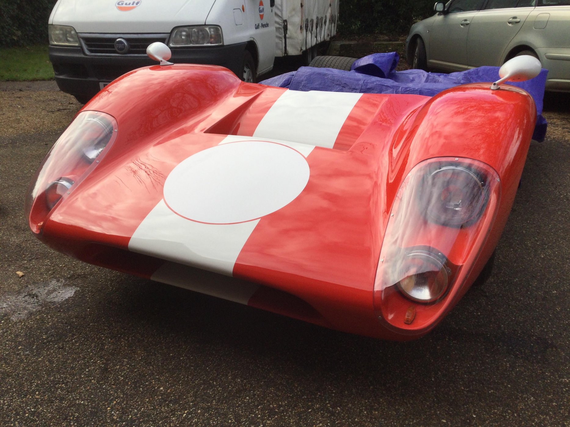

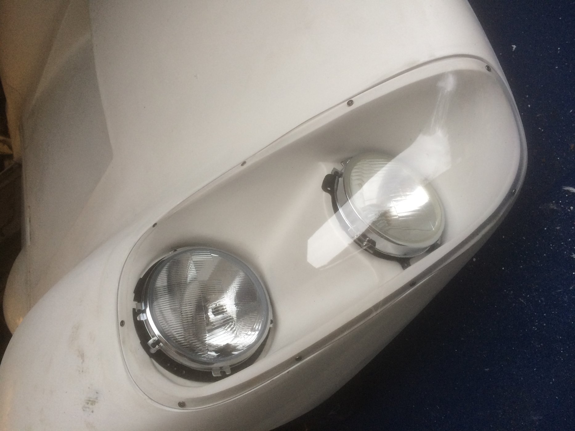

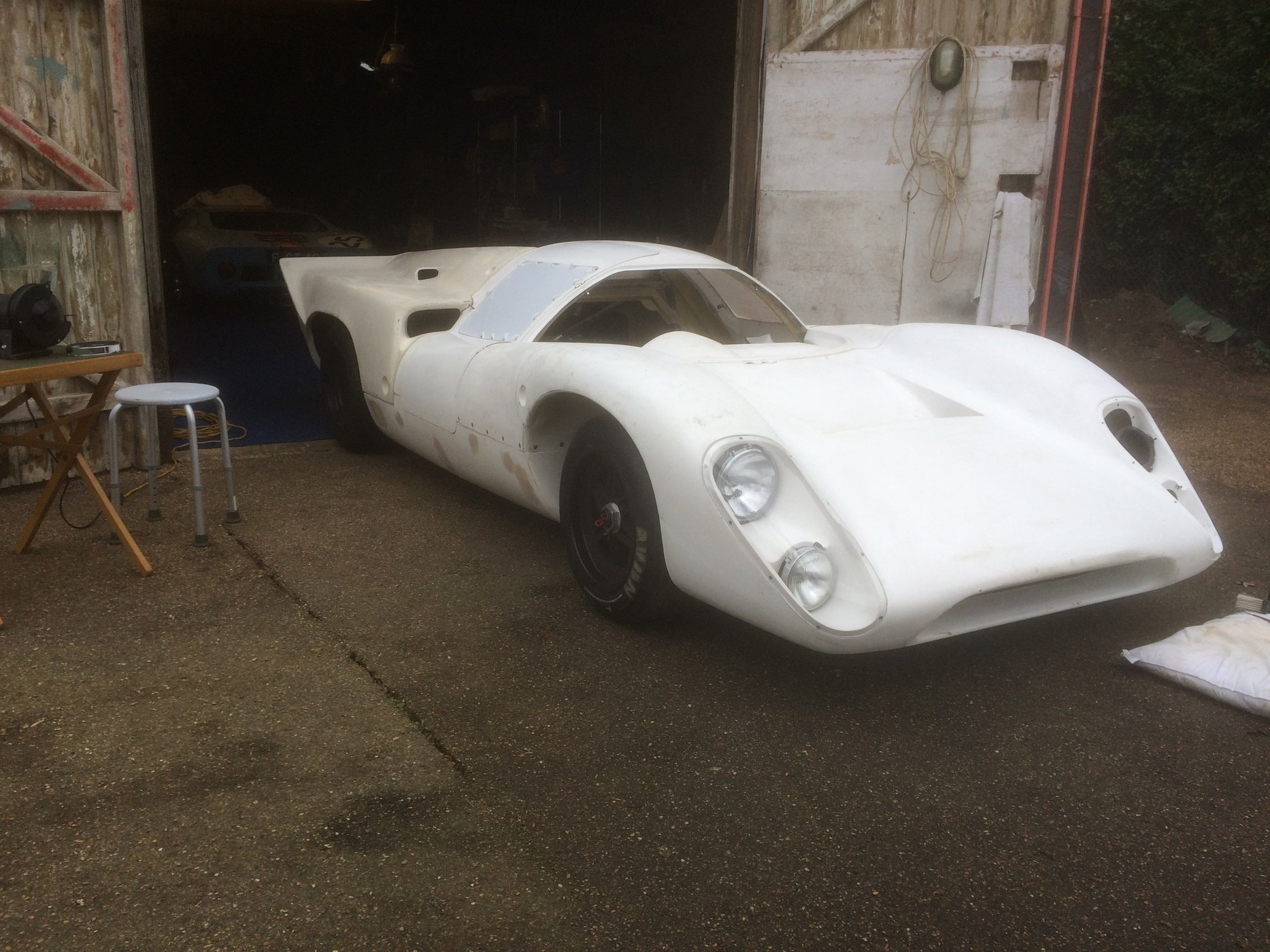

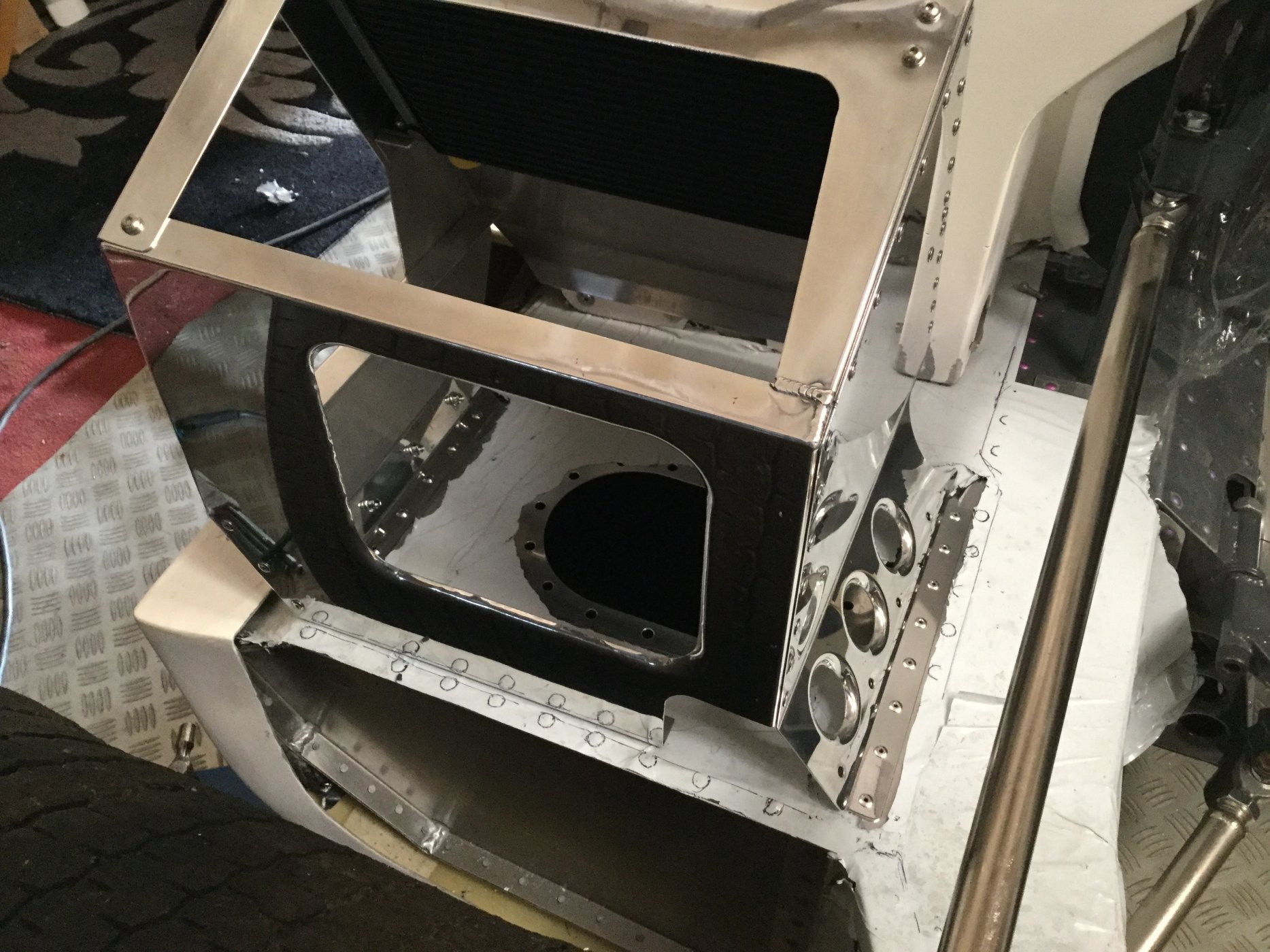

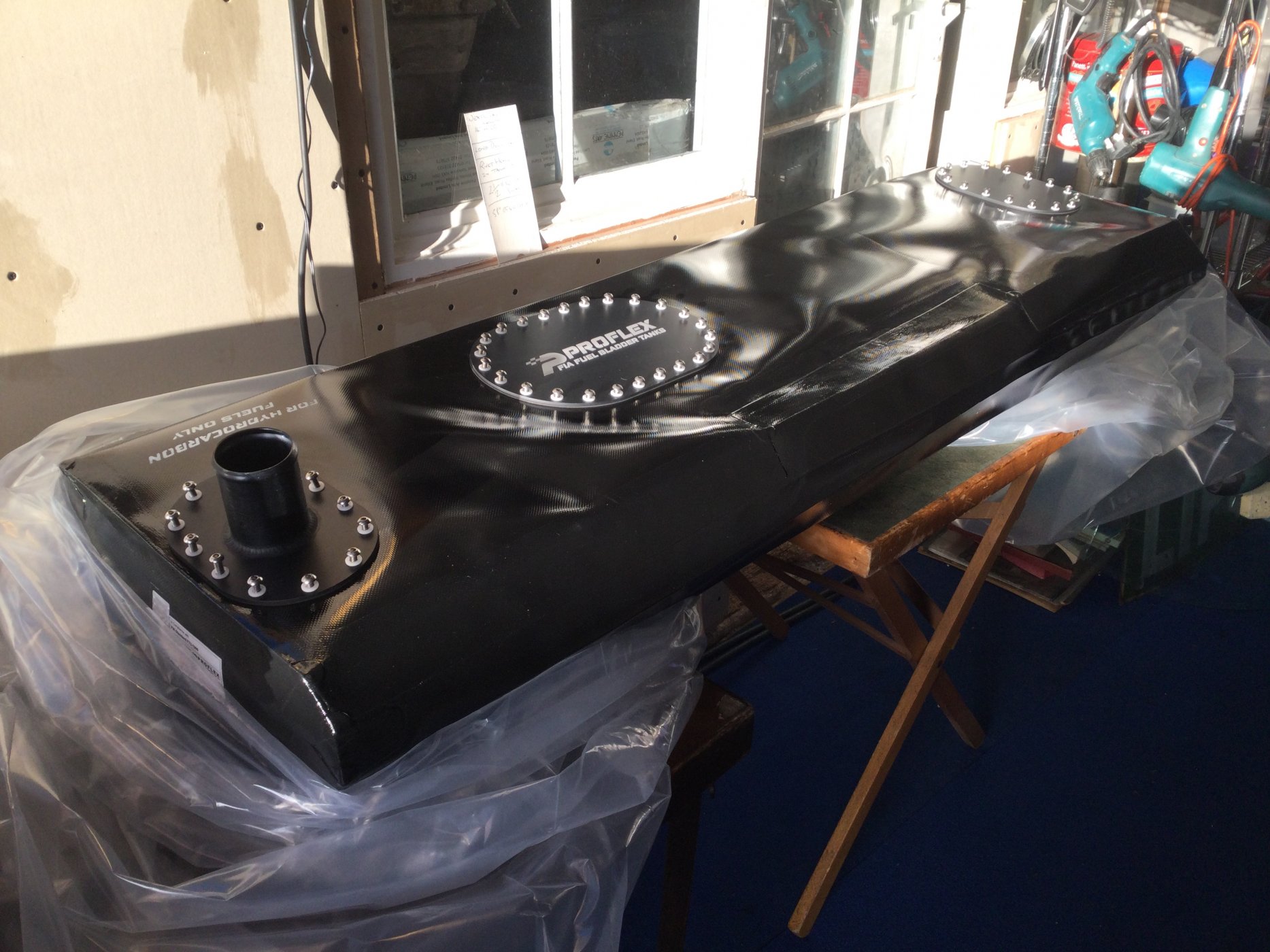

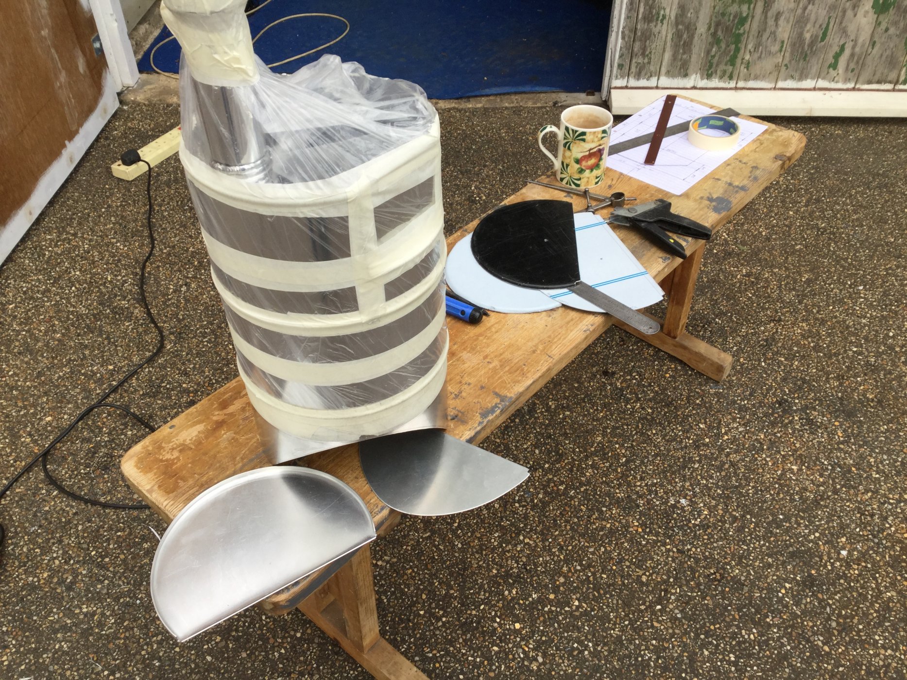

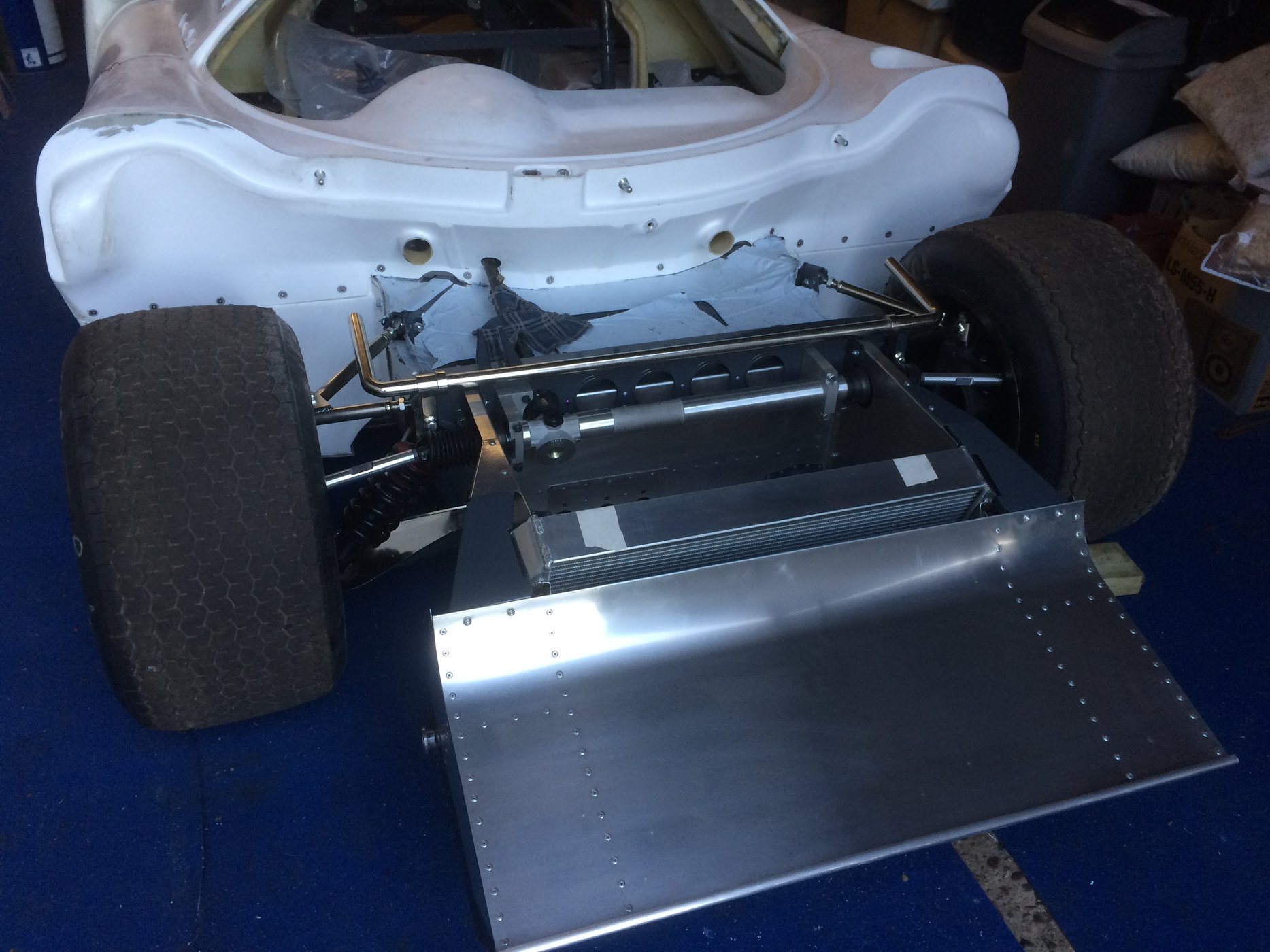

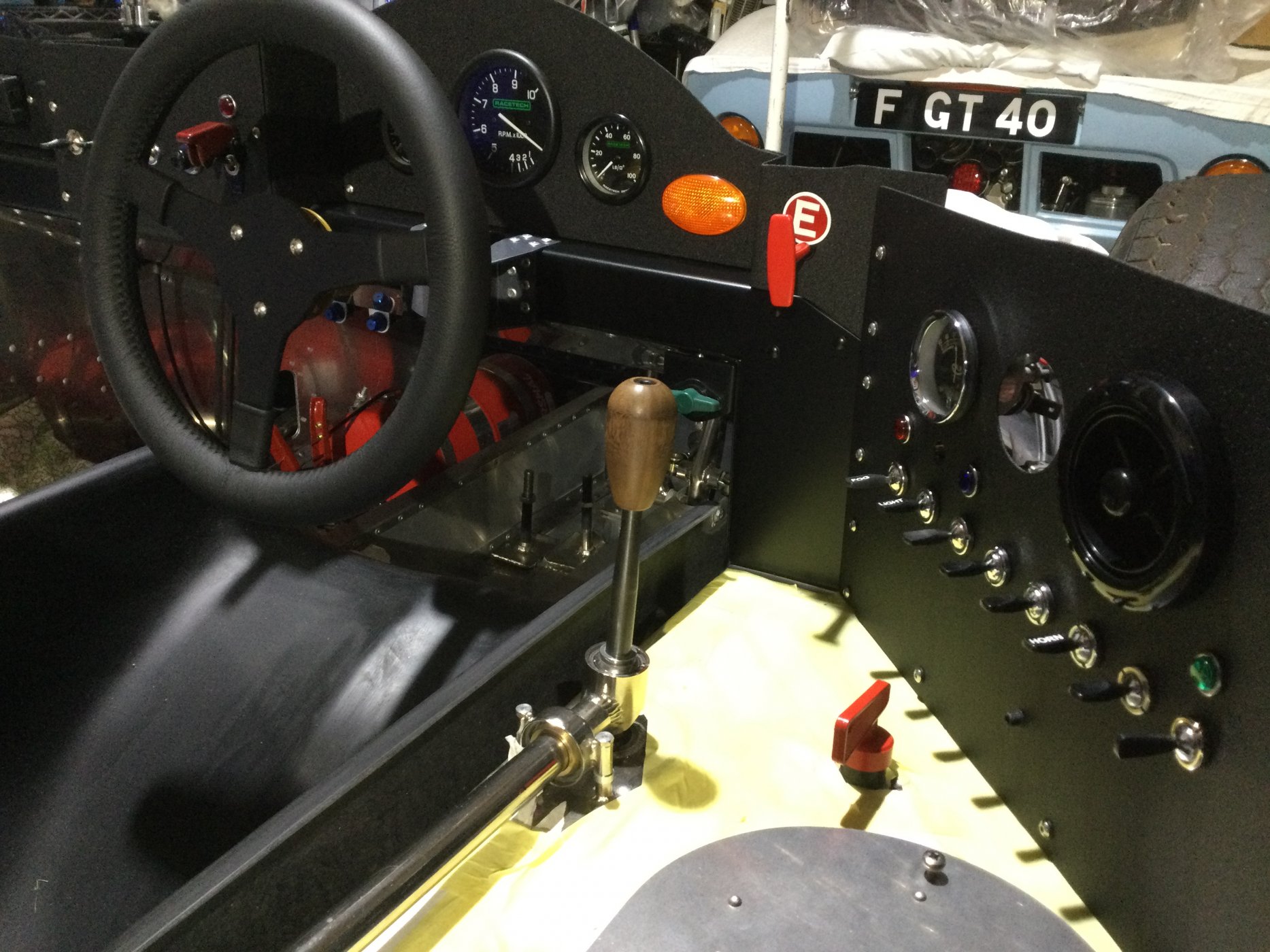

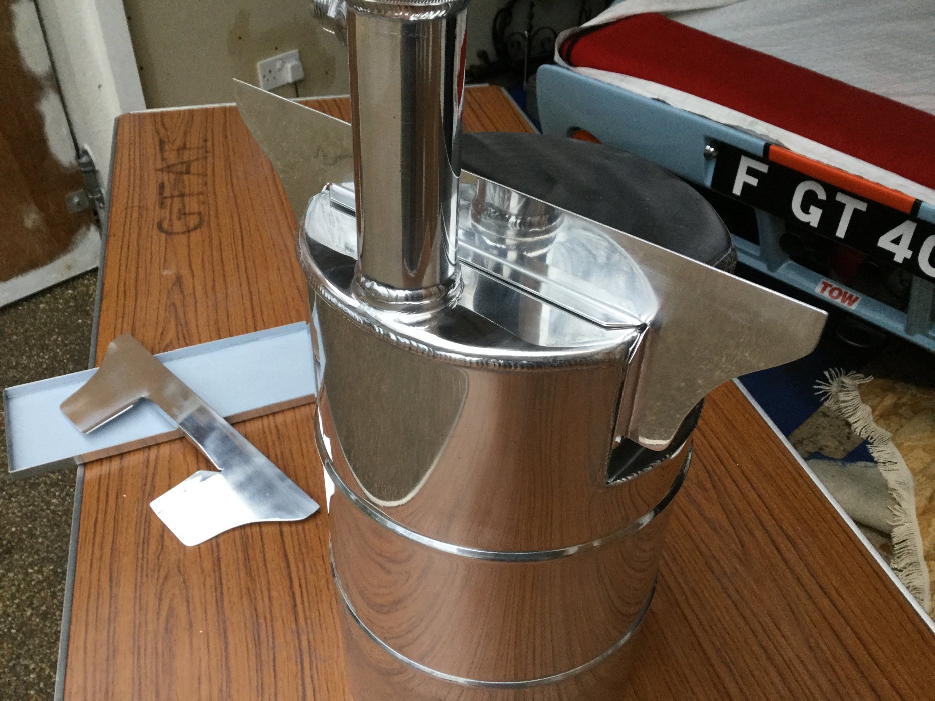

Sorry folks, long time no update ! !
Life, Universe and pandemic getting in the way.

Some more boring photos.

Hello Brian, hoping you are safe and well over there.
Still have the Marauder in bits, as I,ve concentrated on this FIA build. Probably will end up selling it to someone who wants a good project.
The pictures only show a very small cross section of what I,ve done. So much has been made, trial fitted, and bagged up, ready to be finally refitted as each part of final assembly is being reached.
