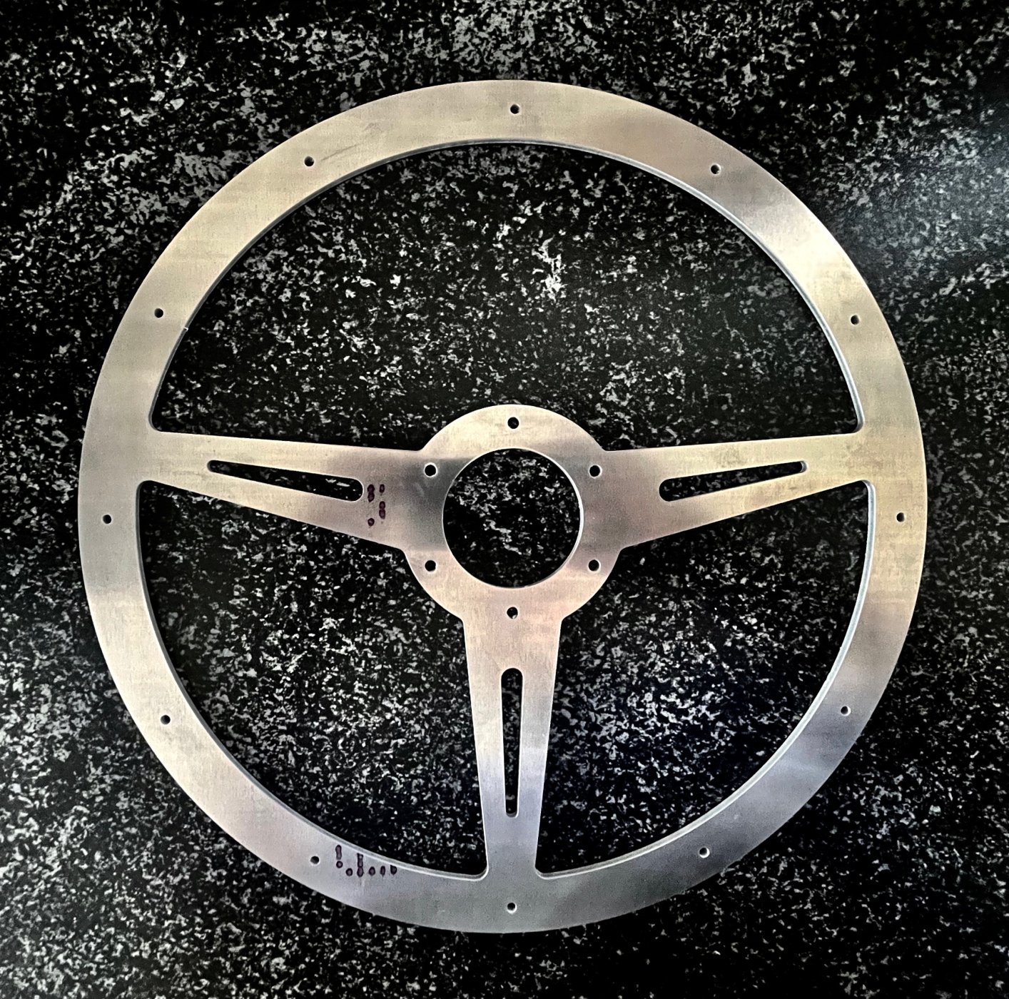

I have what I think is part of mk1 15inch wheel drawing. I'm not hell bent on 100% original for my build, it's not an original car.
Hello David,
Which wheel had you in mind to reproduce ?
I have a little experience in producing wheels for
P chassis cars, where historically they had 'gone racing'
and lost the original wheel.
I was also fortunate to stumble upon a full animal hide dating
from 1964, to upholster them. It has a beautiful soft character,
yet retains its grain.
