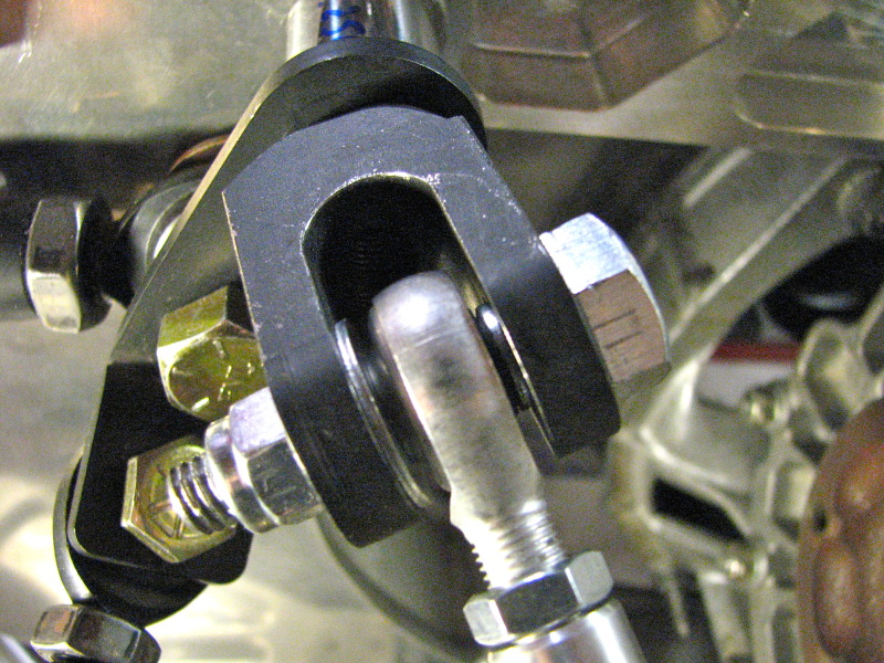

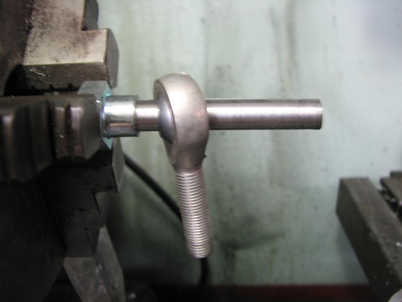

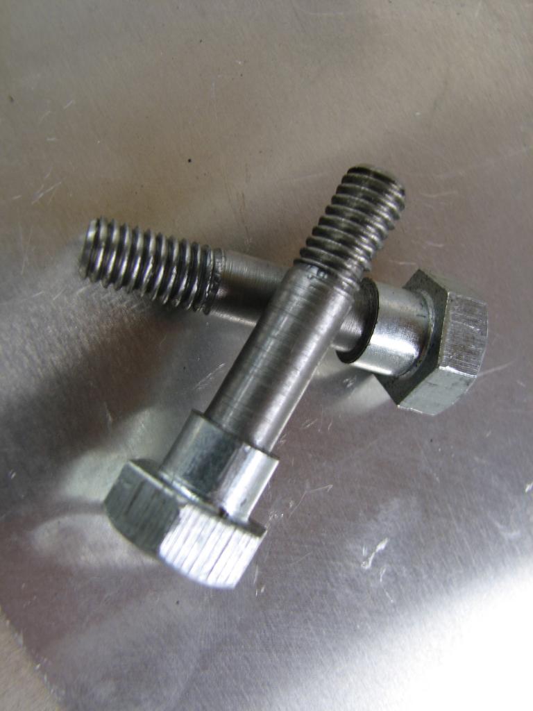

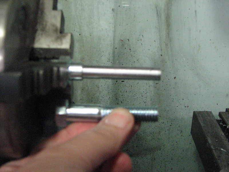

I've already made this unit pay for itself probably 6x over just in doing small one-off parts that I would have had to pay a bunch for at a local machine shop.
Just an example shown here - I needed to use a 3/8" Heim joint with a clevis made for a 1/2" one for my Transmission Support system. I turned a 1/2" GR5 bolt down and rethreaded it..
MANY Dozens of little jobs like this were made easily.

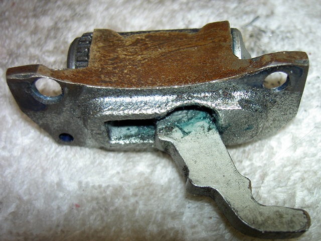

You're by no means the first knowledgeable person who has said the lathe is the starting point, etc. etc. But when I look back over the last year working on my GT40 almost all of my machining problems have been with respect to making things flat or square, not round, and that's why I was headed for a mill first. In fact, I'm having a hard time remembering a "lathe-type" problem at all. Whereas, the task that got me really motivated to buy a mill was to re-make the body of the parking brake actuator so it had proper mounting ears and that would have been a milling job in steel. (See below, and imagine it with 1" extensions on either side to meet up with the mounting ears on the upright). There were others like removing material from the bell housing to clear a clutch arm, or milling the upright in places where the mfr. "forgot to."
Possibly it's a peculiarity of the task at hand (lots of brackets) that made the mill seem like the thing to focus on. I have also assumed that when I did have a lathe job to do that it would be a pretty small one, so cost and space consumed by it would be relatively minor.
So I guess the question for me is: if we imagine that I had both a mill and a lathe (or a combo) and I'm a typical kit builder / hot rodder / racer / inventor, what's the distribution of work between lathe and mill (I'm willing to disregard drilling just to keep the discussion simple), and which suffers the most from compromised size/power/quality.
And I guess what really motivated the question was seeing you about to spend $4K on a 3-in-1 when I was about go spend $2K on a mill-drill who's mill capability I thought was superior; my reaction was "why not buy better ones separately for the same money" my assumption being that the result (aside from space consumption) would actually be significantly superior precision, power, repeatability, size capacity etc. Of course one complication is that I'm unusually comfortable with the "make a cheap chinese clone work" mentality since it's served me well in the past, so I am not a good Smithy customer candidate if there is a clone around.
And then finally but more philosophically the particular combination of mill and lathe has always struck me, from a mechanical design standpoint, as somewhat of a strained combination trying to share one motor and gearbox. I always wondered if there is a "false economy" in the concept. But I do see the space advantage which is 2:1 if not more.
So I too would really like to hear from you and others on the "distribution of work" and "distribution of budget" question re: mill vs lathe.
