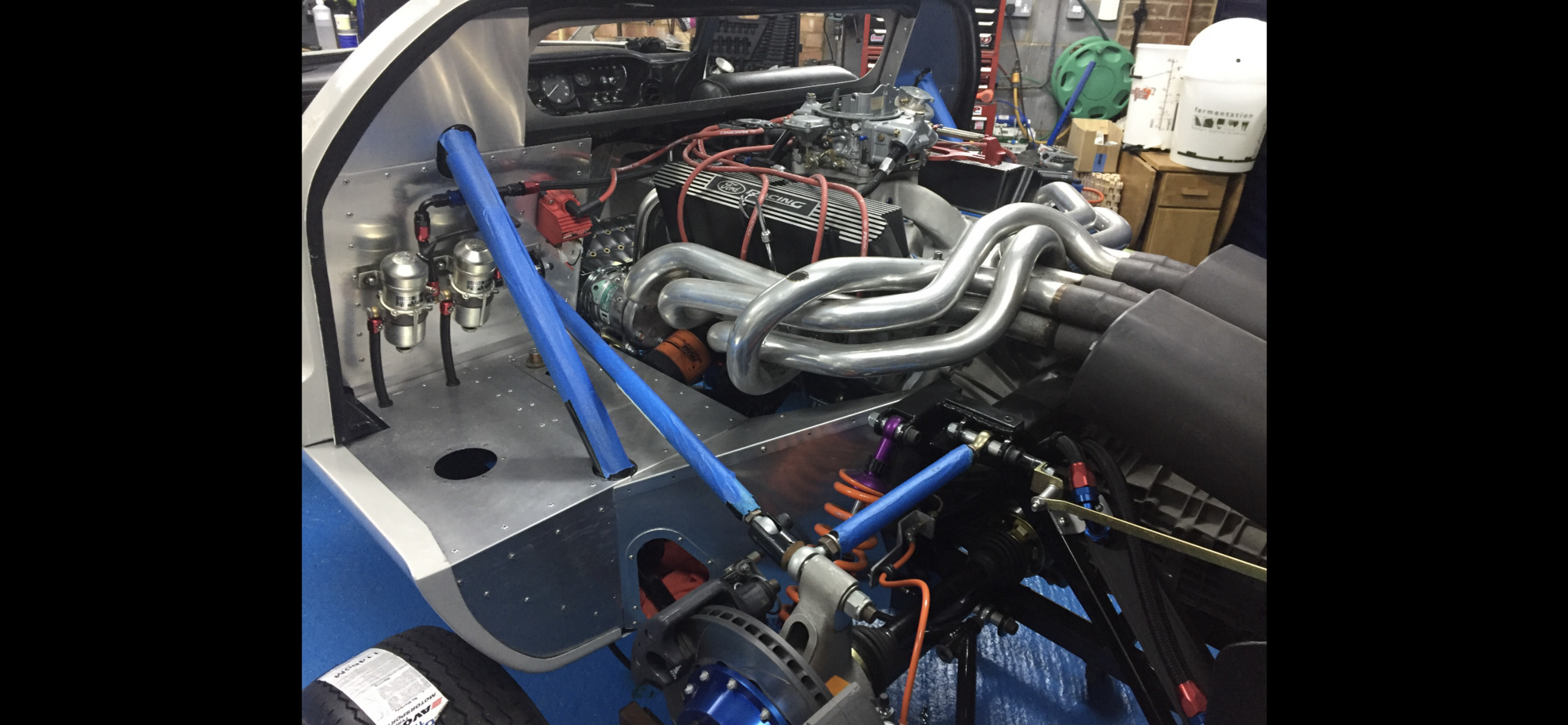

I'm using a pair of SW 240A. Not many road miles yet, but seem to keep up with a few spirited track laps. A bit hard to find, but crop on eBay now and then. Most will need refurbishing.

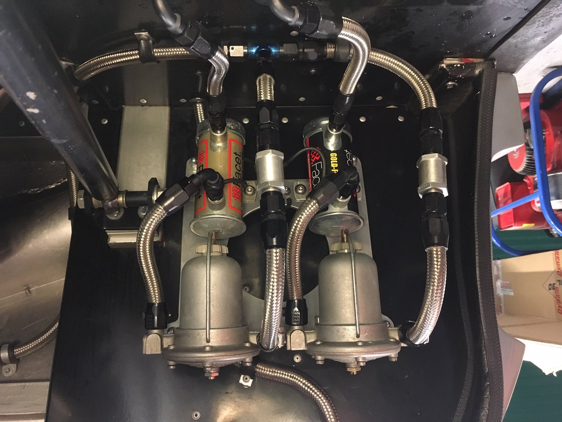

JulianView attachment 98548
Hi Julian
img_4801-jpg.98548
I think I spot the problem with fuel flow...either your pumps & filters have been mounted inverted, or your car has flipped and is currently on its roof!
