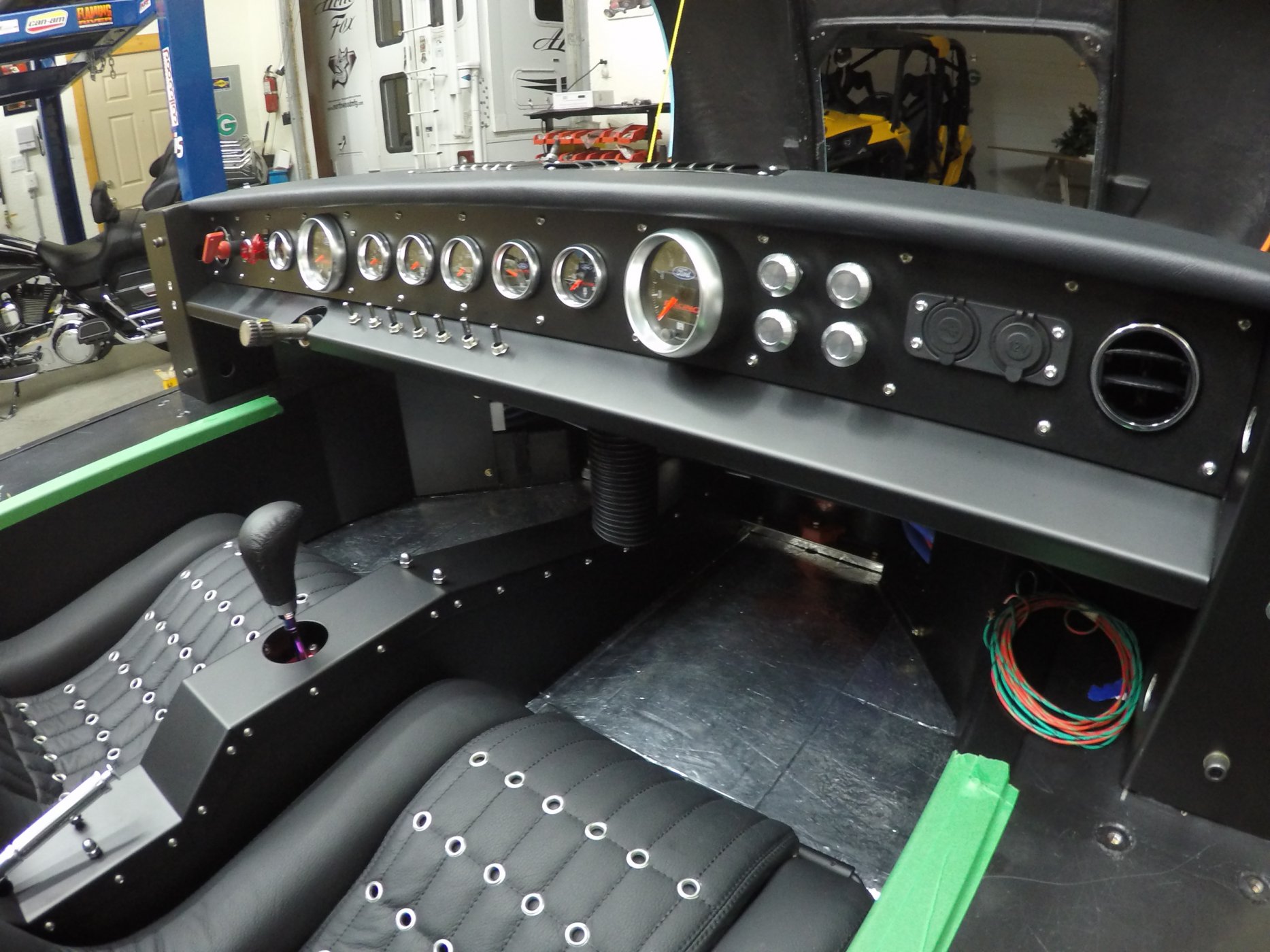

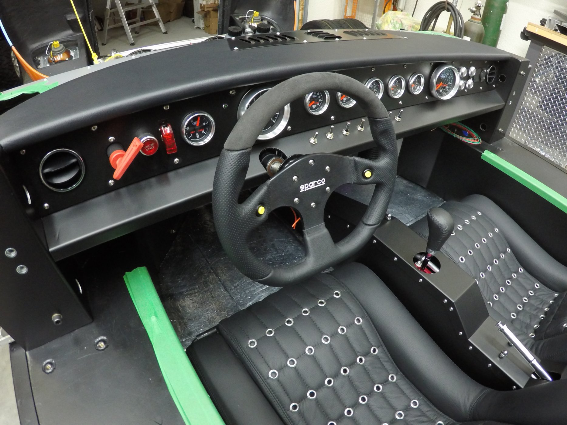

Home made dash ???? The one supplied with my CAV was junk. I would never want to change the body shape .

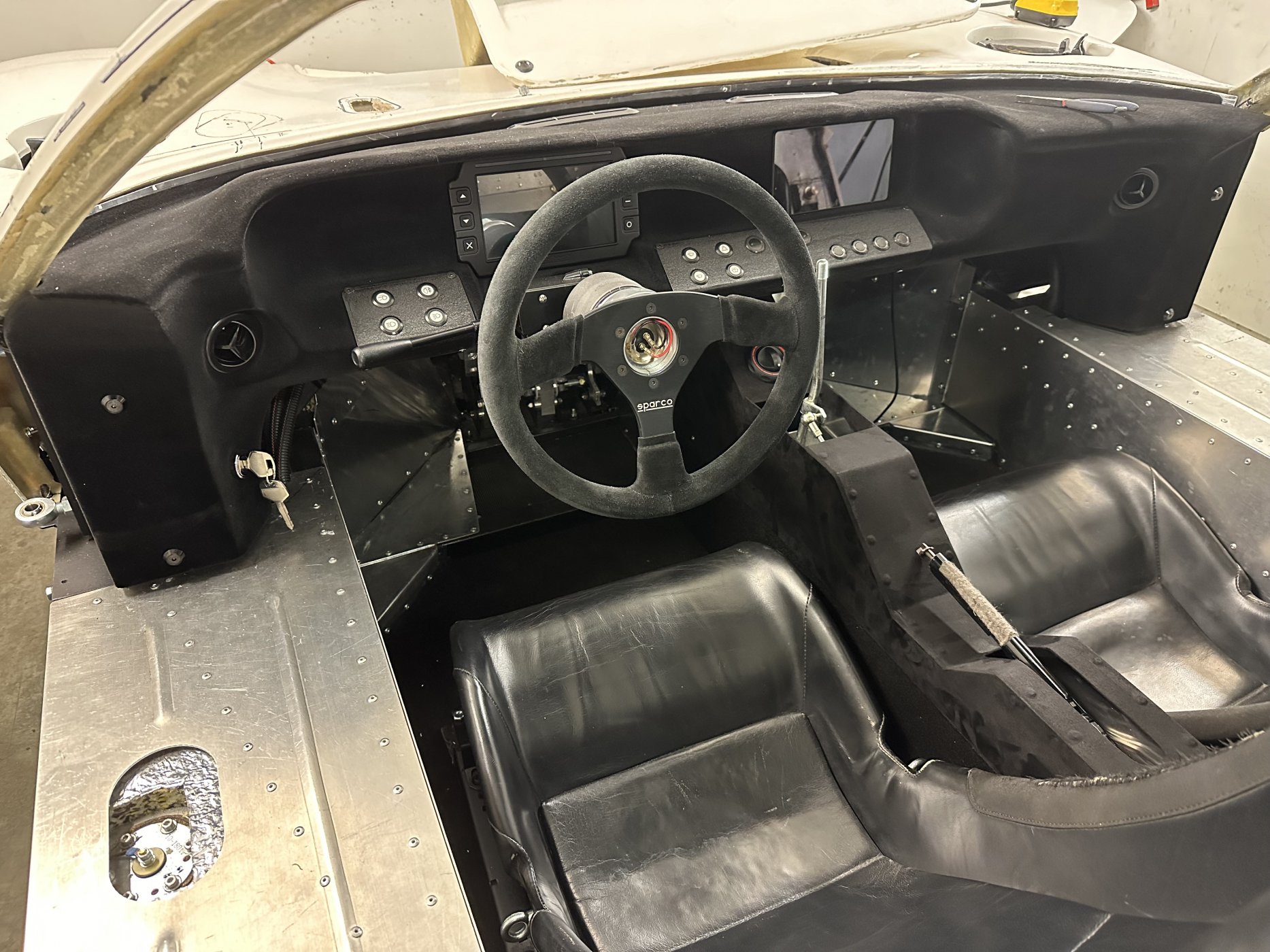

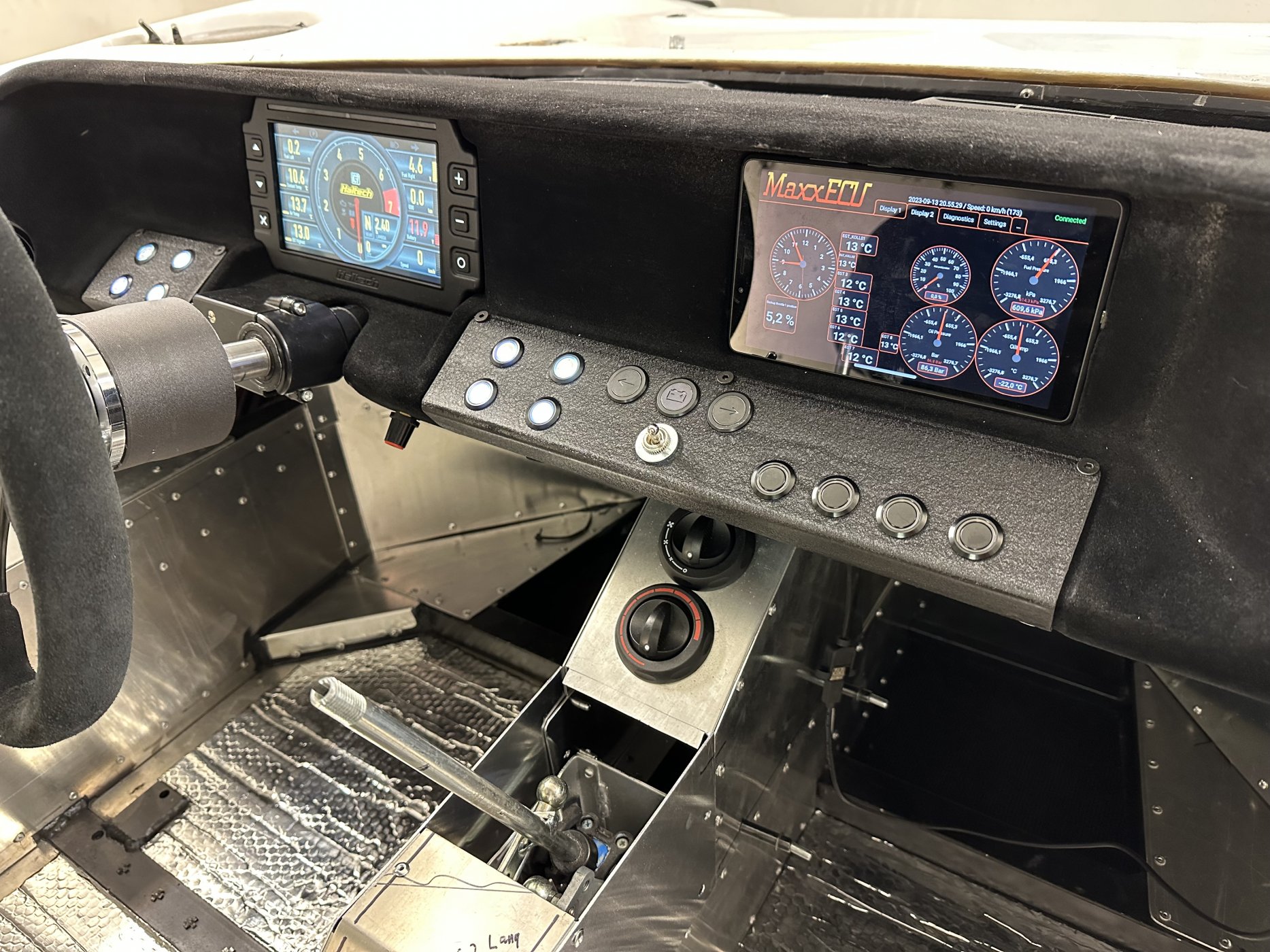

I have done a lot og small things to try to do my own modern version of the Gt40.
One of the things I have done is to skip all the Gauges and installed a Haltech dash and a Lenovo tablet. The tablet speeks with the Ecu(Maxxecu) to show all engine data. The dash talks to the Ecu on Canbus. So all info is possible to display.
