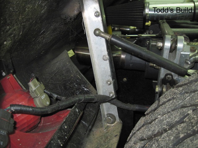

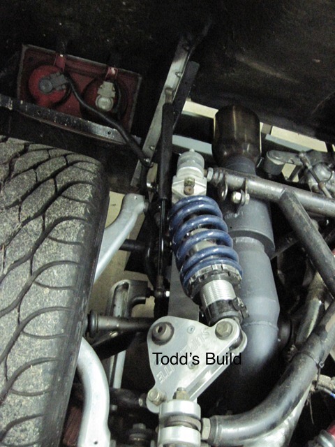

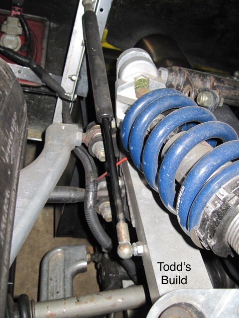

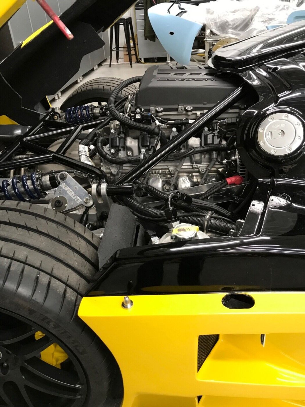

This may help, I think this was a very early build and might have been the first to add struts…
Joel K
Thank you Joel , This gives me some direction. Lois like they added a bracket that pivots
I think he put a bracket there because the rear wheel wells are not installed. I think you can mount the gas strut to the rear vertical surface of the wheel well liners if you have them.

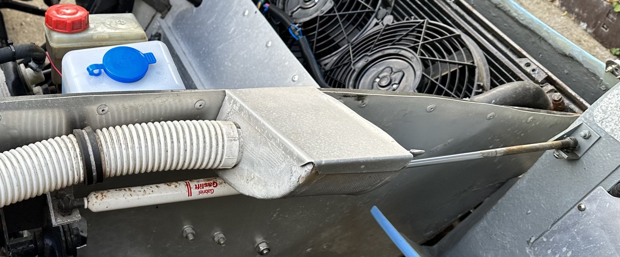

Adrian Starling
Hi Greg, my old KCC struts work well on very heavy old clips. Regards, Adrian

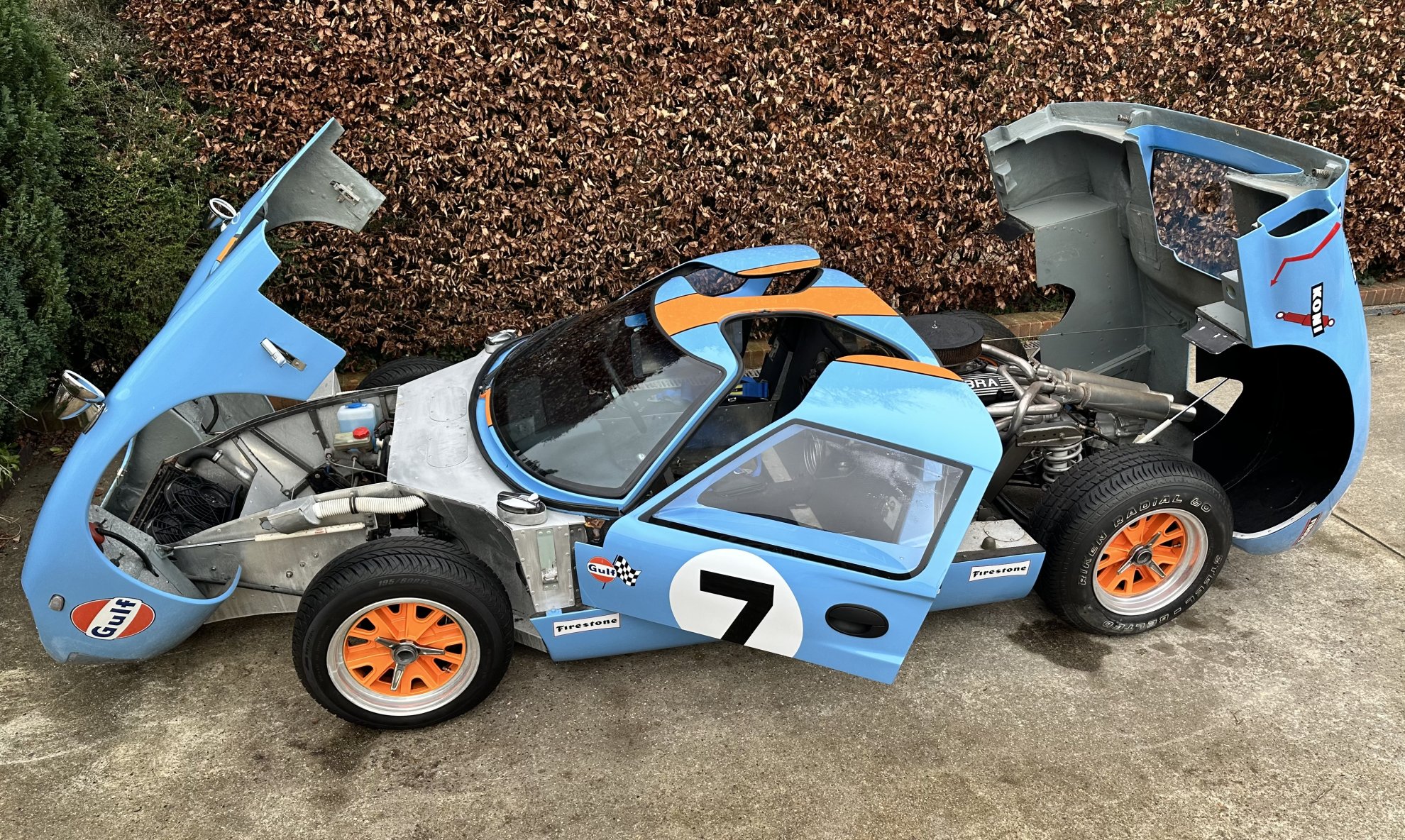

venius
I saw one allens post on you tube where he had the struts bolted to clam .like the pic.... My car also came with the struts also...must be a new addition to the kit

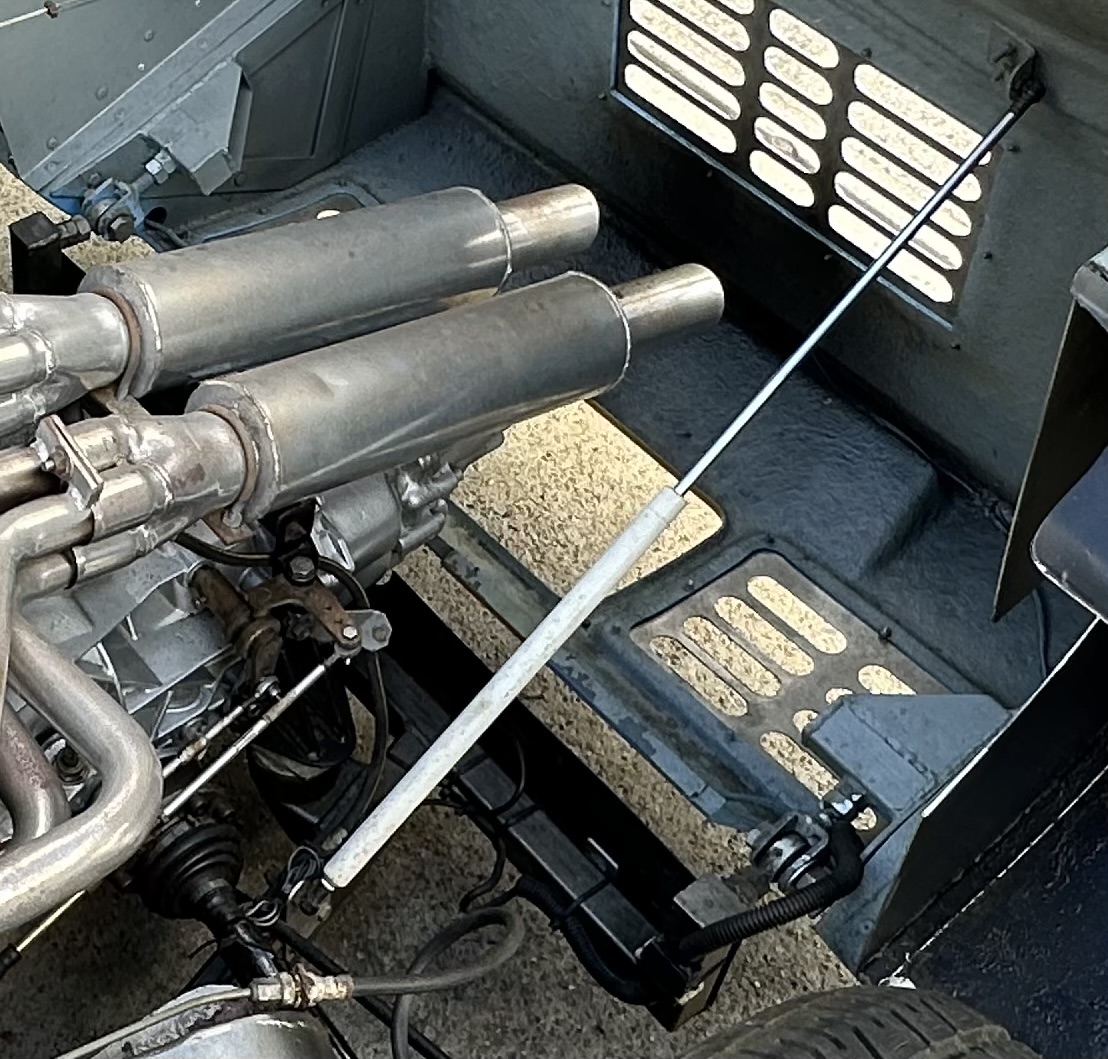

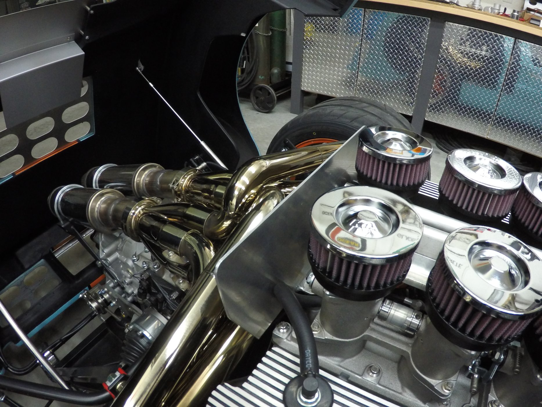

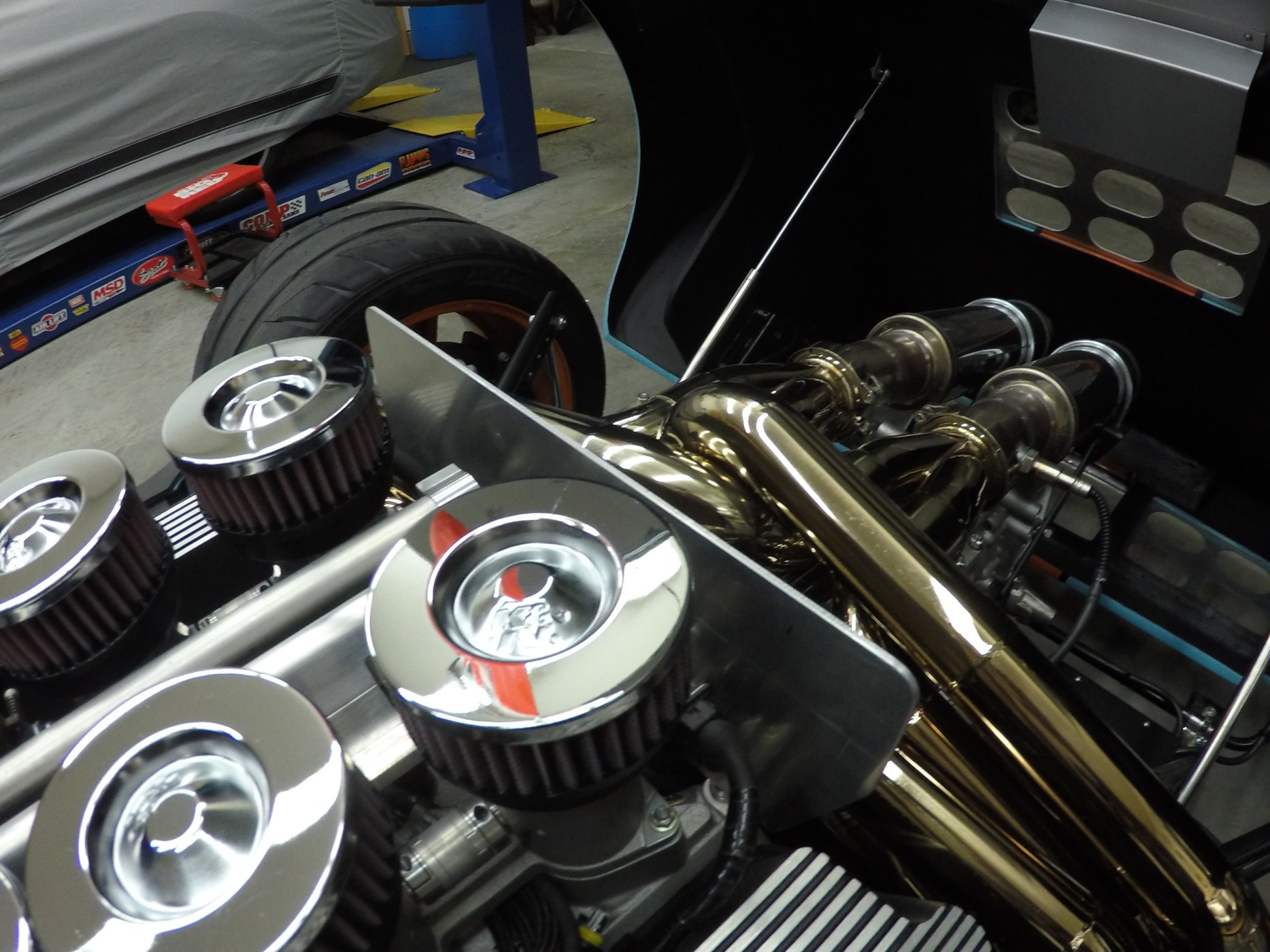

Bill Kearley
Could this idea be what you are looking for !! It works very well for me on my CAV
