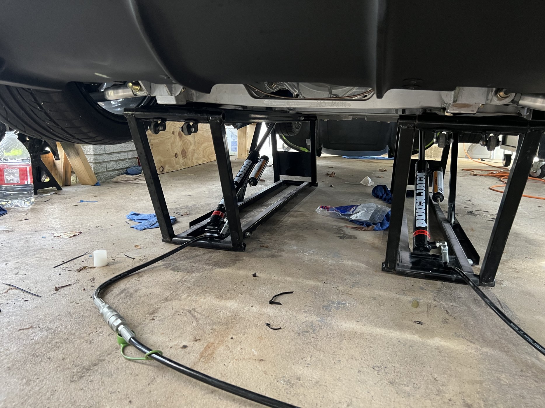

I wouldn’t worry about the wood or the rubber. Just straight on the jacks. Here is my SLC on them. My opinion, but you want as much surface contact as possible. Admittedly I don’t know what the underside of a GT40 looks like but I’m sure there’s plenty of flat spots.
Not that this pic is much help (its all I have here), but I suspect that you’d be hard pressed to tell the bottom side of an RCR40 and SL-C apart...

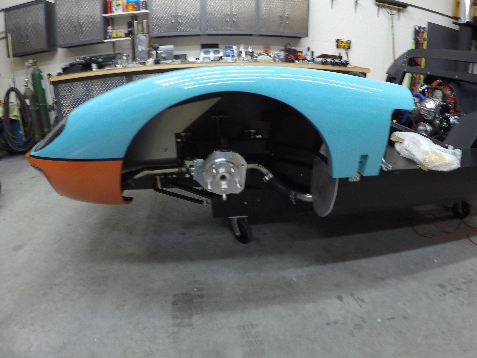

Howard Jones
Better yet, These are at least 25 years old and still being used all the time. High enough to claw under the car, cheap to build, Can be used to move the car around to work on it or simply store it on. I used them to move the car from out under the hoist when I remove the engine/gearbox. Note: buy the cheapest wheels you can find. The weight on each wheel is very low. With a 2000 car it's about 130 pounds each. I used 6-inch wheels.
