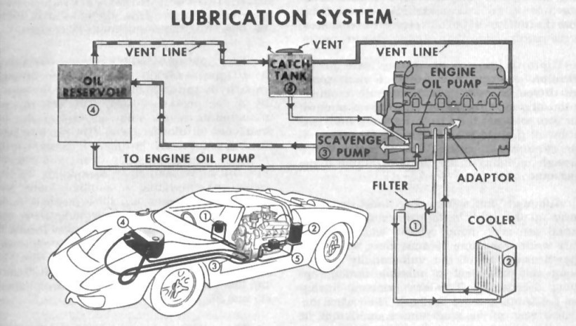

Any pictures showing locations of line routing, catch can(s),type of fittings used, etc... of the original crankcase venting system? I have seen a few shots of vent lines from the rear of the intake manifold. Was that the only vent, must be a fresh air inlet somewhere? Any info appreciated.

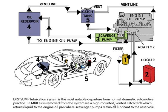

From the SAE papers.
Thank you for sharing those photos. Be carefull with the size of the vent lines if you do not use a dry sump. If you engine is using a standard wet sump, for street application it is sufficient, but in this case the vent line has to be at least of 3/4 inch in diameter and it is prefarable to make a oil catcher on the back of the intake manifold to avoid to loose to much oil in the catch can.
