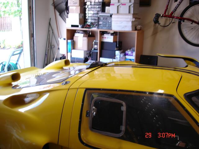

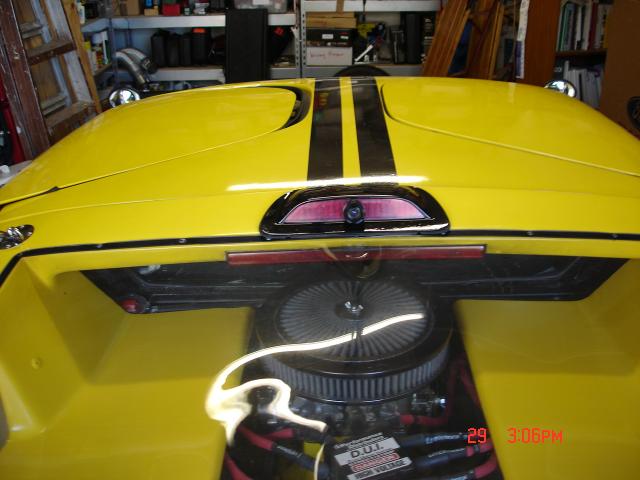

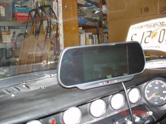

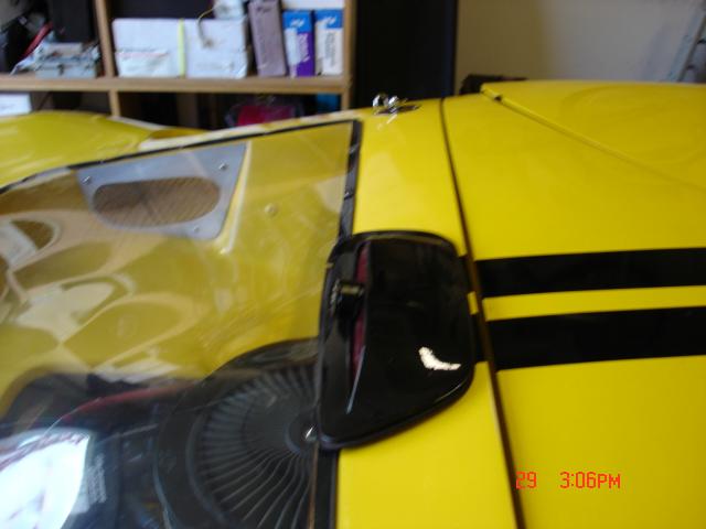

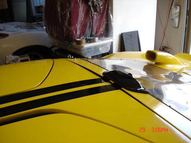

Here is my setup - works fairly well. Gets some vibration because it is mounted on the rear hatch. Also gets some glare when sun is shinning on it!
John
I tried the same type of setup(trial) using the license plate camera from a unit I had on my truck. It would fit the third brake light barely and you could see the strech in the plastic.
What is your field of view?? 90, 120, 180?? I want a good camera(I believe they call them "surface mount") on the top of the car. So it will be a little larger. What kind of pic are you getting with your setup. Is the camera you are using a lp unit? Is it using infrared lights?? Do you think the cameera would be more stable if put on the spyder? I think it would help with the cable run. Most of the shops give a ton of wiring so lenght is not an issue.
If you could, can you give us some of your driving impressions?
