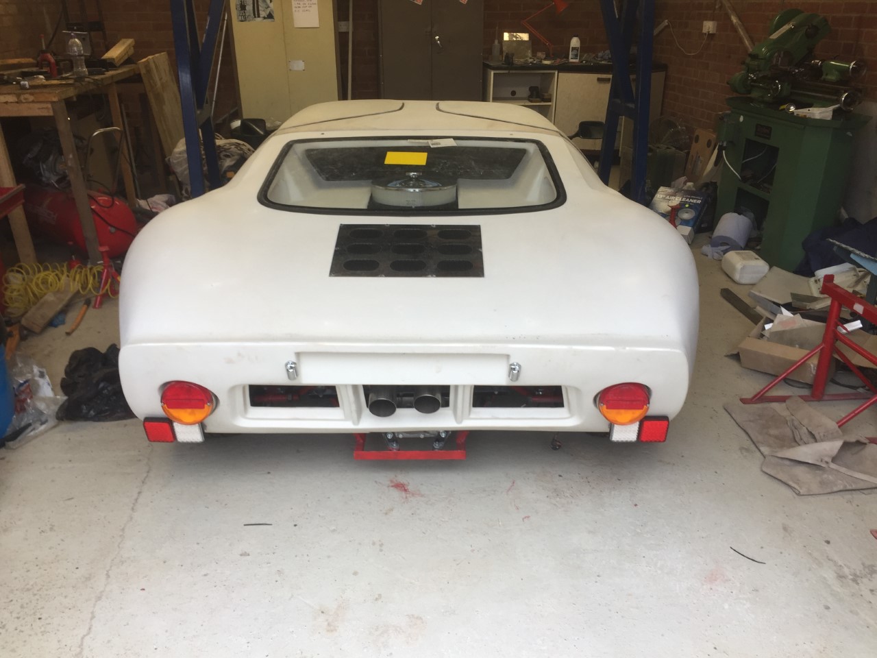

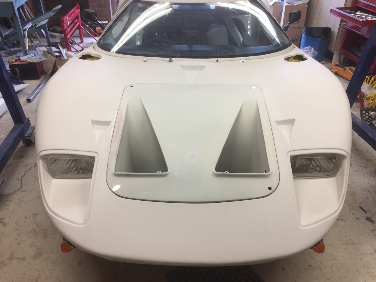

a friend is currently looking for as much infos as possible on KVA replicas,
as he is looking to buy an exemplary that is roughly 90% complete
The kit was bought in 1989, seller has bill in his name and and the VIN stamped in 2021 (dvla)
We dont know much about the UK rego specific requirements, but it would be really helpfull for us to gather as much infos (build sheet, history) for an historical vehicle applyment here in FR
or if any data can be shared (weight... type)
thanks,
Romain

Mike Pass
Does the car have a UK V5 registration document?
Is the car in the UK? If the car has a V5 and in the UK or the previous owners(s) may be known to the GT40 Entthusiasts Club.
The VIN number which is stamped in 2021. Who stamped it and how does this relate to the DVLA?
To better understand what you are dealing with some pics of the front and rear clips would be very helpful.
