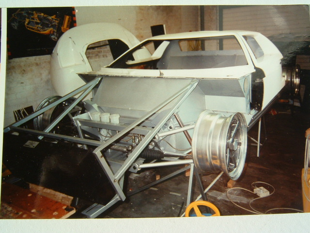

Hi Adrian,
I did all the work on my scratchbuilt GT40 in a garage almost identical in size to your's. As people have said jut need to organize.
Trevor
