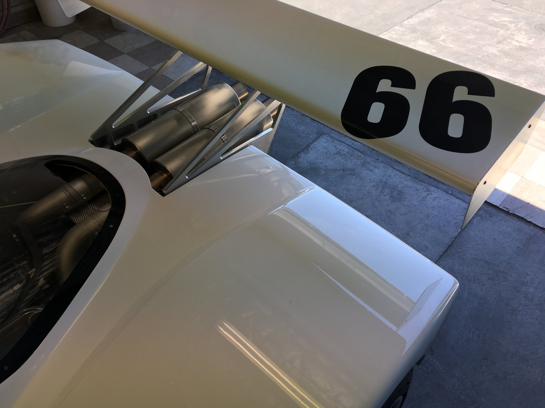

Big reason why my car is white and it wears a number 66

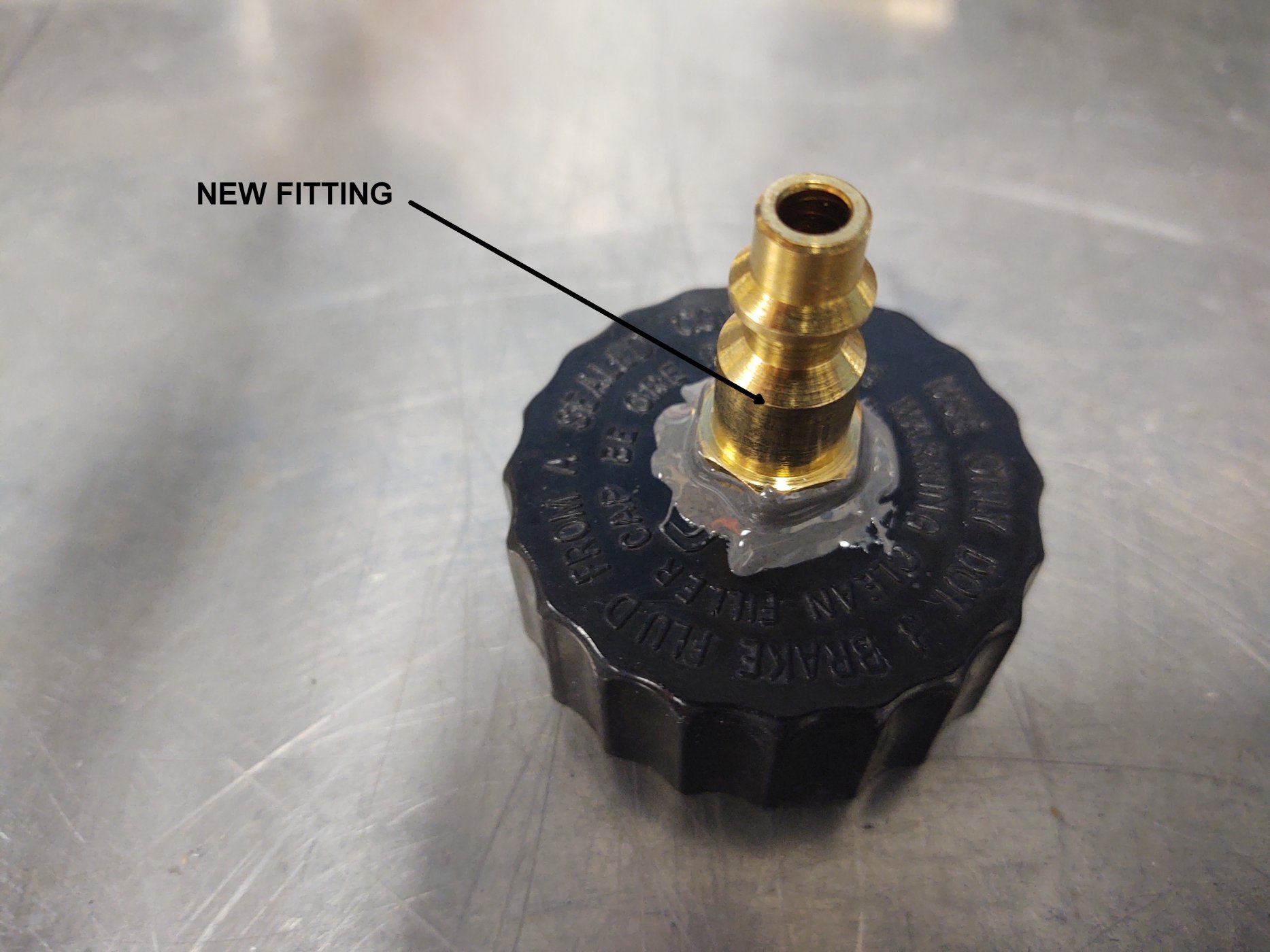

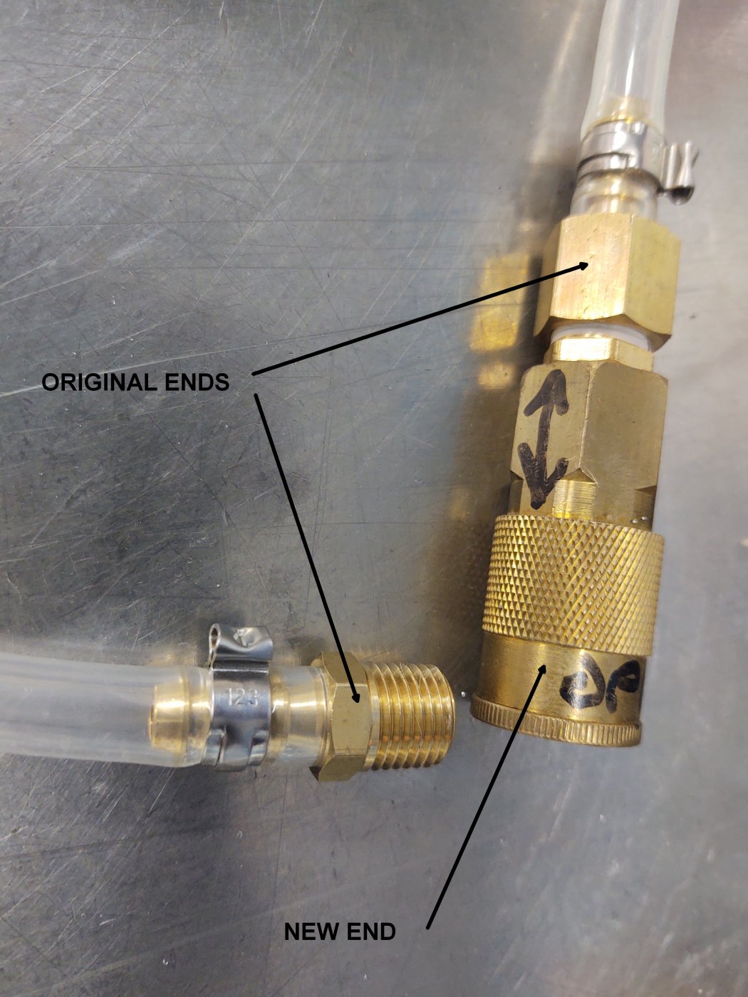

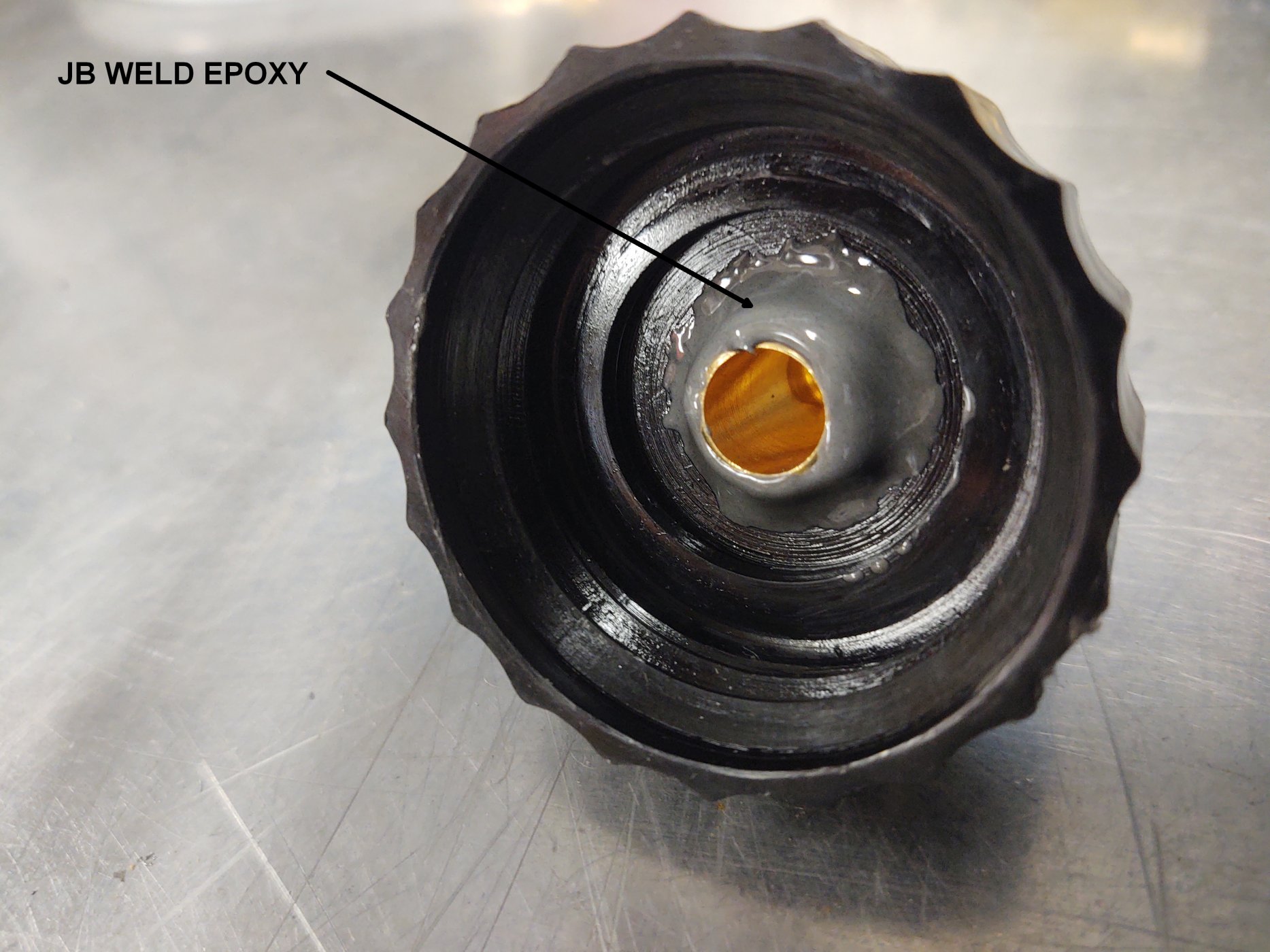

The Motive Power 0100 European Power Brake Bleeder Kit is a basically good idea but is a PITA to use, Why? Here's the problem;
The pressure tank hose is provided with a male brass 1/4 NPT fitting that is intended to screw into a female brass 1/4 NPT fitting on the end of the hose connected to the fluid reservoir cap. Simple, right?
No, screwing the pieces together winds up the hoses since there is no provision for rotation- the plastic hoses are crimped on both ends.. Screwing the two hoses' pipe threads together first and then threading on the cap winds up the hoses. too. A simple modification will solve this problem. Here is how:
Thread an air hose fitting on the tank hose end. Seal the threads with Teflon tape.
Buy a replacement brake fluid reservoir cap or sacrifice your original cap.
Drill a 1/2" hole in the center of the cap with a step drill and thread in a 1/4 NPT fitting as shown in the photo. This will probably seal in a plastic cap but for added insurance against leaks I added some JB Weld epoxy around the threads inside and out.
Now you can screw on the cap, connect the push-on fittings and pressurize your master cylinder. No tangled hoses!

similar mods on mine. One bummer is that my nice machined aluminum adapter for the Girling reservoir is no good - apparently Girling changed the thread sometime around 2010, so if you have an old one, you'll need to make a lid out of an old cap.

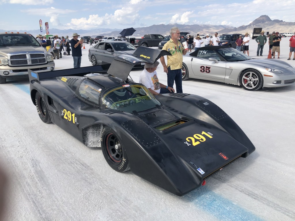

One more picture from last year. I'm in the car waiting in the staging lane behind the start line. My friends were helping me as my "crew"- Wayne Luddington sitting on the door sill and Charlie Strickland standing in the yellow shirt. This year there was 12" of rainwater on the course. :mad:

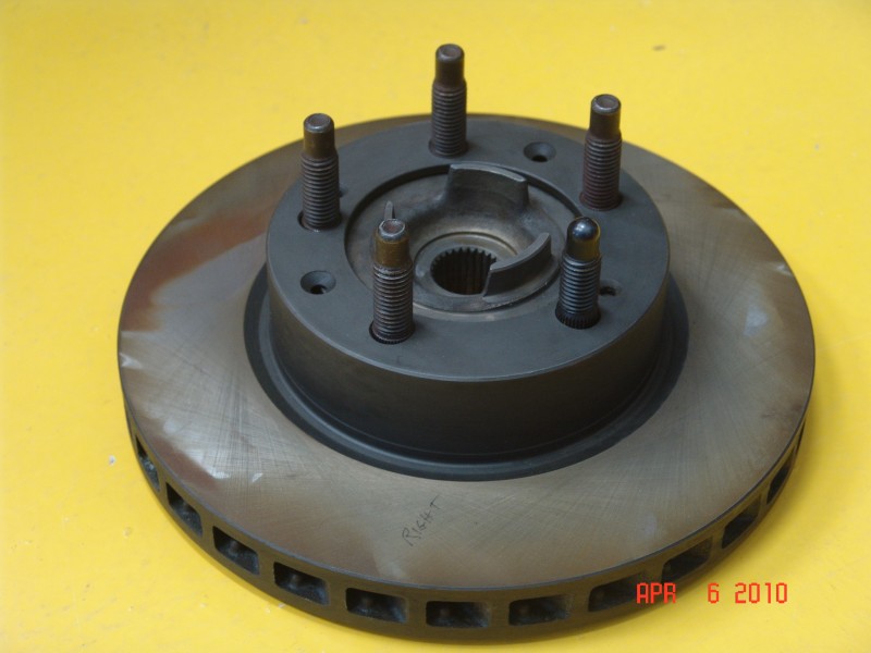

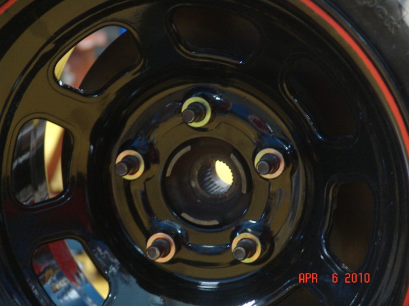

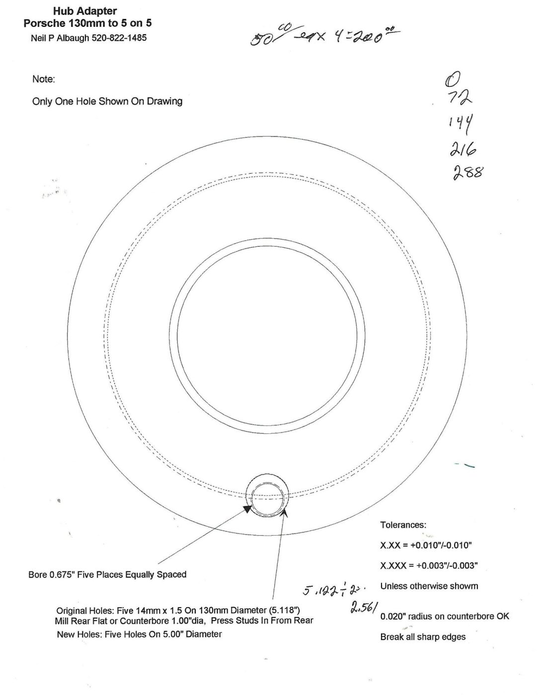

When I was building my black Mirage for Bonneville, I needed to use SCTA compliant wheels. Aluminum or magnesium was out due to salt corrosion but painted or powder coated steel wheels were OK if they were 100% welded all around. It turned out that wheels made for circle track racing met that requirement and they were cheap and lightweight. The problem facing me was that my Porsche 996 hubs has a 130mm wheel bolt pattern and the circle track wheels only were available in a "5 x 5" pattern ( 5 studs on a 5" diameter bolt circle)
I plotted out the patters on CAD and Surprise!- the patterns were almost the same! With 5/8" diameter wheel studs the wheels would fit with only a slight bit of machining. It worked out great!
Neil

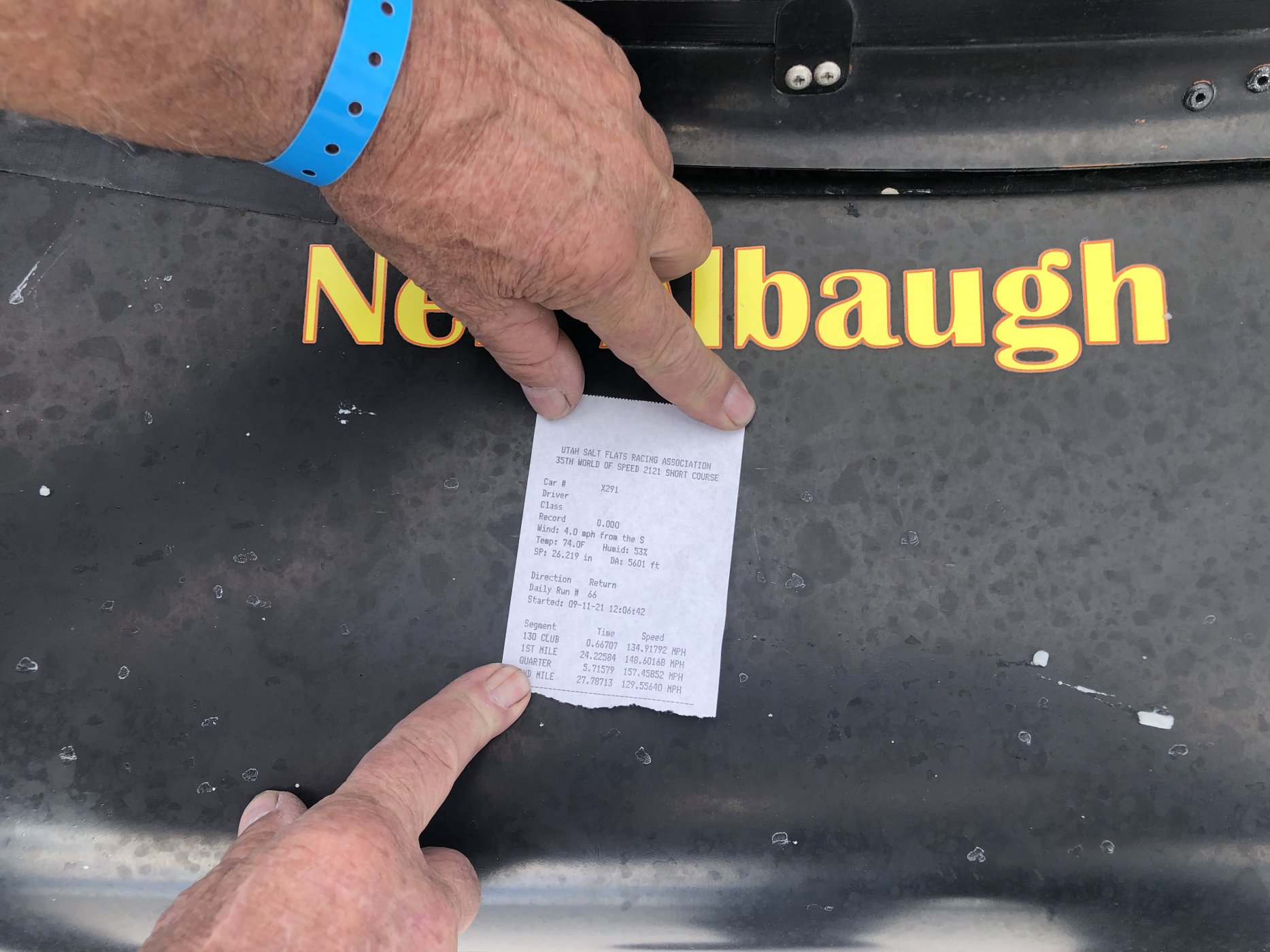

The last TWO YEARS Bonneville has been rained out and I'm getting anxious. Here is what it is all about-
Staging lane preparation.
Ready.
At the starting line.
Starter is checking to hear if the course is clear.
The result- no prize money, no TV contracts, no trophy, just a timing slip and the satisfaction that I did it.
