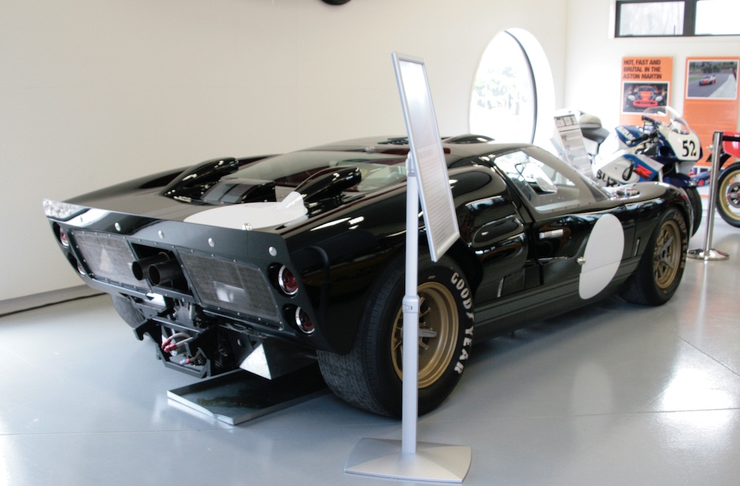

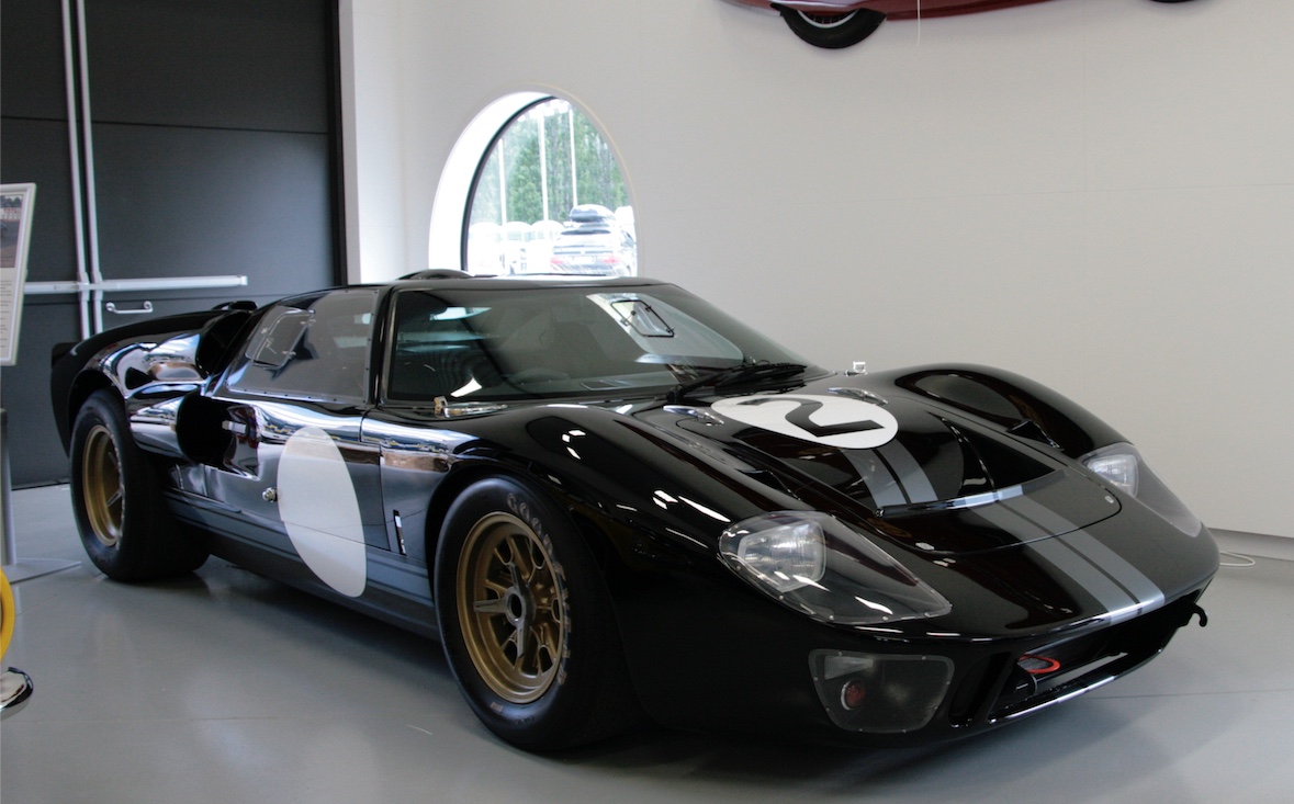

Pathfinder Motorsports (www.GT40Racing.com) recently finished building a clone of the 1966 Le Mans-winning MKII GT40 chassis 1046. You'll recall that this was the same car that was driven by Bruce McLaren and Chris Amon to their historic win at Le Mans.
This project took Pathfinder Motorsports and our partner Holman Moody over a year of collective effort to build and deliver to the new owner in New Zealand what we believe is an accurate recreation of GT40P/1046.
We began this MKII build using Superformance chassis GT40P/2289. Pathfinder commissioned a Le Mans-spec Holman Moody dry sump 427 FE side oiler. This engine was built by Jimmy Tucker, who has worked as the go-to engine-man at Holman Moody since the Le Mans days back in the '60's.
Pathfinder then sourced dozens of authentic and period correct components, including a 1966 front mounted oil tank, a rare T-44 transmission, original Girling brakes, original Ford roundel lights, Pathfinder recreation GT40 racing seats, correct Stewart Warner gauges - including the Jones-style tach, and much more.
The Holman Moody shop then had their long-time chassis man, Jim Rose, assist in making other period correct mods, including the FIA mandated aluminum suit case boxes to the left and right side of the exhaust; an under-dash brake handle; and, a correct shift box with lock out. Jim worked with John Wyer back in the 1960's in developing the GT40, Jim himself owning one of the rare light-weight JW GT40 MKI's.
Our client is very excited to have his car on its way to New Zealand, but this story gets better: The new owner is good friends with Chris Amon, the second driver behind the wheel of P/1046 during their historic first win for Ford. Chris is scheduled to race the Pathfinder P/1046 clone at a vintage race event later this year in New Zealand. (We will soon add Chris to the roster of racing luminaries who have driven Pathfinder GT40s and the Pathfinder-designed GT40Rs, including Bobby Rahal, Derek Bell, Bill Adam, Divina Galica, and others.)

A great build . The only thing that gives it away is the GT40 steering wheel . Correct me if I am wrong but the MKII had a black cushioned centre on the steering wheel.
Regards Allan
Hi Allan,
I think that cushion centre may of been part of the MkIIb changes, along with the 'MkIV style' dashboard & roll cage etc.
Regards Steve

I'm no expert here, anyway some smart comments - no doubt this is a great built.
However if you know a Superformance same detail catch your eye right away e.g. dash vents, center console, starter button, plastic cover on sill to cover wiring harness (at least on one pic), apperance of control arms (including marks to indicate bolt was torqued).....

I looked at the car a few times when it was still here in NZ, and talked a number of times with the owner. Even pointed him in the right direction a couple of times when tracking down such things as decals and so forth. Gave him a copy of the 1966 Le Mans soundtrack LP to go with the car. I'm not sure if that went with the car when it sold.
It is a very well executed replica and had a decent amount of money spent on it to try to build a faithful tribute to McLaren and Amon, including being finished by Holman and Moody in the US. The T44 is worth a bit on its own. However, as Markus points out, there are a number of little things that give away the fact that it has Superformance origins.
That being said, it is a lovely car and I would make room in my garage for it in a heartbeat. I was originally going to paint mine in the same livery, but when Grant told me his plans I changed my mind. After all, we can't have two 40s in the same livery residing within 200 km of each other... ;)
