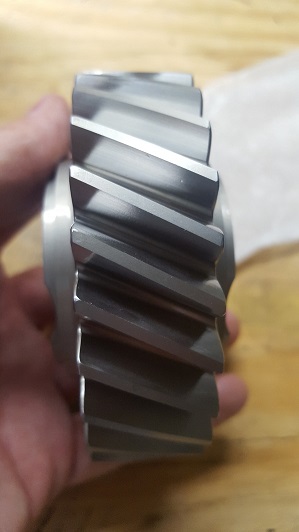

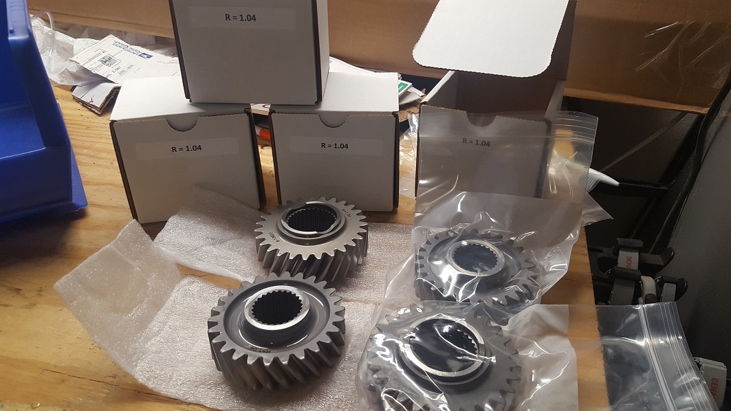

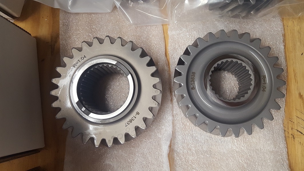

Picked up the gears today. They turned out great. I still have 1 available, if anyone's interested.
Best,

Got my gears today, they look great! Thanks for being the guinea pig on that earlier set and for making this new ratio available. I'll hit Brian up for install once I've had a chance to shake down the car (whenever that may be).
