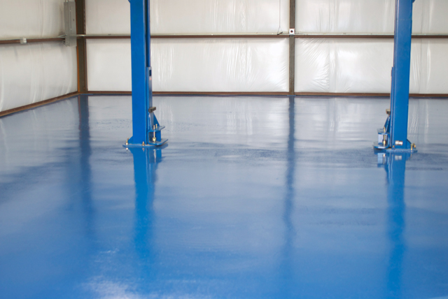

At long last, I finally have electricity/water and completed my epoxy primer/2 part urethane floor coating! Now wait till next weekend to move shop tools and car. I'll work on assembling the lift as I go along....:thumbsup:

BTW, the flooring is from Armorcoat.com. As with any paint job, the preparation of the concrete flooring is most important. And in 108 degree weather, I can tell you it was physically demanding for this "gray-pelt"!
Happy to Dalton,
Wet the floor down and pour a 4:1 water:muriatic acid mix on wet floor. It will foam up on contact. Scrub surface with a stiff bristle push broom and don't let the floor dry. Rinse with fresh water (you can put vinegar in water to help neutralize the acid but I didn't). A power washer would be best tool but I used a contractor's garden hose. Rinse about 4 times, always scrubbing with the broom, or until your arms fall off.....whichever comes first.
Mix epoxy primer A and B. I had 2 gallons each and mixed 1/2 to do the first half of the floor just to be sure of the coverage. Cut in the edges/trim with a 4" brush first and them apply to surface with a large low-nap roller on an extension handle. You have about 2 hours pot time.
Mix the Urethane topcoat parts A and B (I had 2 A's and one B gallon). Roll on the topcoat with a new roller. I had just enough for the 1200 sq ft. Don't walk on for two days and don't drive on for at least 5 days.
As I implied, scrubbing the floor in the heat was not fun but worth it I guess.

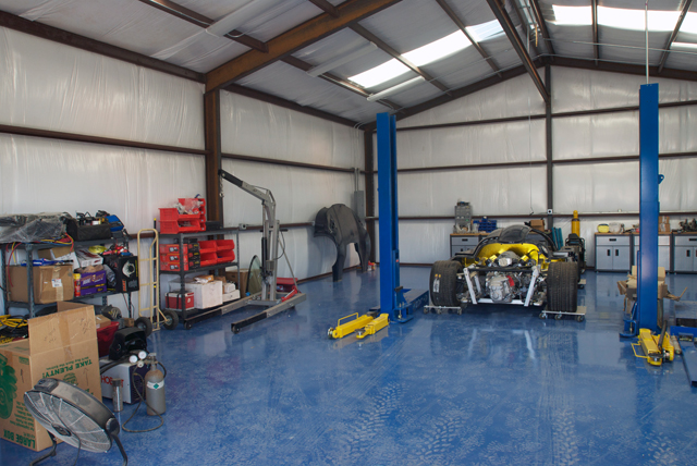

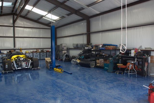

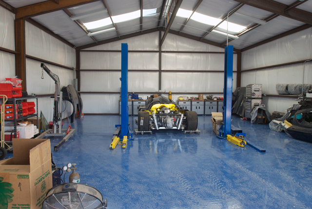

I finally got the car moved into the shop. I still need to finish the rigid air tubing for the compressor (compressor still in Lone Oak), finish the 2-post lift, 2 more cabinets on back-order, need to order the shop HC. But, at least I got to turn a wrench again! Such a long hiatus from the build made it feel like I was taking over someone's unfinished project!

Absolutely superb Doc. I didn't realise just how large it was until you posted the photo of the SL-C inside. Congratulations!
