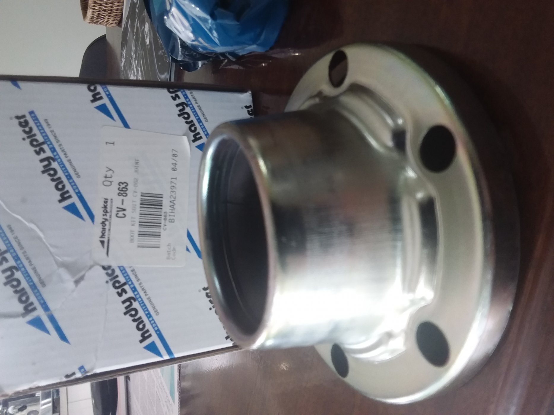

I Couldnt confirm if the 930 porsche boots are the same . I purchased the complete CV jionts from a local drive line company who has subsequently stopped trading. My set up is totaly unique from the transaxle through specialy made axles to Frod falcon XR 8 rear wheel assembly .please see picture of the boot I think may be OK note the boot has been inverted into the housing.

I can't find any useful dimensional information on that Hardy Spicer part number. The 930 is a 108mm diameter with 94mm bolt circle or a Type 1 CV is 94mm diameter with 78mm bolt circle.
The following may be of help in determining which type CV joint you have;

I dug up the info on my 930 boots - let me know if it helps:
CV boots (Autozone P/N 1094)
$40.20​
CV Boot banding tool
$15.45​
CV Boot Bands (4)
$9.37​

But they don't look like the flanges you have there.
Fits my 930 CV fine..
