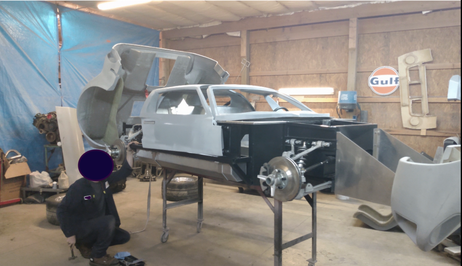

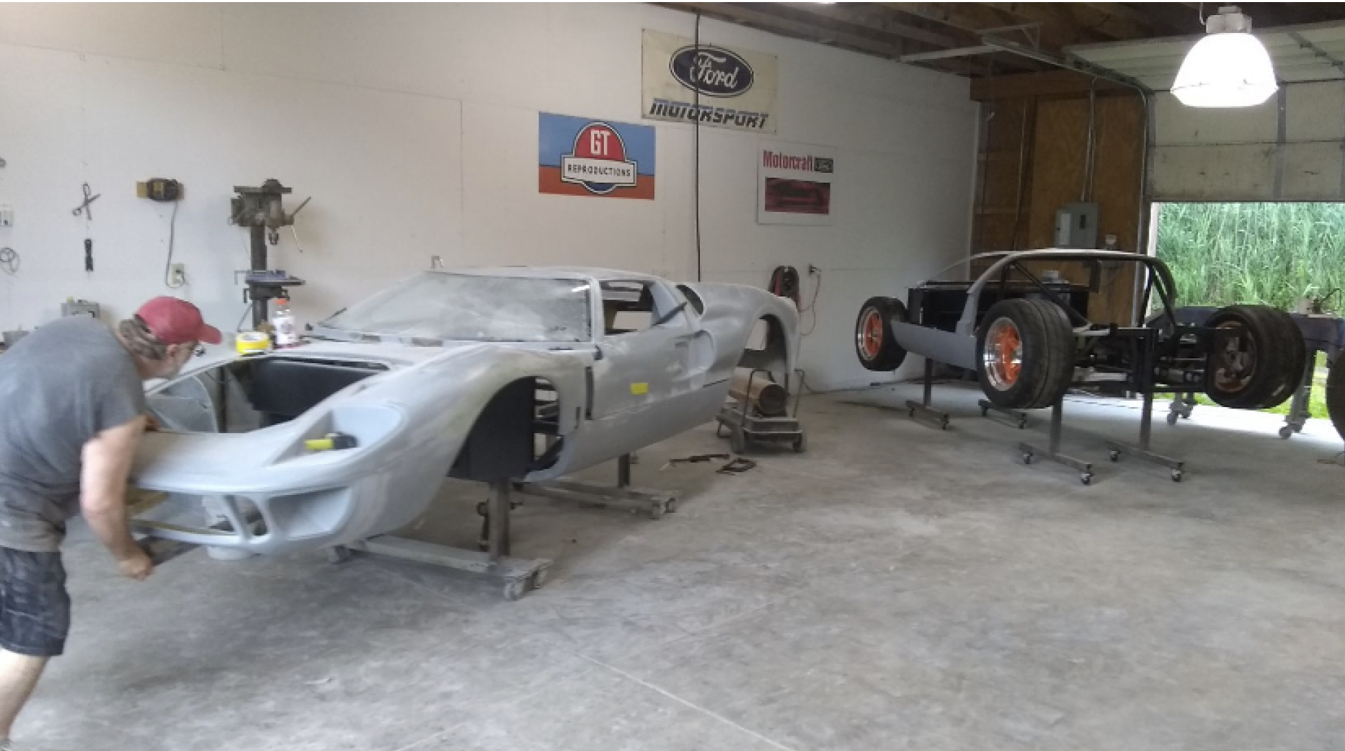

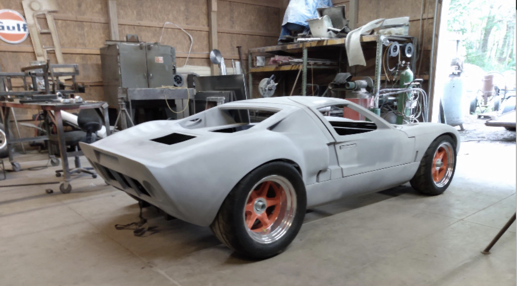

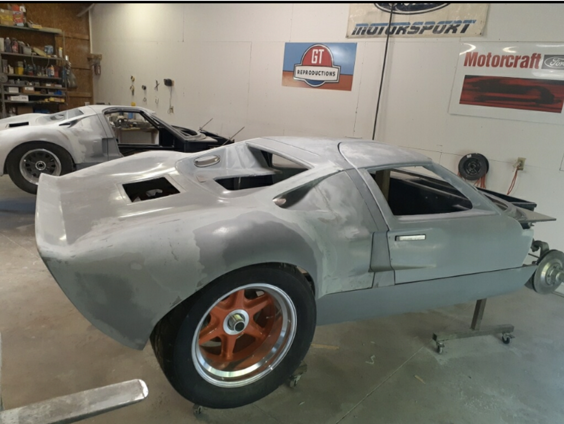

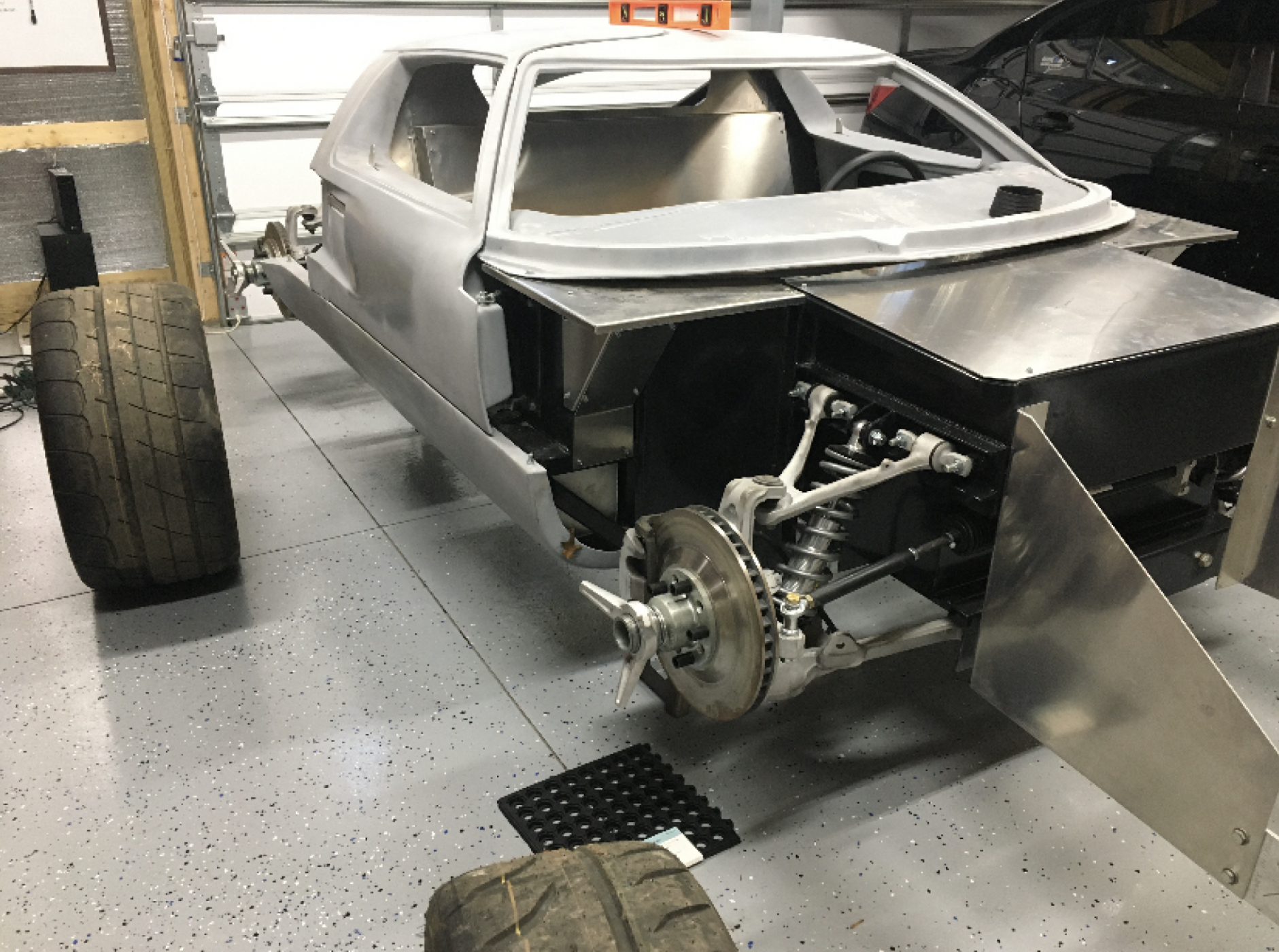

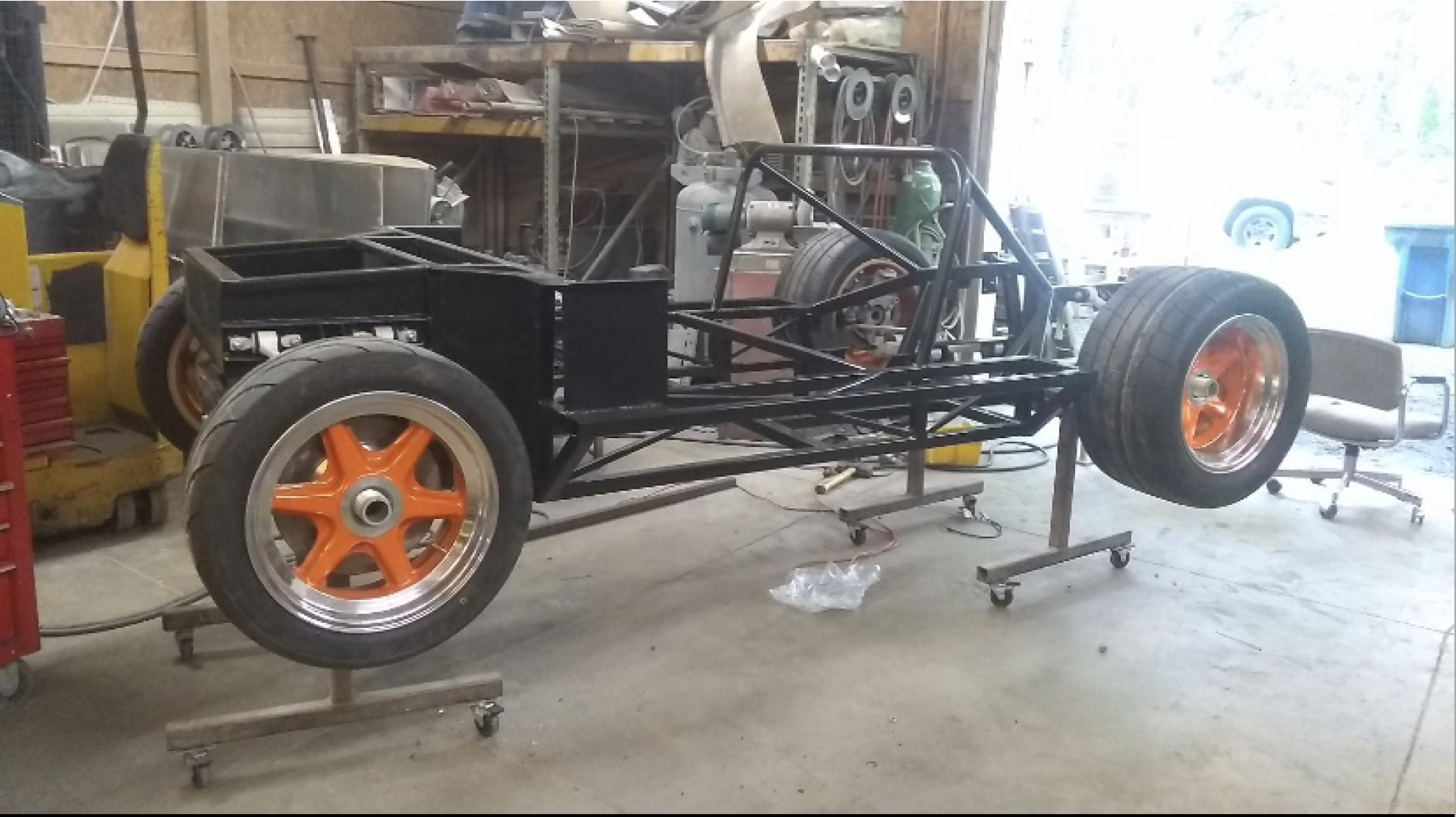

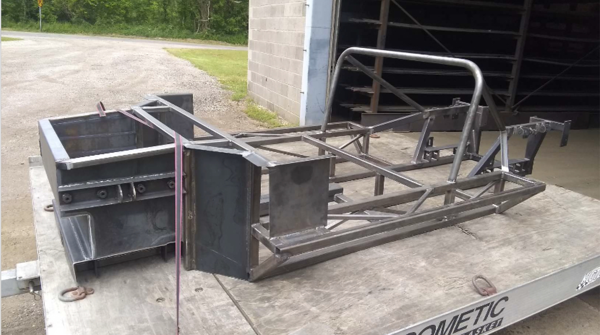

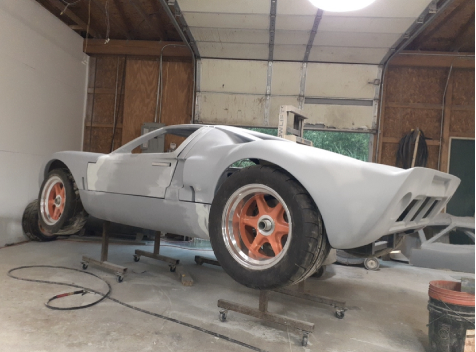

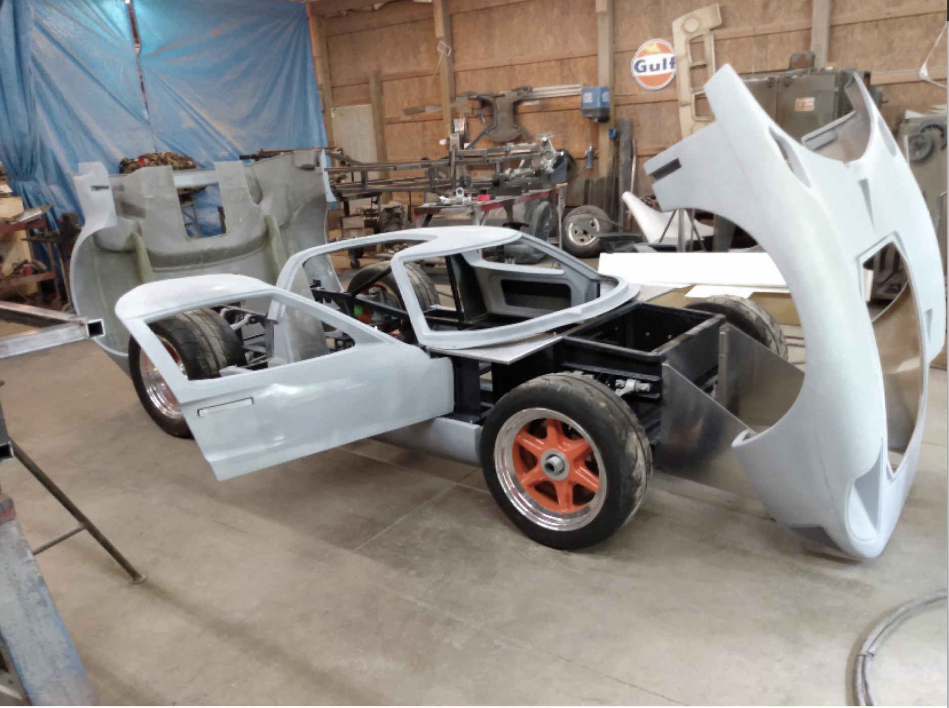

OK. A bit more information about my car:
Based on the John Wyer 1075 car with the 3" flares. This car is WIDE in the rear and I love it. Measured it at 79", which makes it wider than a Testarossa.

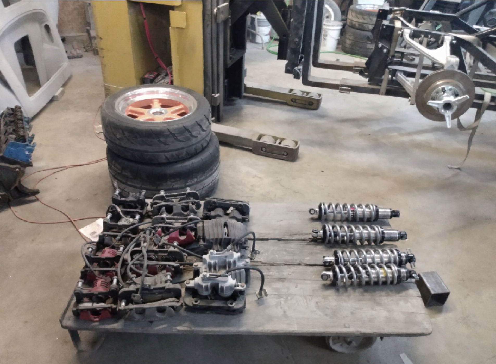

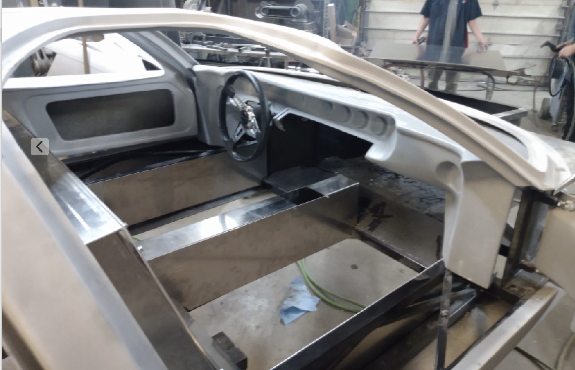

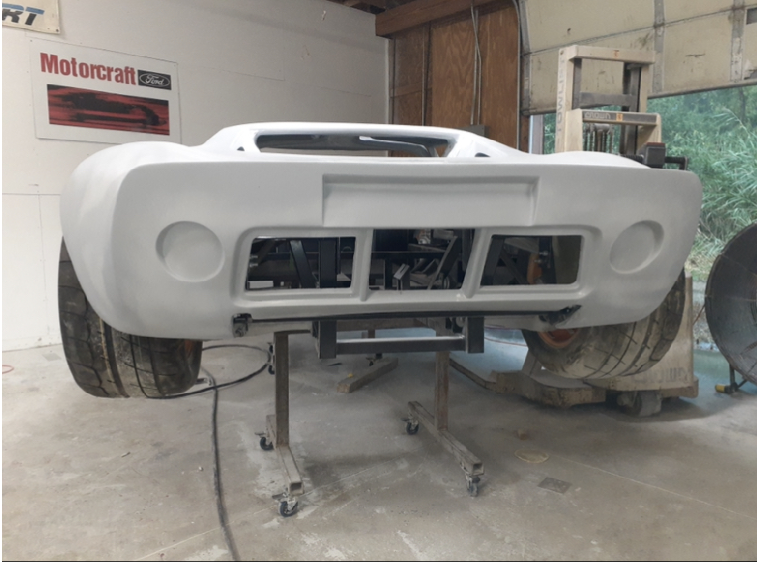

Some pics from Chris during the build process. Chris' communication was superb and he would send photos of the progress throughout the course of the build

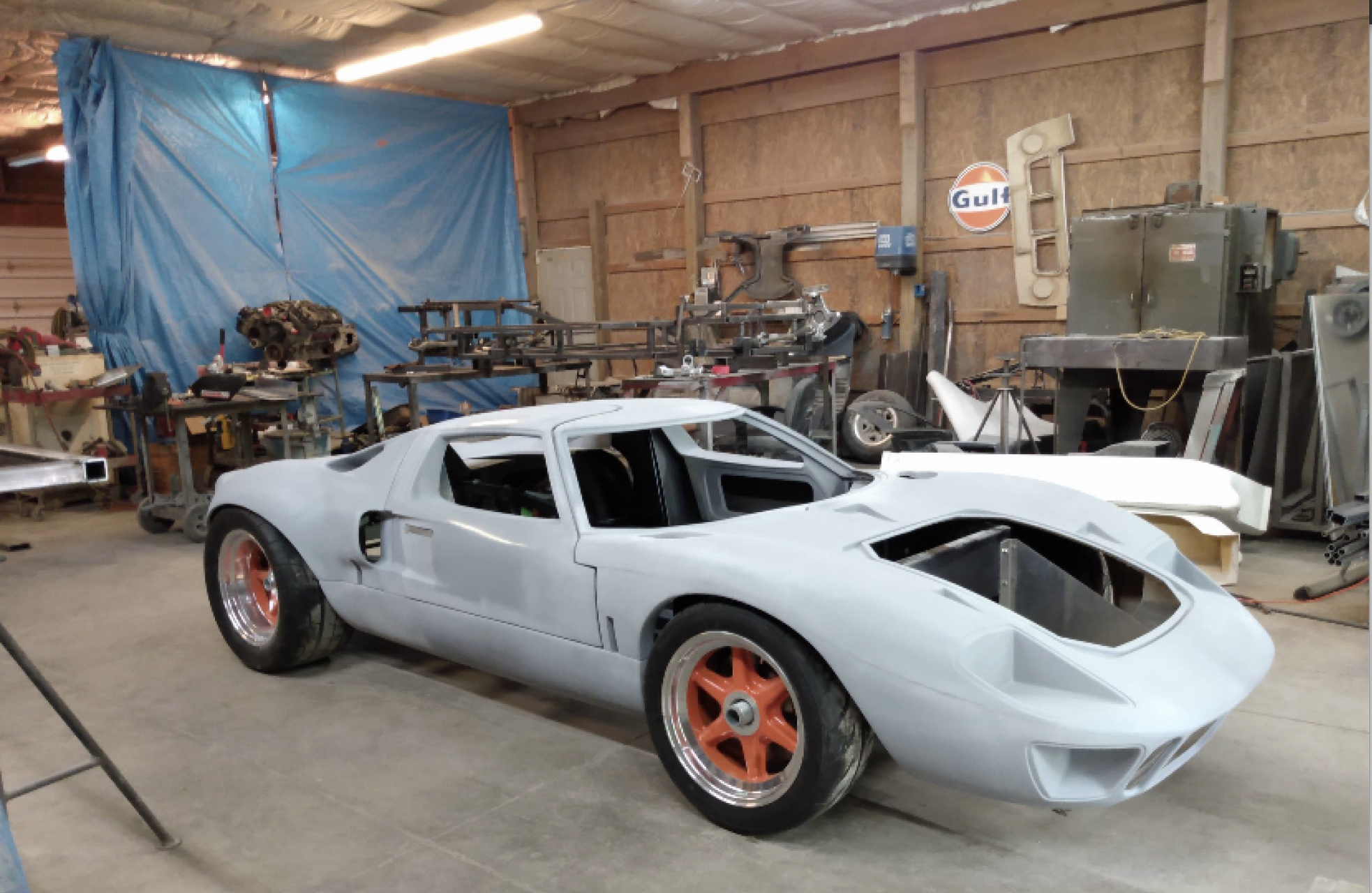

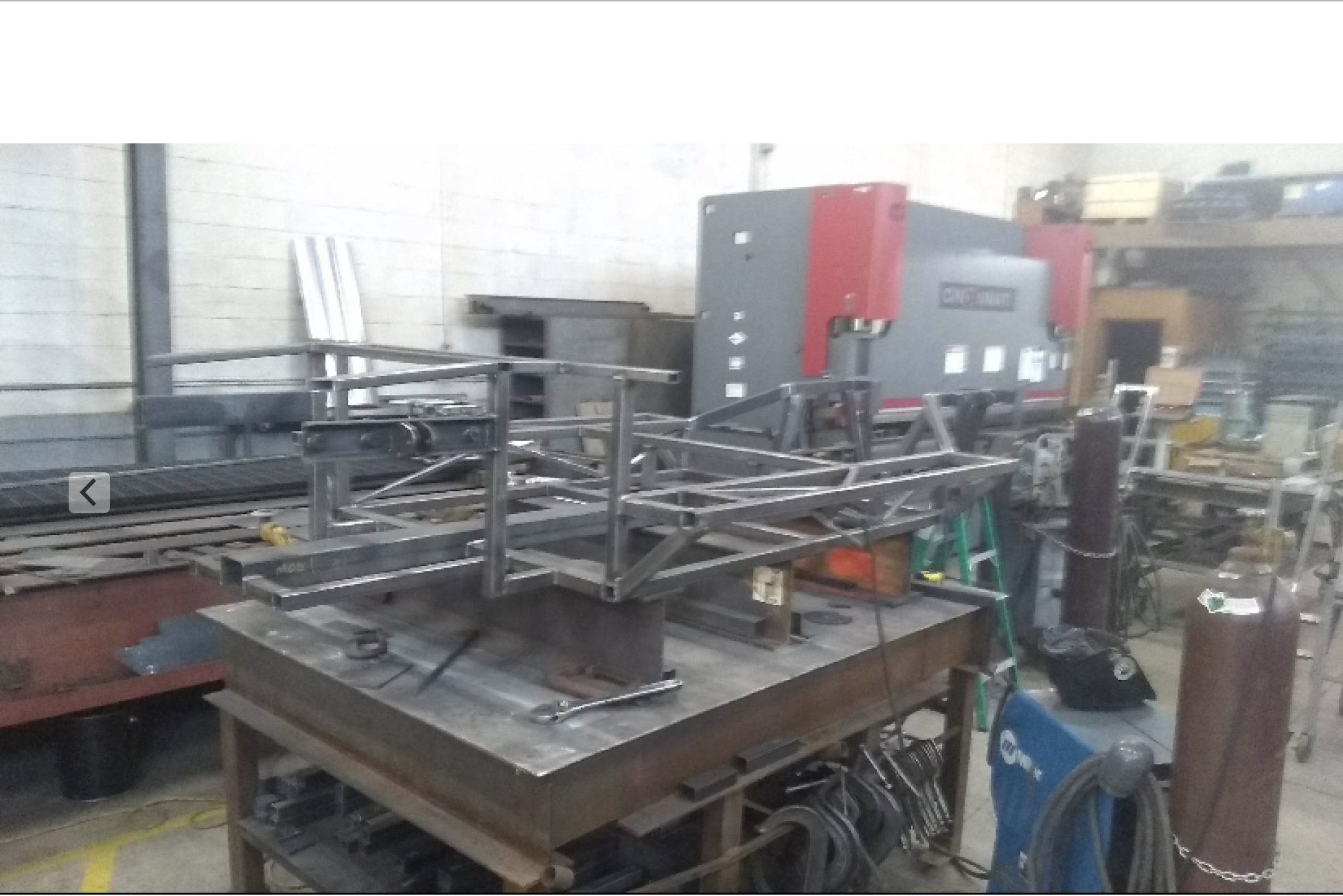

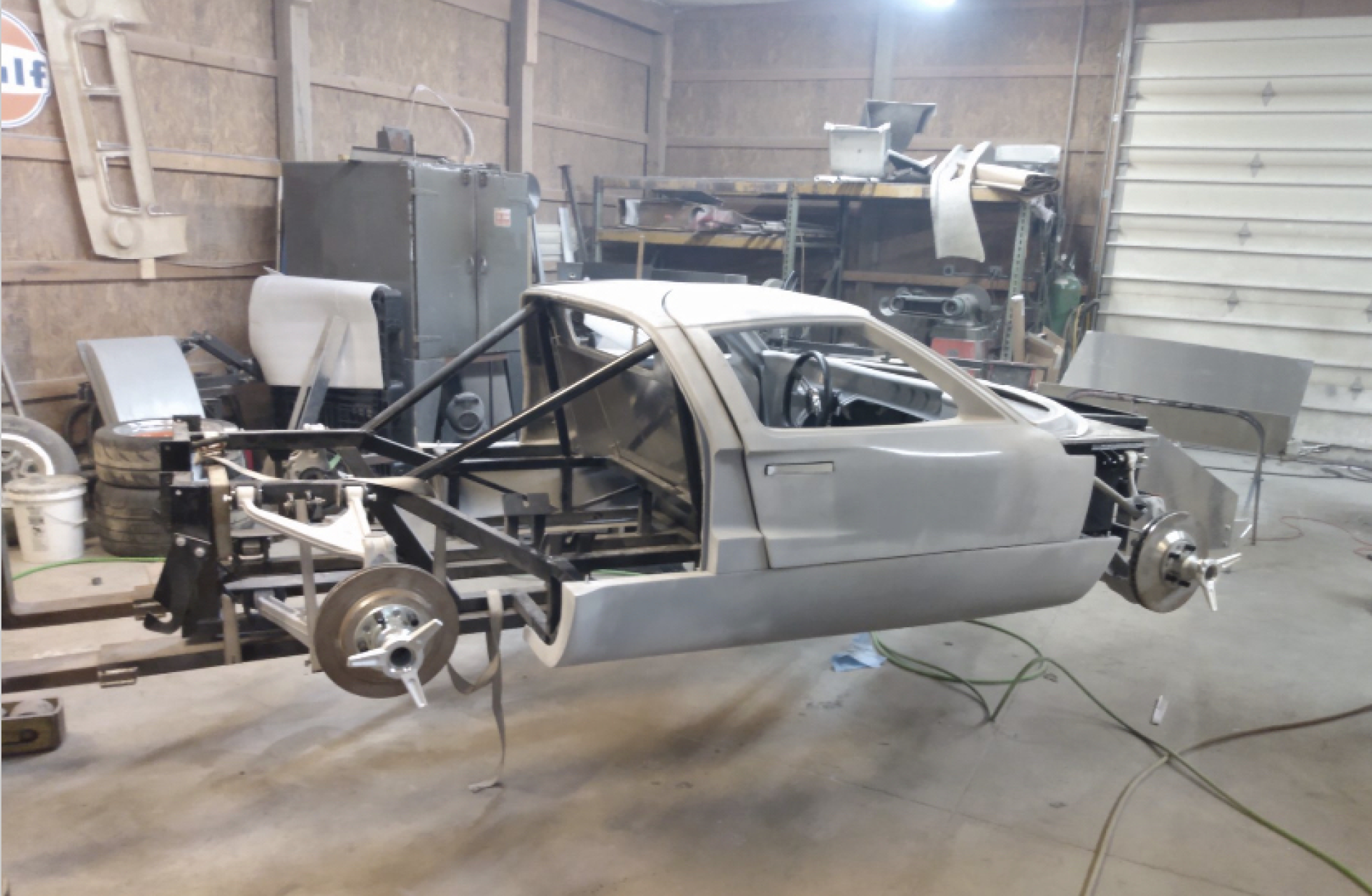

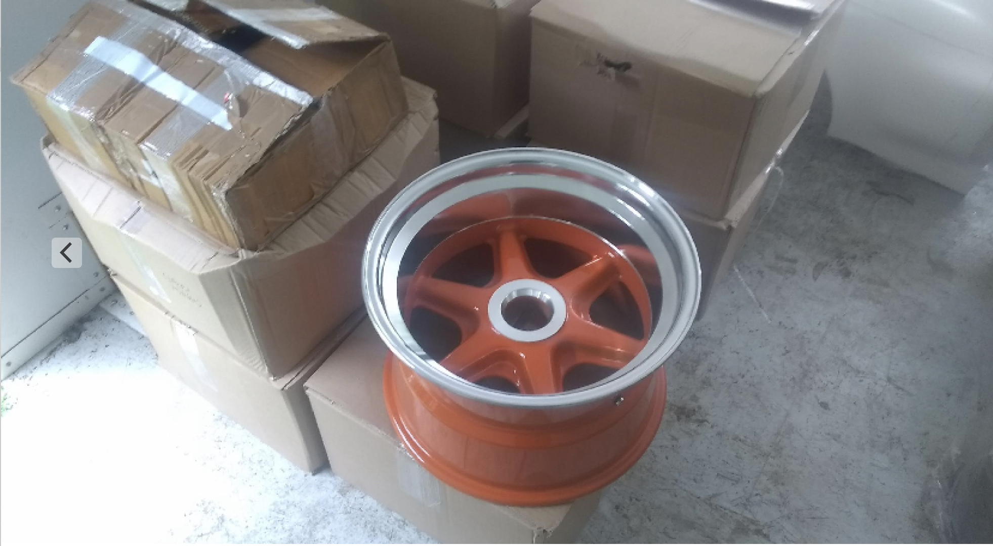

....more pics. I think the extra money for the flares and BRM wheels is absolutely worth it if you are planning to do the Gulf Livery scheme. The scheme doesn't look right without the wider flares and wheels, IMO. The rear pic gives you an idea as to how wide this car is. It's crazy wide back there. The body guy named this build phat @ss. LOL!

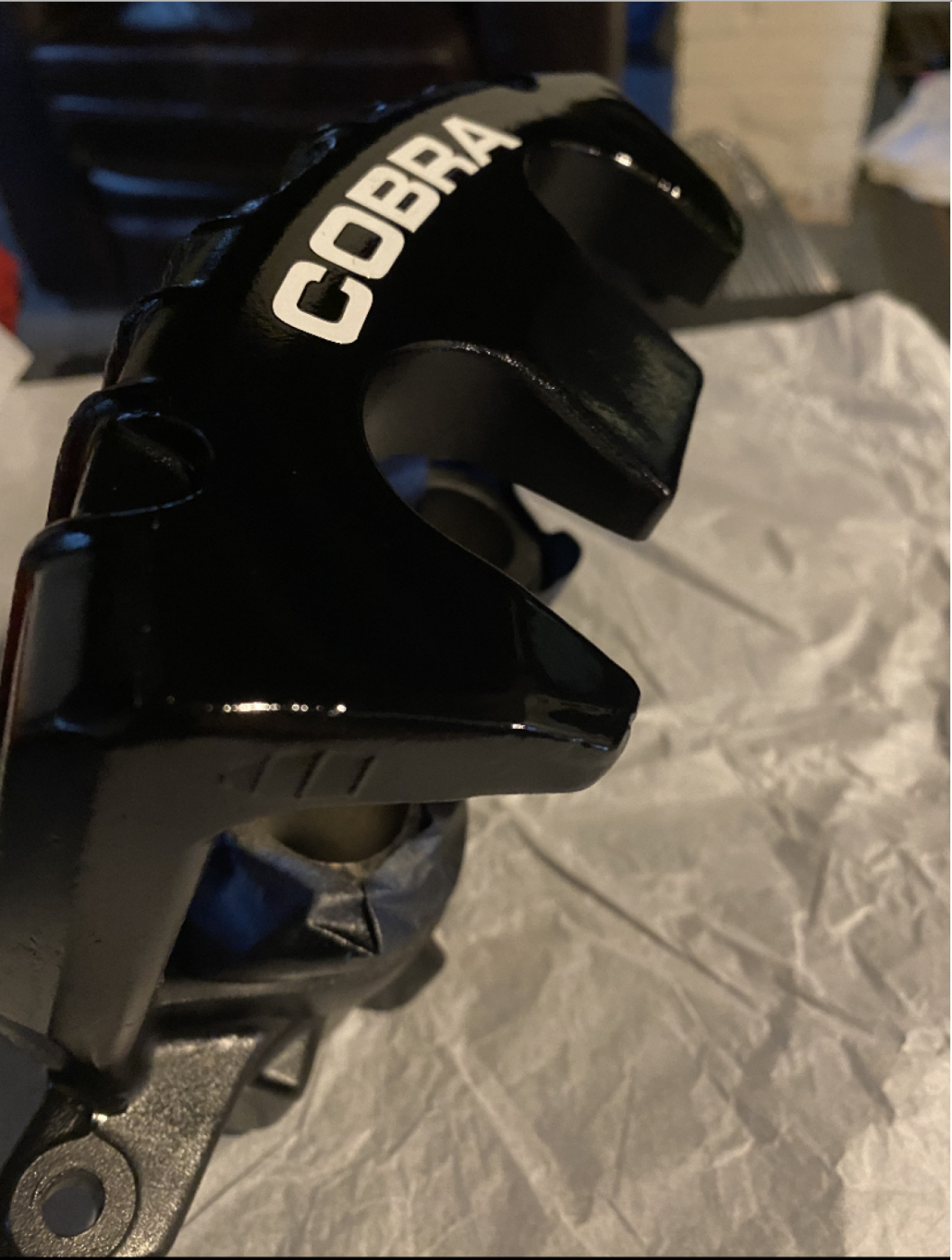

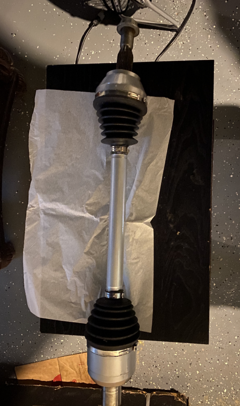

So far, I have mocked up the brake system, installed pedals, repainted calipers and CV shafts, mounted AC/heater box, fuse panel, drilled most of the holes in the dash for the gauges.

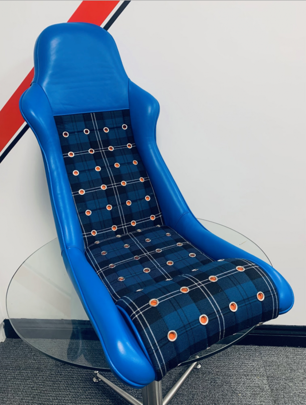

Also intended to purchase the carpet kit and seats from Chris, but they were unavailable at the time, so I sourced my seats from a superb outfit in the UK called Intatrim. Admittedly, at first I was a bit apprehensive about sourcing something like this from across the water, but Robin 'Rob' was excellent to work with, and I recommend the seats highly if you are looking for alternatives to color and design. He was very diligent in helping me find the right pattern for my seats due to the uniqueness of the design, which took a couple of months just to find the right tartan pattern and color for the leather seats, but well worth it. This is my opinion, and per usual, always do your due diligence and proper research.
Prices, communication, and service was superb (I am not affilaited with Intatrim, just a happy customer and my experience with them was excellent) - here is one of my seats (they are leather with custom tartan pattern I picked out). I'm going with a blue interior that will emulate the bright blue interior of the early C3 Corvettes (see example pic below). I know the 1075 car has black interior (and right hand steering), but I wanted to do something a bit different. Exterior, however, will emulate the 1075 car...

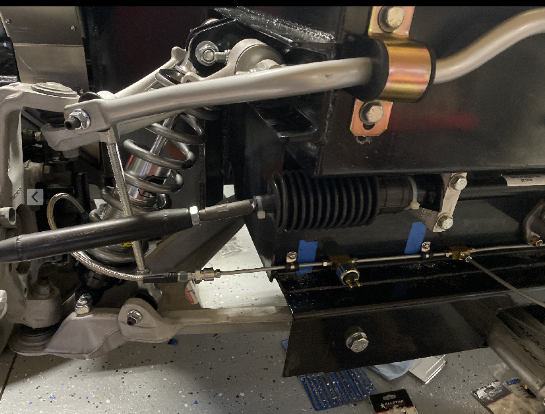

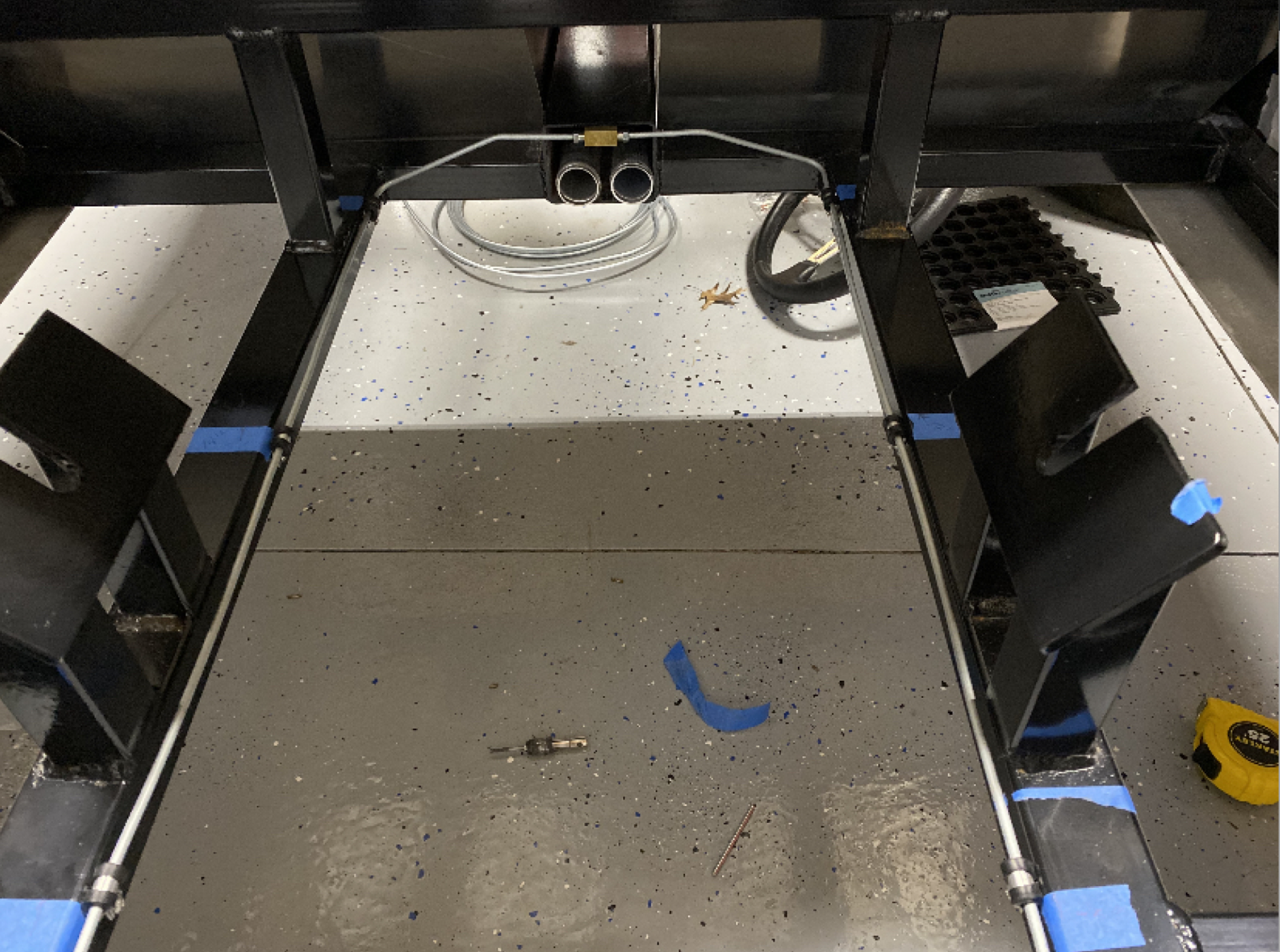

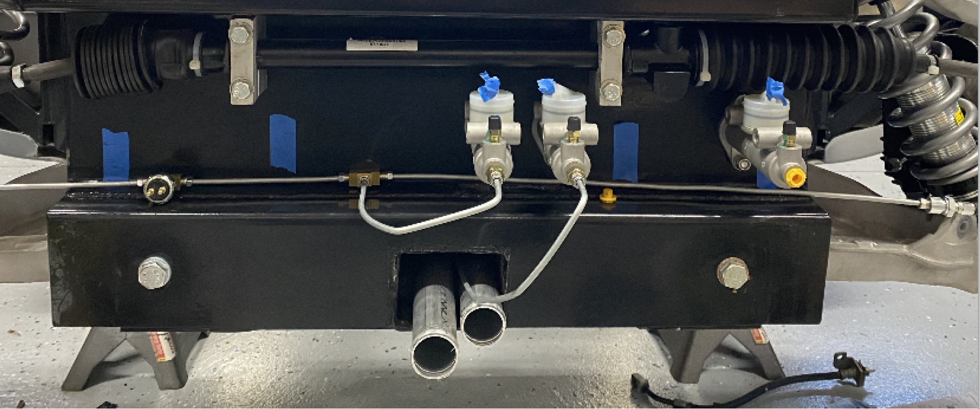

I decided to run the clutch and brake lines inside the tunnel. I think it should be ok (I'll likely insulate the aluminum coolant tubes to keep the heat down in there. I noticed that most folks run them on top of the tunnel and around the e-brake, but wondering if anyone has tried my setup. Also, some add'l pics of what I've done attached...
Note, if making your own flares for the brake and clutch line, do spend the extra dollars and buy a proper flaring tool if you can. I bought the K Took 70081 which is a fairly expensive kit, but it has worked very well for me.
Hi Matt. I also have a wide body " Wyer flare" GT40 from Chris. I started my build late 2020 and 70% done. I ran my clutch and brake lines inside the tunnel like what you did. I can only insulate one coolant tube and brake/clutch lines due to space limitation inside the tunnel. Good luck with your build. Chris is an amazing guy. I am glad I bought his kit. Im already 2 years out and he still answers my questions super fast.
Thanks, Sammy. Yeah, it's pretty tight in there. I figured the water temp running through the coolant tubes would rarely get above 200 (and hopefully stay at around 185), so the ambient temperature should be less than that, and shouldn't affect the brake/clutch fluid in any adverse way. I haven't yet settled on the insulation media yet, but maybe fiberglass wrap (the same stuff you'd use on exhaust headers), or some sort of insulating spray.
What did you use to insulate one of the aluminum coolant tubes?
with the coolant tubes,brake line and clutch all in that lil tunnel there is going to be alot of heat added to brakes & clutch lines. I could be wrong just a thought lol. Coolant tubes are deff going to need some type of wrap on them
There is no harm in the brake fluid being 200 degrees. I wouldn't want the A/C low pressure line getting heated to 200 degrees ahead of the compressor.
I'll be insulating to not have the tunnel hot.
