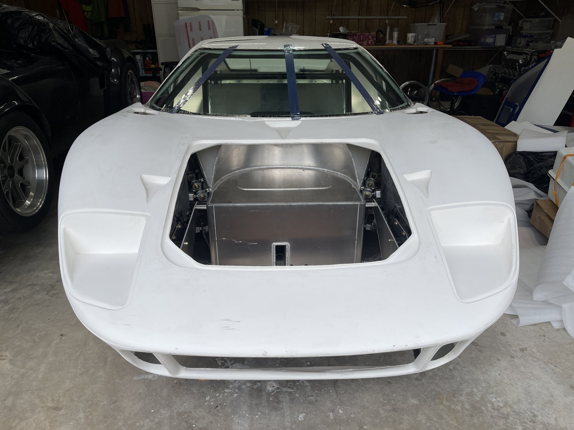

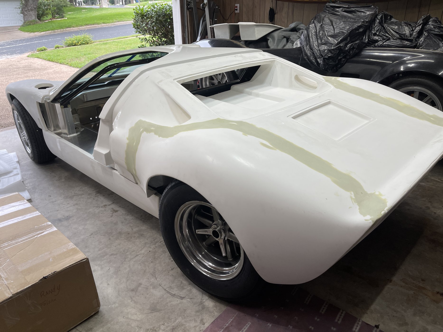

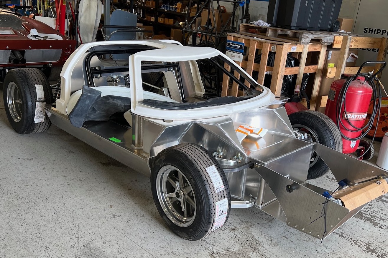

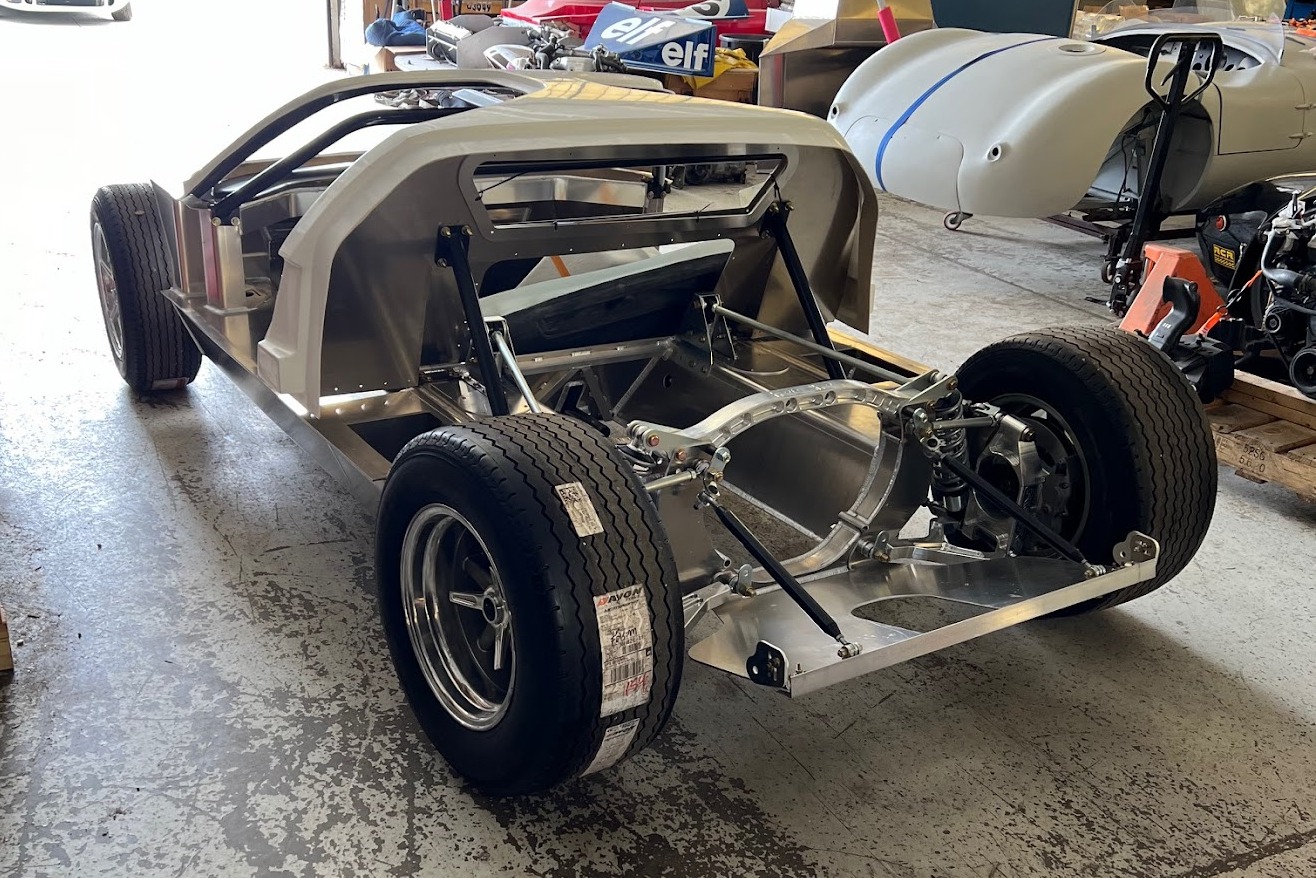

Happy Days. Bill at RCR sent me some progress pics. The rear clip is at the body shop for the +2 flares. There is a nice looking Mk2 in the background. I like the period look of the Avons.

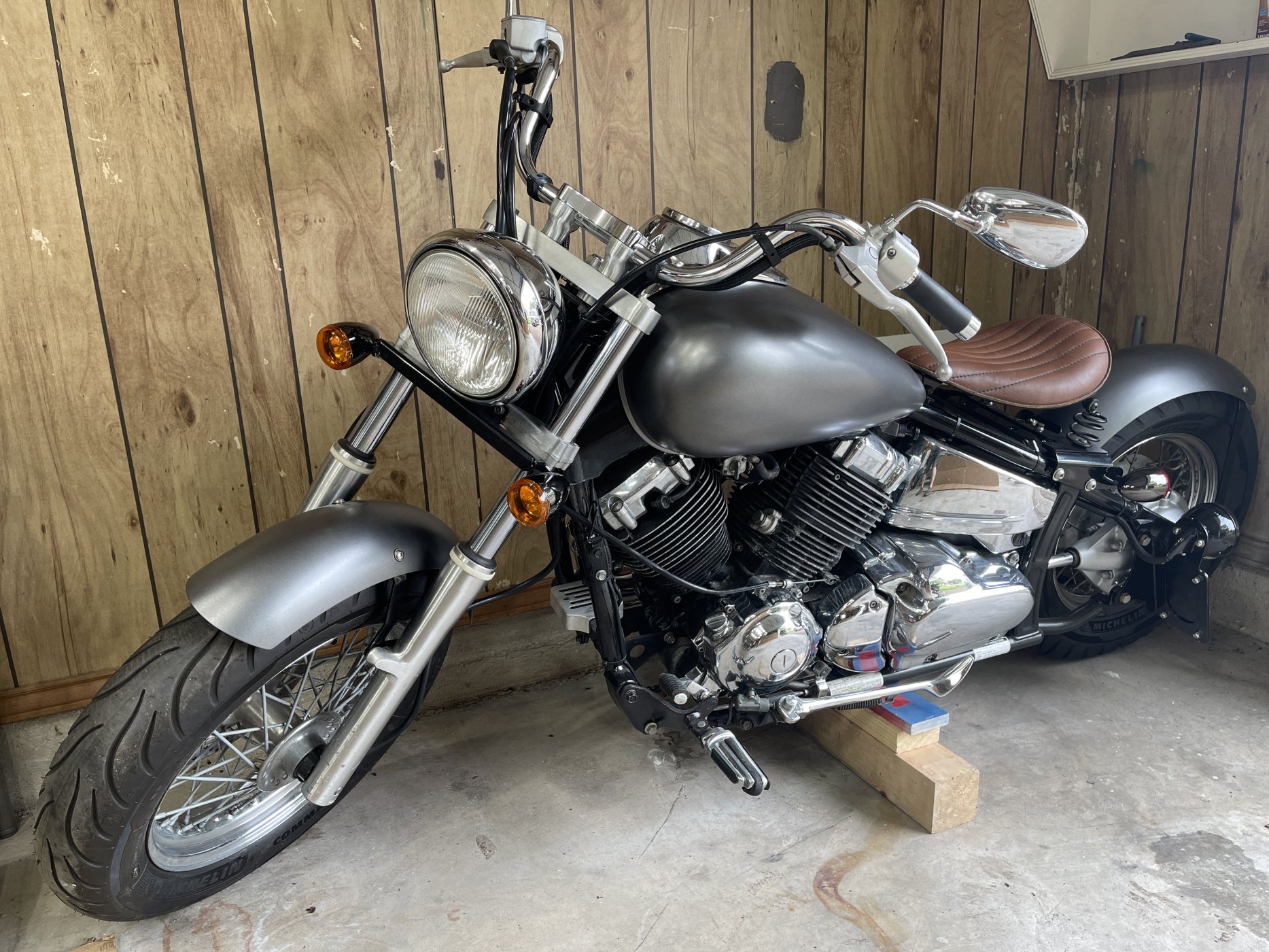

I have yet to start work in earnest on the RCR40. I had another project that needed to be finished first. This one has been an on and off effort for the past eight months. Finally finished it today. It’s a bobberized Yamaha V-Star 650. It started out as two basket cases.

Bike is looking great!

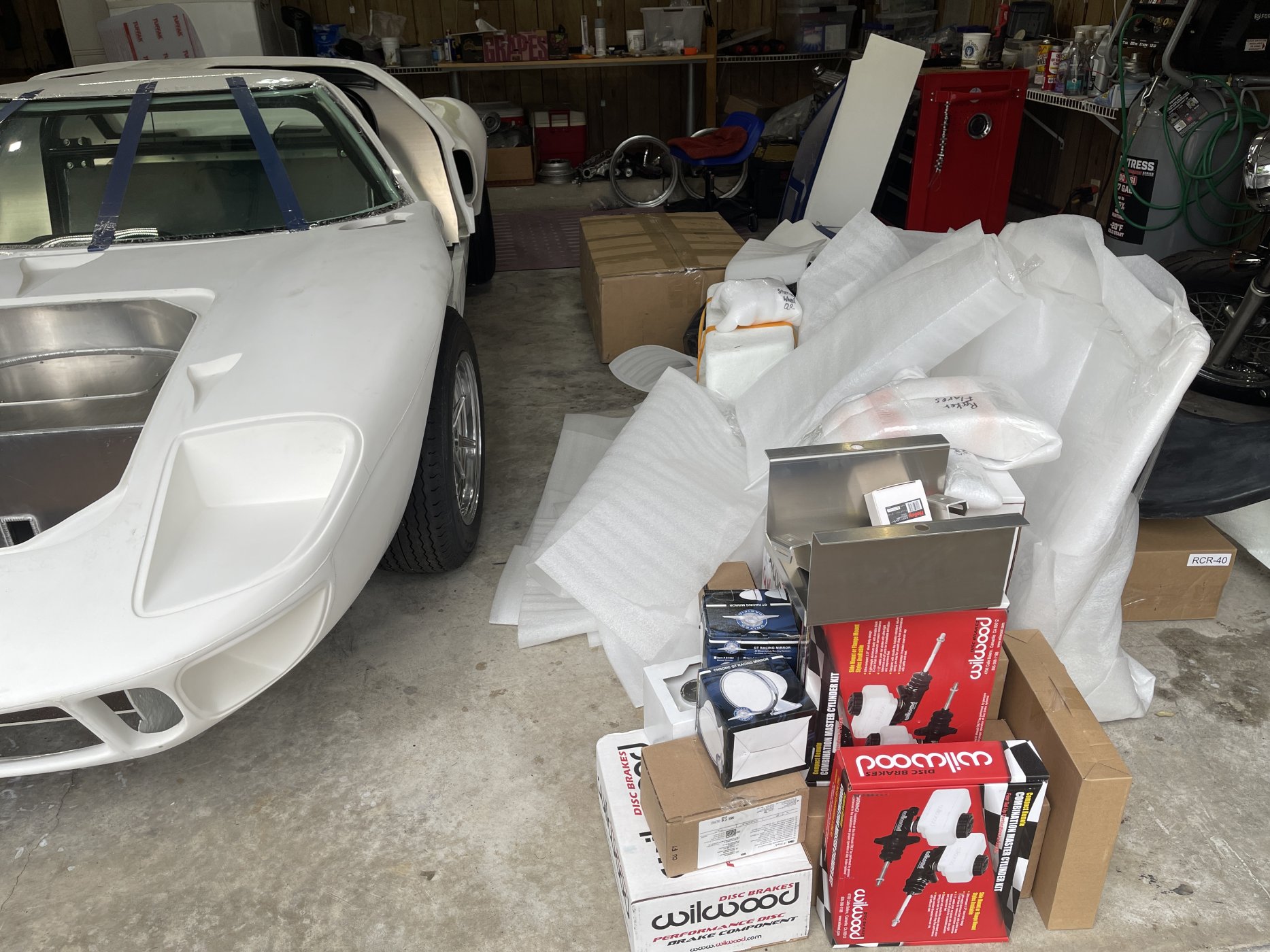

For those not familiar with the RCR delivery process I thought I would share my experience.
I used Beacon. Like others, they have a pool of independent haulers and they presumably ensure the haulers have insurance, etc. Beacon works with RCR to arrange pickup.

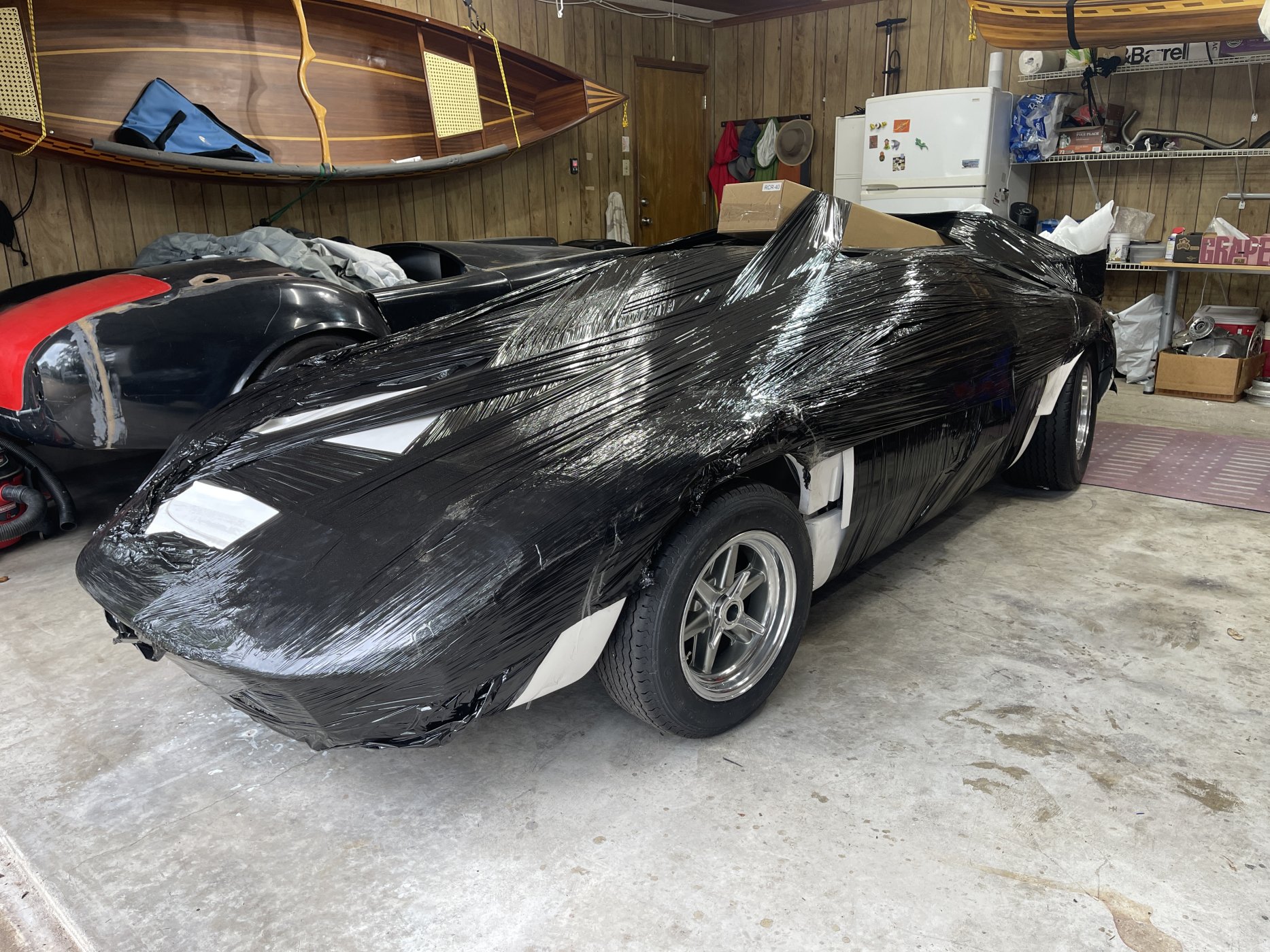

The car is loosely assembled, filled with parts and wrapped in pallet plastic.
This how looks fresh out of the trailer.
First step after unwrapping is to inventory everything. Some part description's are difficult to interpret, but using a process of elimination I was able to identify everything.
I thought I was missing some parts, but I contacted customer support and found everything.
There aren’t nearly as many parts as my FFR Roadster since most of the parts are attached to the chassis.

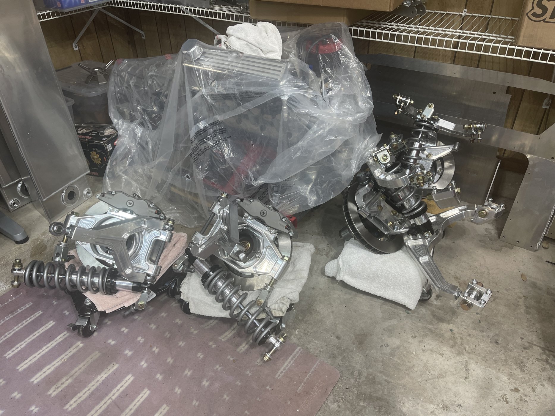

I finished the easy part of the build today: disassembly. I made a dolly using 4”x4”s with 6” casters. It puts the chassis at a very convenient height and can be moved easily. I used the same for my Cobra. Even with the engine installed, it can be moved around the shop. I have a set of wheel dollies that came in very handy to hold the suspension assemblies.

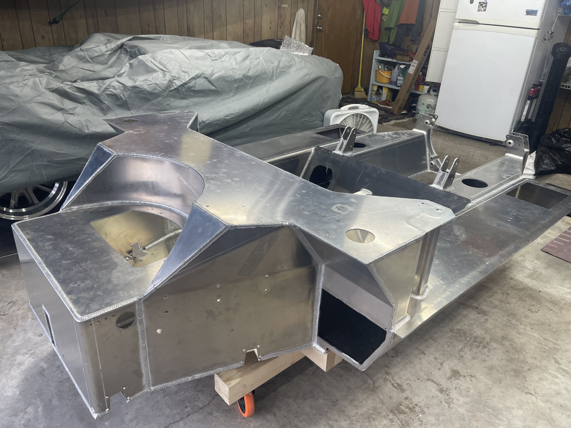

I spent the past few days deburring the tub and the many aluminum pieces. It took a more time than it should have because I pretty much polished the edges. A complete waste of time, but I couldn’t resist using my newly acquired pneumatic die grinder to it’s fullest extent and I just really like shiny new parts :)
Next up is to undercoat the bottom and the wheel wells.
Deburring sheet metal piece edges is a sign of good craftsmanship.

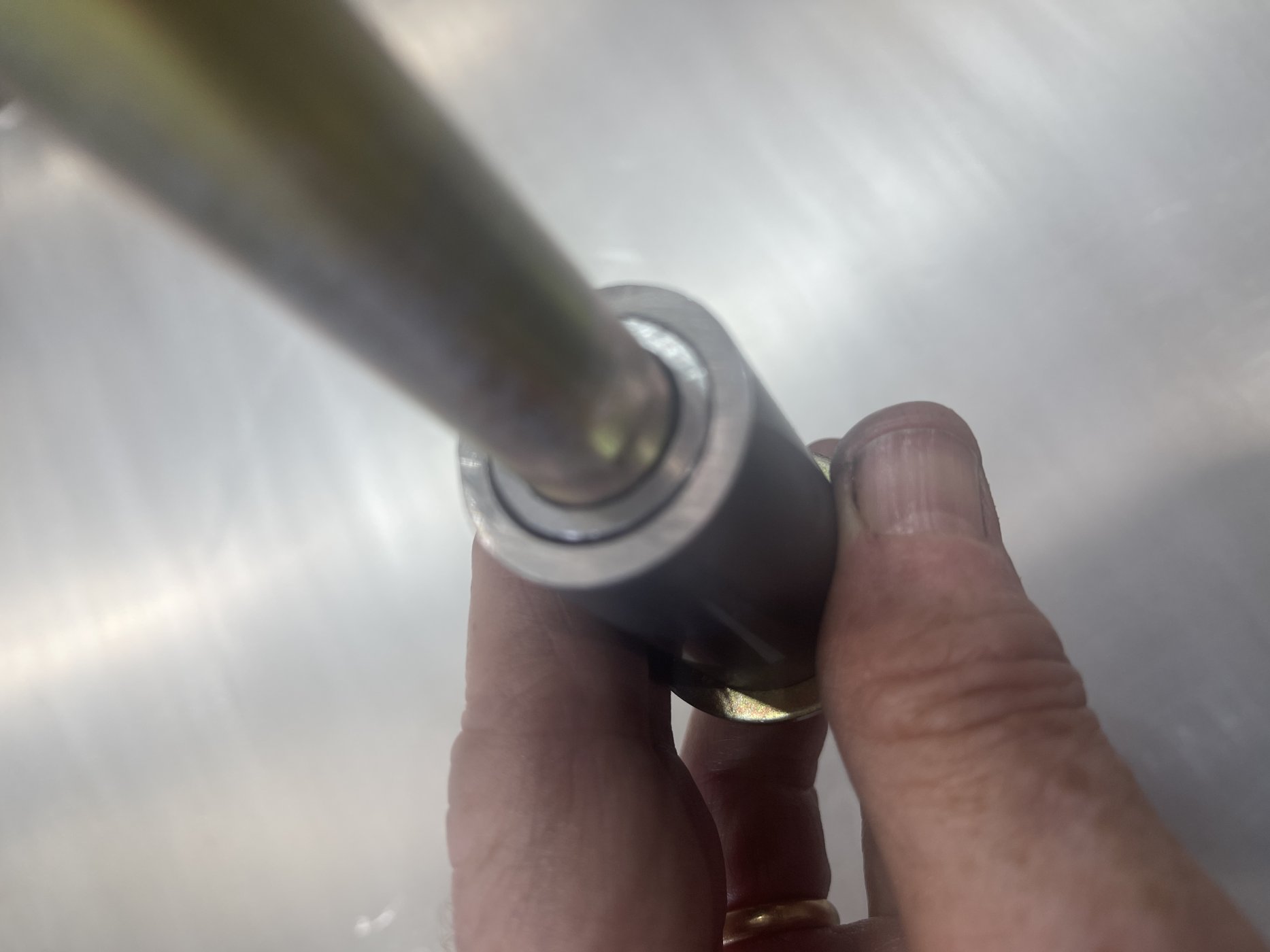

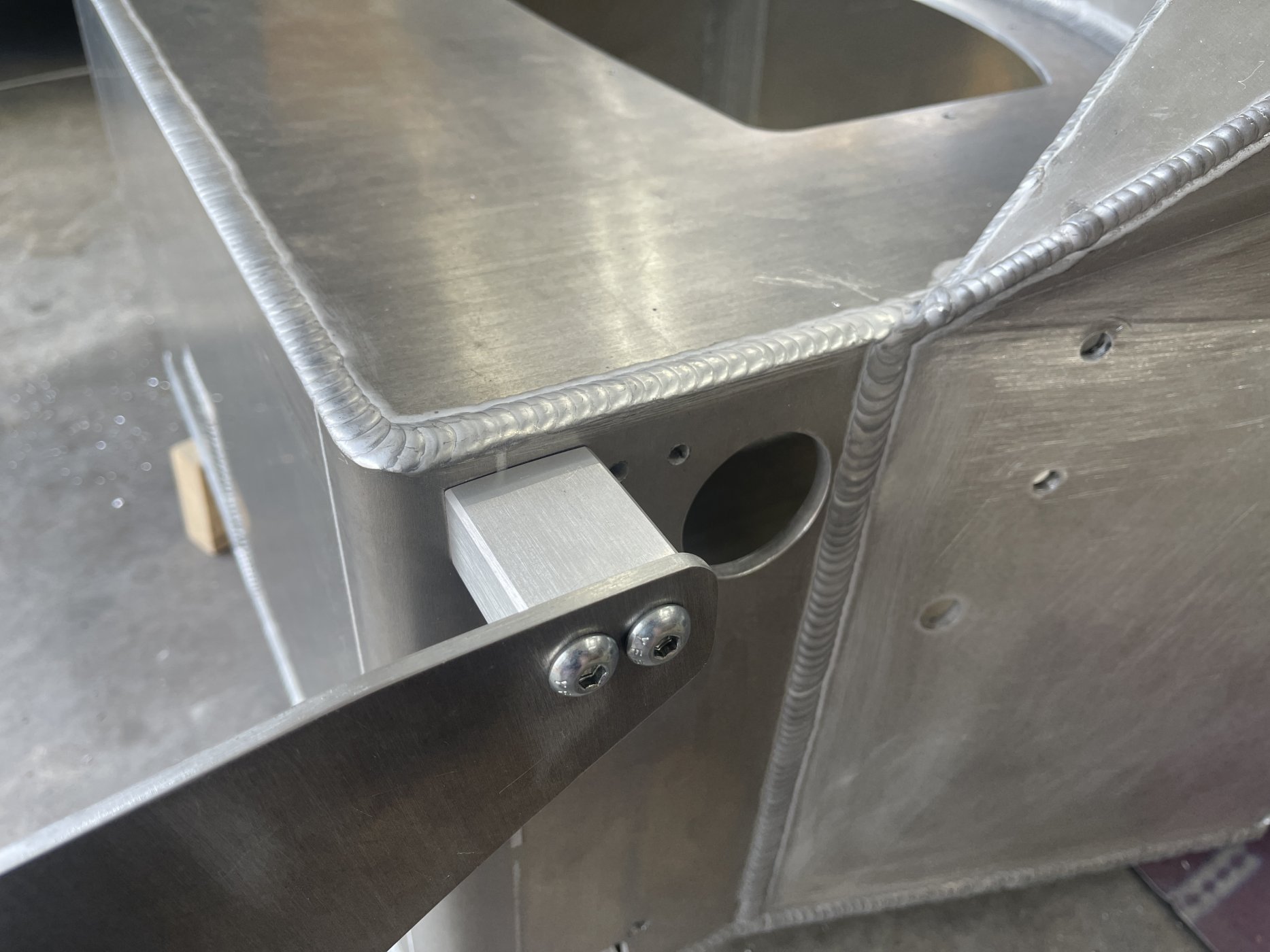

Today’s little project was to replace the thin wall tubing with 1/4” bolt standoffs that hold the radiator sail plates
I made billet pieces from some aluminum bar stock and used 7/16” bolts. They are also the correct length.
They should provide more robust support to hold a radiator full of water, front clip, A/C components, etc., all at arms length. You know, just in case I decide to go off roading :)
I also found that the provided thin wall tubing

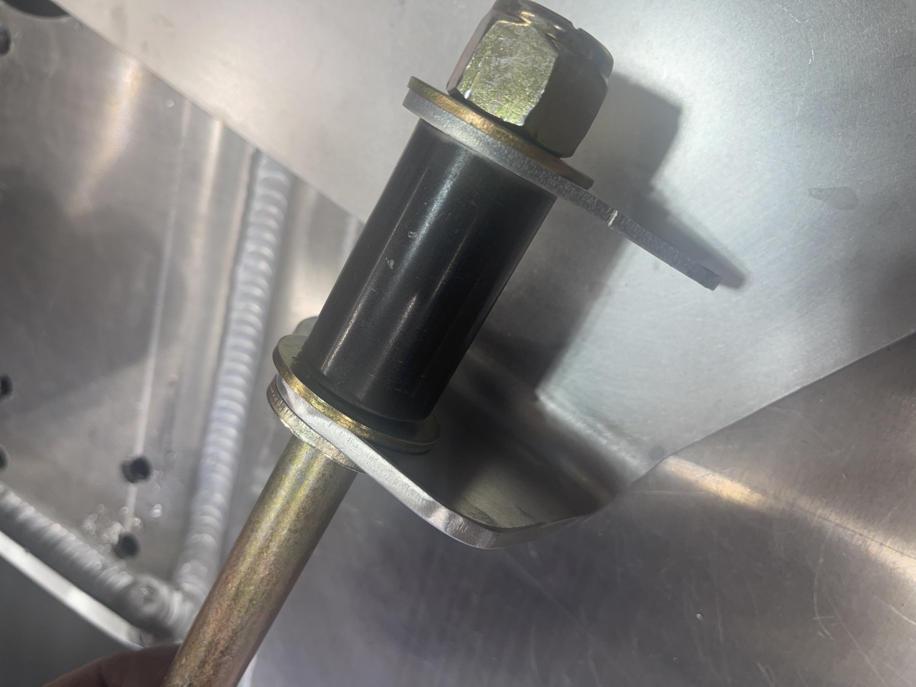

Another little project completed. I was not happy with the standoff tubes that hold the rear bottom plate. Their inside diameter was 3/4” and the bolts are 1/2”. Simple solution was to cut some 1/2” ID tubing for sleeves. I also trimmed the length and added a flat washer to protect the bottom plate aluminum and further distribute the load (again, just in case I decide to try the Baja 500).
