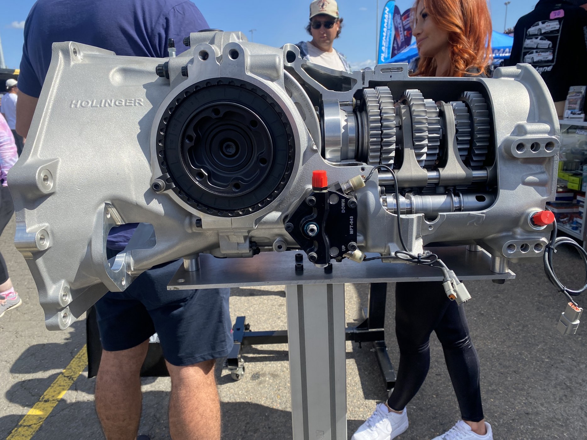

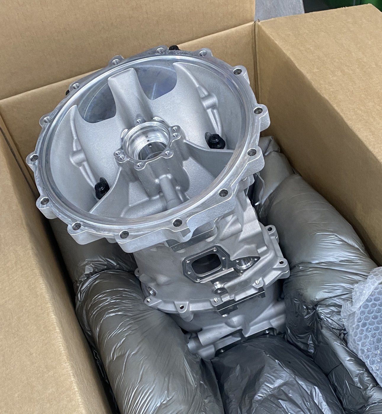

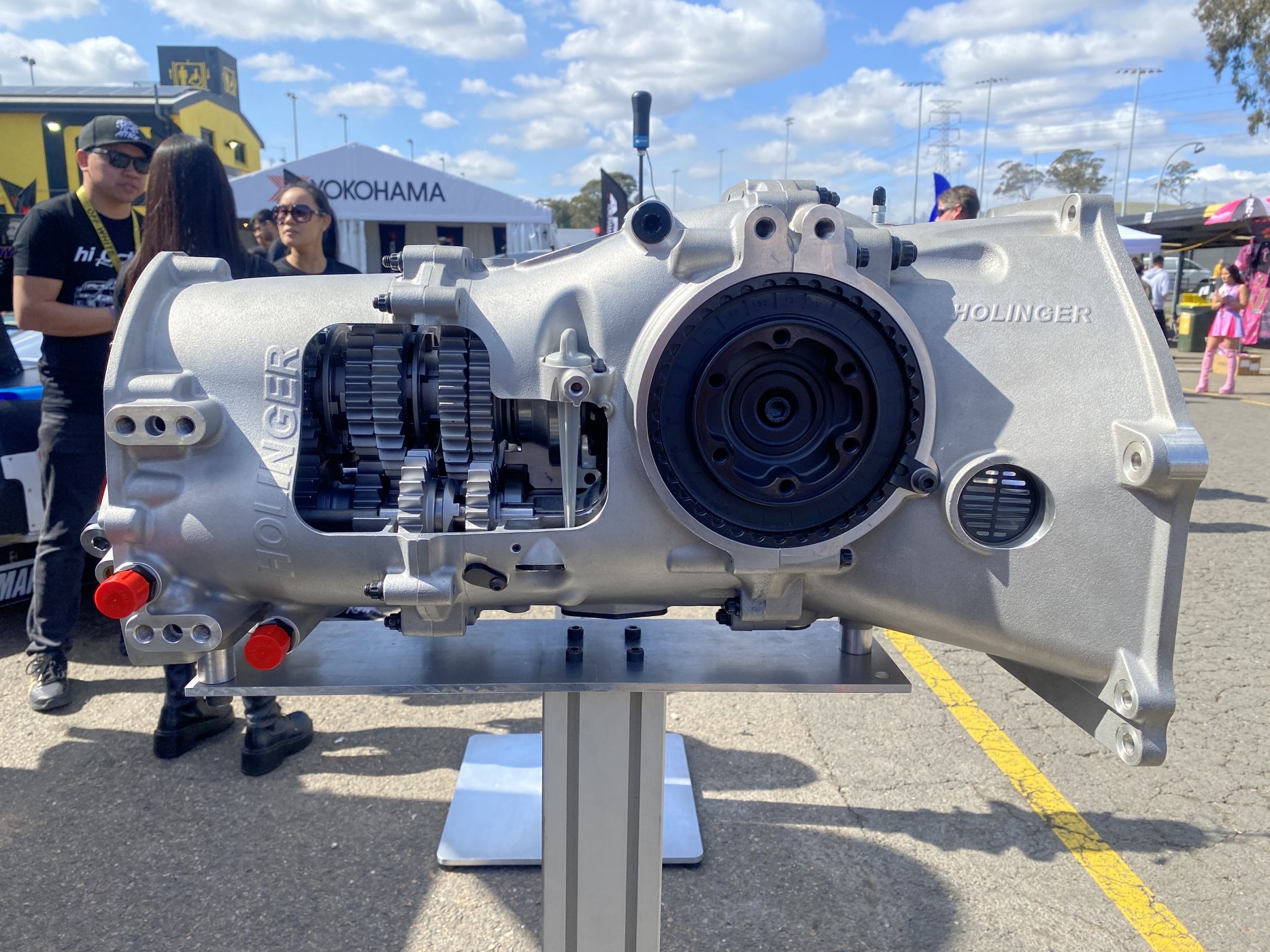

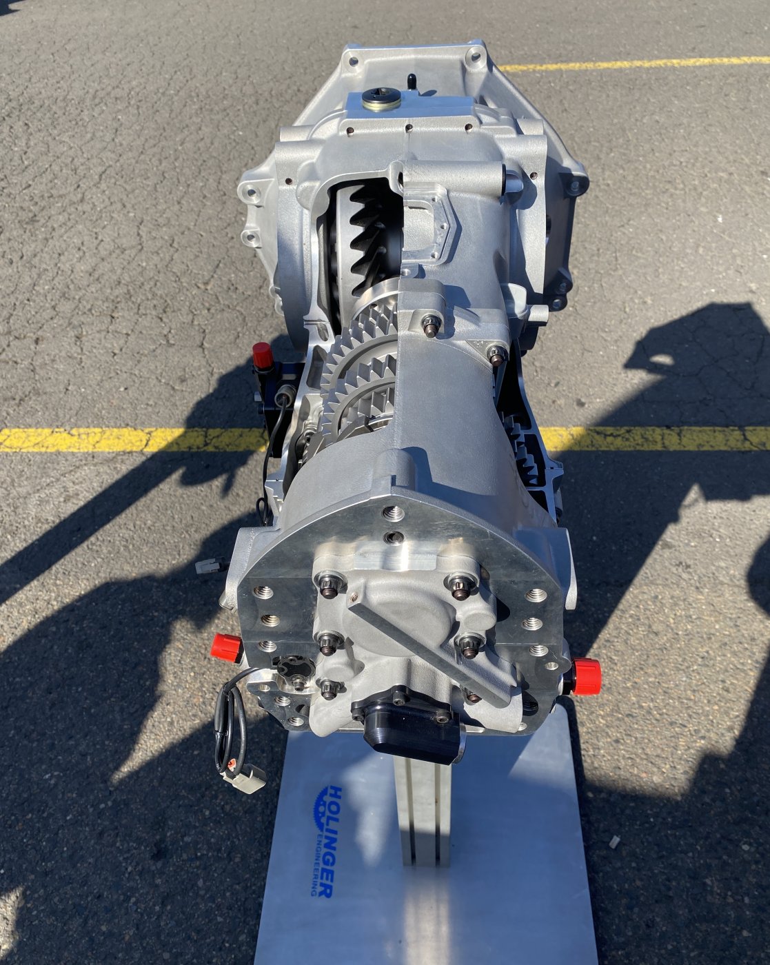

Here’s a cutaway of the MFT. Quite a few are going into GT40s in Europe to replace the ZF/ZFQ. 6sp sequential, straight cut gears dog box. Strong and race proven.

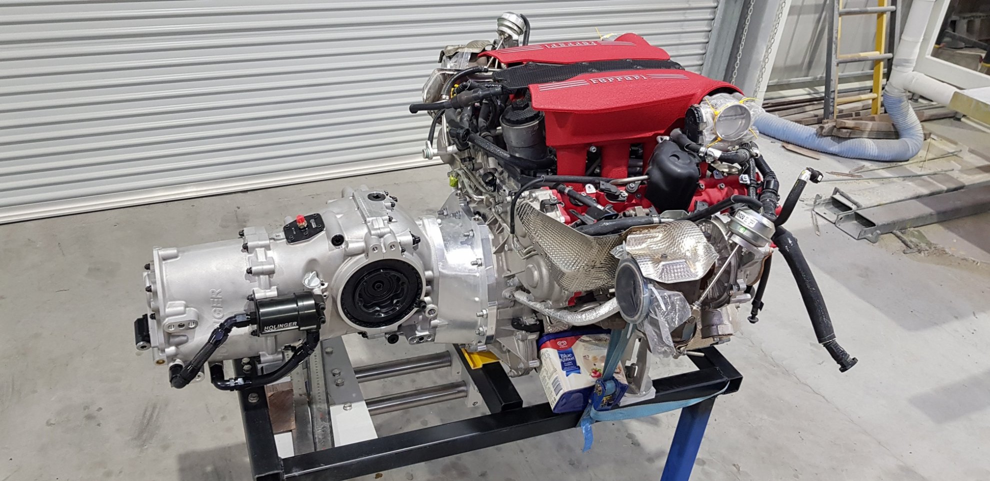

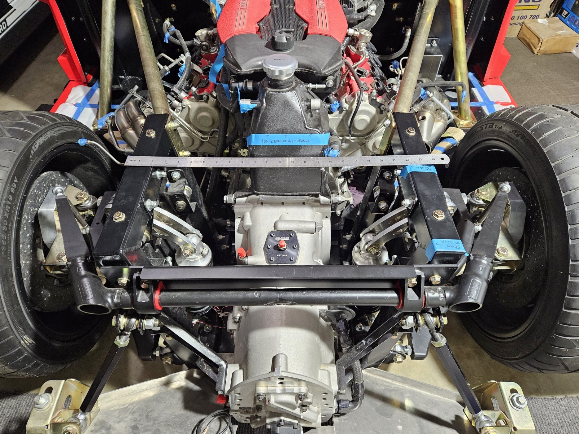

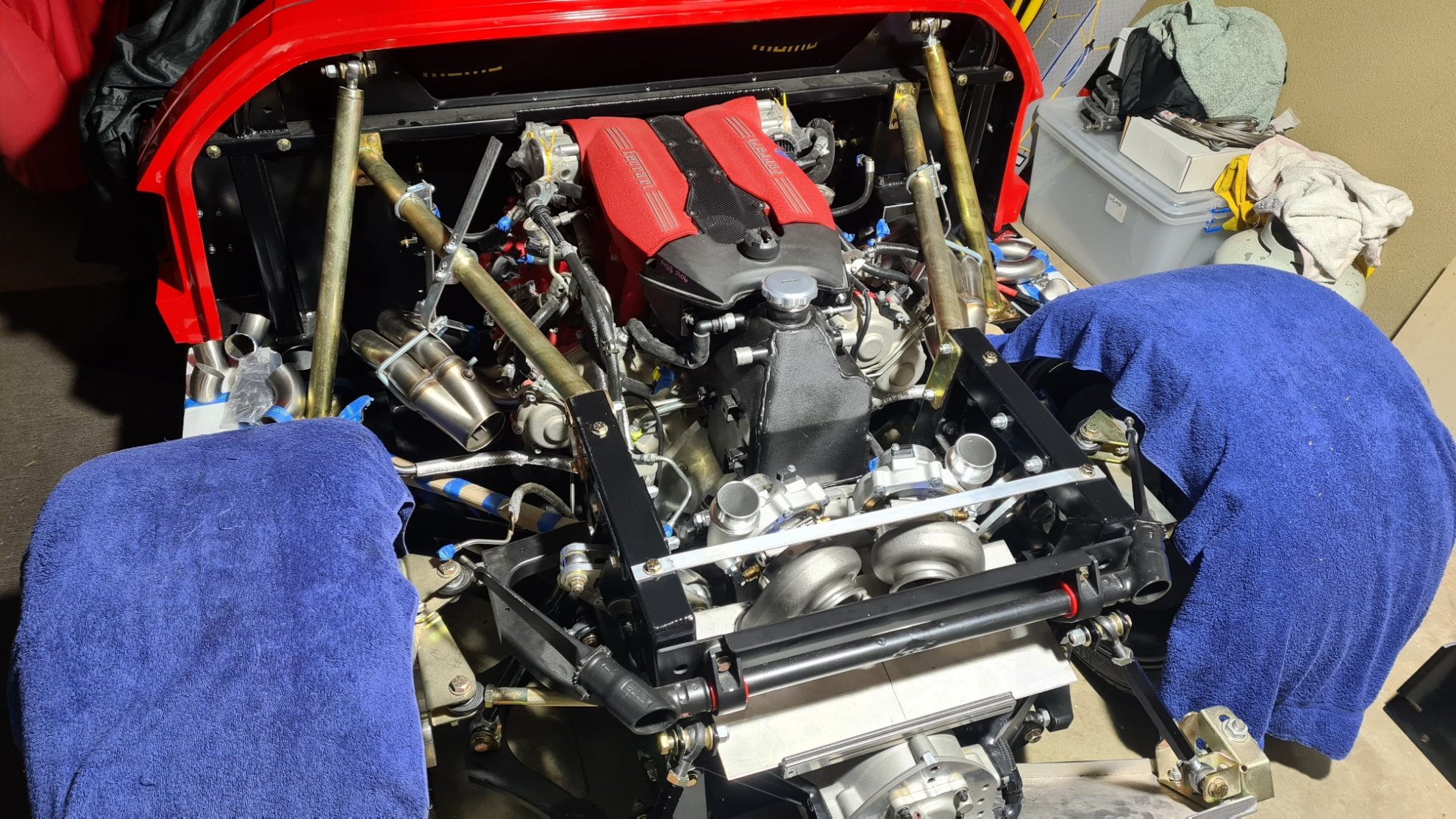

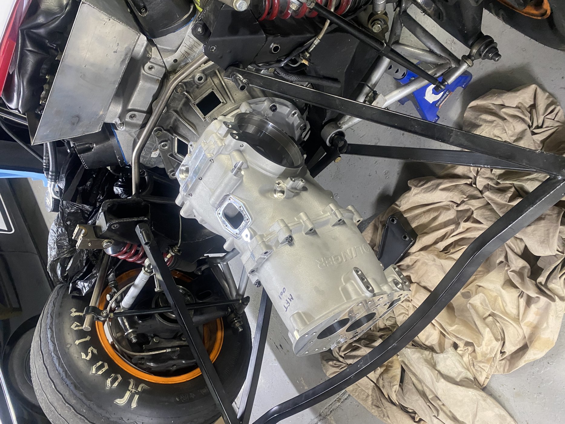

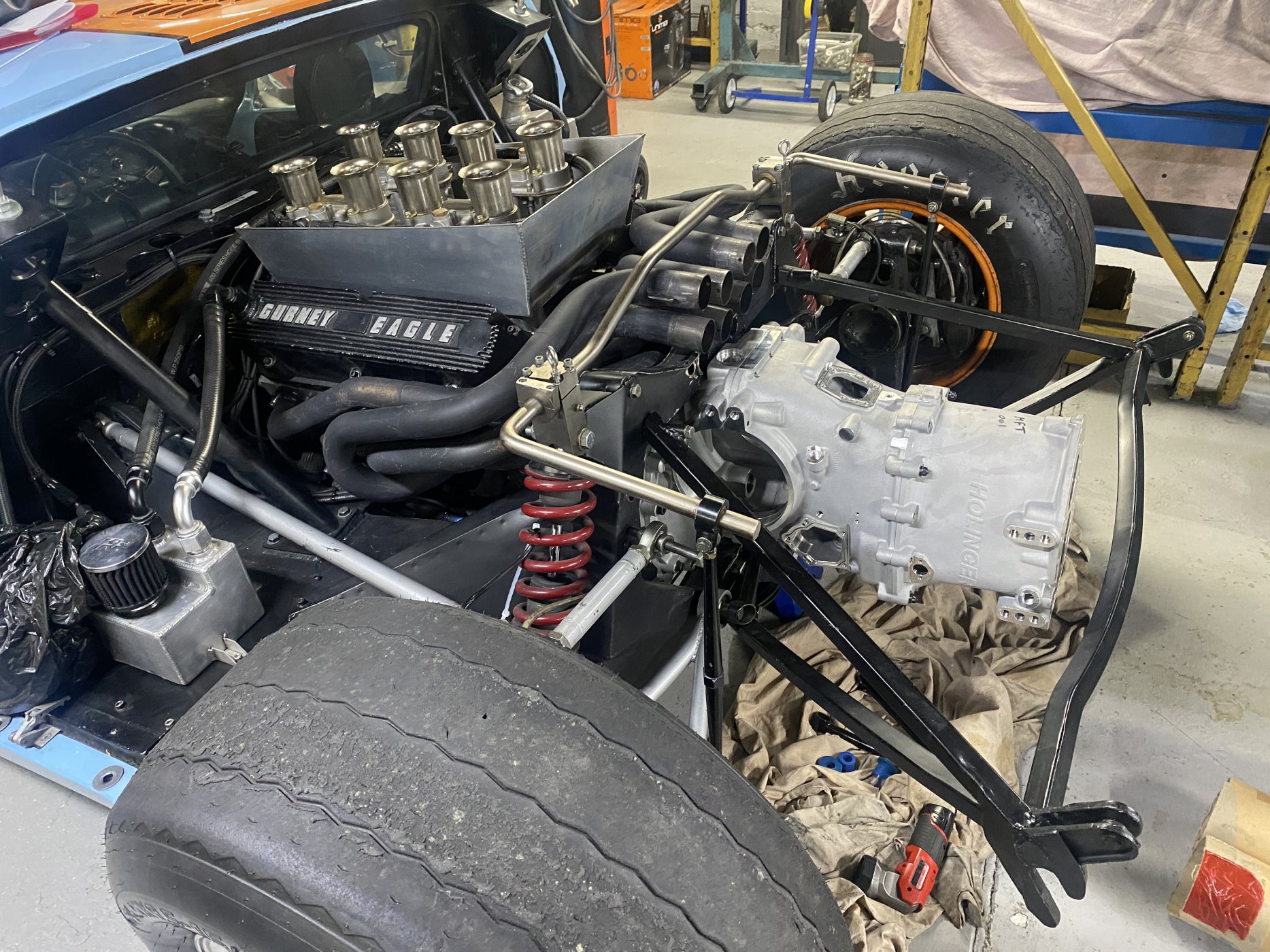

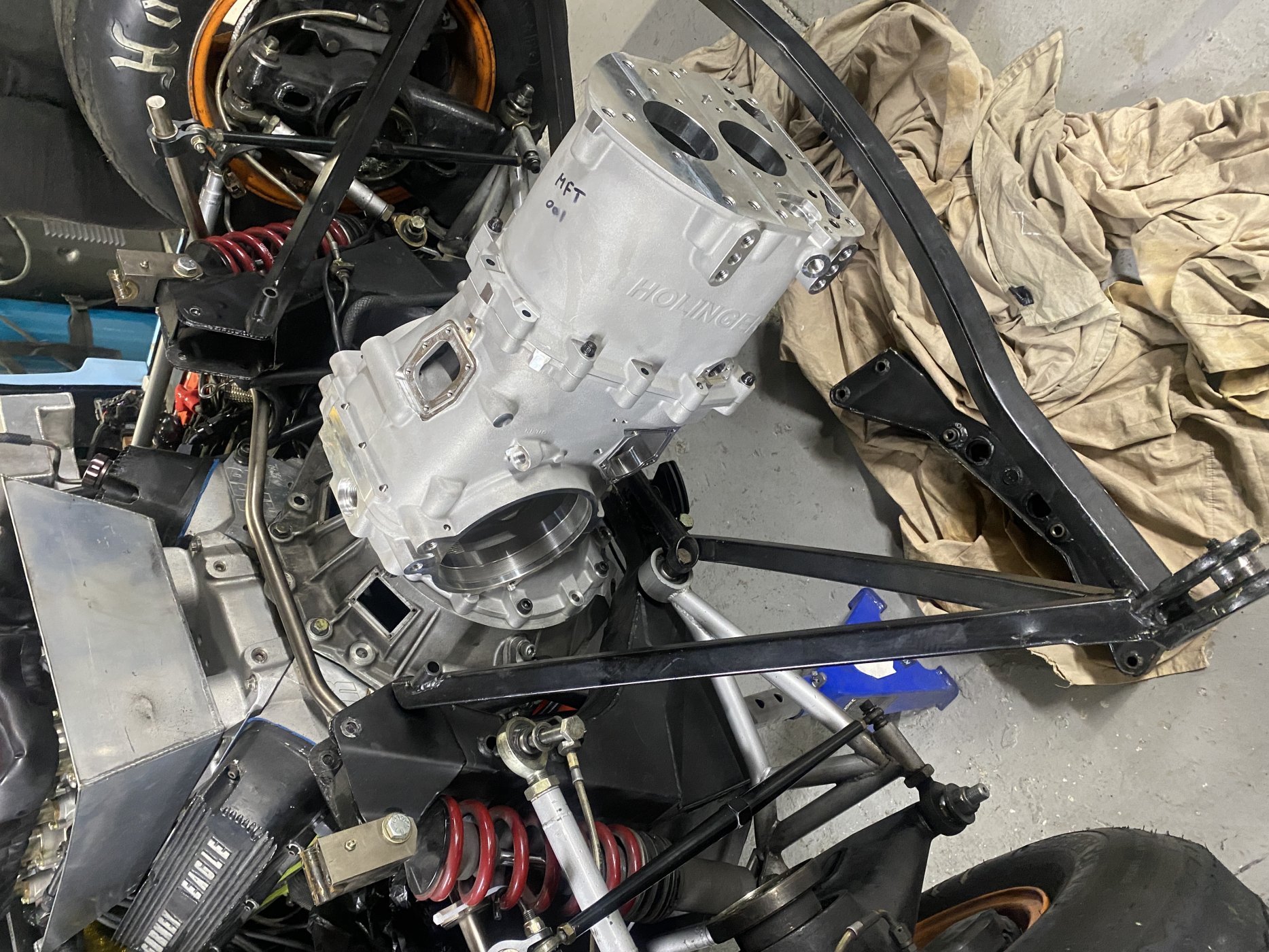

Old pics, but here's mine during the build on the twin turbo Ferrari 488 engine for my 40.

'Quite a few are going into GT40s in Europe to replace the ZF/ZFQ'
Surely this box will not comply with FIA htp specification?
True but the huge expense of constantly rebuilding a ZF/ZFQ for a track car is nuts and when the loss of track time too is frustrating. I can still do enough events without FIA rules.

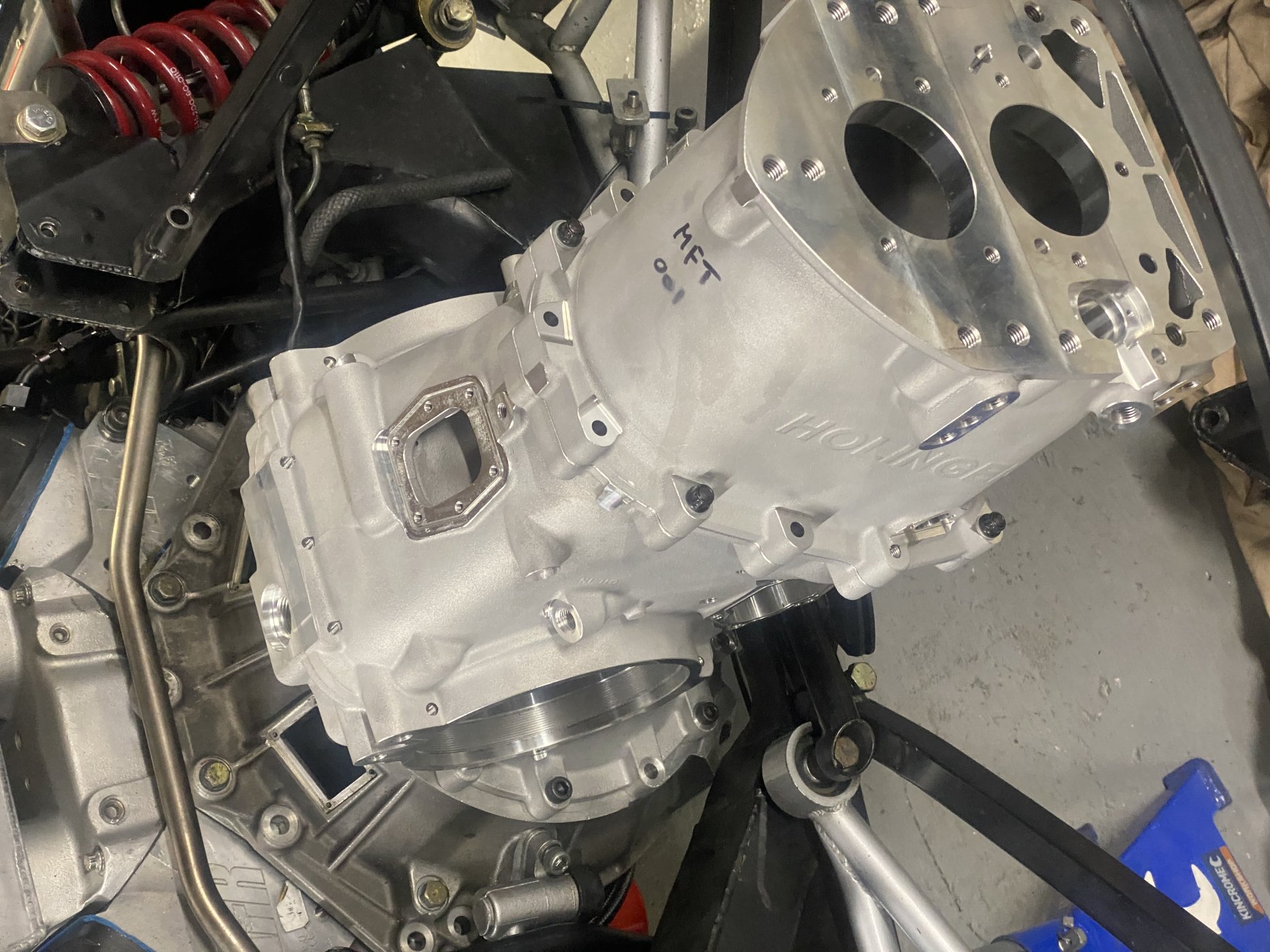

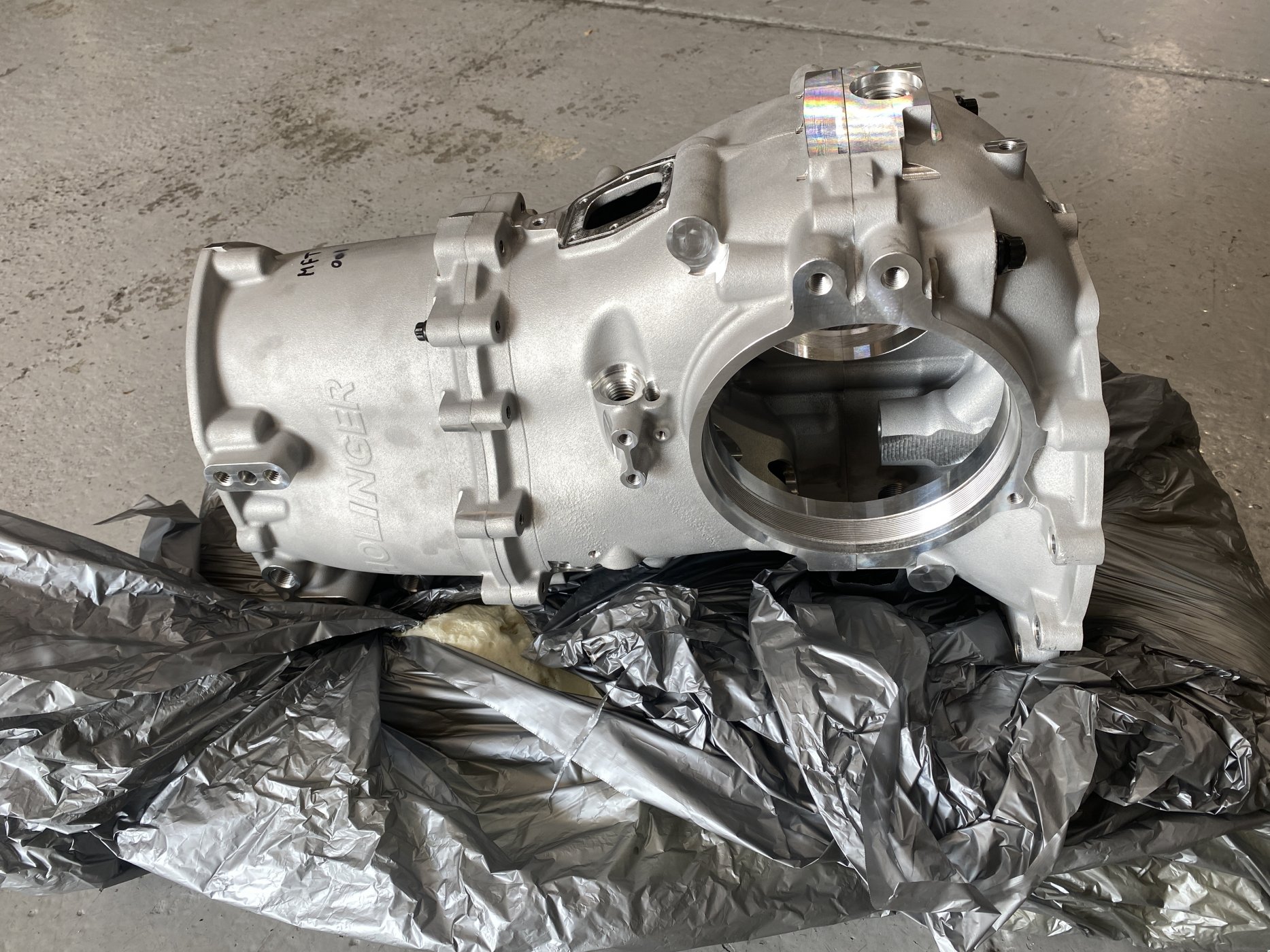

MFT Holinger, popular ZF replacement for GT40, Pantera, Lamborghini, and BMW M1.

how cool is that thread where the side plate for the diff goes in. I wonder have they thread milled that with the CNC millining machine.
I know that the middle casting is multiple wall as well, as the opening on the top goes into a separate cavity. It provides extra triangulation and support for the main pinion bearing support.
I suspect that if it's not done that way, you would end up with a very heavy casting, and casting issues, whilst trying to maintain the required pinion area support.
img_8431-jpeg.132484
The front and rear main castings are drilled and threaded together, meaning you can't swap out the front casting half for another with an integral bell-housing. Ask me how I know... ;)
These are very well thought out designs.

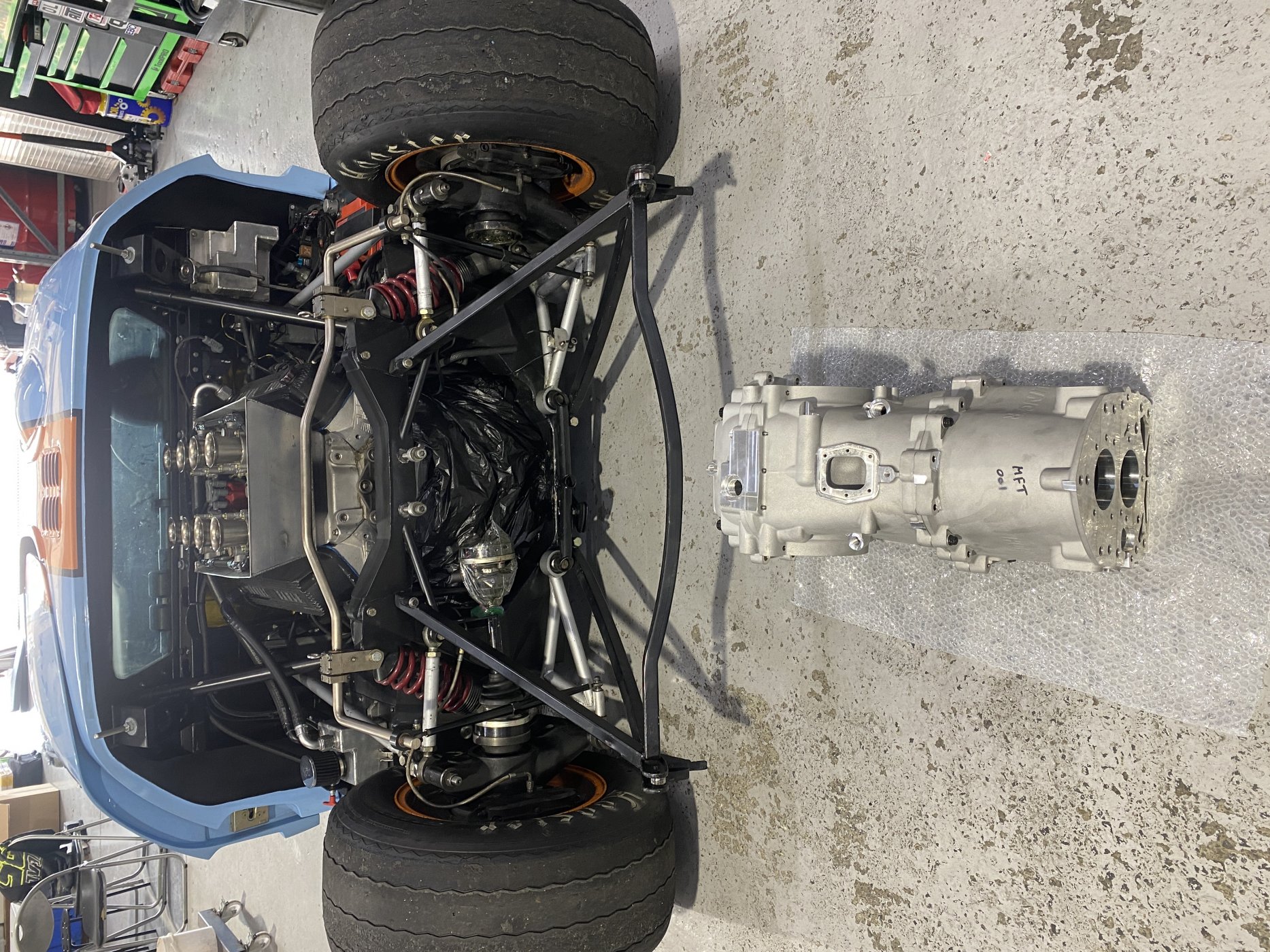

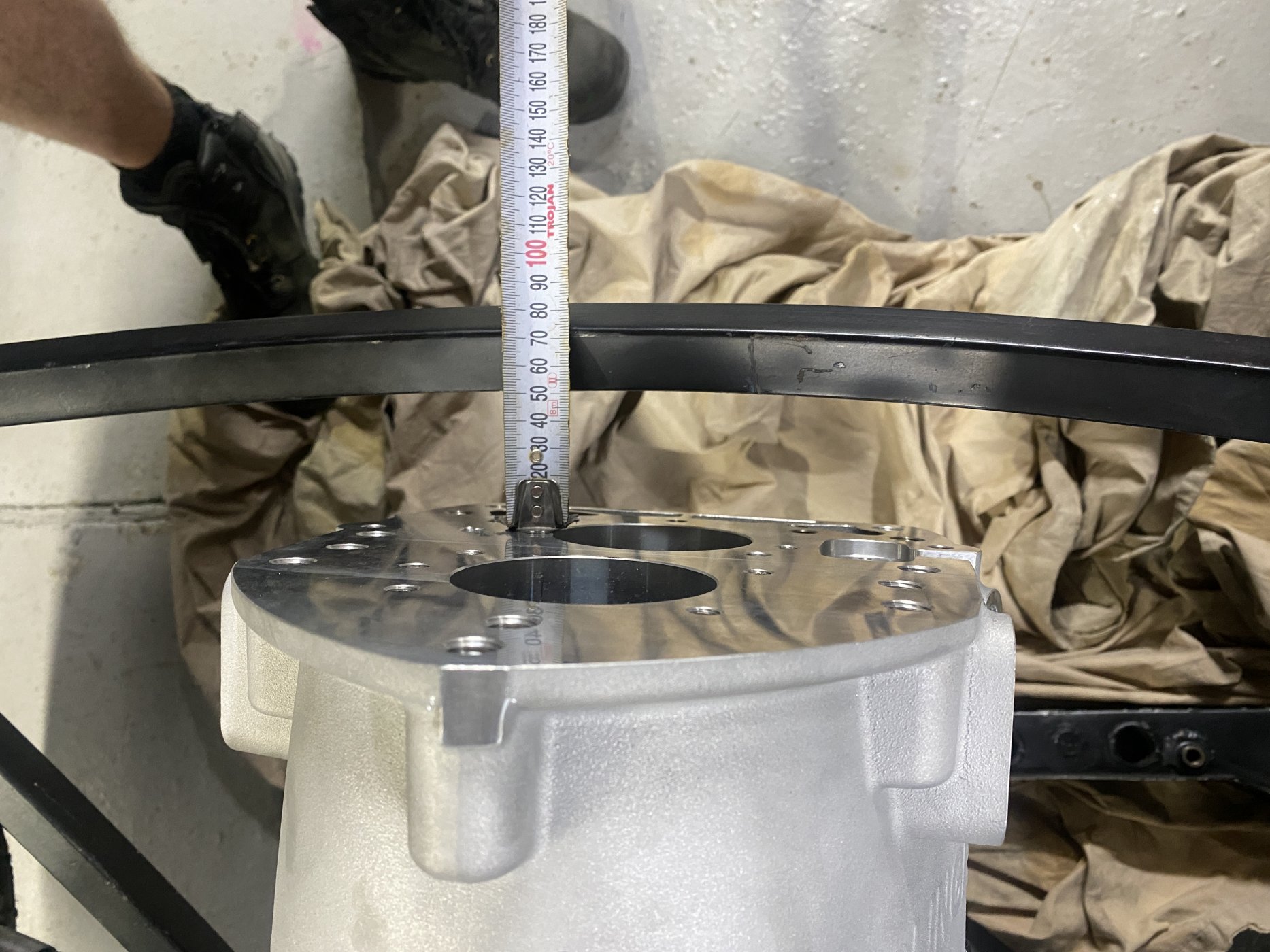

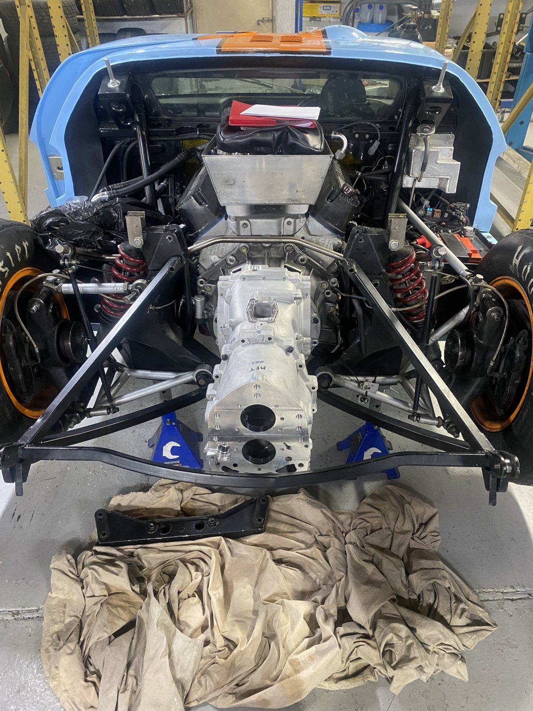

Fits perfectly to replace a ZF or ZFQ, 65kg lighter than ZFQ and shorter. CV’s driveshafts will be around 15mm offset from centre.

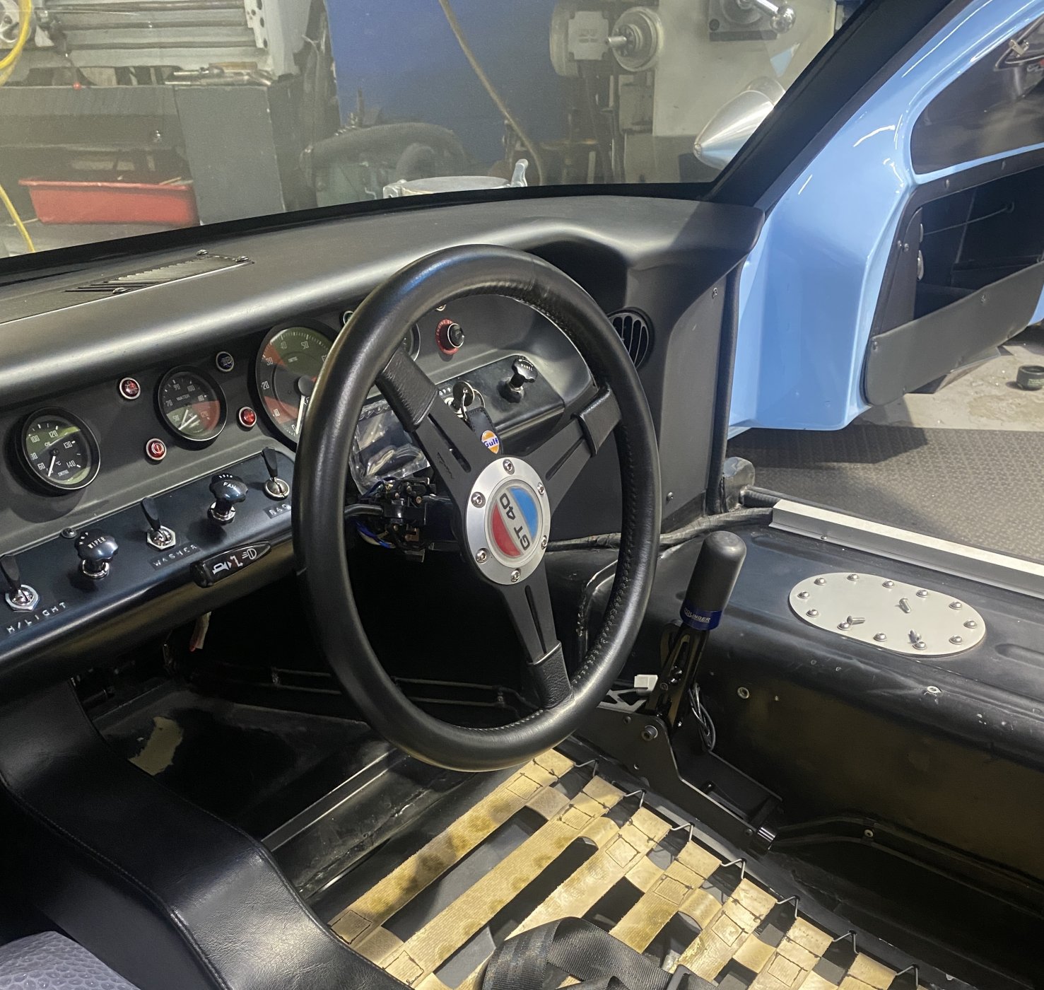

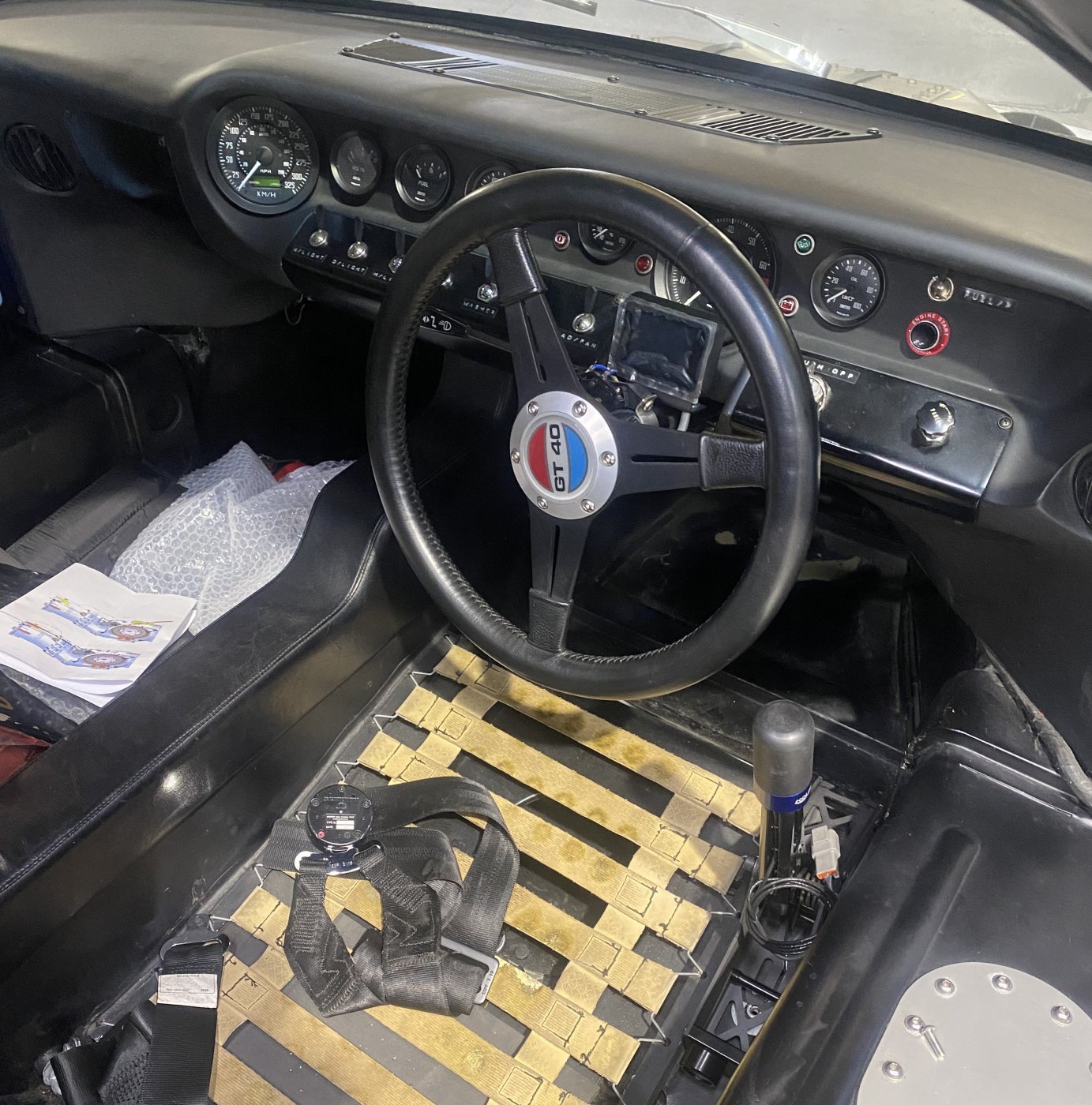

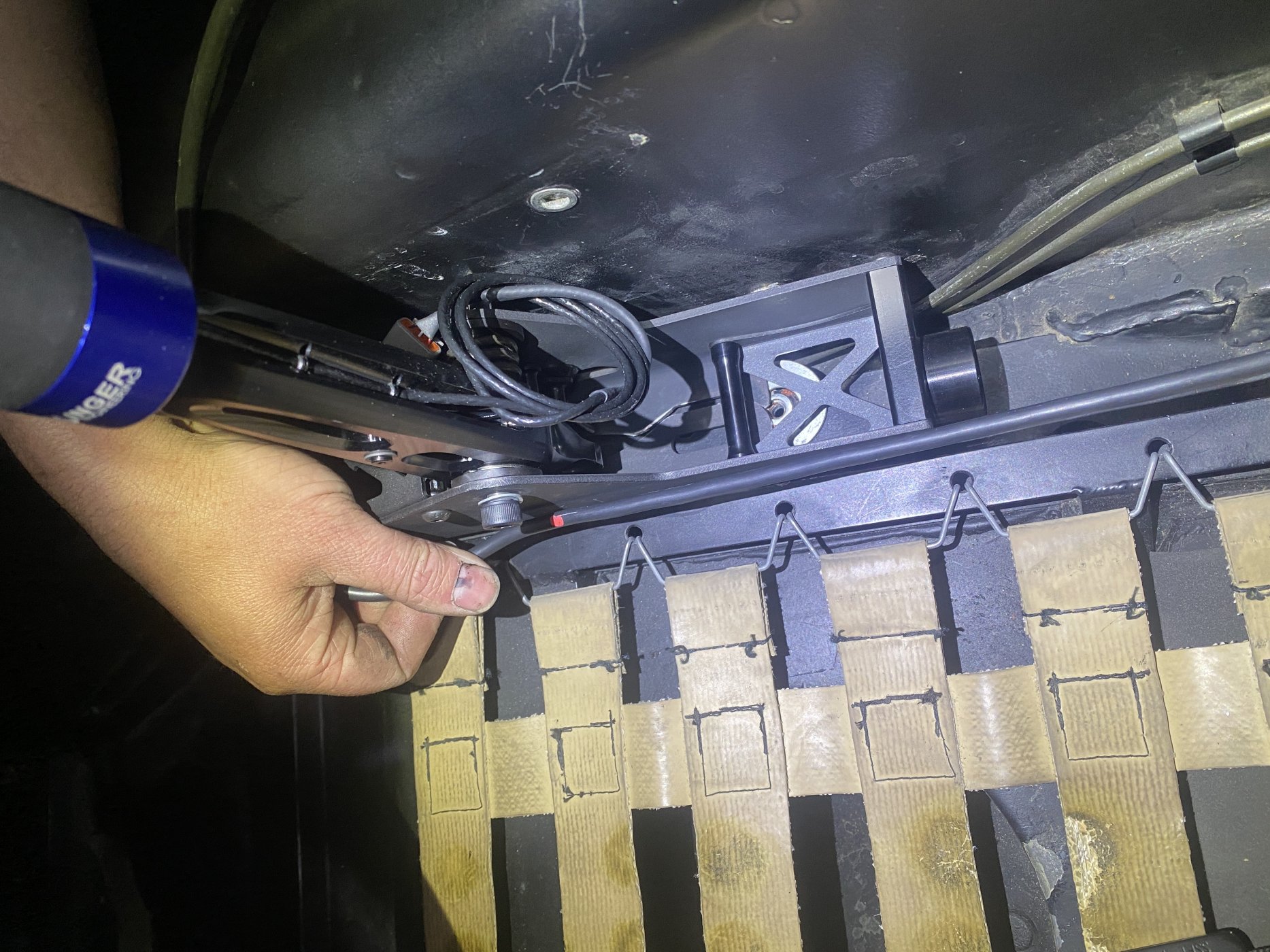

Holinger sequential gearshift fits perfectly to replace the Gelscoe H pattern shifter that’s been in my SPF.
