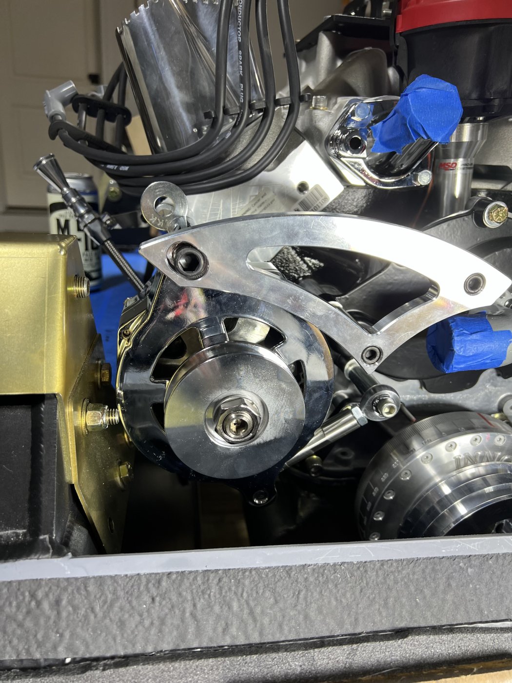

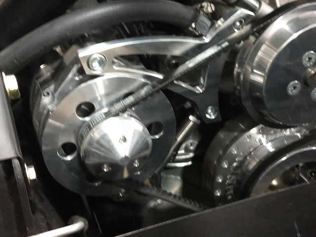

I`m in search of a low mount right hand side alternator bracket for my build its a 351W any help would be appreciated ,thank you!
Rod thank you for your reply, I will check into CVF racing do you happen to have a photo of what it looks like installed? and what part number of low mount bracket you purchased?
Rod Dittmar
CVF part# 302-ACBRKT.

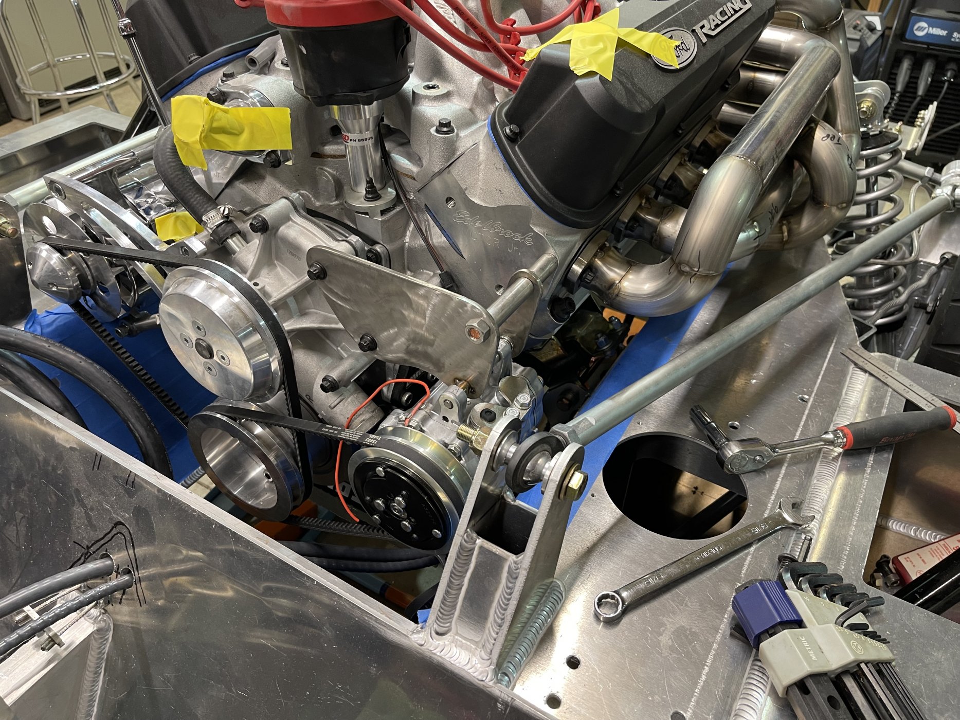

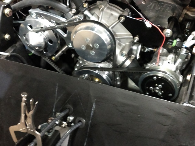

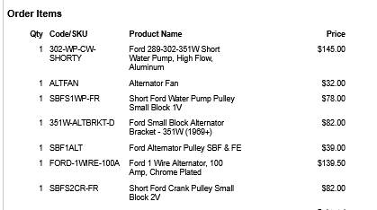

Here is what I ordered for front dress from CVF on my 351W Had to make a A/C bracket as I had difficulty finding one I liked.
