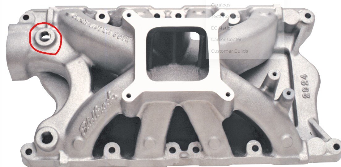

I own a Edelbrock Super Victor 351W Intake Manifold - SKU:2924.
There is an NPT thread in the thermostat housing for the Coolant Temperature Sensor.
Does anyone know the exact name/size of this thread?
I have attached a picture so you can see which one I mean.

Is that the heater hose output connection. I know on the 302 manifold, the temp sensor normally goes on the left hole away from the thermostat?
Note that both threads are the same.
The water is hottest at the thermostat housing. For the display of the water temperature in the cockpit, it does not matter where you screw in the sensor.
I don't need a thermostat as I use an electric water pump.
Edelbrock has just replied,
the thread is a 1/2” NPT
