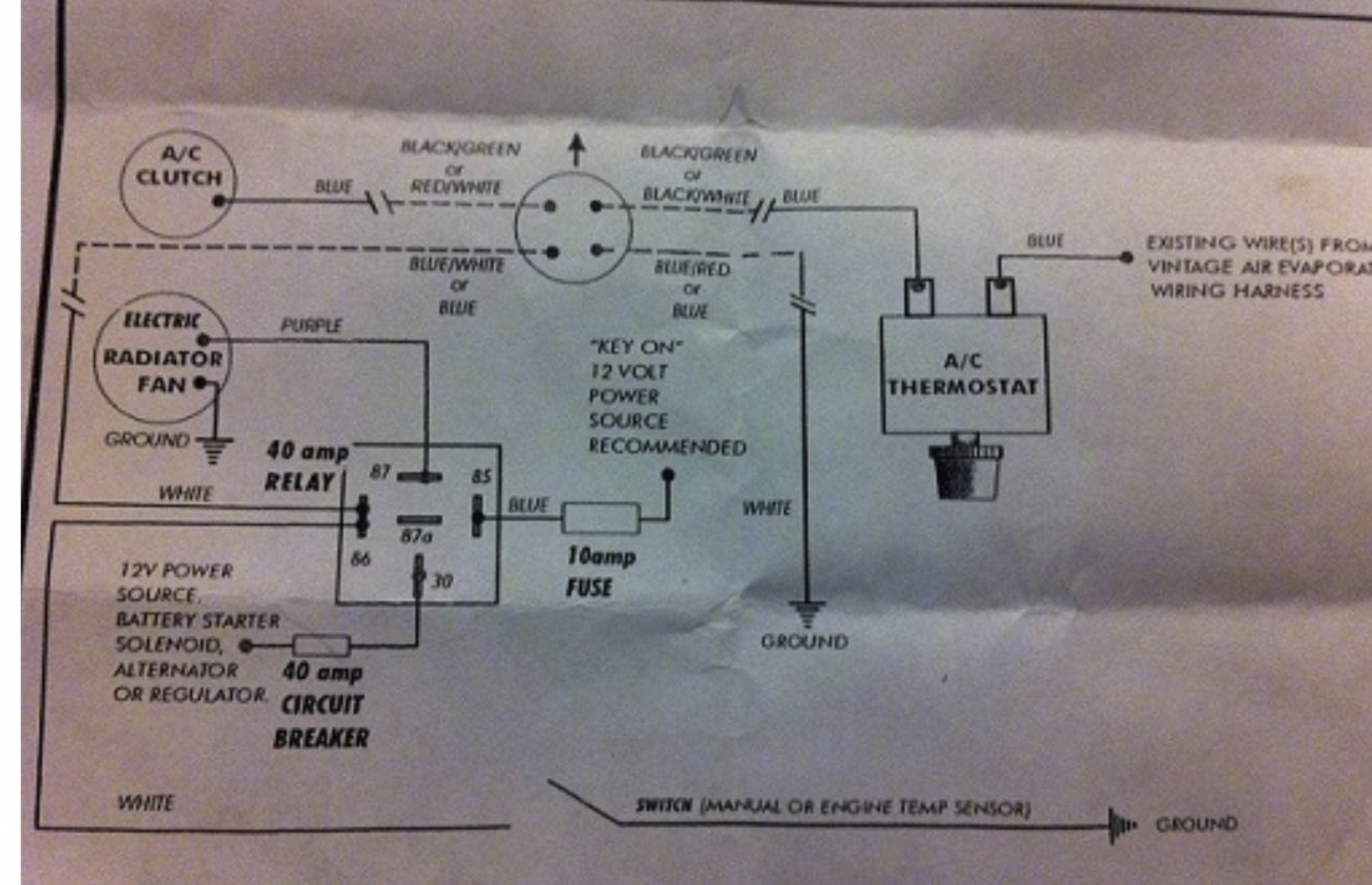

I bought an std aircon kit from carbuilder.com.
But the wiring, is it actually as described on the homepage?
www.carbuilder.com
Because the industry standard seems to be that the blue wires switches the compressor on, and not the condensor fans...
Can anyone that have used this exact switch verify the wiring?
Trinary Switch for Air Con
A Three-function pressure switch for our Air-Conditioning kit #AIRCON.
