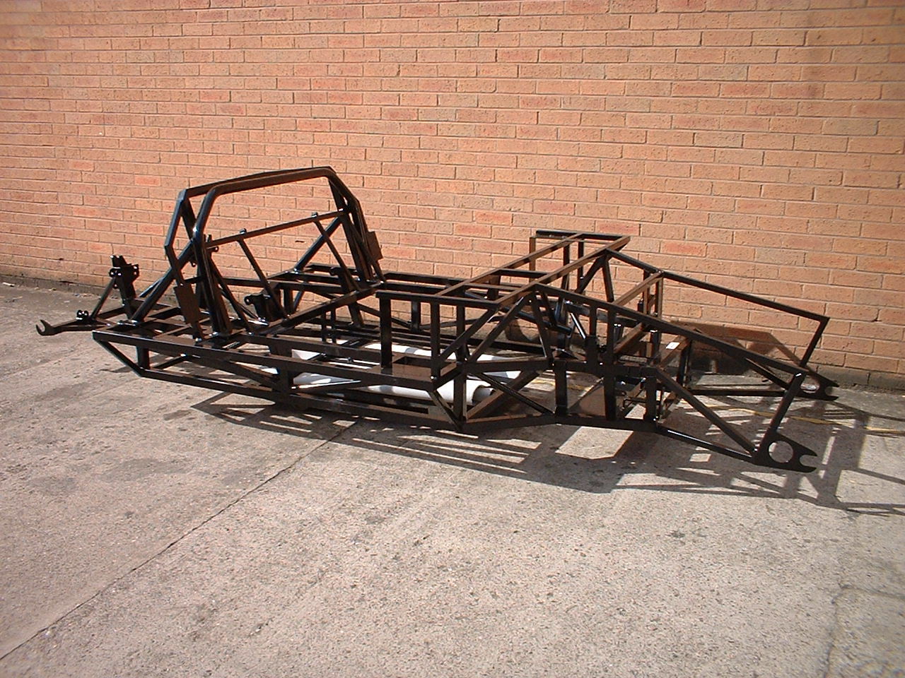

Not sure where you heard that but I would be interested to know.
Our space frame chassis has more triangulation then most other space frames.
We also have a Race spec version available which has even more triangulation.
Rear braces on the rear bulkhead are available as a bolt in option to make paneling of the chassis easy.
We also offer 4 and 6 point cages.
Andy
