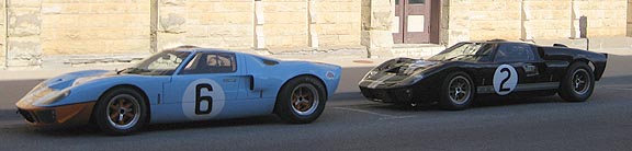

I have a RHD MKI and a LHD MKII. First...MUCH easier to pass with LHD. RHD you cannot "peek" around the car in front and then nail it. By the time you are in "peek" position, almost the entire car is in the oncoming lane!
Less room for both the driver and the passenger in the RHD. RHD with the rod shifter is awesome and muc better than the cable setup on LHD.
RHD= slightly harder to get in and out...shifter in the way.

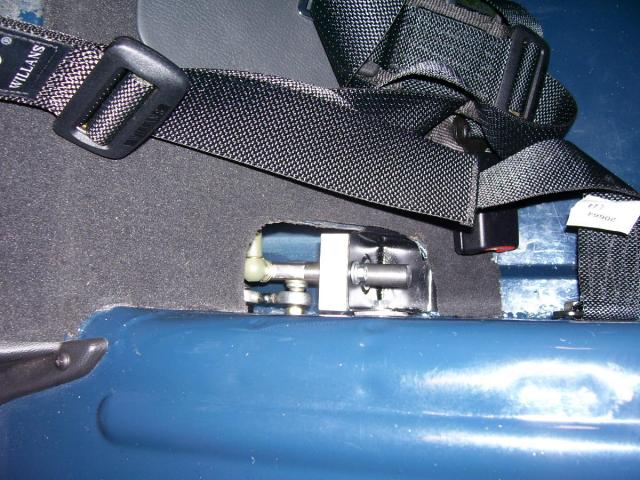

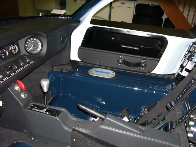

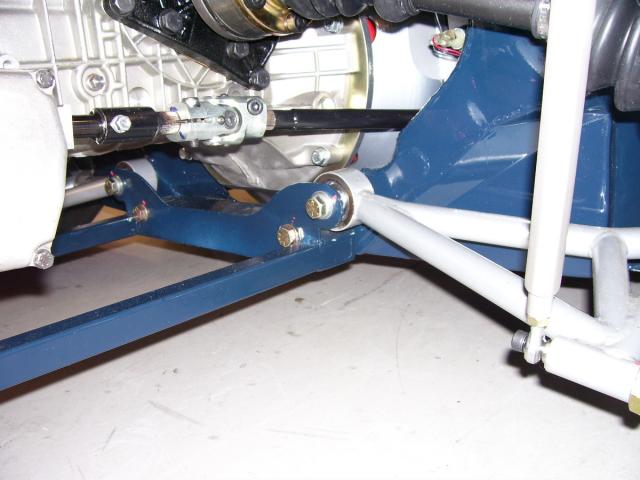

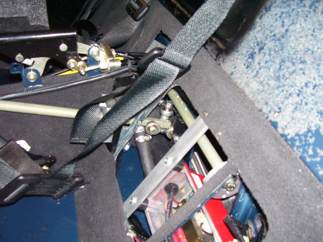

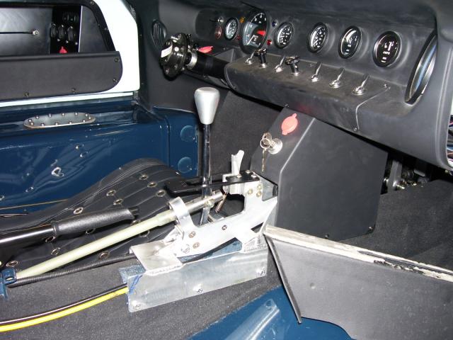

Terry,
See center rod shift as fabricated and installed by Olthoff (works great, has positive feel):

Steve, firewall photo shows more than I understand. I may contact you offline to gather more information on that portion.
