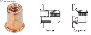

It occurs to me that if you over-crimped a rivnut it would pull the nut part up into the rivet part in a way that would start to thin or cut into the folding part. See pic and imagine pulling with arbitrary force on the threads of the crimped part on the right.
Which raises the question of what is the ideal crimping force and how do you determine when you've applied it? Too little and the rivnut spins, too much and the rivnut fails. I bet the rivnut mfrs have a spec that says if the metal is x thick the compressed rivnut should be y long, or else a pounds-of-pull spec. But with hand tools I don't know how you would measure the latter. IAE not sure how we amateurs are supposed to deal with that, other than experimenting with scrap and sectioning a lot of rivnuts.... With hand installation there is a pretty clear point where everything "goes solid" and that's all I know how to do.
