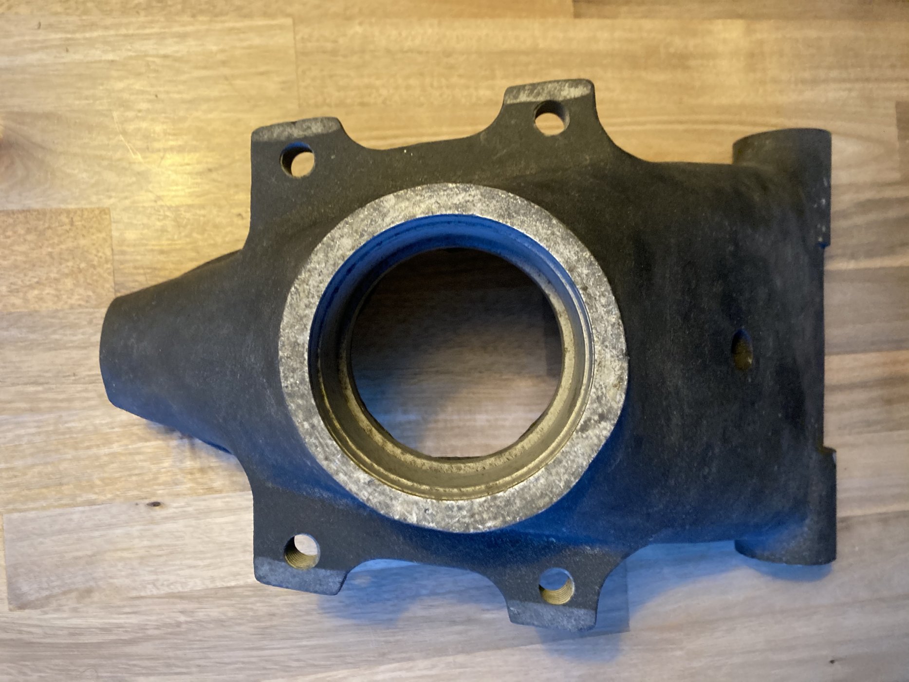

Folks I have bought these rear uprights which seller claimed they were spares with a GT40 they had sold on. They are magnesium so nice and light, but a little different to any that I have seen on any cars. Has anyone seen any like these? I am trying to work out what wheel bearings and hubs work with them but have not cracked this yet. Any bright ideas welcome.

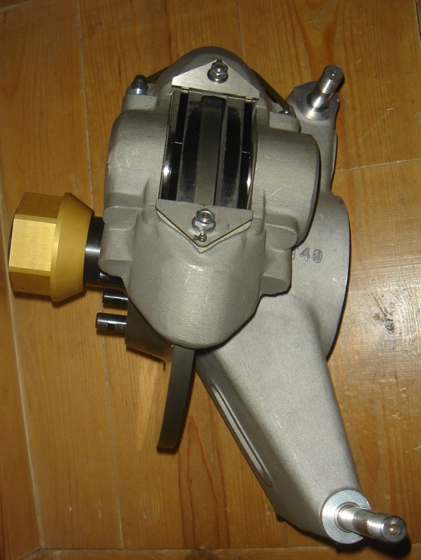

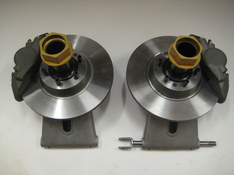

Here are mine for reference.

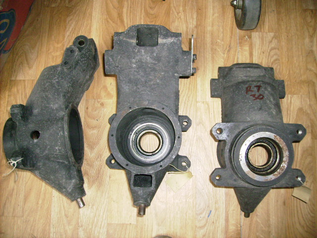

Have done a little browsing and this cherch confirm what I was explaining ;
they are more parts coming from F3 or similar ; some Ralts RT 30 one are something similar ....

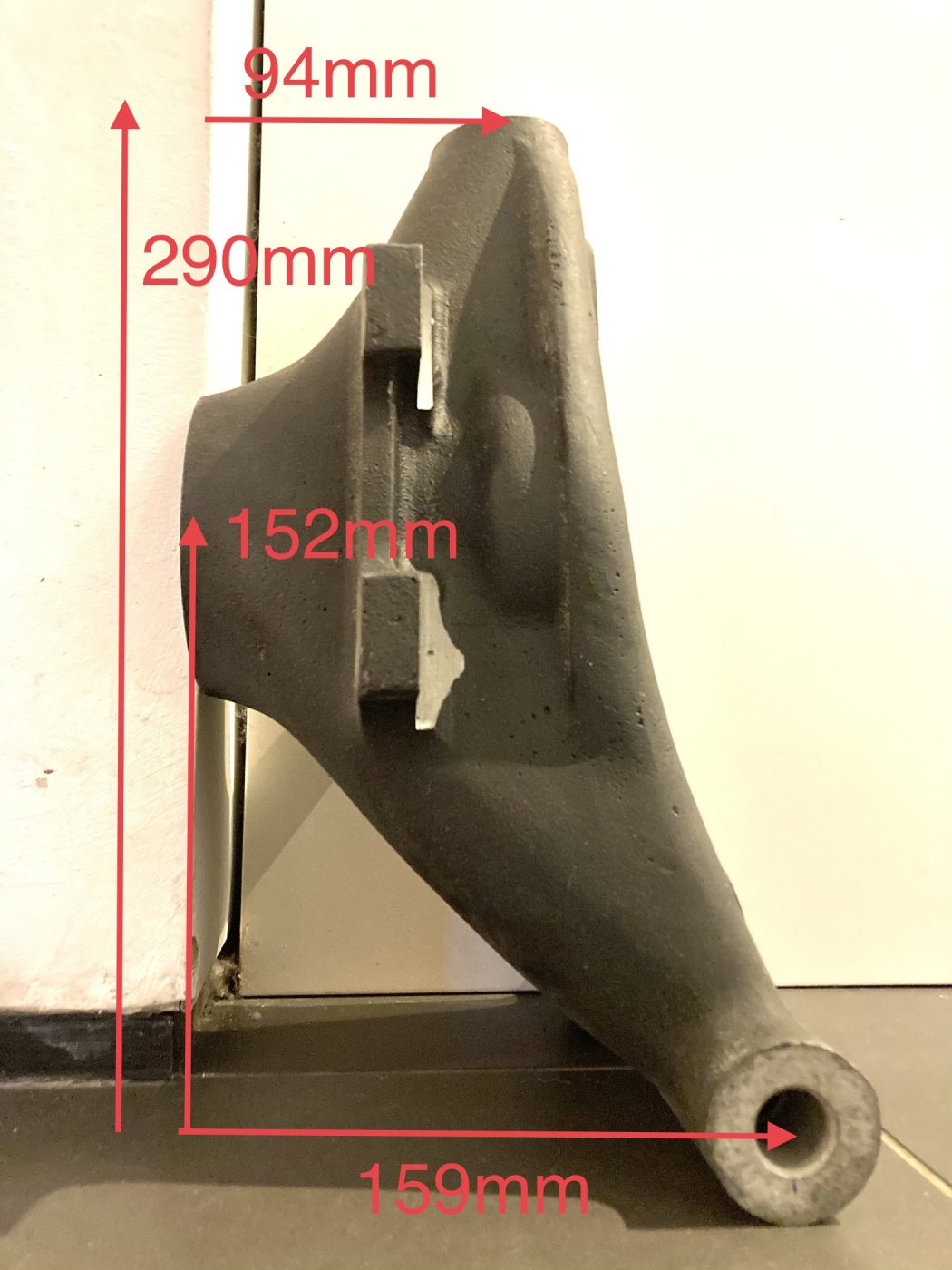

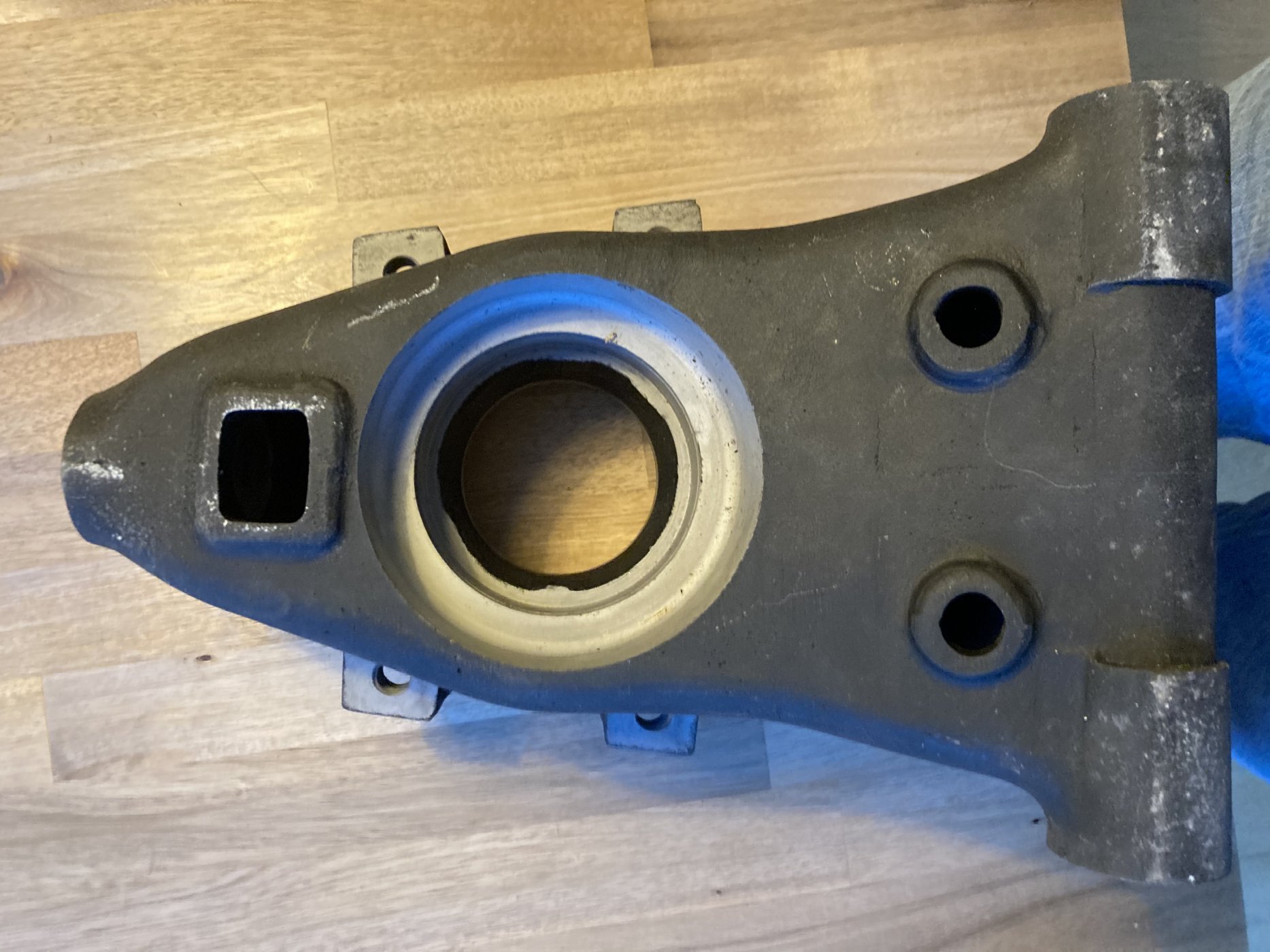

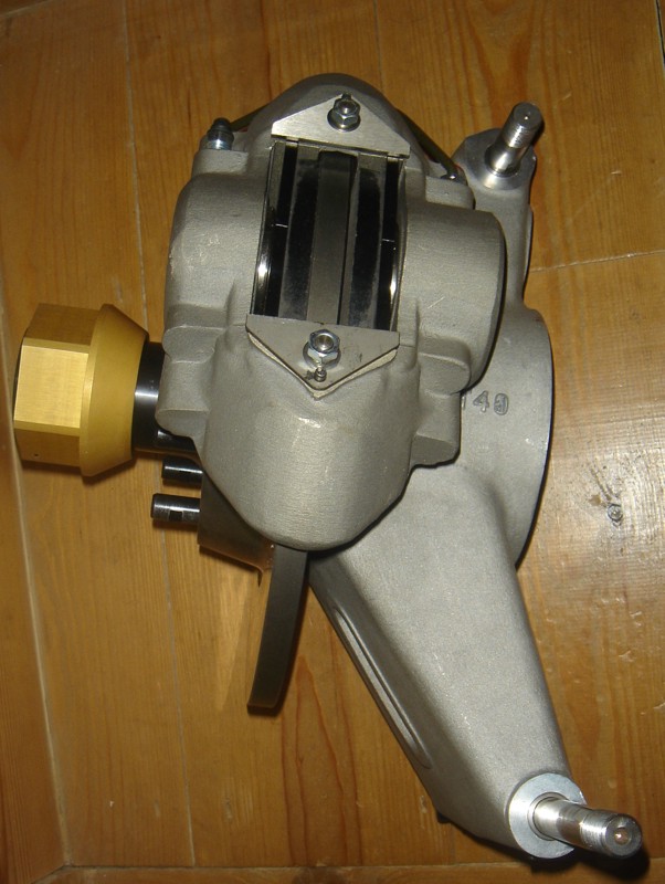

Thanks here is a lateral picture, does this help?

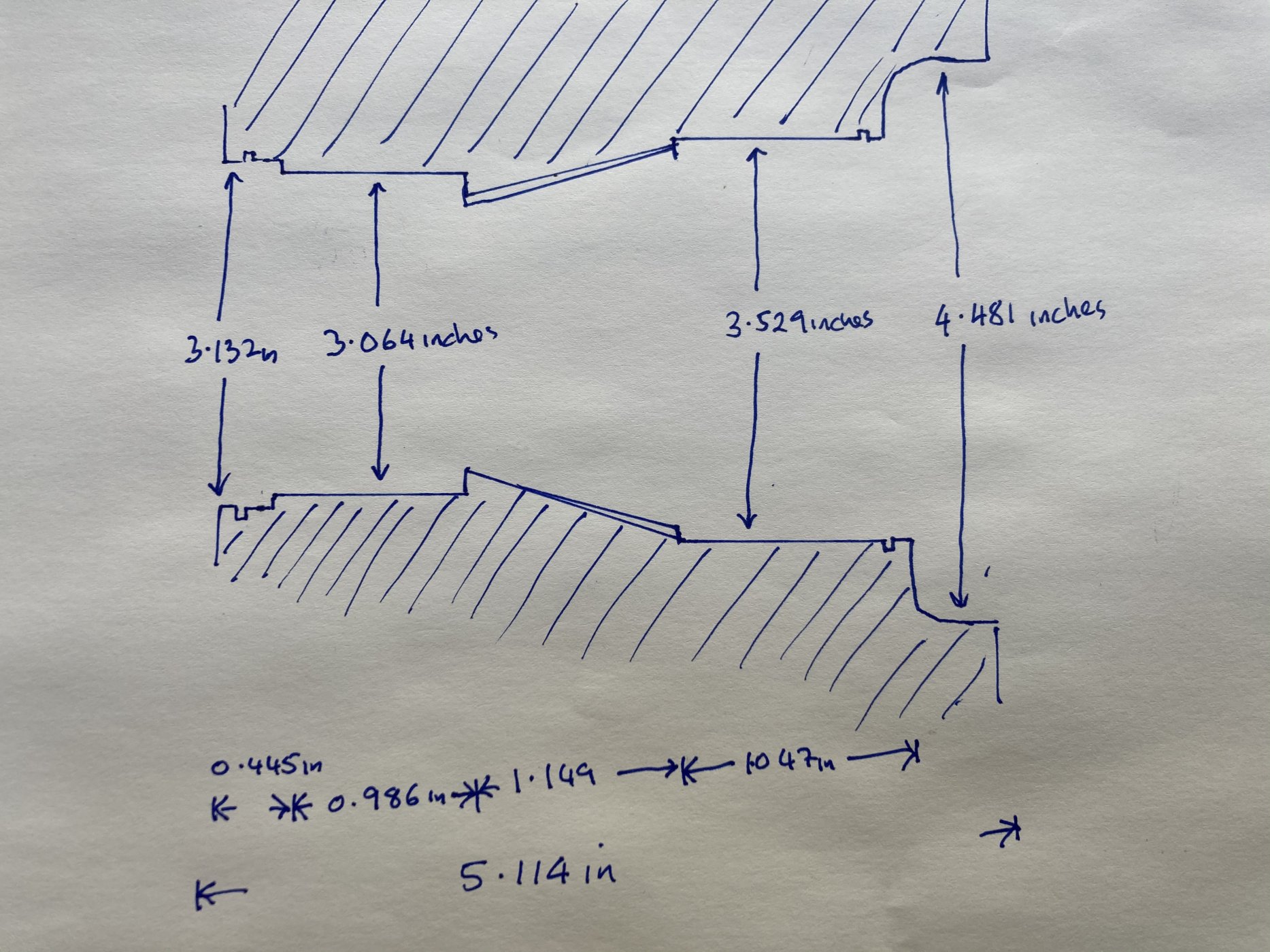

seems the closiest small bearing is Timken 75 mm od ( Imperial ones does not meet with your 3,04 inches .....
Inside diameter for thehub would be 40 mm so very very short diameter to have material to ensure 400 hp torque ?
Probably as said an old unknown F3 ( with max 180 hp)
from your last pic ; the probable use "on period " of those uprights is"inverted style suspension "
