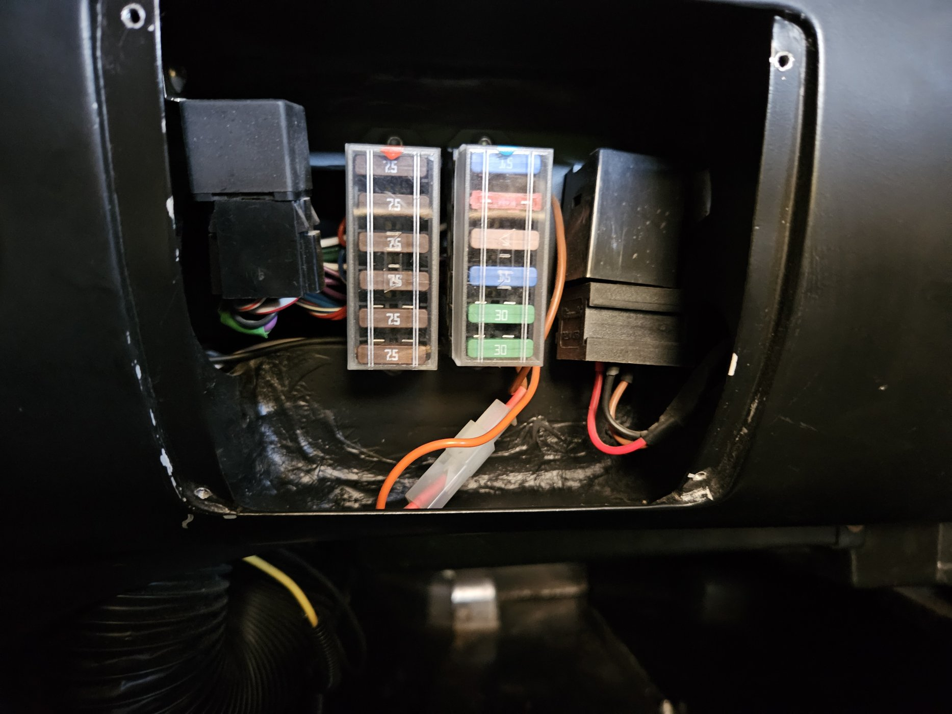

Hello, I check the forum but I cannot found any drawing that shows the wiring diagram of a RCR GT40, if it exist ? or may be my car was wired specifcaly by the person that built it.
My car was built about 12 years ago, and I have no documentation with it. Of course I traced most of the wires from the fuse box, but itr reamains some mysteries, like components that seems to not be protected by fuse or I did not found it ! If somebody has the same fuse box than mine, could you copy me your diagram, Thanks!
To my knowledge, there was not an RCR Wiring Diagram. The wiring package was ala-cart but included with the delux package. You’re basically on your own to choose the wiring package you like and to wire the car the way you like. I bought my car from RCR with the wiring package made by EZ-Wiring. It was a 21 circuit as I recall - had a single fuse box that included a turn signal relay.
what you’re showing in your photo looks like a do it yourself wiring center with two separate fuse panels and some assorted relays.
I know this is not much help, but at least you know there has not been an RCR Wiring diagram and most likely there is still not one.
So, if I am correct - to make use of what you have will be the process of elimination and making your own drawing..
Thank you Randy, I was expecting this answer, Walter already mention the EZ-Wiring package but mine is really different. Nothing is impossible, I just have to pass more hours on it.

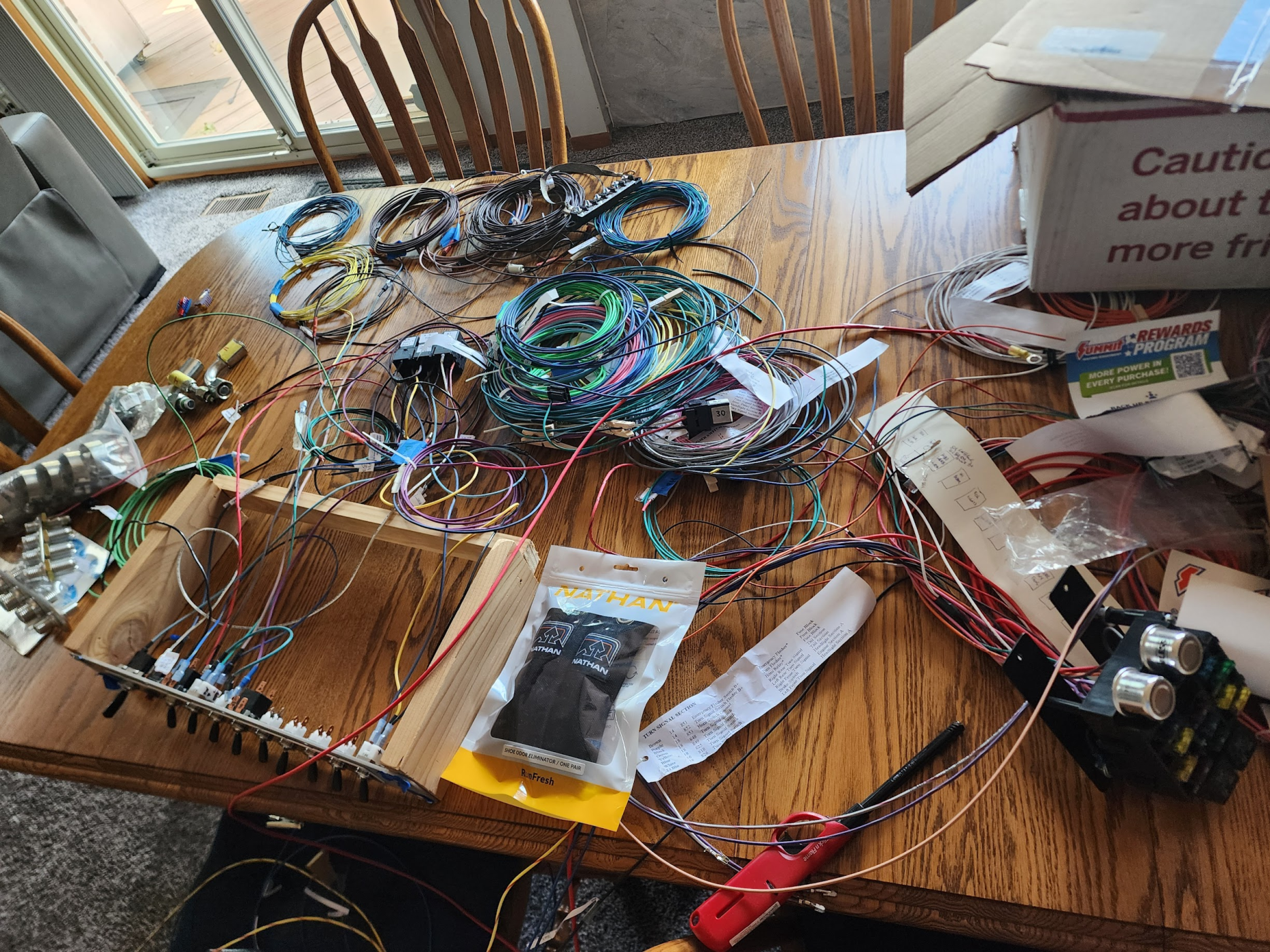

Jean-MarcI am just getting started on my RCR40 wiring using the Haywire TA fuse box and many bundles of wires. There are a few diagrams in the instructions but no comprehensive view because the kit is intended to work with multiple configurations/components.
I will document how I put mine together, but it may be a few weeks before get to a point where I have something to share.
Cheers, Randy
