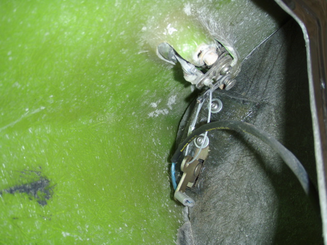

Dean: Would this photo help you?
Thanks, that is a good shot for the interoir handle but I was referring to a cable from the extior handle to the latch. Do you have a shot of that? It would be a short cable, maybe 3 or 4 inches.
You don't need a cable. The latch comes with that long rod (with threads on the end). Use a vice and bend the rod to fit into the holes in the latch. Don't bother nutting it down because it won't pop out of the bear claw latch.
