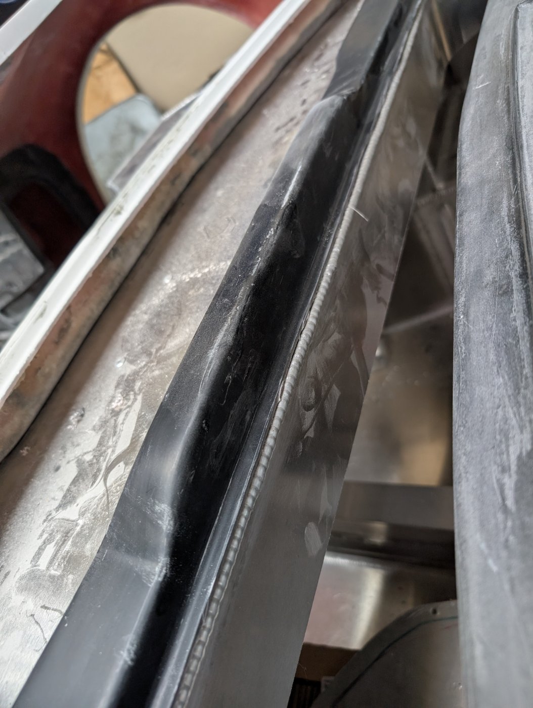

This is a shot of the current RCR plenum showing the raised bump-up in the center
I also wanted to be able to remove the dash. I cut the taller center bump off, made the plenum the same height all the way across. Will add some diverters. Also modifing the dash at the dempster grill for better flow and ease of removal. I also cut the top ends by the a pillars of the dash off and will mold them to the spider.
GTD dash on KVA chassis. I made my dash plug & play and removable. My dash slides in and is screwed to the upper chassis members.
I just fibreglassed some mounting points to my dash corresponding to the beams that sits below the dash.
A bunch of conectors makes the whole dash plug & play.
While I never finished this part of my build (sold the car), I was setting it up to have the plenum bonded to the dash. Note that the front of the dash is actually to be held in place by the front of the spider. You’ll have to loosen the spider to slide the dash rearward.
